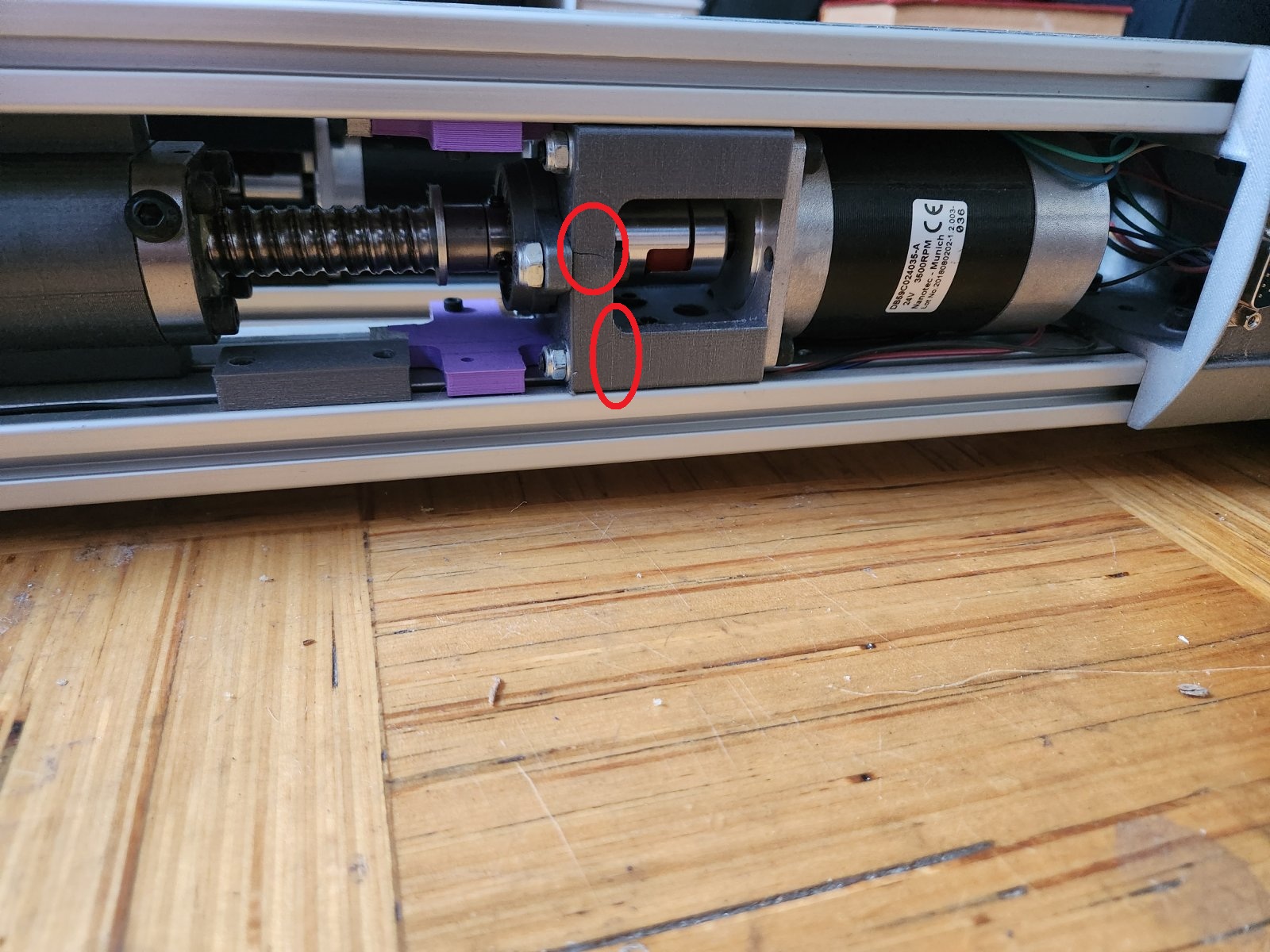

    Now that I finally managed to get FlyPT to recognize telemetry from games, I moved on to assembling the platform. And it turned out that not only the U-joints cracked—other 3D-printed parts also broke. Never use 3D-printed parts in your devices where there is any load. This is the result: everywhere there was stress, everything broke apart. And I haven’t even used the platform for a minute yet; the actuators are still sitting on my desk... The previous owner said it was used for a maximum of 20-30 hours. But that was enough time for failures to start appearing in all the joints and mechanisms. I don’t even know how safe it is to build this platform under these conditions. It looks like for safe use, all the actuators will need to be rebuilt, and all these 3D-printed parts replaced with metal ones. Now I’m starting to understand why factory-made actuators are so expensive. I recommend everyone to buy those if you don’t want to suddenly fall from a height because of another broken part. If anyone is interested, I can sell it right away for the price I paid. If you need it, feel free to contact me!

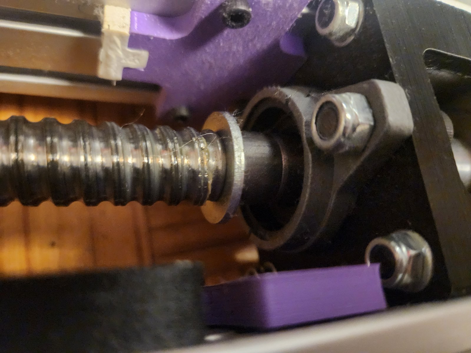

    This is exactly what I’m talking about…

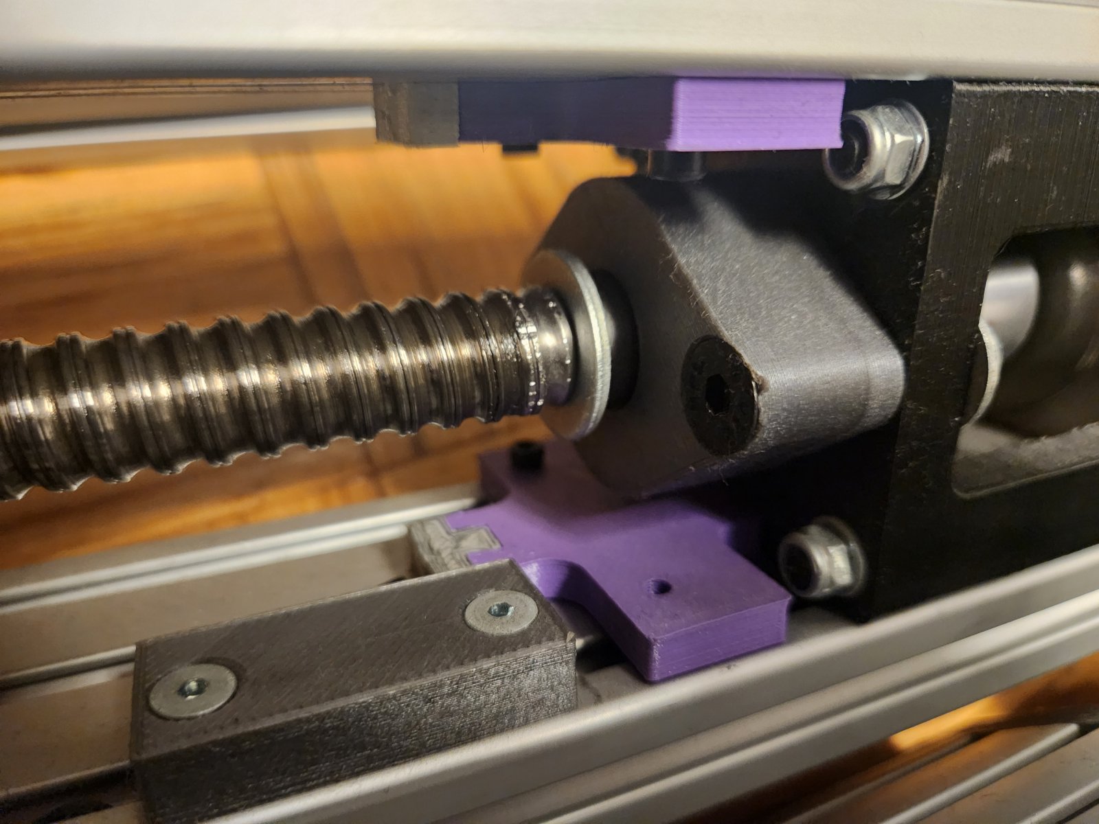

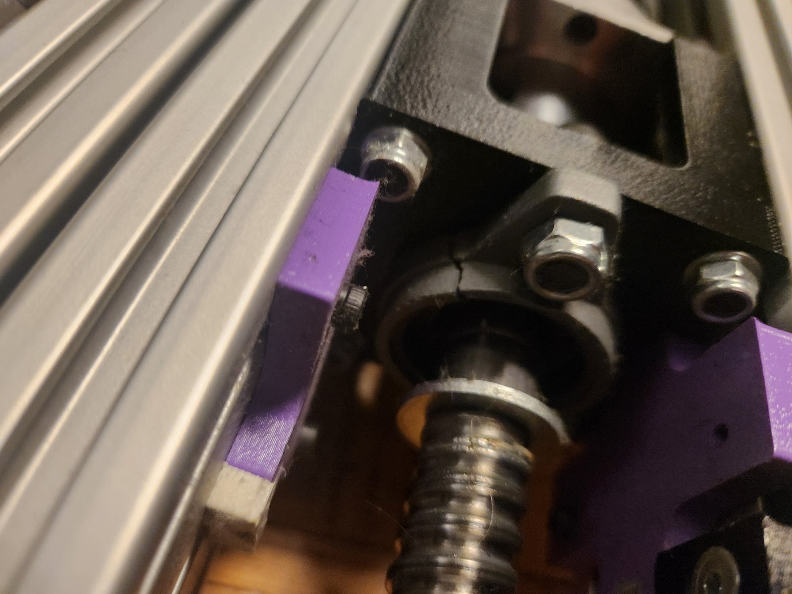

    Hi. I'm from Estonia. As you’ve seen, the simulator has a lot of problems. The design of the actuators is just unbelievably bad. Almost everything that could break is either already broken or cracked. Today I found even more issues. The support bearings have completely fallen apart and all of them need to be replaced. And instead of one of the support bearings, there’s actually some kind of 3D-printed part installed…

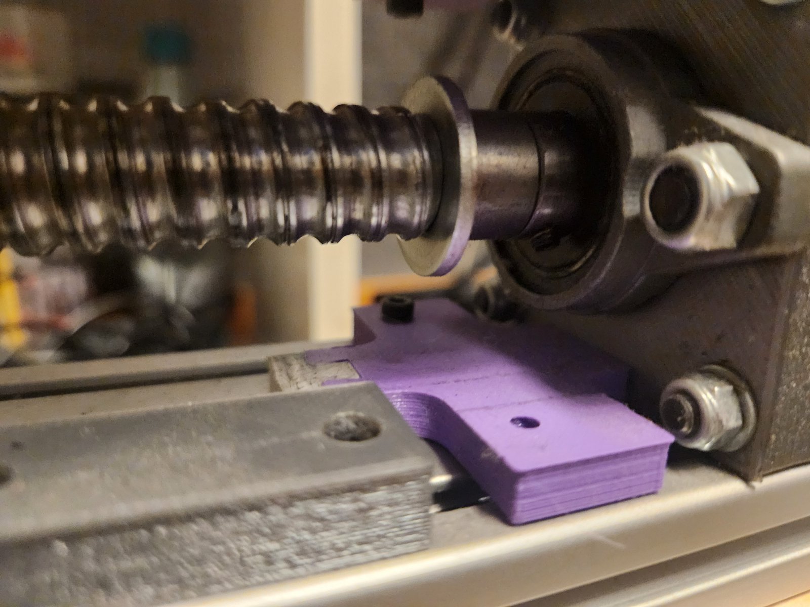

    What i mean...

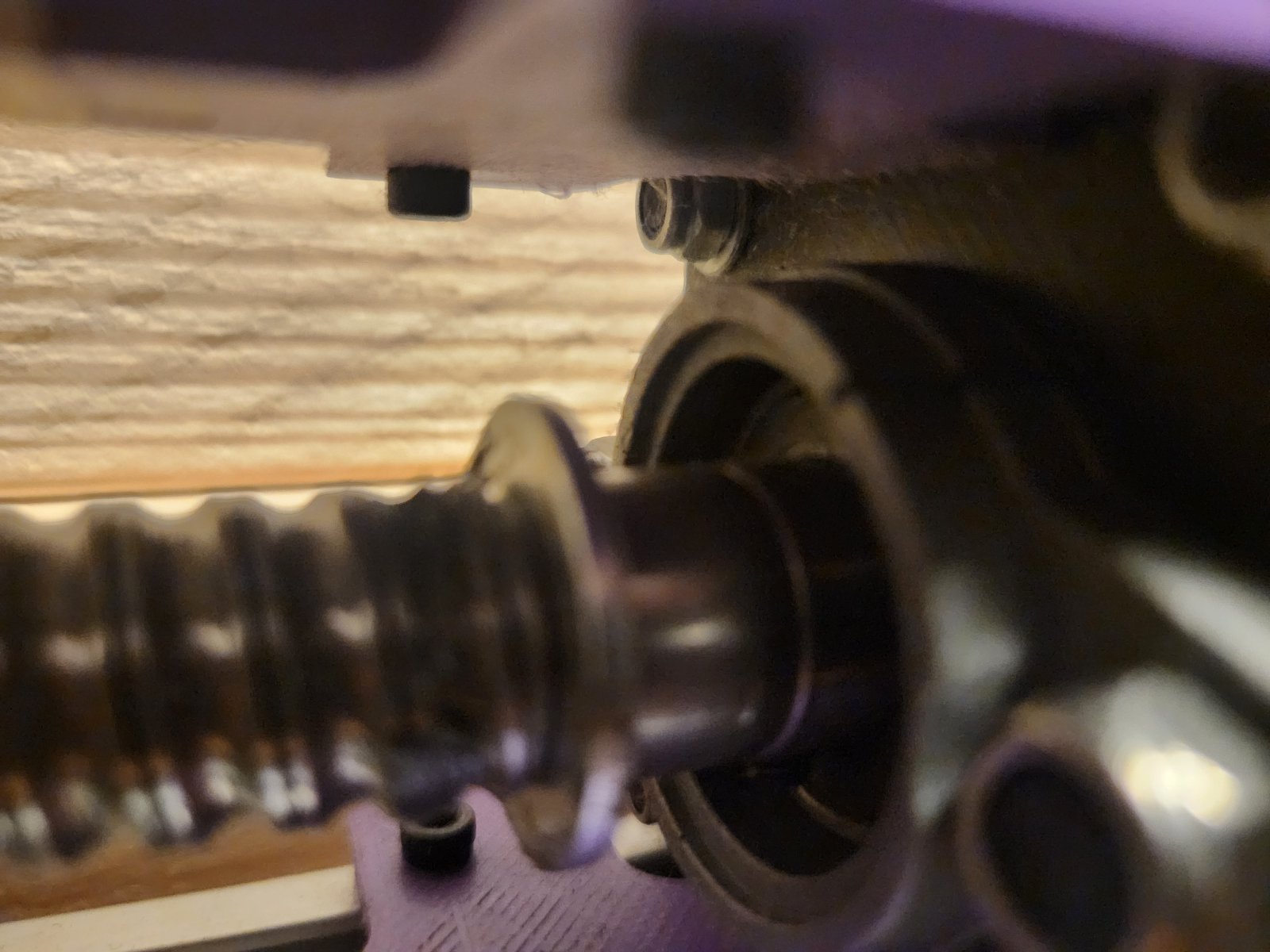

    How it should be...
