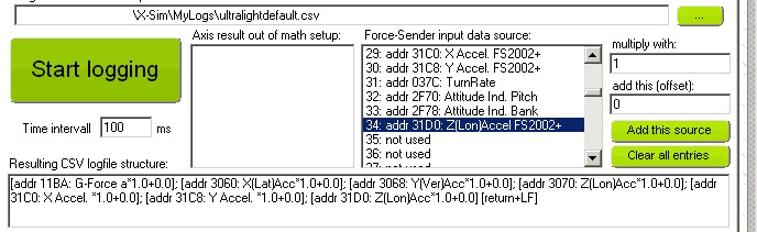

    Well it looks like I'm getting a constant stream of data from sender now without any problems as might have been expected. However, I'm still unable to get any data when I Start Logging under Output Setup. I assign the full path which ends with
    X-Sim\MyLogs\ultralightdefault.csv
    I then select the Force-Sender input data once it's connected and I can see figures updating in Input-Setup and if I'm in the folder of the assigned path and I've deleted the .csv file with the name that I've assigned... as soon as I click Start Logging, a new file with the name specified is created but it remains at just 1kb with no data being written. The names of the Force-Sender input data are input as they can be seen in the Resulting CSV Logfile Structure, but no values are added as I fly around.
  3. Atomic_Sheep
    Atomic_Sheep New Member
    May 19, 2010
    21
    22Coins
    Oh, I see, I thought that you could log the force sender outputs directly. Time to start figuring out the maths.
