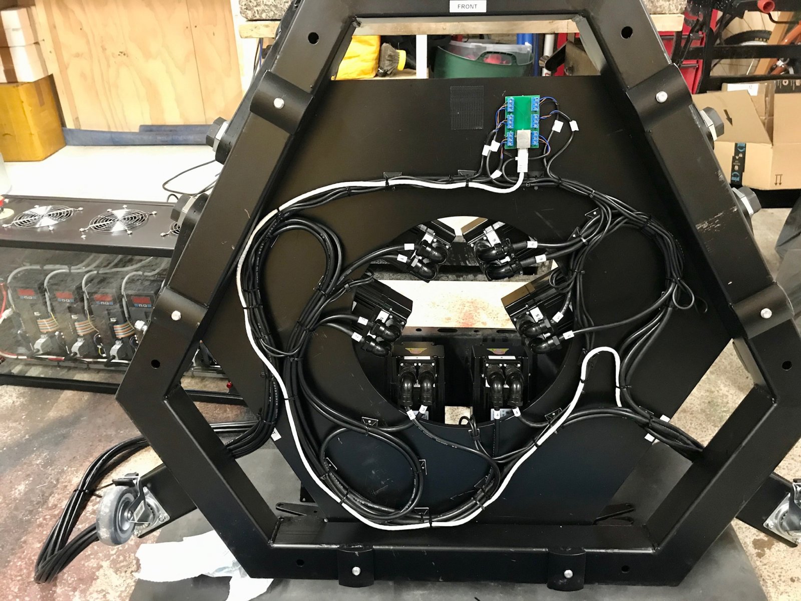

    In the meantime, it sounds like you're making good progress :) I can post some information about my first single motor test, which might be helpful:
    As you can see the movement of a single motor is irregular and difficult to correlate with the image. If you are doing it with jus the motor then you will see much bigger and more irregular-looking movement.
    Now I have the platform built I have found that the output from some games can be very noisy. That is when the filters in Simtools become very useful. It's possible that this is what you're seeing. Even with the platform fully built, I have found that some of the outputs are difficult to correlate to start with.
    When I could see that the Axis Testing 'Heave' dof was working correctly in all of the motor positions on the circuit board, that was good enough evidence for me to progress to the next stage.

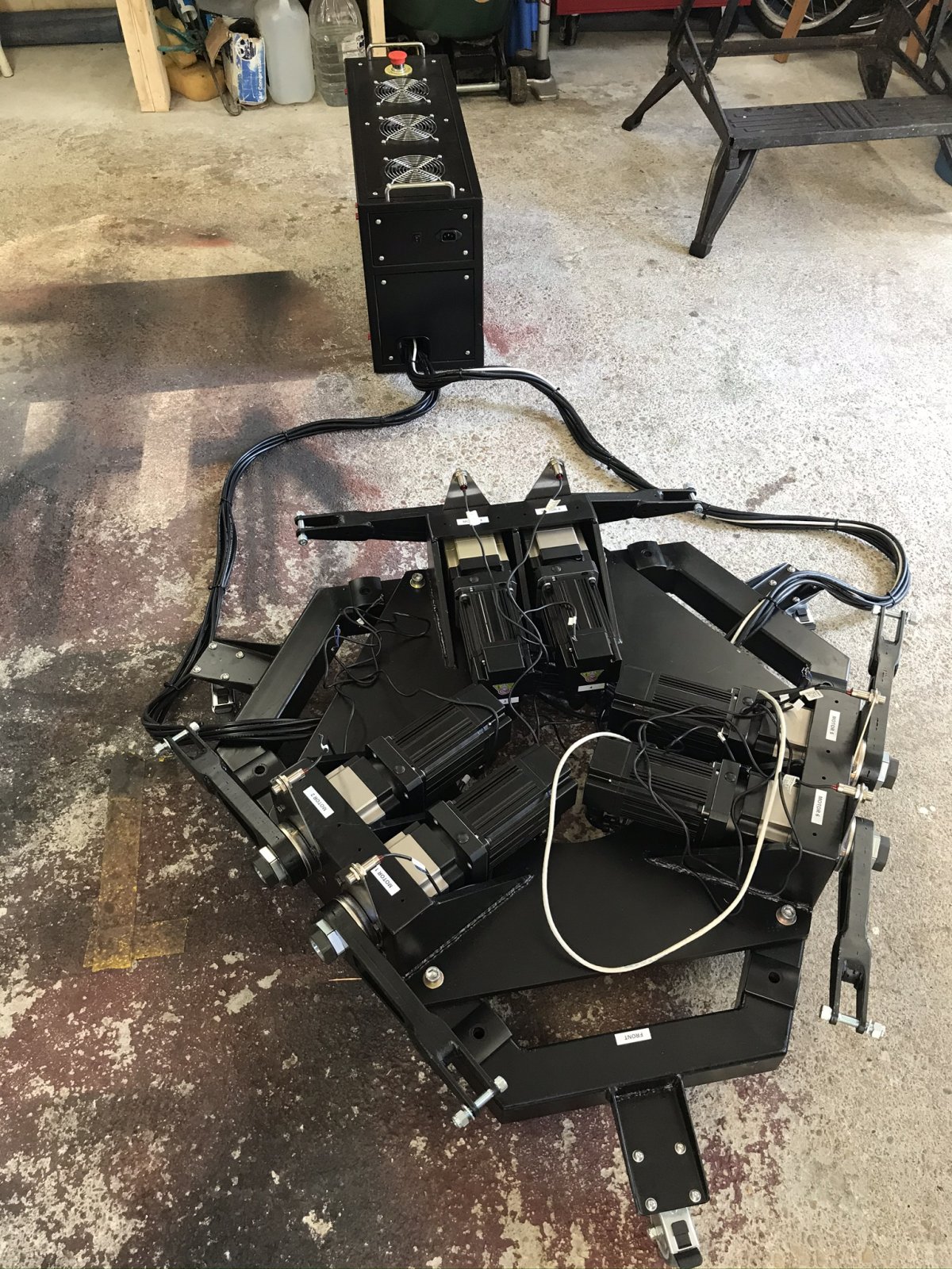

    Thank you very much for your help. Now the single servo motor works normally. It is because my computer is not set to English. I will go on to the next step. I am going to buy welding machine, welding arm and support rod. Is your support rod ordinary steel pipe?
  7. DirkGently
    DirkGently Tweaking, always tweaking.
    Sep 15, 2020
    38
    Design Engineer
    UK
    151Coins
    +67 / 0 / -0
    Motion platform, 6DOF
    Yes, I used mild steel tube 25mm diameter and wall thickness 2mm.
    Be careful to check the buckling capacity. My first design (Ø20) buckled a little bit so I have just done larger diameter and shorter length. I will post photos of the new support rods later,

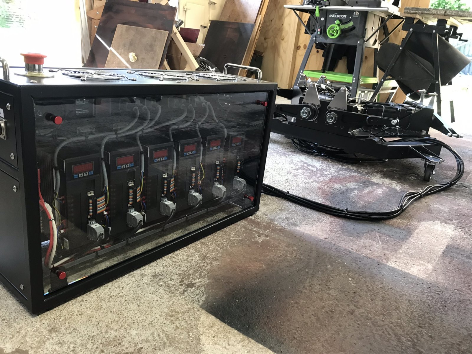

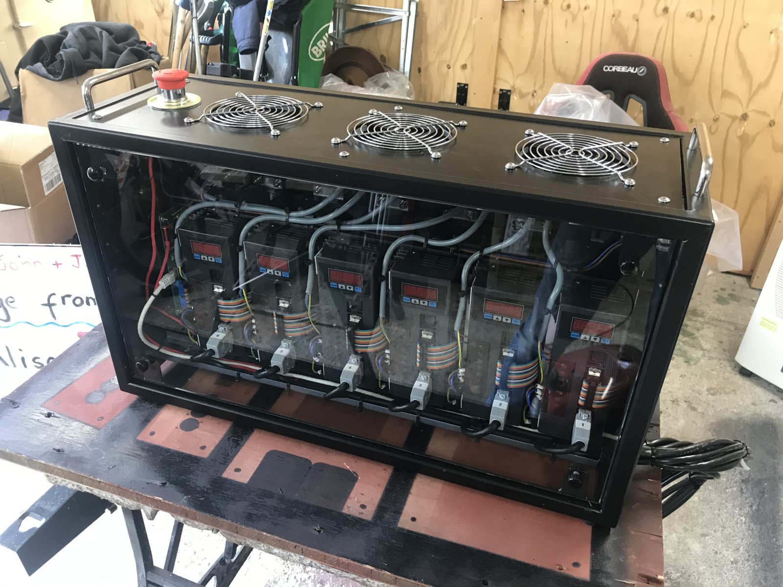

    Hello, what is the name of the enclosure that houses the servo AASD15A driver, can you give me the link to buy this enclosure? Thanks!
  11. DirkGently
    Sep 15, 2020
    38
    Design Engineer
    UK
    151Coins
    +67 / 0 / -0
    Unfortunately it is not a commercial product. I made it all myself by welding the frame together and getting a piece of glass cut to fit onto the front. I made the top, sides and back from aluminium.
