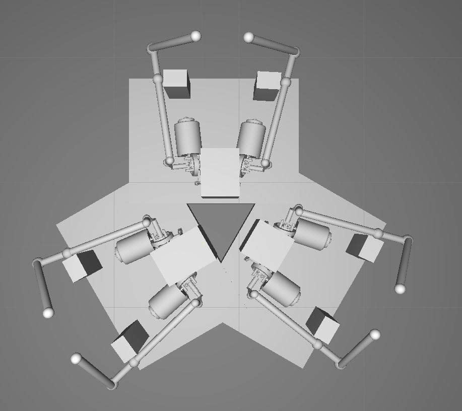

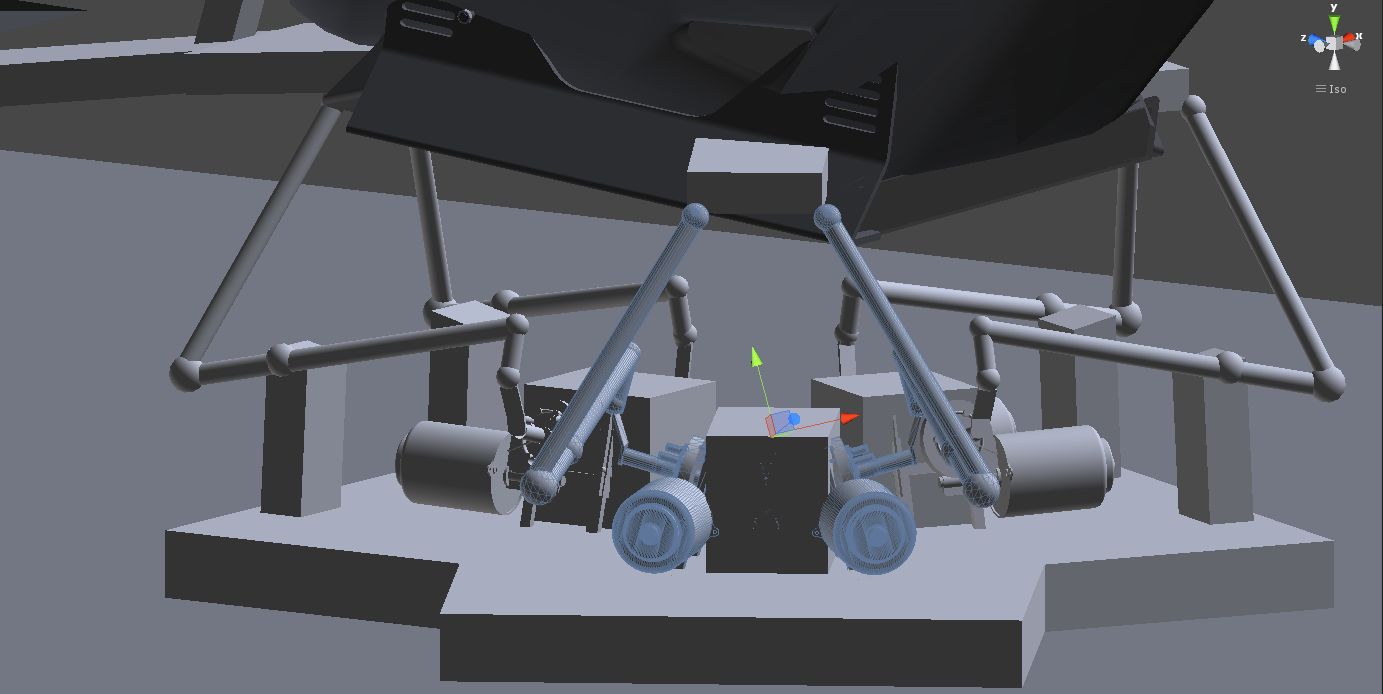

    Hi prilad
    Would you agree that having a pivot point works good in 2dof simulators?
    In 2dof setup, two motors share the same pivot point for movement in 2 directions, for 6dof I plan each motor to have it's own pivot point, which should take on some of platform weight.
    Also 1/3 lever should help motors as they will always feel just one third of the platform weight.
    (In theory you could make 2dof by mounting seat directly to a motor shaft and 2 motors would do the job, but pivot point makes it possible to use much smaller engines)
    I plan to get around the speed and movement reduction problem by using 180rpm motors. if the speed is reduced to only one third, that leaves me with 60rpm.
    With lever there is less weight on the motors and you can use longer motor arm.
    You can say that this is the same thing as reducing the arm length in the first place (and not use any levers),
    but the motors which I plan to use can back drive, and 1 to 3 lever will give me confidence that this will not happen, also it should help gearbox and motor last longer.

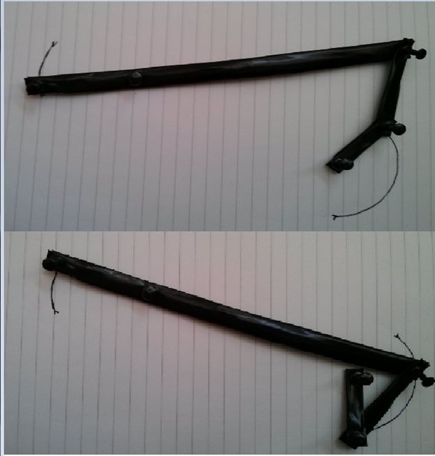

  7. Tino
    Tino Member
    Mar 25, 2014
    100
    1,289Coins
    +46 / 3 / -1
    Hi Historiker,
    Yes, I plan to use strong levers :)
    Also I'm thinking of having motors and lever at an angle so they would follow as closely as possible isosceles triangle movement for 6dof.
    However, sideways force will be the same as on your 6dof platform without lever, and hopefully another lever benefit would be reduced sideways forces on the motor.
    When using levers resulting motion is exactly the same as motion of motors with just motor 'arm', except you loose more motion as you use longer lever and lever motion has opposite direction.
    Here I have highlighted with a pen resulting lever motion on (left half circle) and ordinary motor motion with just motor 'arm' (right half circle)
