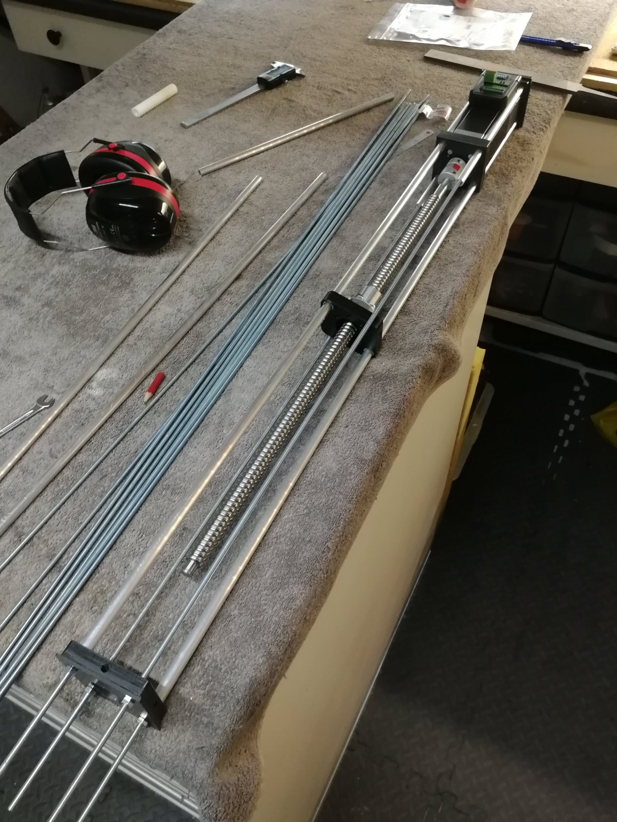

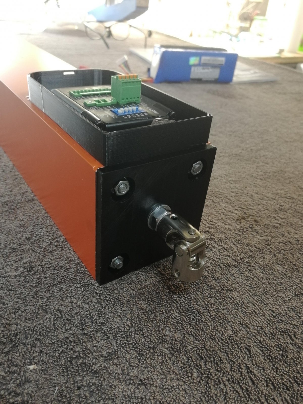

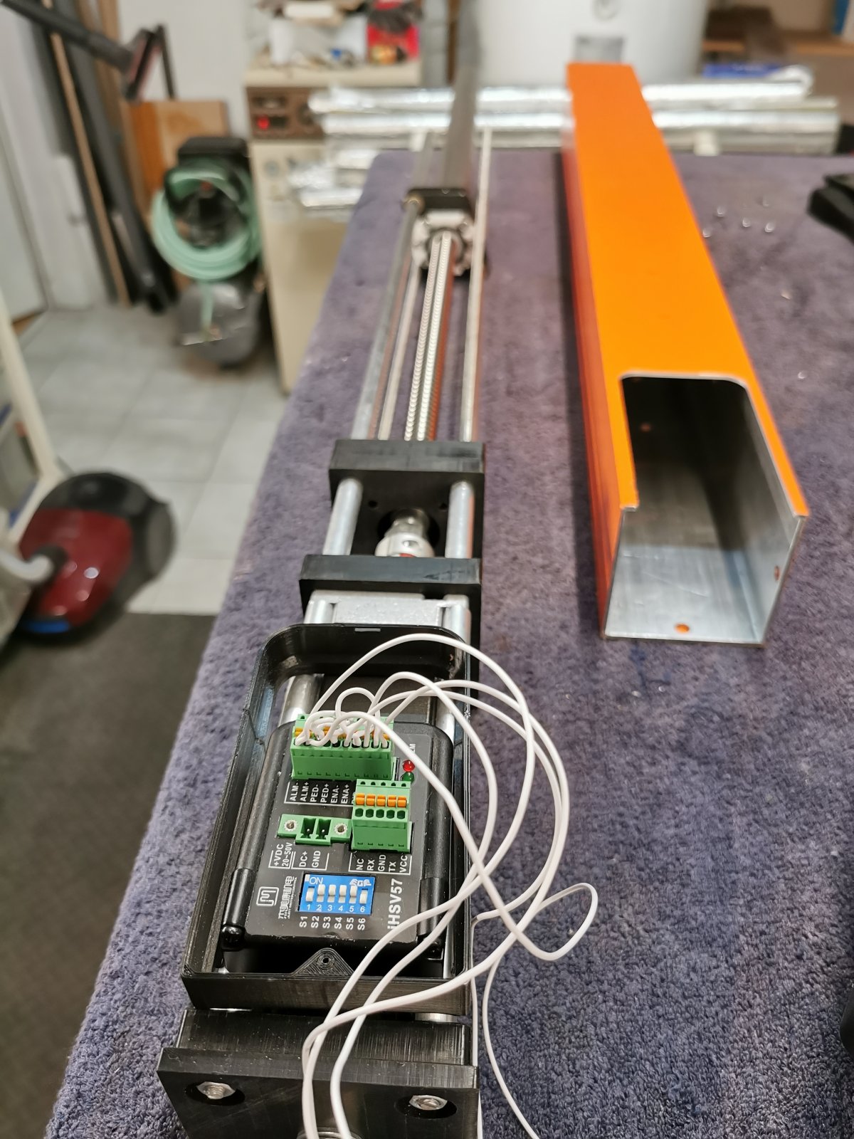

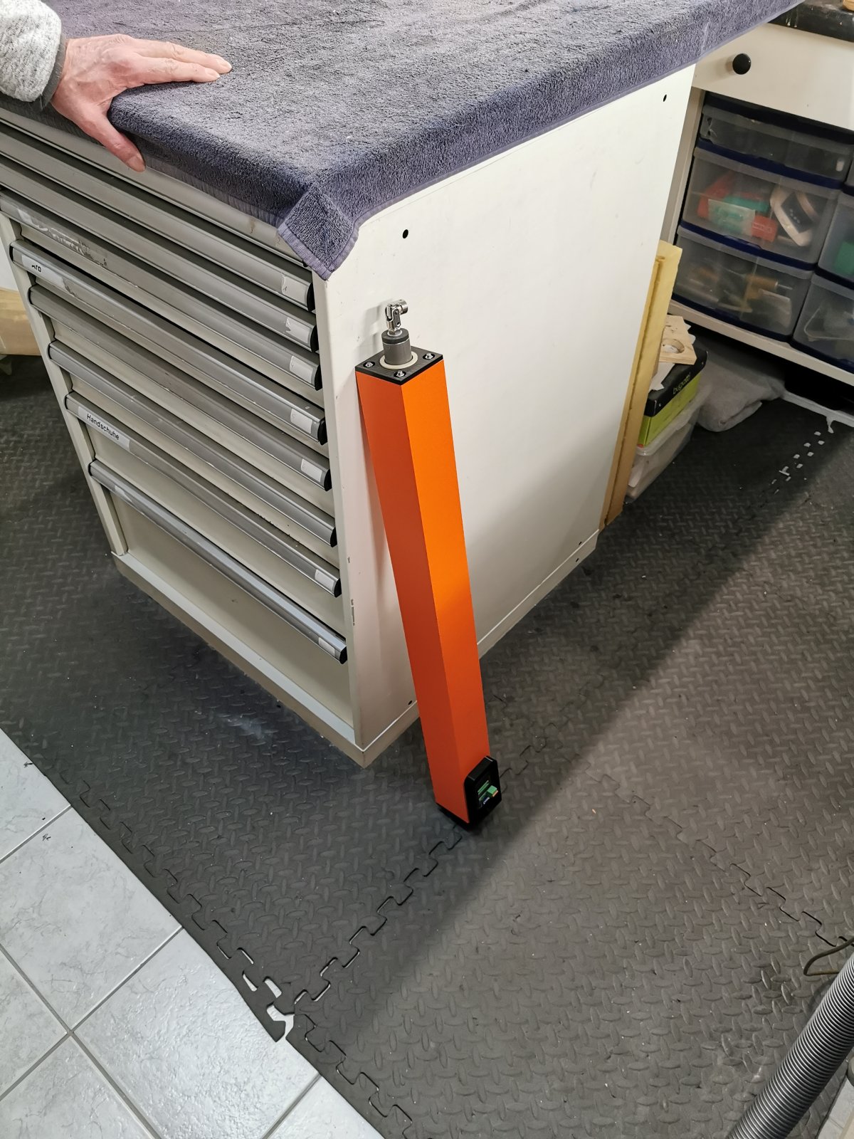

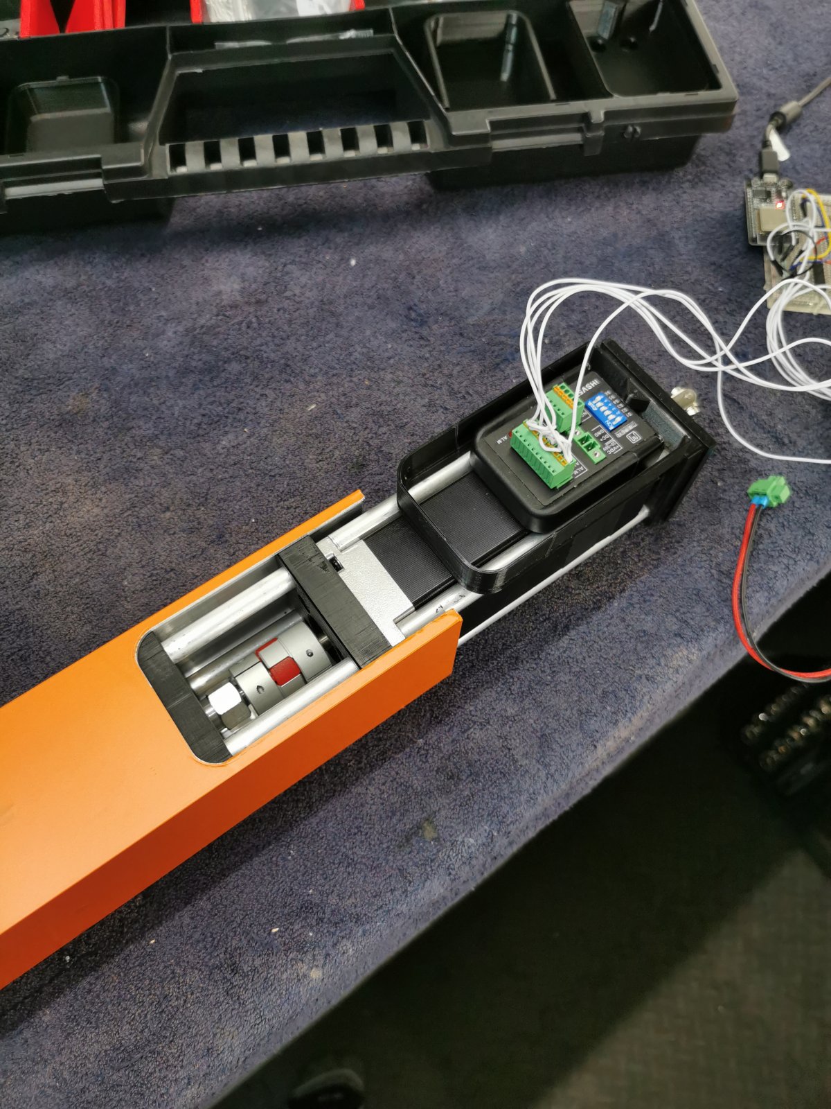

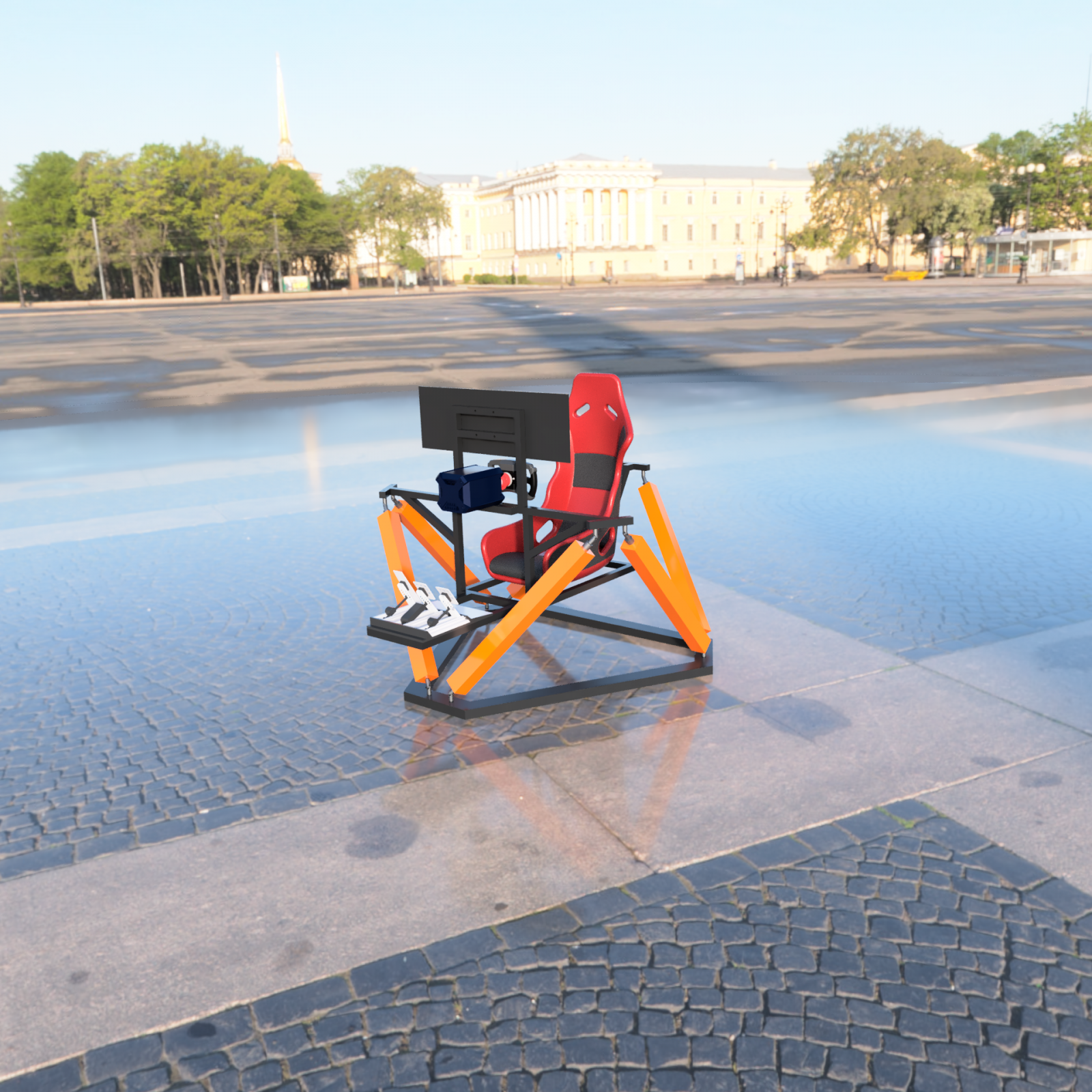

    Some years ago I started to design a 6DOF motion simulator after I got inspired by pmvcdas (aka FlyPT) 6DOF using brushless (BLDC) motors with 220W of power.

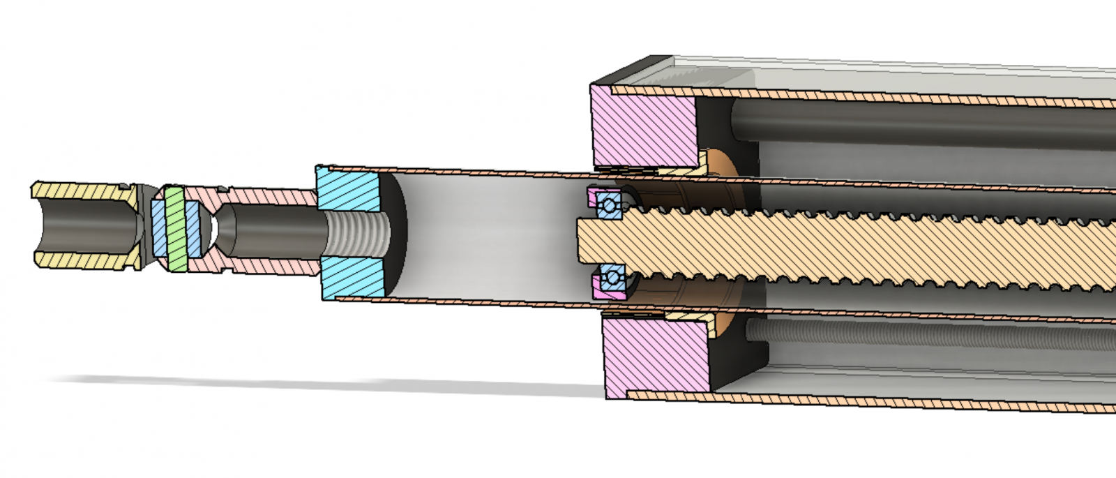

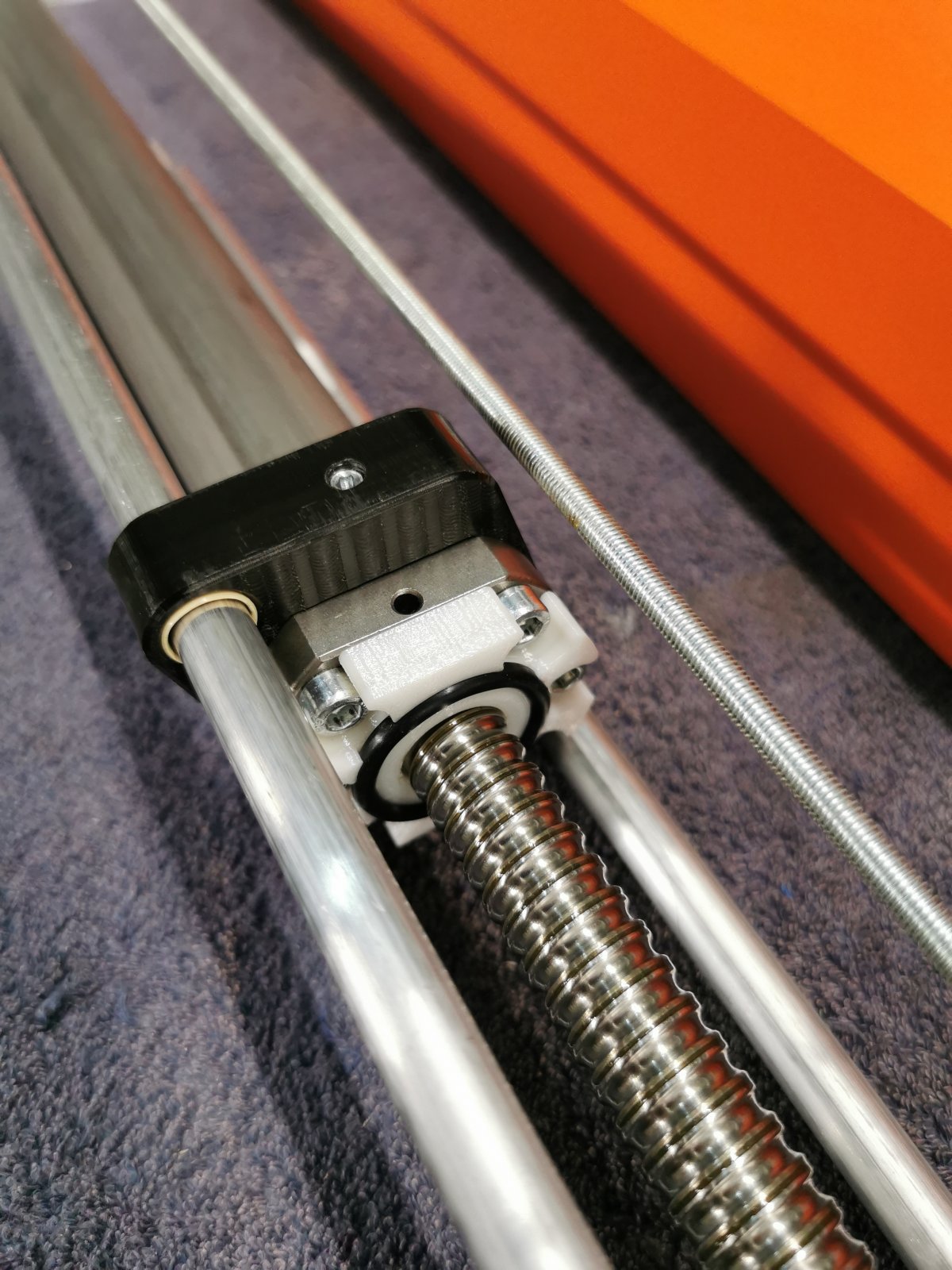

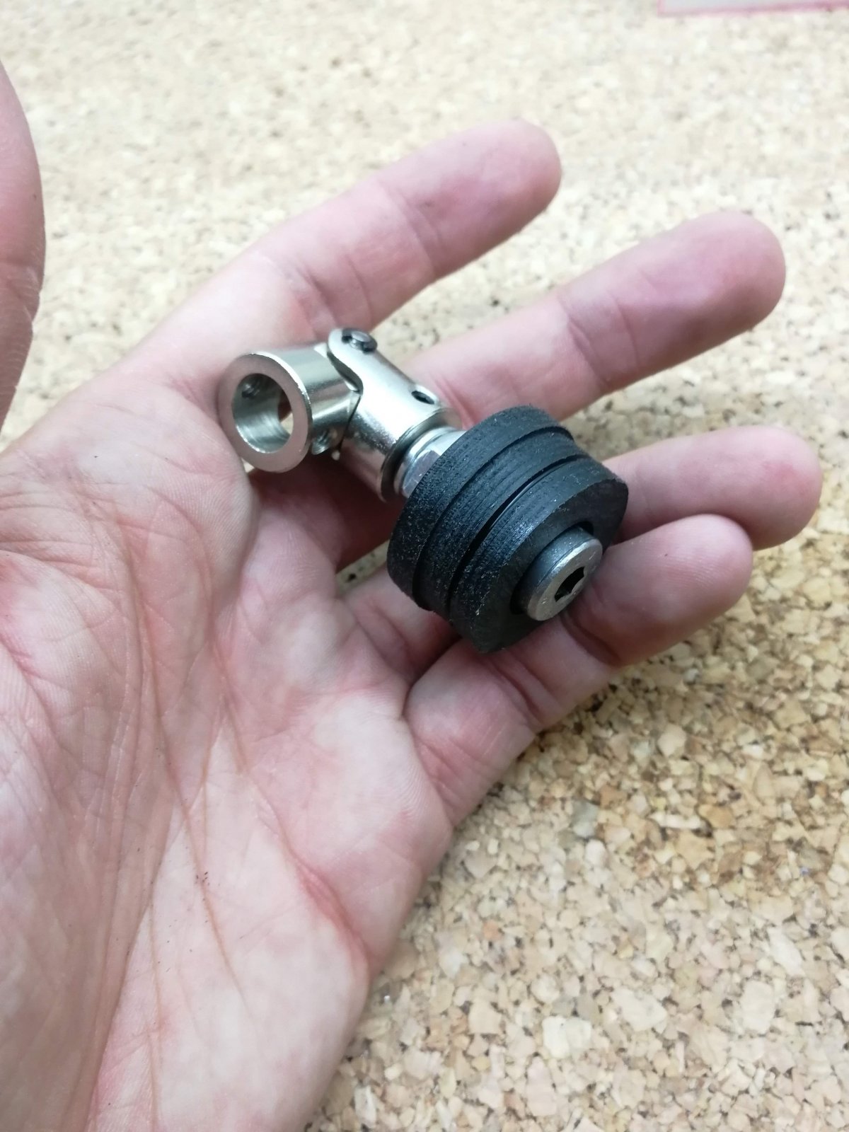

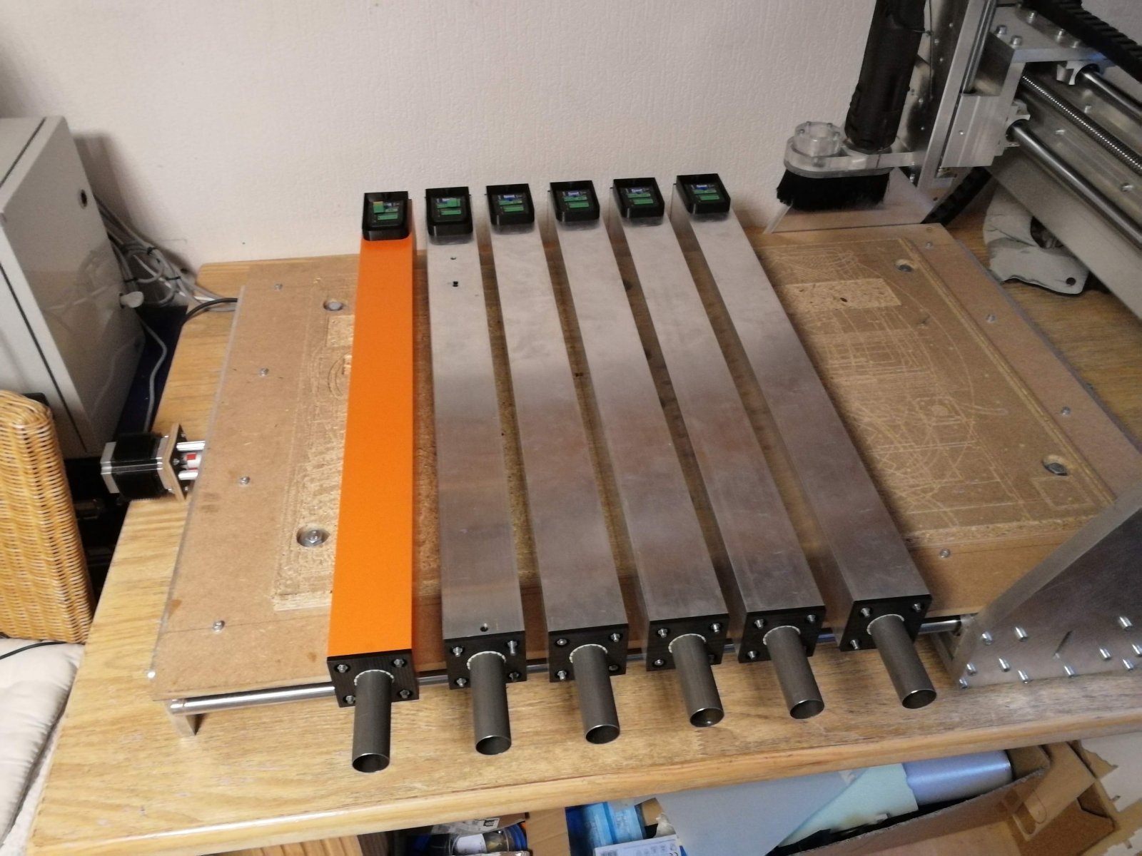

    Instead of the 220W BLDC motors I'm using 180W Servo motors by JMC. They are quite inexpensive and easy to control. However, they might have not enough power. I guess this is something i have to find out.

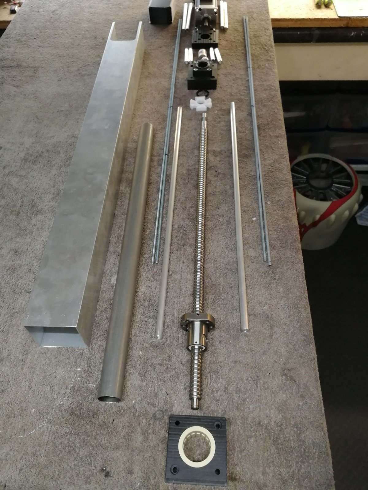

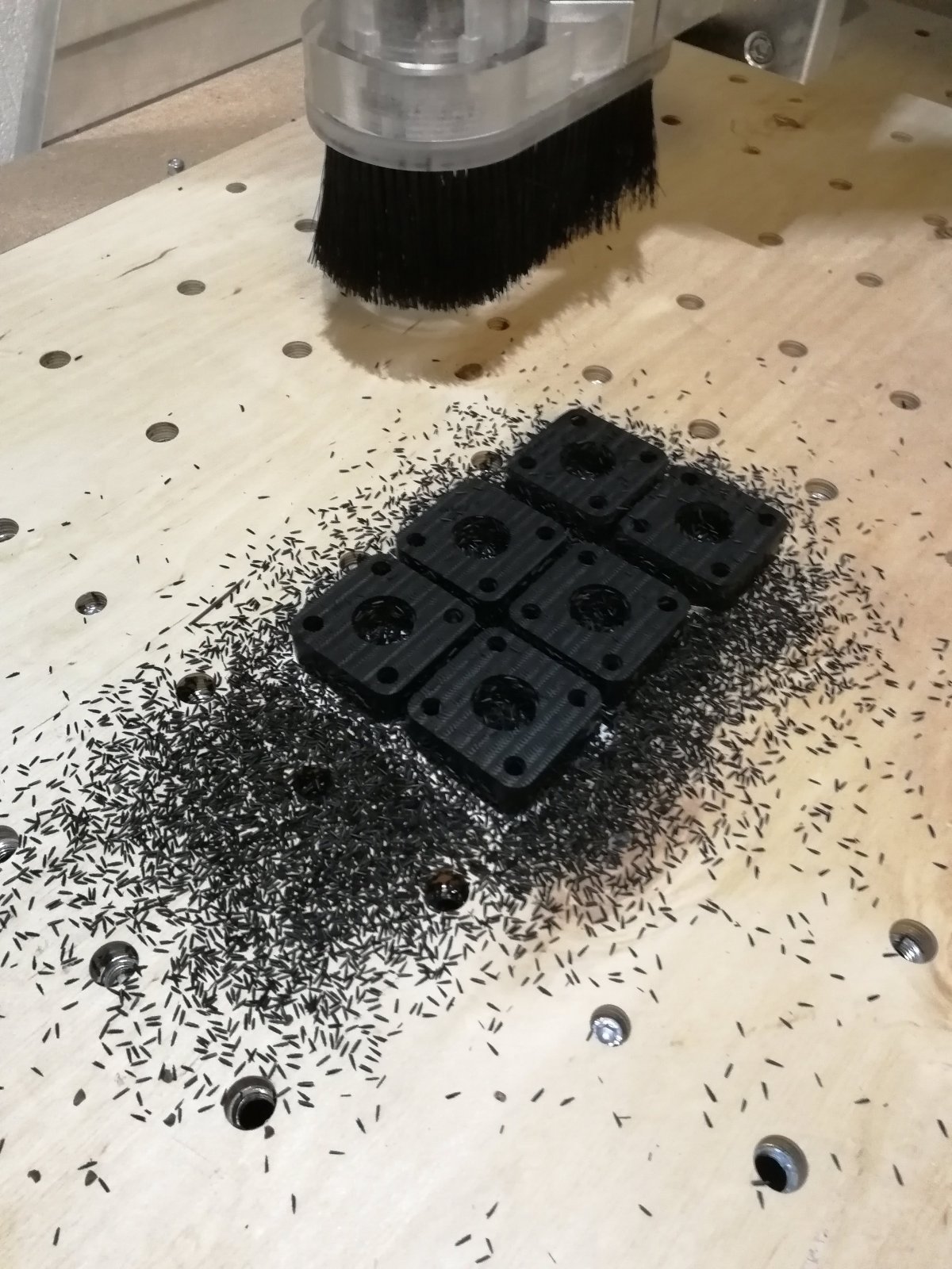

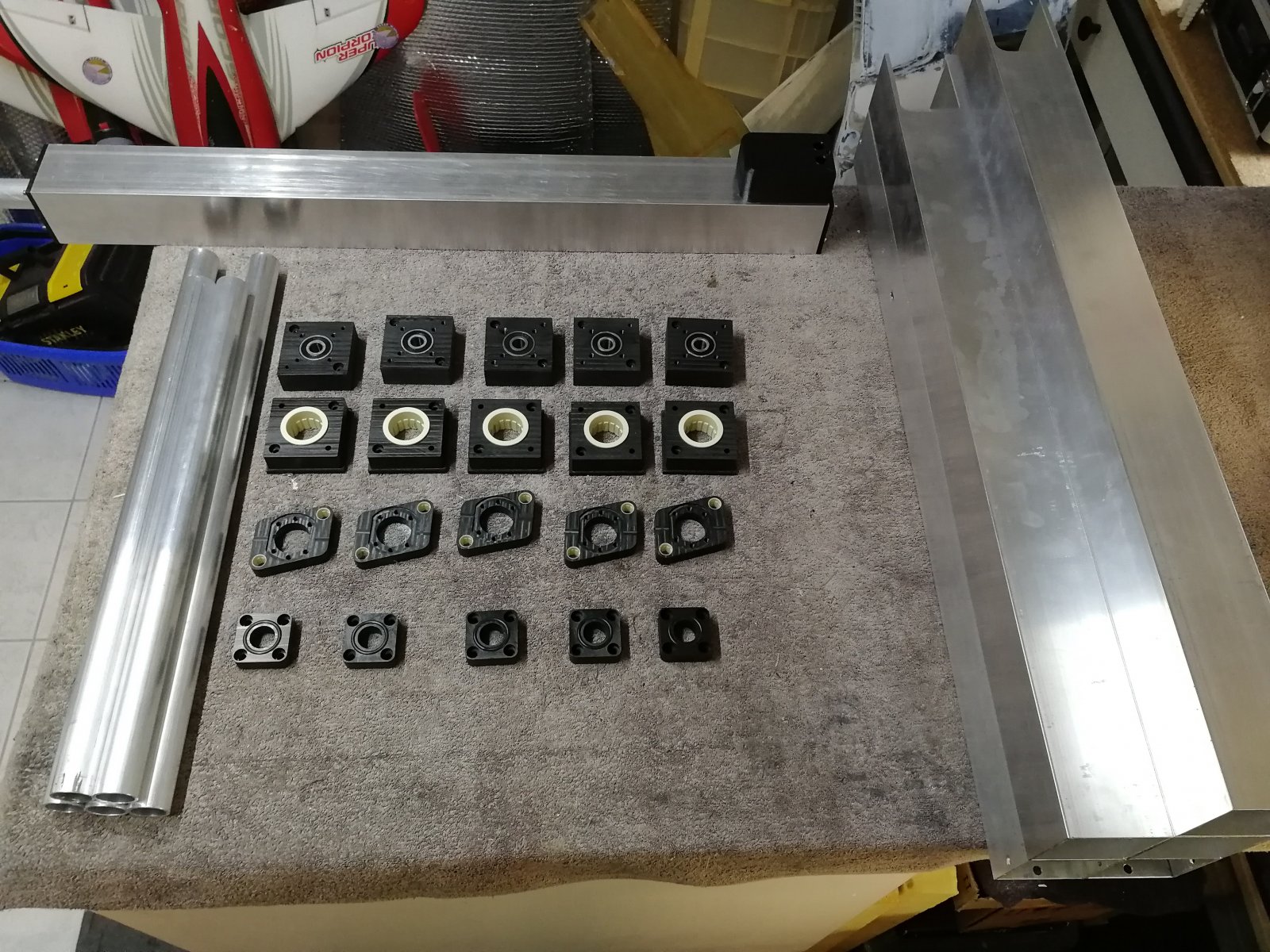

    Until now I have finished all six linear actuators and ordered some steel tubes to start the construction of the upper and bottom frame. The bottom frame will be made from 80x40x2 steel tubes and the upper frame from 30x30x2 steel tubes.

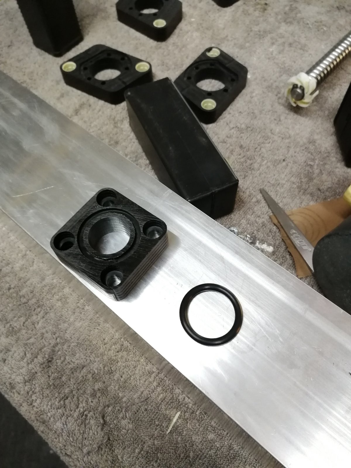

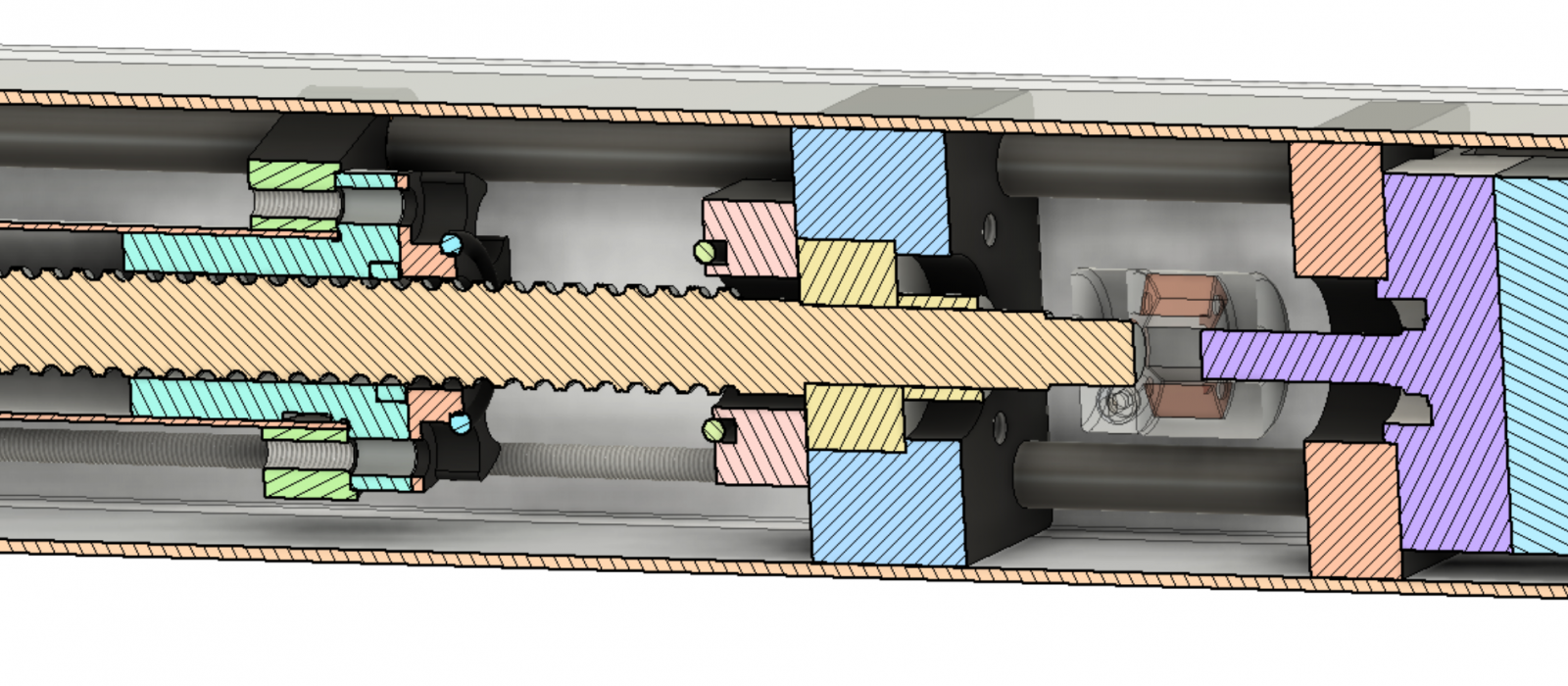

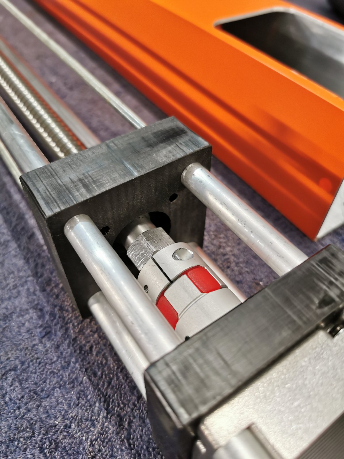

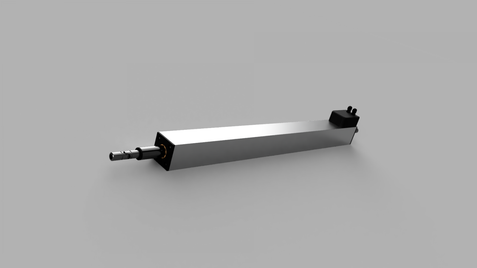

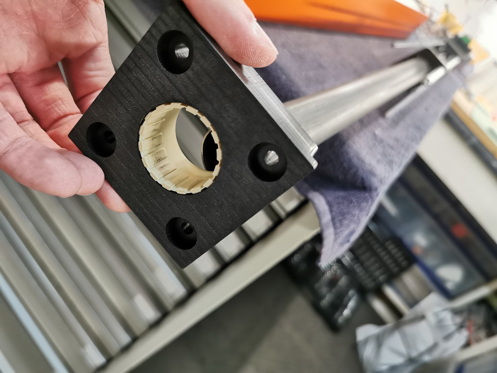

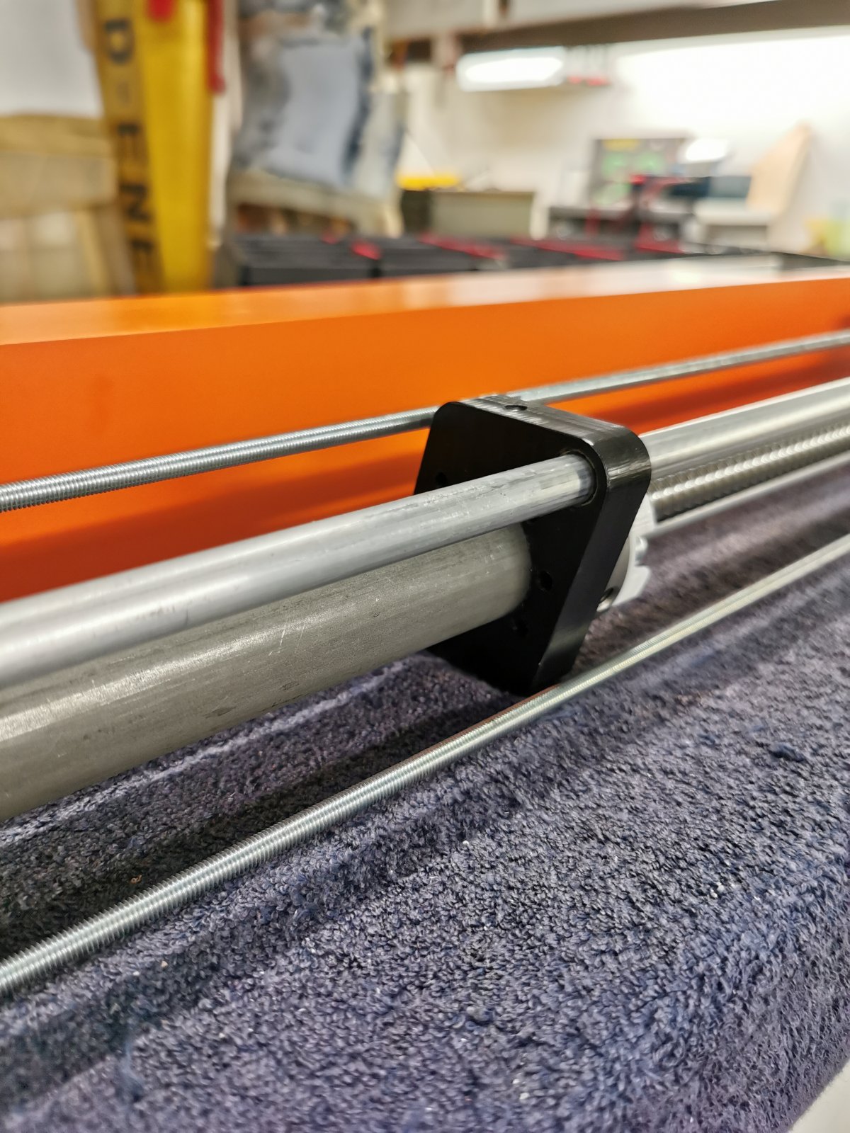

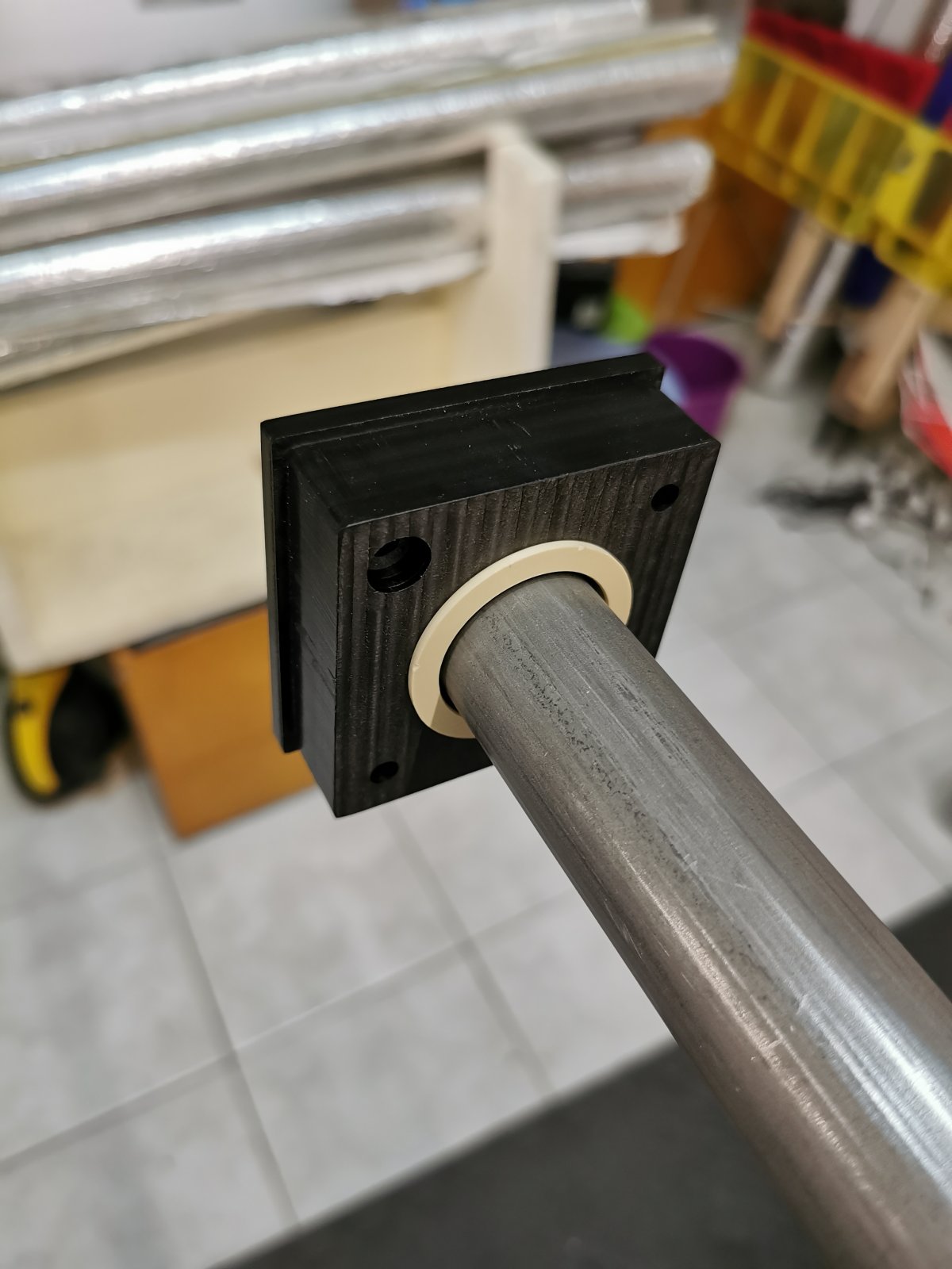

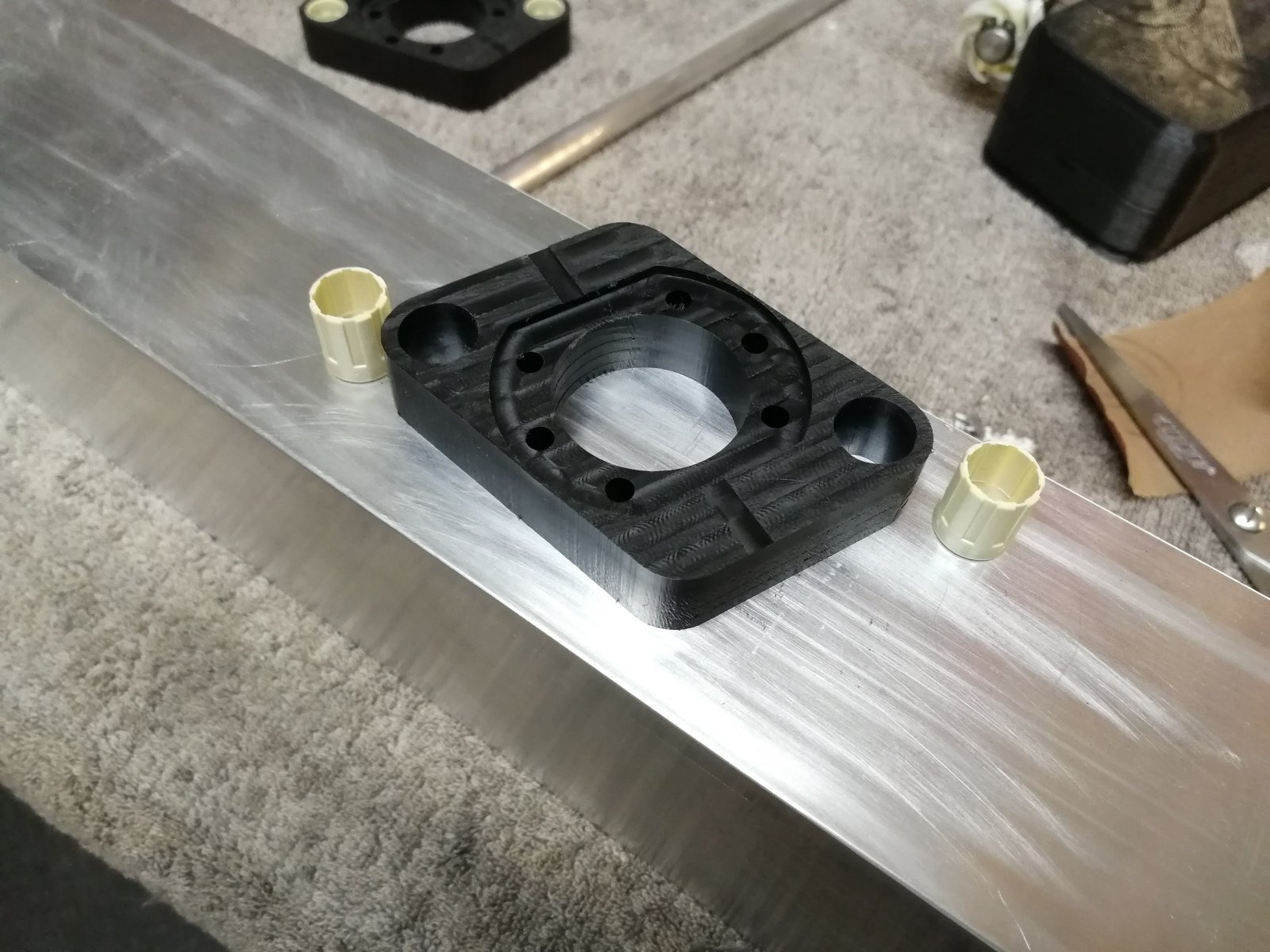

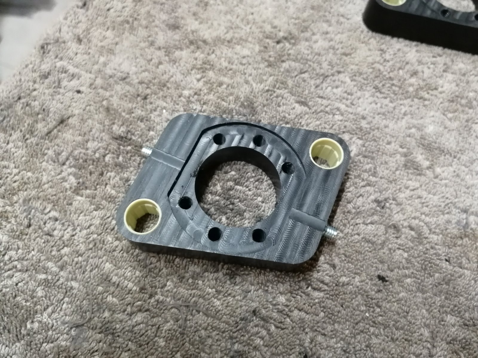

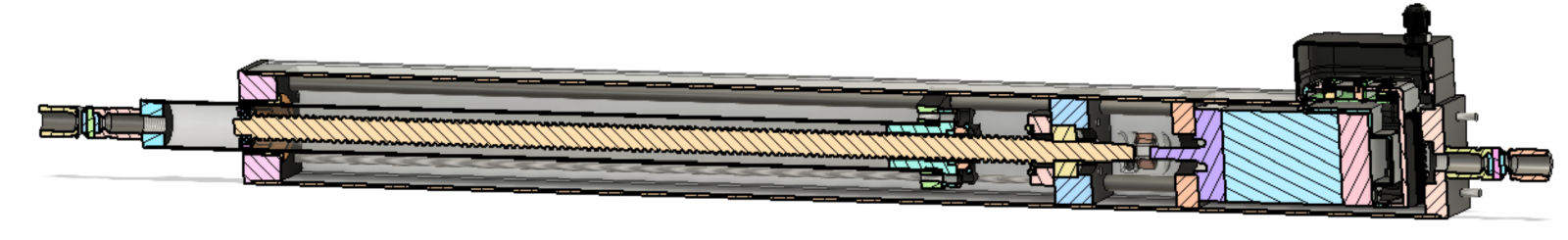

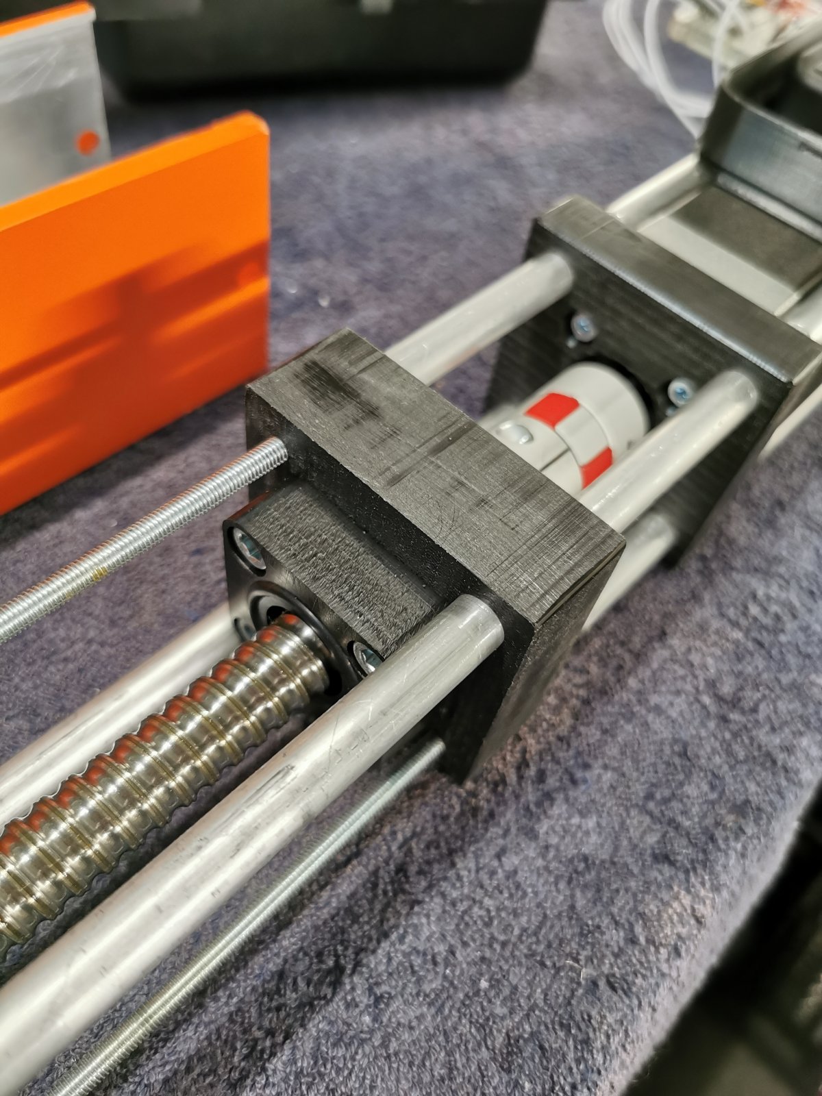

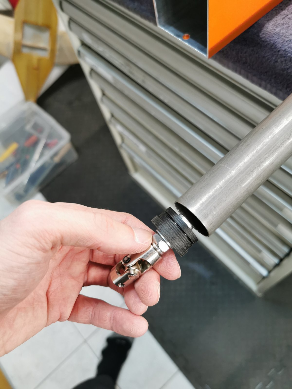

    The actuator housing is made from 70x70mm aluminum tubes while most plastic part are milled from POM. The rotary motion is transformed into lateral motion by a 1605 ballscrew. The pushrod is a 30x1 mm steel tube.

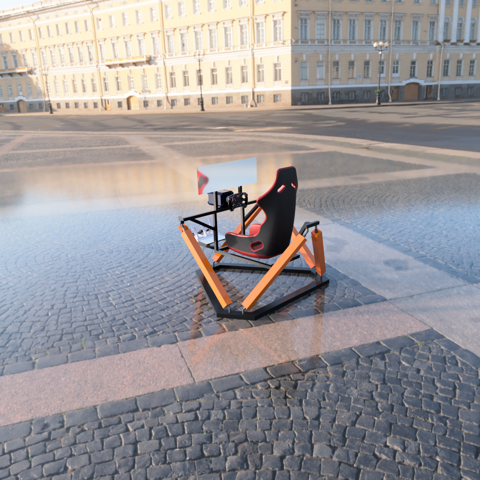

    The final simulator will look something like this:
    9d46654c-de67-4b6c-9c78-cc263d50932a.PNG Assembly_new_upper_2023-Feb-24_09-36-56PM-000_CustomizedView30228800524.png

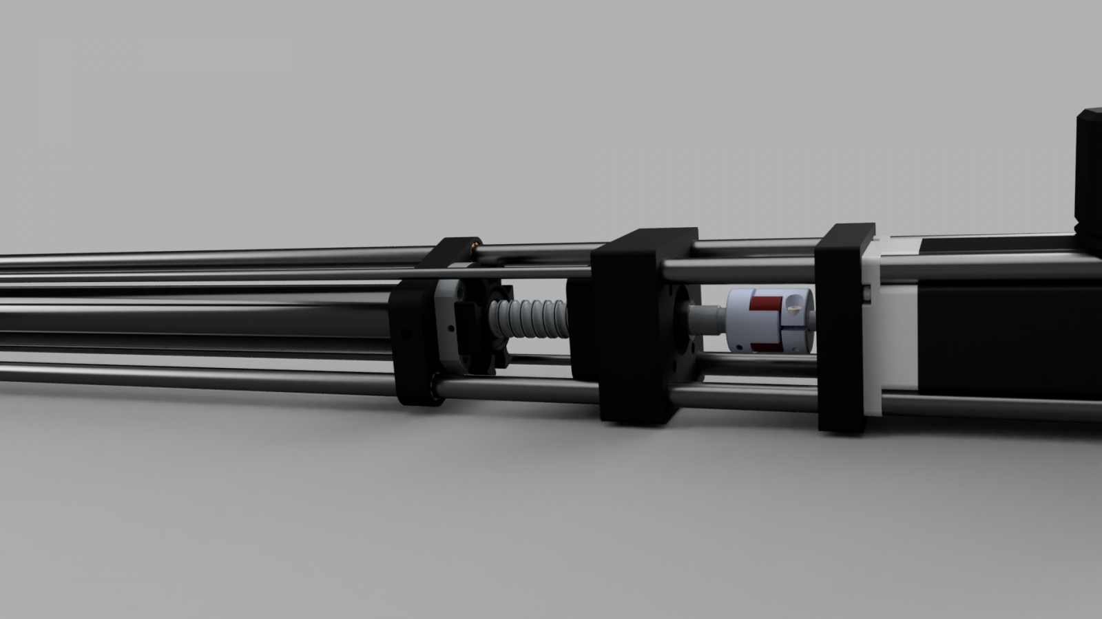

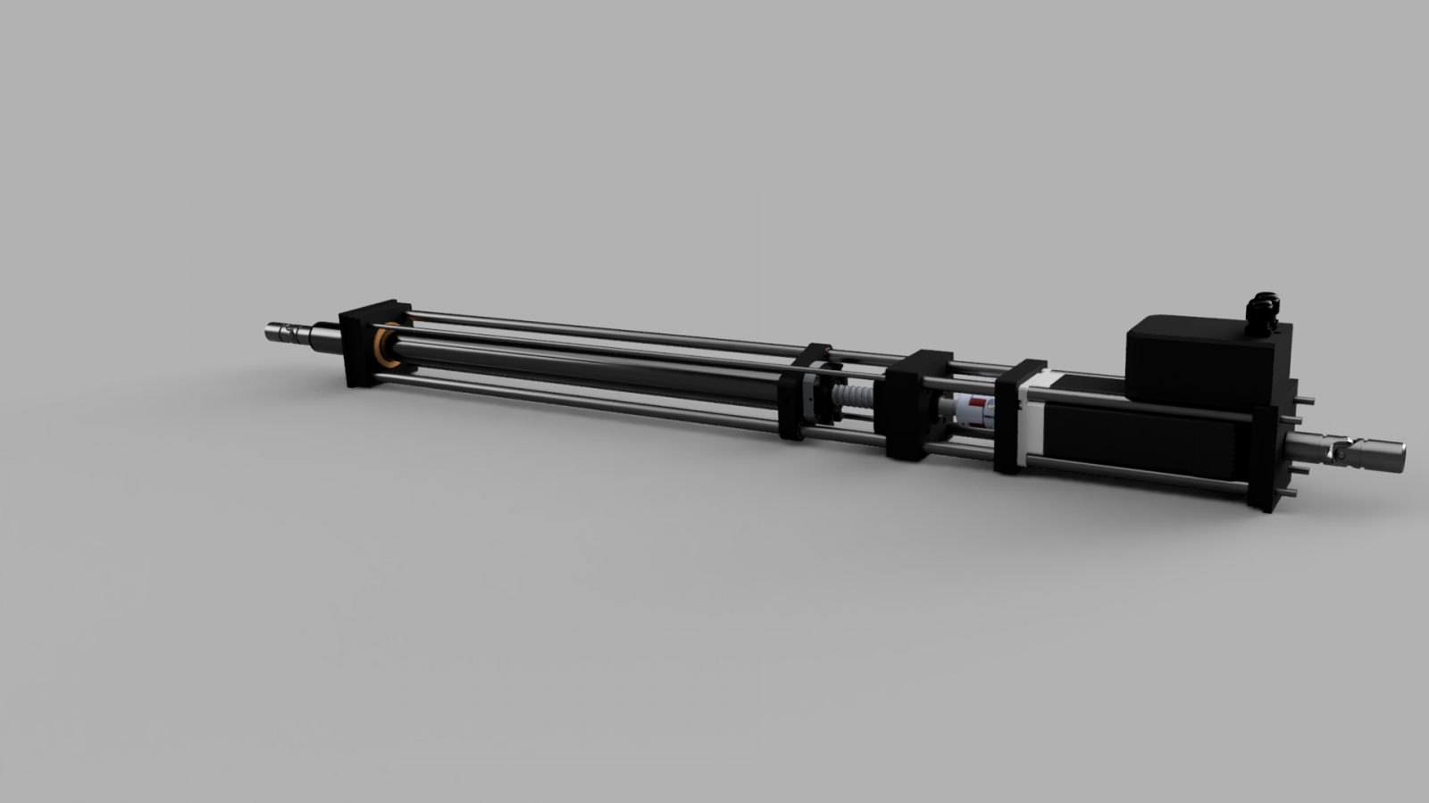

    The renderd actuator looks like this:
    Square_Linear_Actuator_Assembly_70x70_final_2023-Feb-24_09-46-49PM-000_CustomizedView5889932424.png Square_Linear_Actuator_Assembly_70x70_final_2023-Feb-24_09-45-05PM-000_CustomizedView10817719629.png Square_Linear_Actuator_Assembly_70x70_final_2023-Feb-24_09-45-46PM-000_CustomizedView27315113013.png Screenshot 2023-02-24 225035.png Screenshot 2023-02-24 225124.png Screenshot 2023-02-24 225155.png

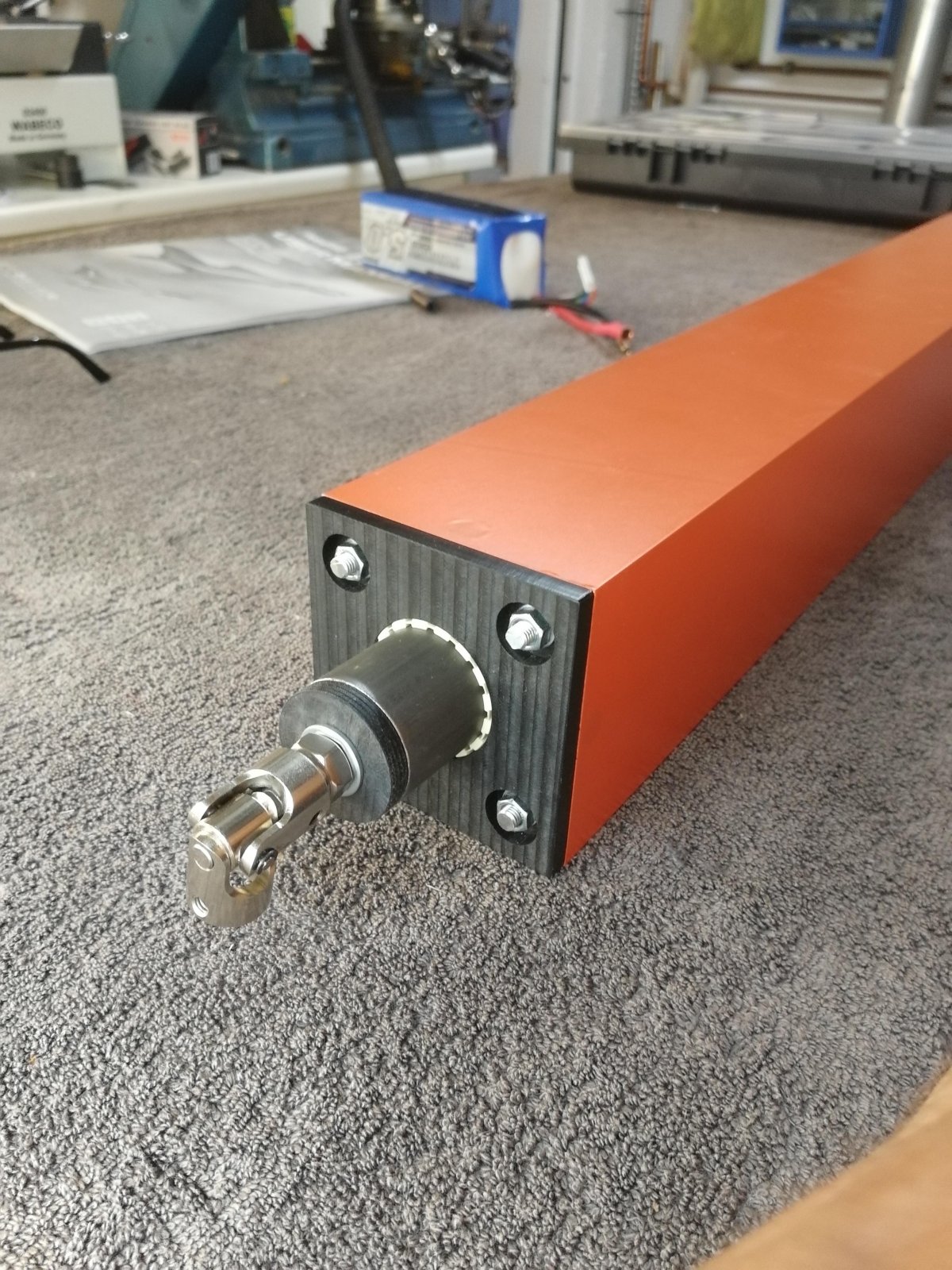

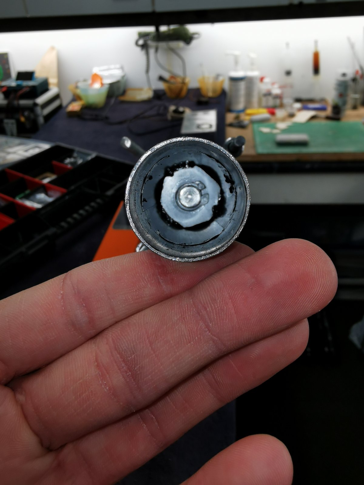

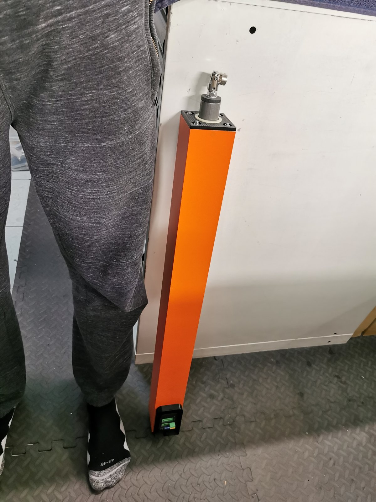

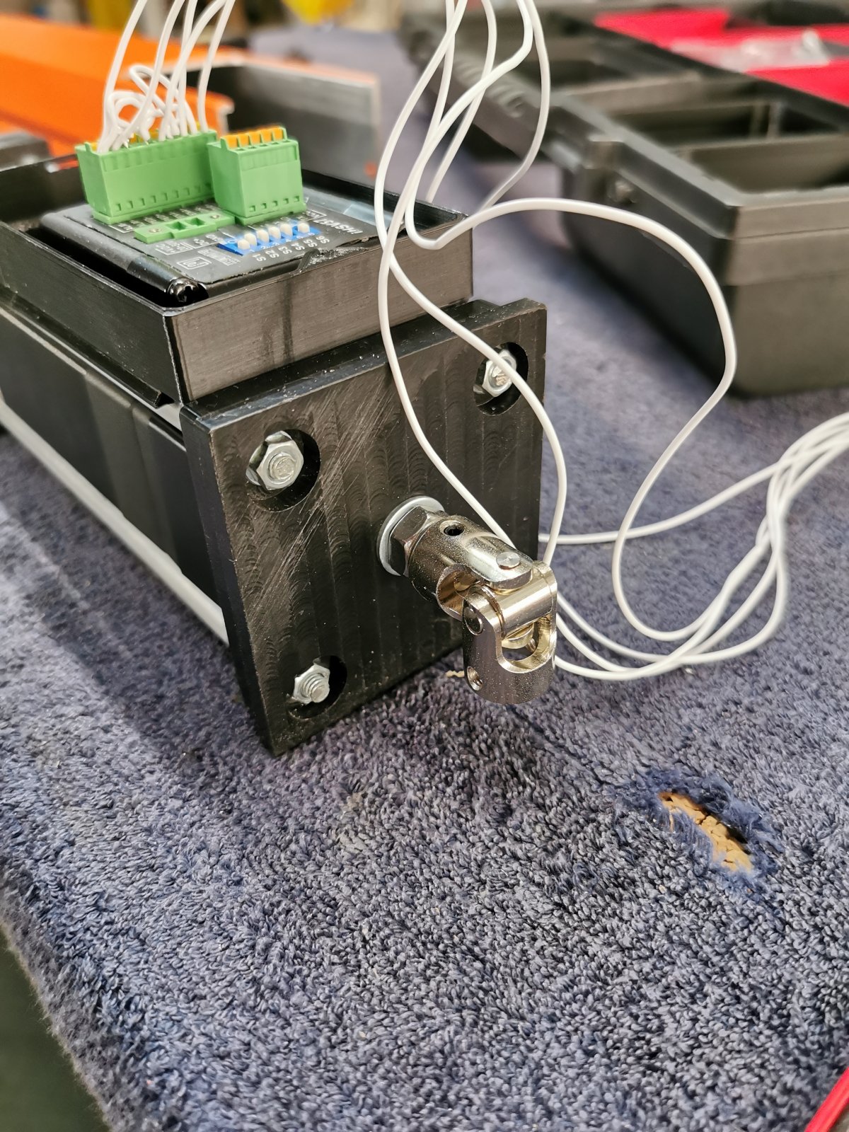

    And the real thing like this:
    Video - Testing the actuator
    Video - Testing the disassembled actuator

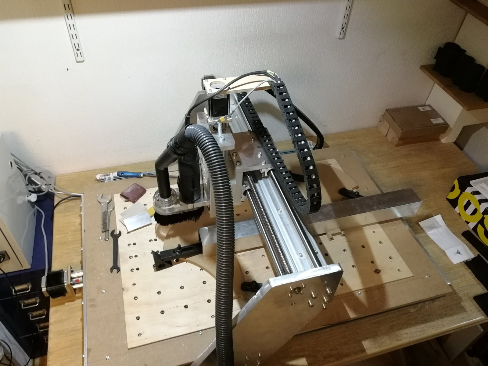

    IMG_20230224_202002.jpg IMG_20230224_195439.jpg IMG_20230224_195617.jpg IMG_20230224_195629.jpg IMG_20230224_195350.jpg IMG_20230224_200327.jpg IMG_20230224_200332.jpg IMG_20230224_195015.jpg IMG_20230224_195021.jpg IMG_20230224_195028.jpg IMG_20230224_195036.jpg IMG_20230224_195114.jpg IMG_20230224_195131.jpg IMG_20230224_194948.jpg IMG_20230224_195003.jpg IMG_20230224_194955.jpg IMG_20210821_164113.jpg IMG_20210813_174612.jpg IMG_20210821_164051.jpg IMG_20210116_162041.jpg IMG_20210116_163808.jpg IMG_20210116_211743.jpg IMG_20210821_164120.jpg IMG_20230224_200315.jpg IMG_20210106_193025.jpg IMG_20230224_201952.jpg IMG_20230224_195054.jpg

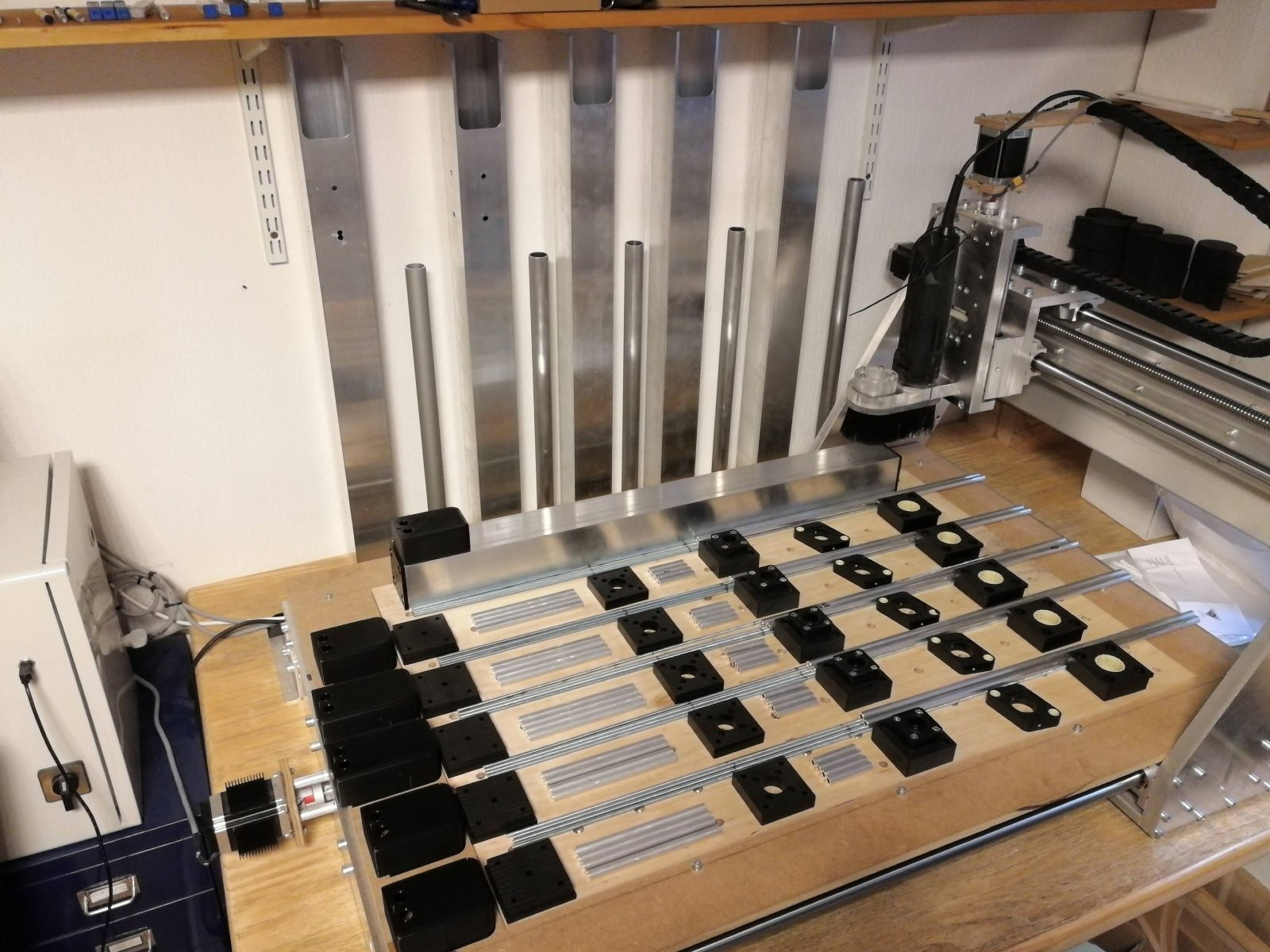

    Here are some pictures of the series production ;):
    IMG_20210815_194359.jpg IMG_20210116_131128.jpg IMG_20210116_205116.jpg IMG_20210120_162204.jpg IMG_20210116_155805.jpg
    That is all i have for now :)

    I tried to lift myself with one of my actuators (75kg). It was able to lift me, but sometimes it cut of. However, I think it will be okay, as I have six of them.

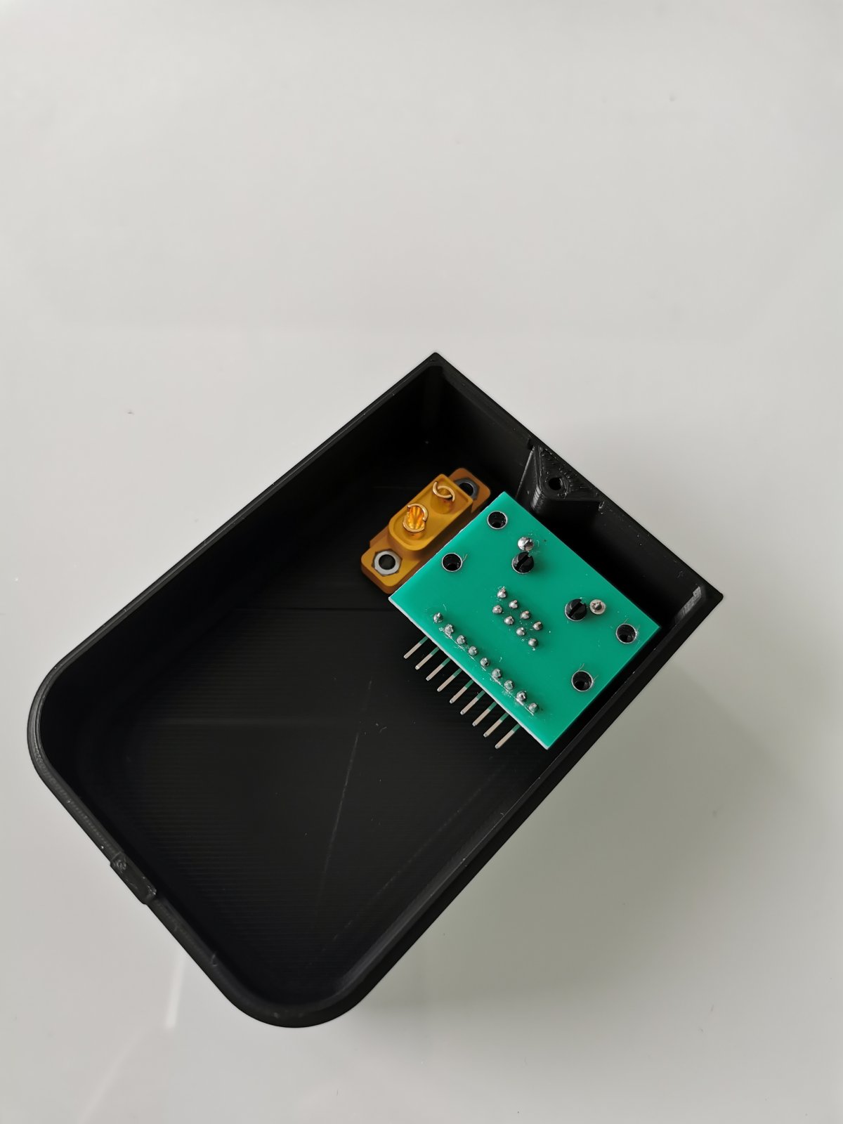

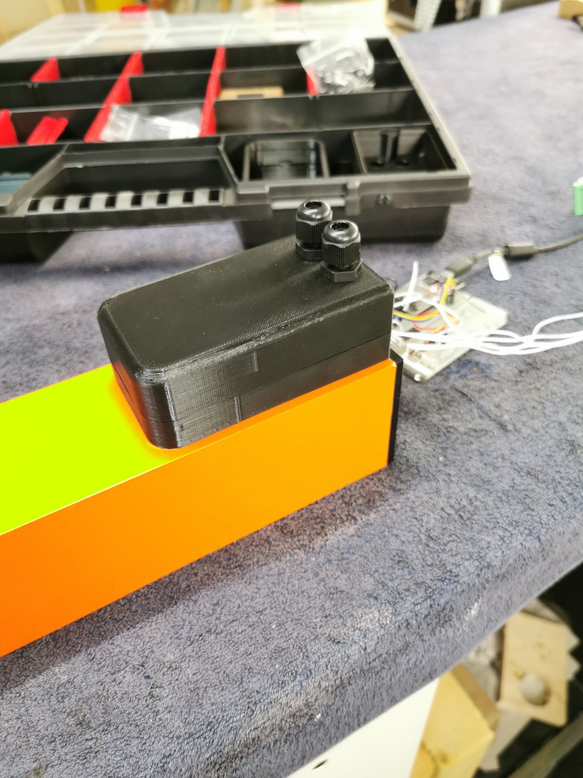

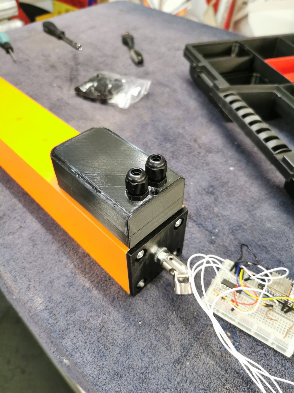

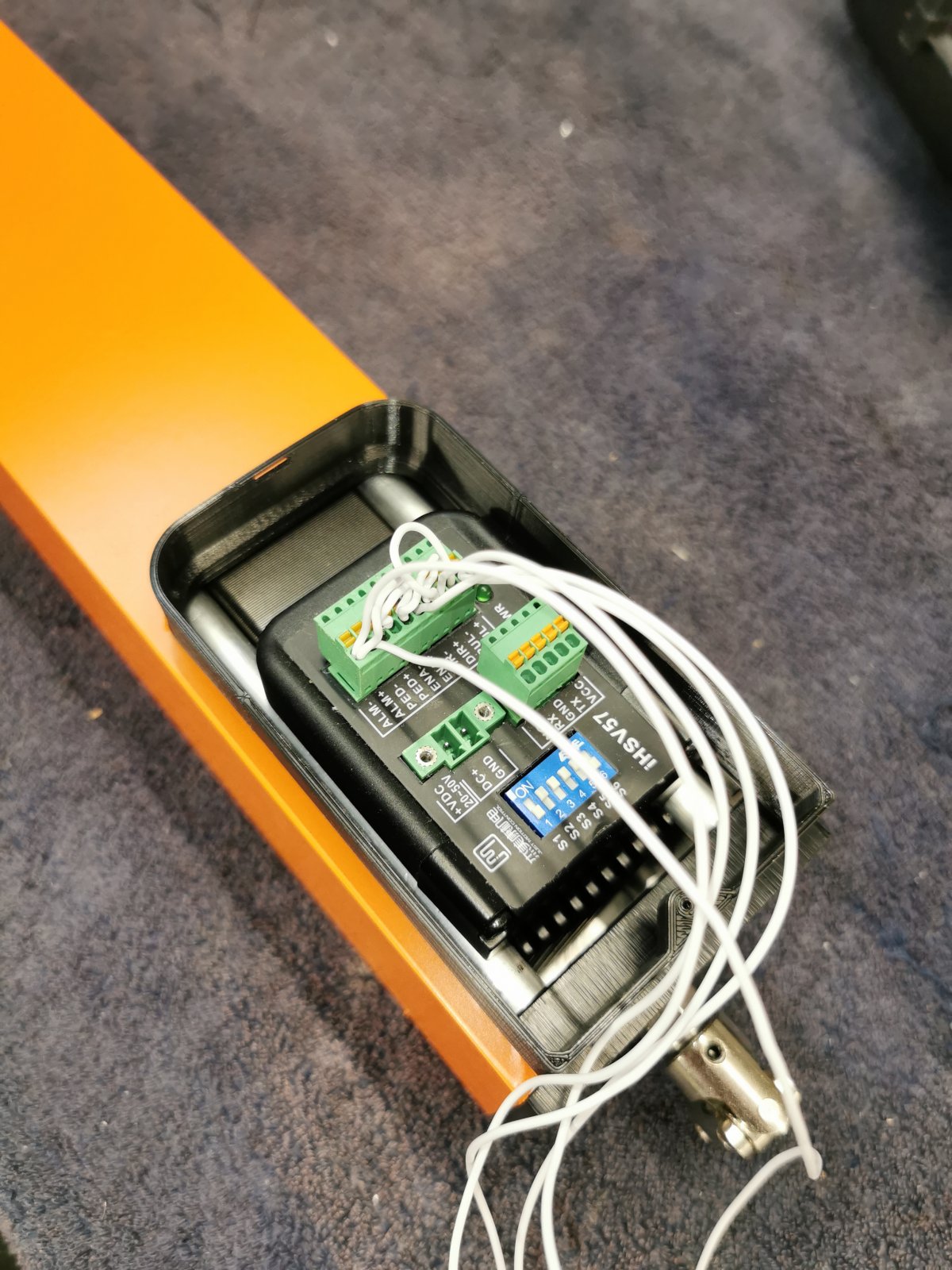

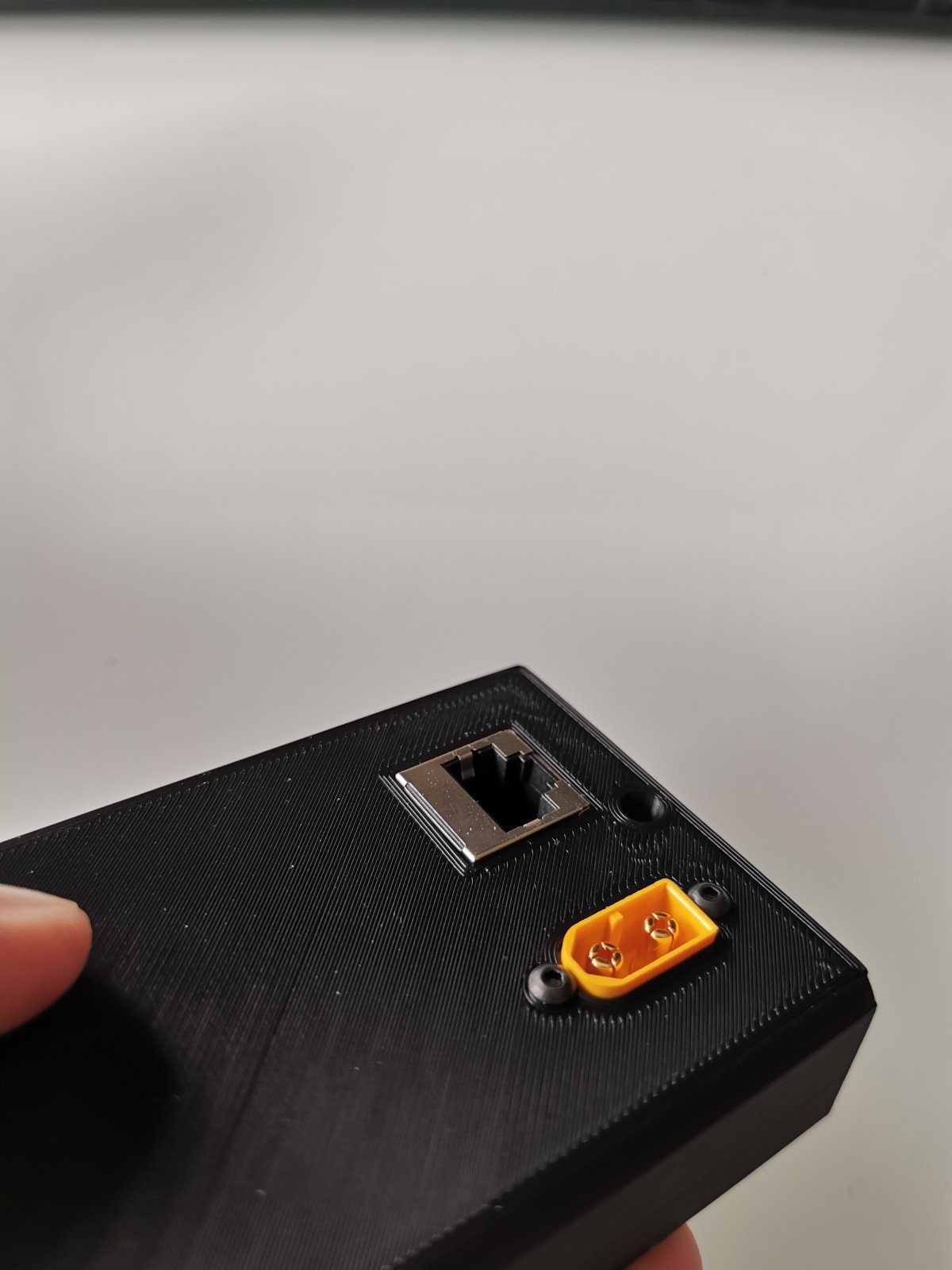

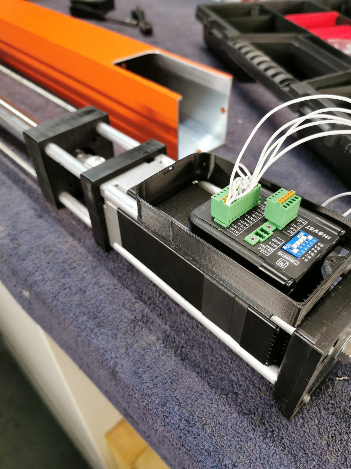

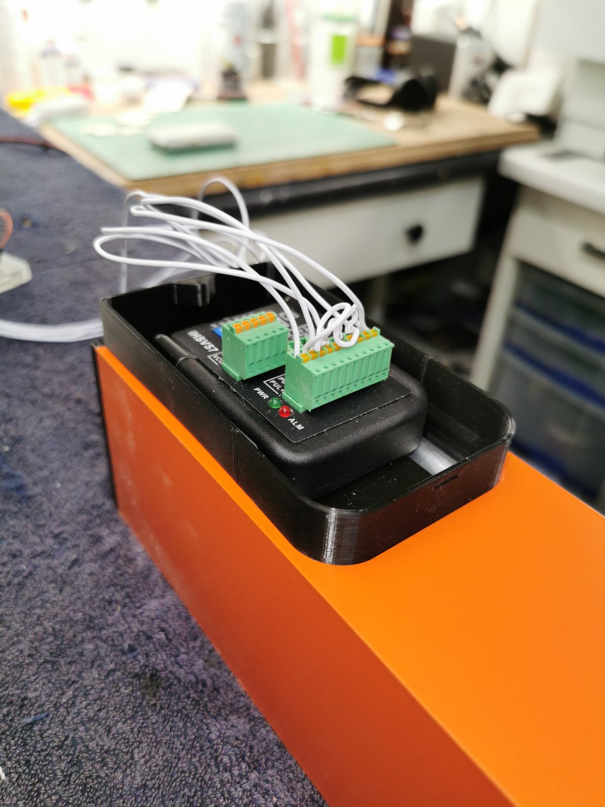

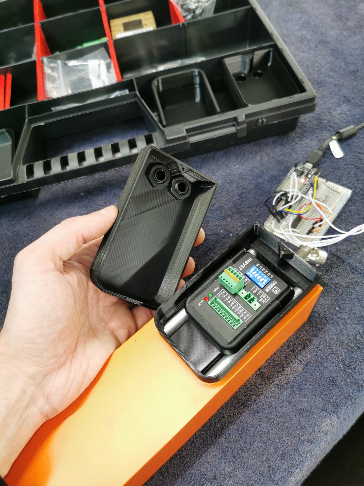

    However, there is a little bit of progress. I desided that I would like to connect my actuator with RJ-45 LAN Cable so I bought RJ-45 Breakout Boards and modified my Motor caps. I still need to wire and assemble it.
