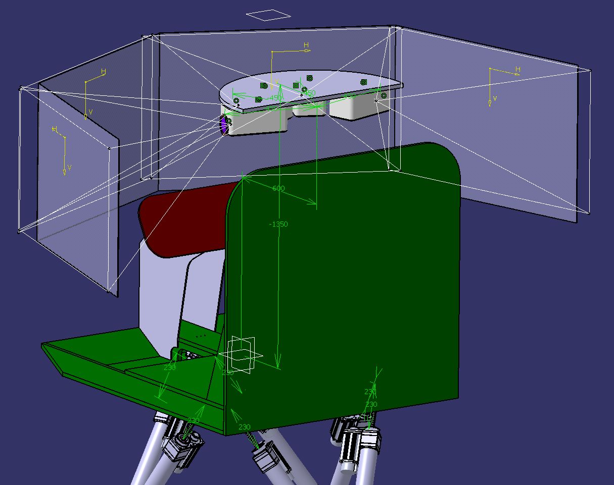

    Ok, I think I have found an acceptable layout.:thumbs
    The projection areas overlap a bit which leaves some reserve for adjustments. The light beams do not interfere with the pilot's head or the dashboard. I even have some headroom to the ceiling when the actuators are fully extended.
    However, this excludes the installation of an overhead panel. It would have to be mounted above the projector level and would be out of (comfortable) reach. Manipulating switches on it would throw shadows. Bad luck but no desaster. You can't have everything.
    Good question. There is no technical data available. I had to measure it. The amp meter of my workbench supply shows 0.5A at 220V. That's 110W. So a total of 440W should be manageable if I add some ventilation.

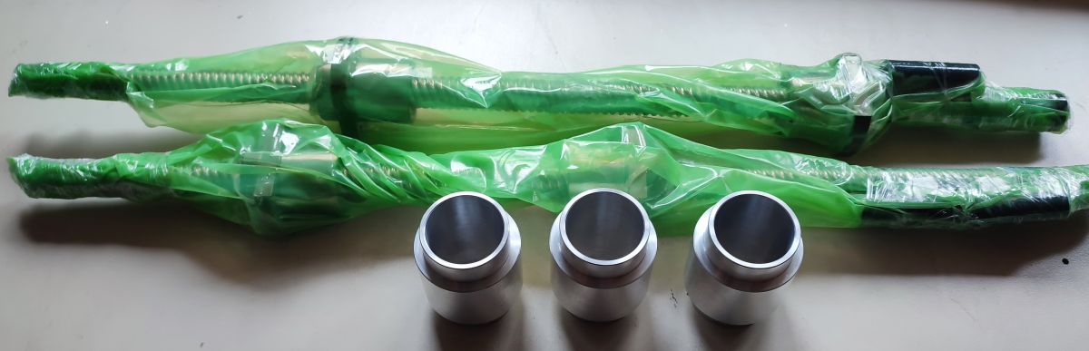

    Unfortunatelly, I have been very busy almost all the time since the Xmas holiday. There was almost no progress with my project. At least, the actuators were finished ... errr, almost. I mean 11 out of 12 so we could finish Sven's rig. But one of the actuators still has problems with the ball screw. One of the ball nuts seized inside the bushing. I had to heat it to get it disassembled but this damaged the wiper rubbers and the balls spilled on the floor.:eek::oops:
    I had no patience to repair it so I ordered two new screws and 3 bushings.
    They have arrived today so I no longer have any excuses.:D
