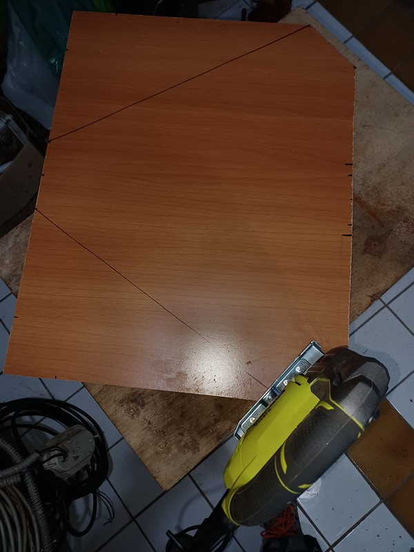

    Since in quarantine I can not go and get the material to assemble everything, today I had so much fun .......

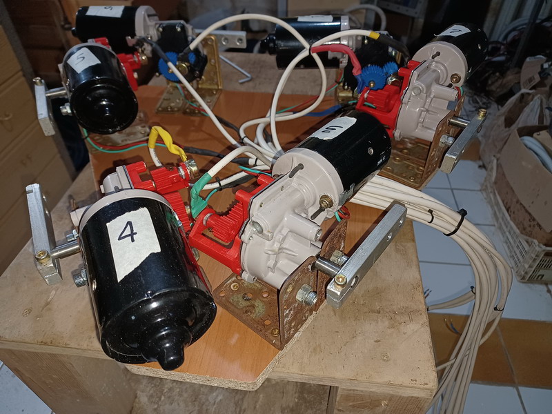

    After cutting the lower platform, I mounted the motors with metal "L" brackets, a little "delicate" but to test they are just fine.

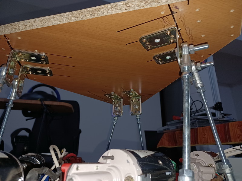

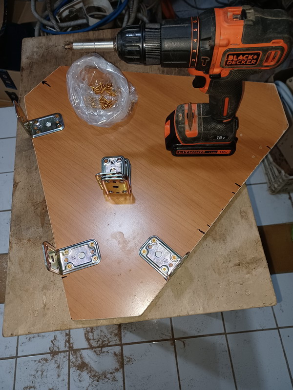

    Once the engines and engine levers were mounted, I cut the upper platform and mounted "L" -shaped metal plates to fix the tie rods

    Finished assembling the lower platform I coupled the parts
  8. SteULM
    SteULM Active Member
    Nov 13, 2021
    225
    Alla ricerca di cose nuove da imparare.
    613Coins
    +149 / 0 / -0
    5_posizione corretta tiranti.jpg After the first tests I realized that the tie rods mounted in that way were not going well and therefore I modified the arrangement of the metal plates and reassembled everything.

    Here everything is reassembled correctly ....

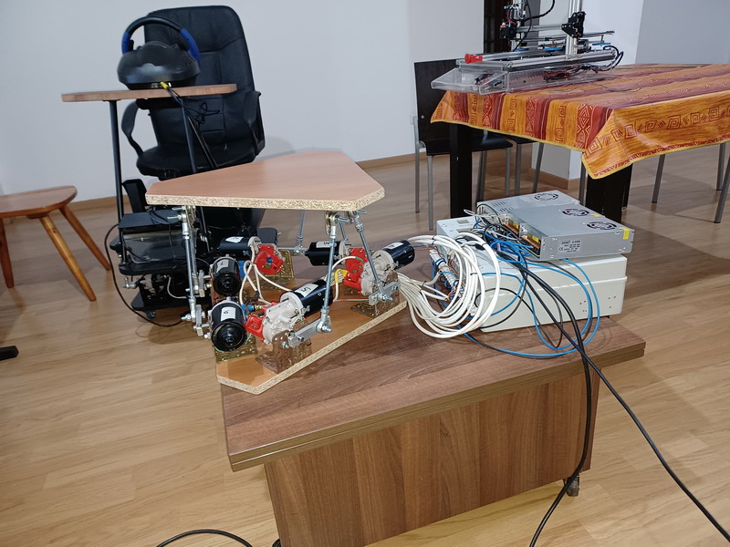

    First setup and first "download" test with NoLimits2

    and test under load with my official test driver, my princess ....

    Everything is working with the 12V IBT-2

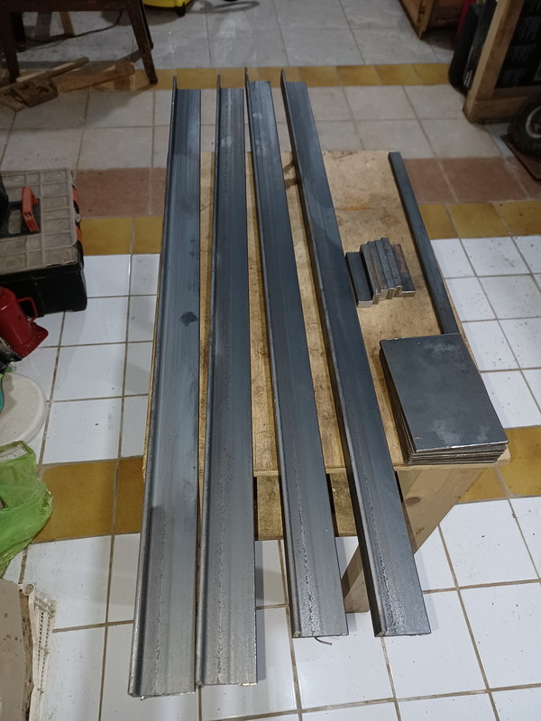

    Quarantine finished, I went to get some iron and cut it off.

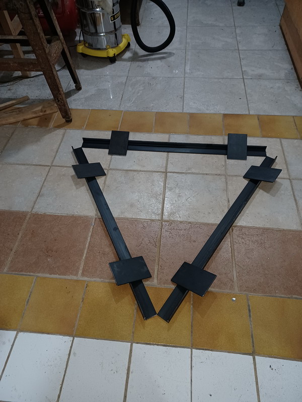

    This is what it should come up with if I can solder ...

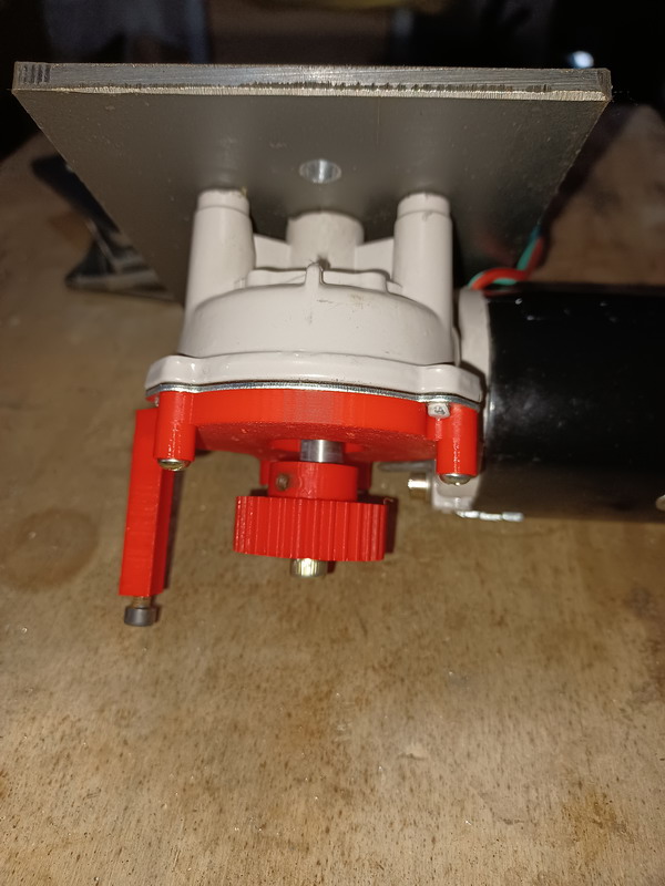

    After lunch I prepare the engine keys because they are made of aluminum and are too soft and slip with the loaded weight.
  17. SteULM
    Nov 13, 2021
    225
    613Coins
    +149 / 0 / -0

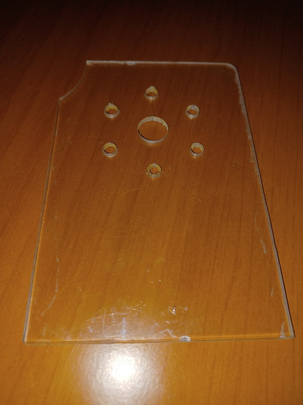

    Finished motor keys, I cut a template for the motors on a piece of acrylic on the CNC and tomorrow I start drilling the motor plates.

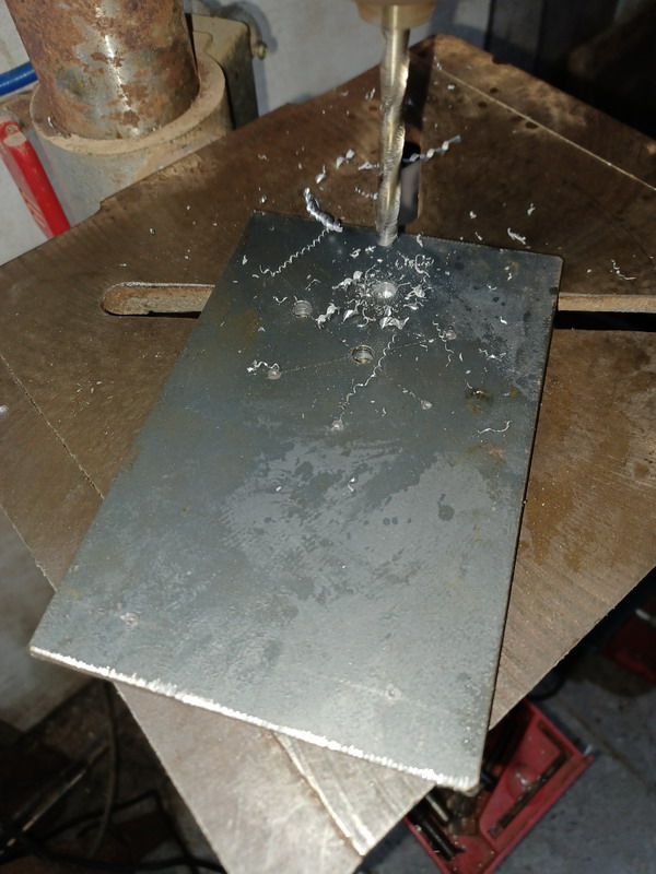

    Today I started drilling the engine plates ...

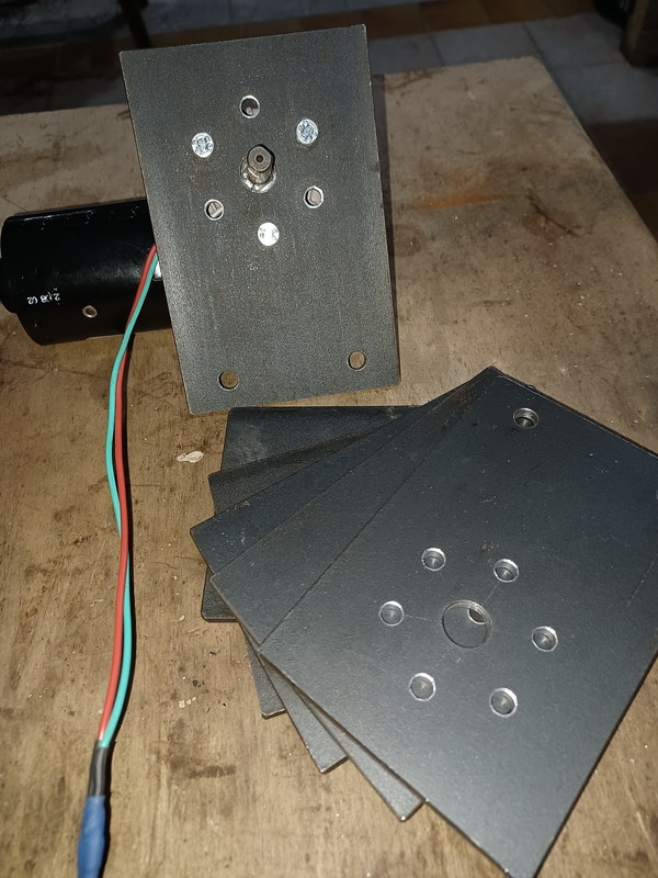

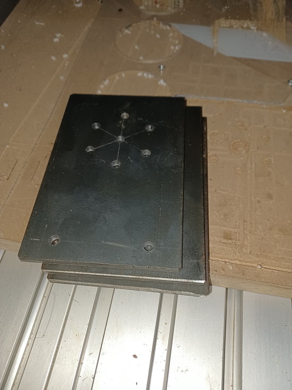

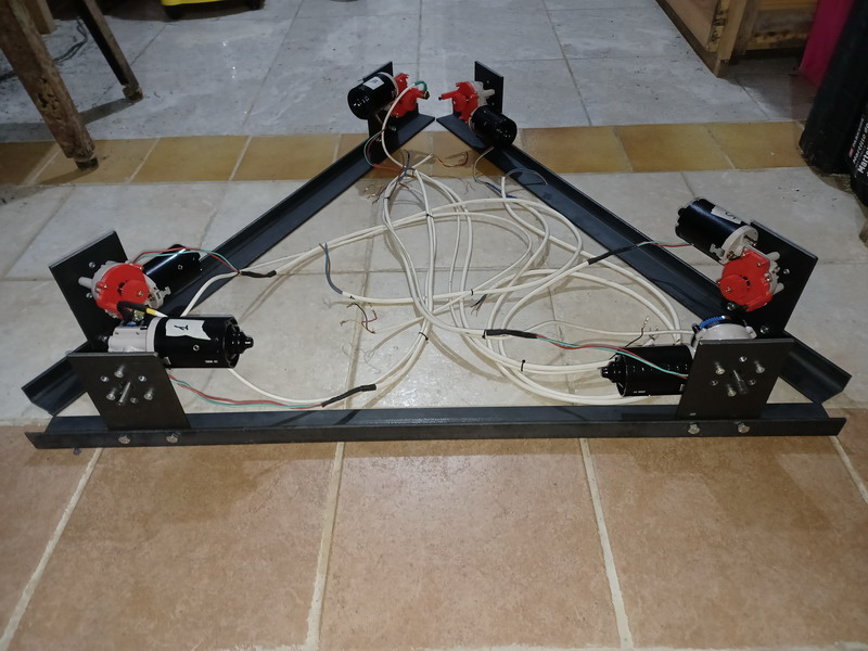

    And I finished them and tried the correct assembly with the motors

    then I drilled the bottom frame and tried to install everything before welding
