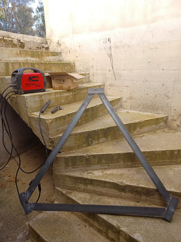

    Finished the welding phase of the base

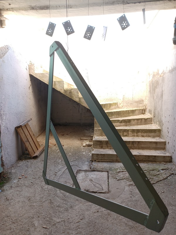

    Given the first painting with an anti-rust primer on the base and motor plates, tomorrow I'll move on to painting.

  3. RacingMat
    2,233
    21,082Coins
    Good project!
    Try to improve your welding skills ;)
    it's really advised to grind the welds: you can check if it's really fused (you may be surprised! it's often not really fused. The bumps we see are not a good omen.)
    And it's more beautiful.
  4. SteULM
    SteULM Active Member
    Nov 13, 2021
    226
    Alla ricerca di cose nuove da imparare.
    601Coins
    +149 / 0 / -0
    :grin:grin:grin
    Hi Racingmat, I thought I couldn't even do it, it's my first time with the welding machine. Let's hope it holds up ...
  5. SteULM
    Nov 13, 2021
    226
    601Coins
    +149 / 0 / -0
    However with the hammer I beat the welds once finished following the tutorials and it seems to hold.
  6. SteULM
    Nov 13, 2021
    226
    601Coins
    +149 / 0 / -0
    Tomorrow I put on a first coat of paint and once it is dry I try to mount the plates with the motors

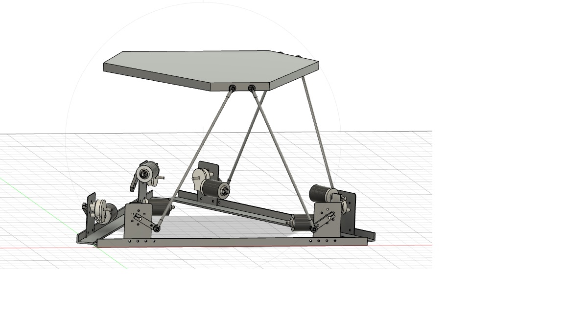

    Now I am calculating the dimensions of the upper base in the CAD to see how I can insert the seat with the accessories

  8. Keith
    Keith Active Member
    Jan 21, 2020
    179
    Electrician
    Canada, Saskatchewan
    154Coins
    +83 / 0 / -0
    Hey Steulm. I look forward to hearing how this works for you. How did you decide on 40mm/60mm levers? Is that what your 2dof used?
    Project is looking great so far!
  9. SteULM
    Nov 13, 2021
    226
    601Coins
    +149 / 0 / -0
    Hi Keith thanks, you are the same levers. They have two positions at 50mm and 70mm from the motor shaft.

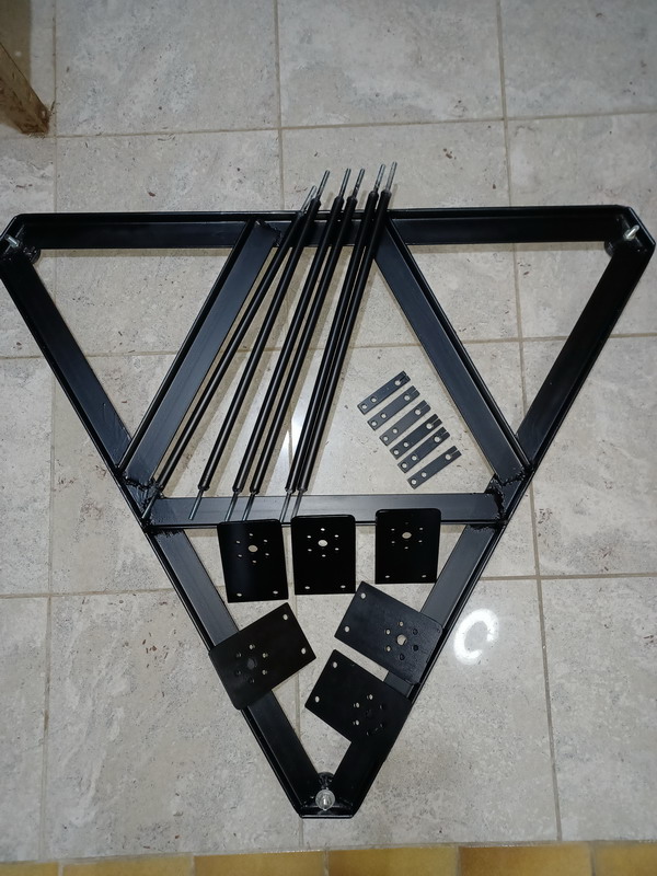

  10. SteULM
    Nov 13, 2021
    226
    601Coins
    +149 / 0 / -0
    Today I prepared everything after the painting, tomorrow I start the assembly.

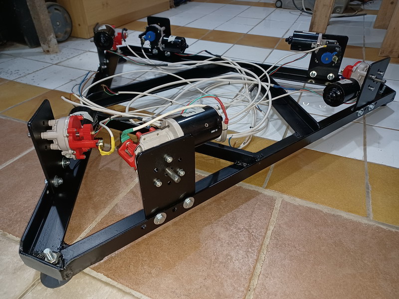

  11. SteULM
    Nov 13, 2021
    226
    601Coins
    +149 / 0 / -0
    Today I started assembling the parts, let's see where I arrive ...
  12. SteULM
    Nov 13, 2021
    226
    601Coins
    +149 / 0 / -0
    Completed the assembly of the motors

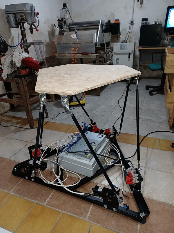

  15. SteULM
    Nov 13, 2021
    226
    601Coins
    +149 / 0 / -0
    Here, I finished assembling everything, I cut a piece of plywood to test if everything works and then I will decide how to obtain the upper platform
  16. Keith
    Keith Active Member
    Jan 21, 2020
    179
    Electrician
    154Coins
    +83 / 0 / -0
    You work fast. Have you tested it yet?
  17. SteULM
    Nov 13, 2021
    226
    601Coins
    +149 / 0 / -0
    Yes, I connected everything and calibrated the motors with SMC3. I'm finishing the setup on Simtools but today and tomorrow I have to wire an ethernet network in a studio so I'm still.
  18. Chris_Beeves
    May 31, 2019
    375
    2,165Coins
    +259 / 4 / -0
    Awesome build!
    Is there any specific reason why you want the connecting rods that long? I'd try to keep them as short as possible for stability.
  19. SteULM
    Nov 13, 2021
    226
    601Coins
    +149 / 0 / -0
    Yes Chris thank you, once mounted I realized that 500mm is too much ...
    As soon as possible I try to change to 350/400mm.
  20. Chris_Beeves
    May 31, 2019
    375
    2,165Coins
    +259 / 4 / -0
    Cool! Out of curiosity, why not less? Is that the minimum?
