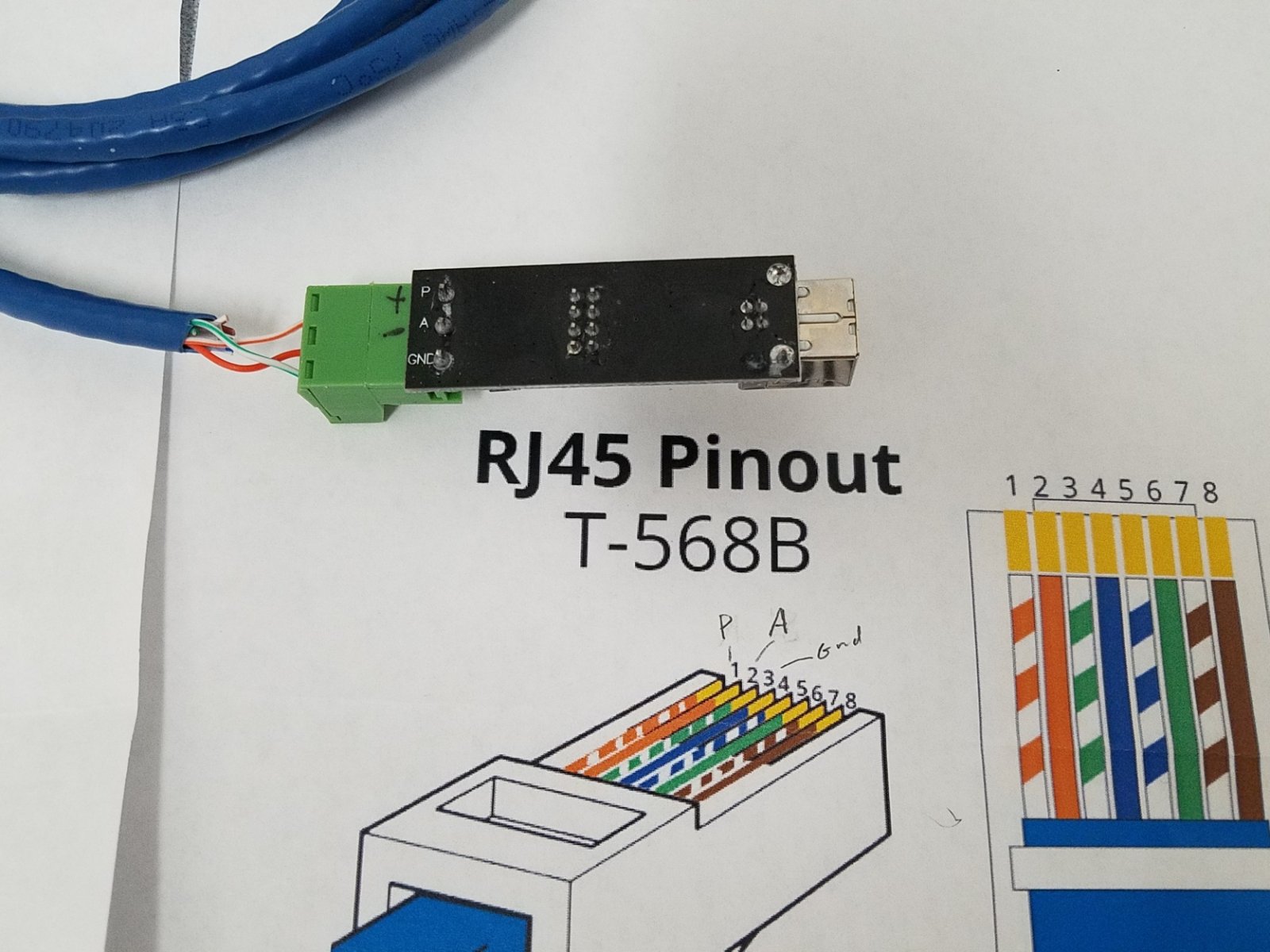

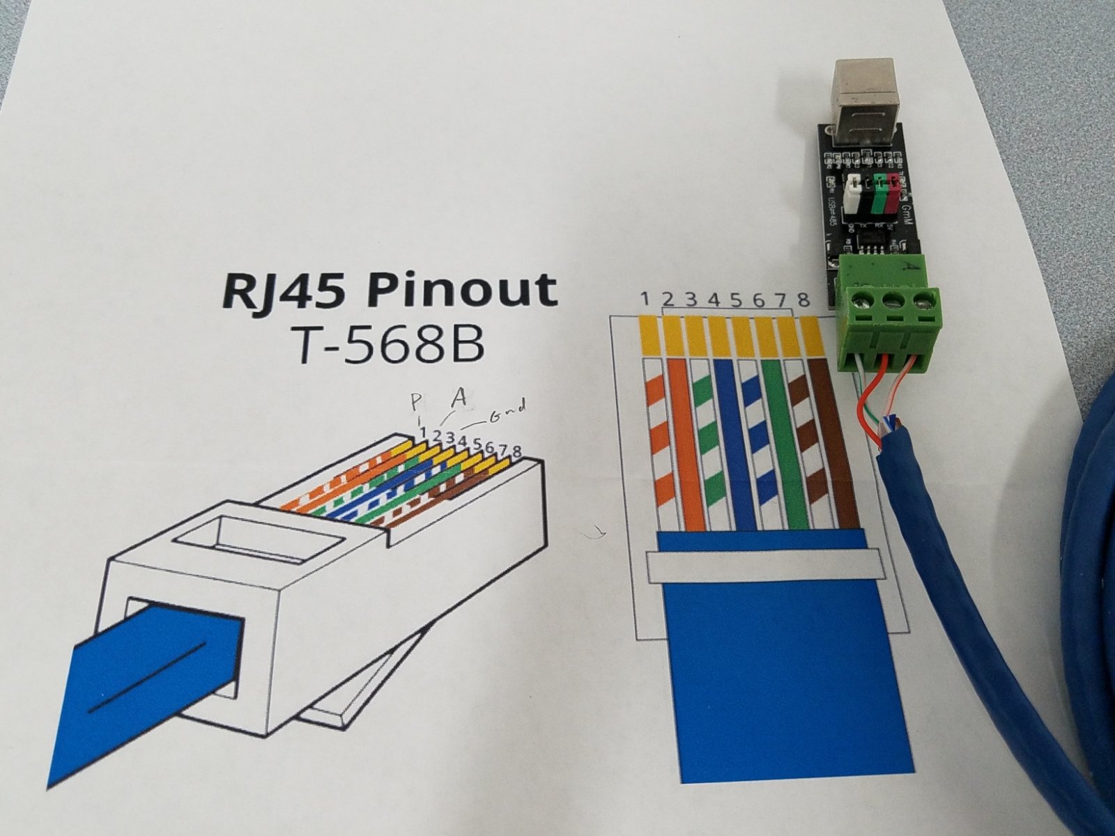

    On almost all Dorna drives, there is RS485 connector that can be used to change the parameters of the drive via the DORWIN software:
    Download the software from here:
    http://www.newtech.pk/down/DorWin-Commissioning-Software.rar
    You will need to make a cable for the Dorna drive using a lan cable (cut in half) and a USBtoRS485 adapter:
    Link to a tested adapter:
    https://www.ebay.com/itm/Usb-To-RS4...75176-Serial-Converter-New-Ic-vm/223132033566

    Ok, it does have rs485, its on pins 16 and 17 of the CN2 connector.
    Pin 16 - rs485 positive
    Pin 17 - rs485 negative
  9. Denus304
    Denus304 Member
    Jul 17, 2018
    74
    600Coins
    +9 / 0 / -0

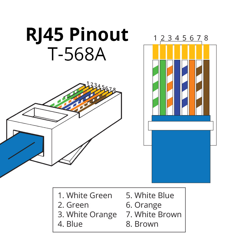

    Ok thats great but where would i buy the T-568B board ?

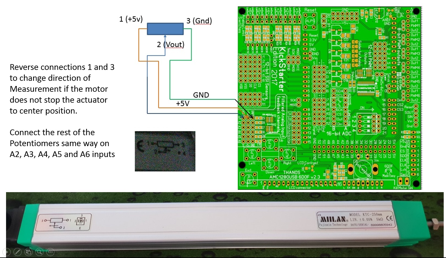

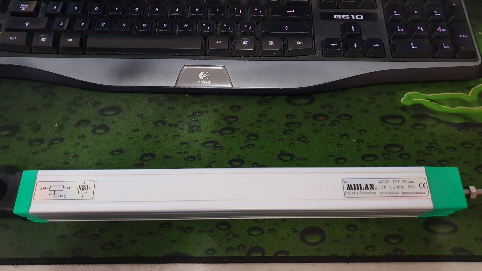

    Here is a photo of the potentiometers i purchased, from what i gathered they are the same as the 150mm novotechnik models i have.
    The wiring code looks the same.
    I also wouldn't mind using a different way of connecting the wires to the amc1280, the current way i have them connected does not seem very secure. Is there some sort of jumper block where i can use screw terminals?

    On the back is this label too, after comparing it also seems like the 1 and 3 wires are reversed?

    This is the data that the supplier had given me originally :
    Model Number-------------------KTC-250MM
    Supply Voltage-------------------Output voltage: 0-10V
    Voltage-------------------Power supply voltage: 24V
    Linear range: 225mm
    Resistance value: 5000 ohms
    Resistance tolerance 0.5%
    Protection level: 67
    Linearity: 1.0~0.1 (%F.S)
    Hysteresis: 0.01 (%F.S)
    Repeatability: 1000 (%F.S)
    Sensitivity: 100
    Resolution: 10000
    Hope this helps and is the correct ones :)
  17. Thanos
    Jul 6, 2017
    1,379
    Electronics Engineer
    United States
    2,917Coins
    +1,079 / 10 / -0
    The voltages they provide are the max that you can use I suppose.
    The connections should be same as I told you before. See here:
    To verify the connections are correct, attach the wires of one potentiometer and move the potentiometer manually by hand. You should see the analog input bar for that axis moving (if you click in the encoder while on displaying the bars, it will switch to numbers where you can see the percentages instead).

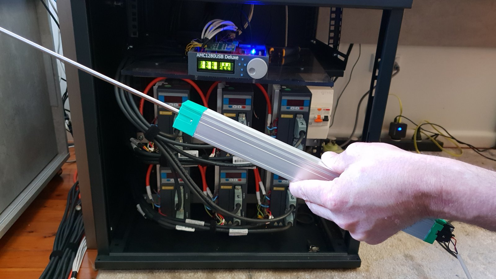

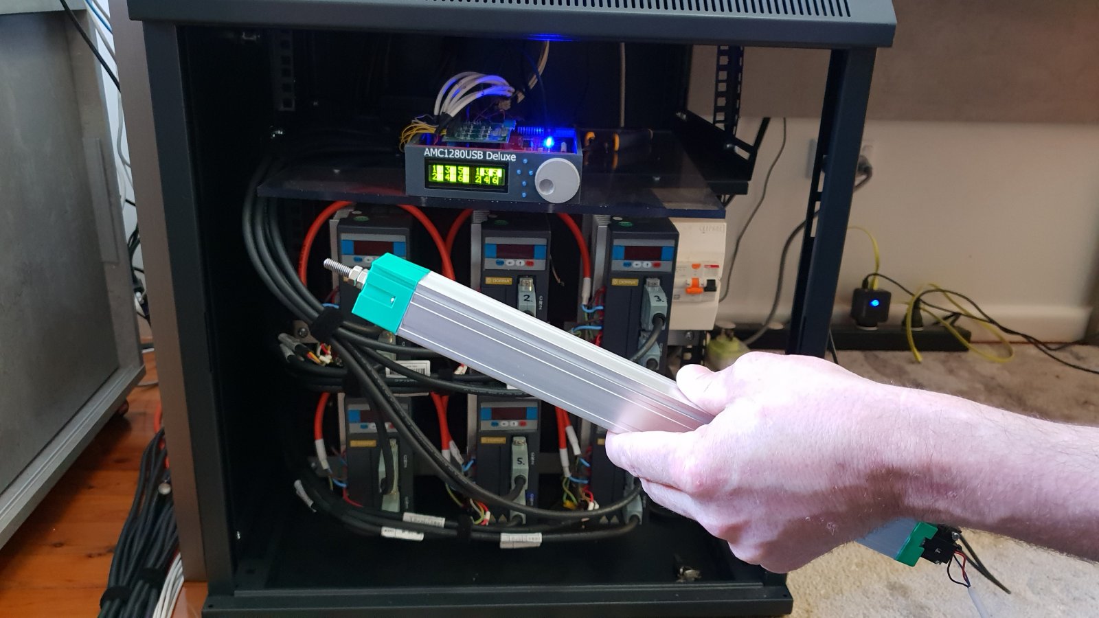

    Hi Thanos
    I had not turned on the AMC1280 for a bout a month and it would not boot. So i did the firmware upgrade and it powers on fine.
    Will i have to do this every time if i have not used the sim for a long period of time?
    So i connected one of my new Linear pots to it and i am able to see the bar changing direction as i manually slide the potentiometer in and out.
    I am curious though.. Am i supposed to see the sensor position when its fully retracted as displaying full bars?
    I mean i have connected sensor number 5 but when it is in its lowest position it shows the bars maxed on the AMC1280 and when i extend the potentiometer then the bars go to its least display.
    You can see the sensor position in this photo.

    I have a feeling that the 2 servo drives that are coming up with error 6 and 7 may be faulty after all ... I have gone through and checked as many parameters as i could and they all seem to match.
    What i did notice is that if i use the display 11 command which is the internal torque feedback display. The torque gets greater and greater like its spiking until it goes into error.
    On the other drives it displays a steady figure.
