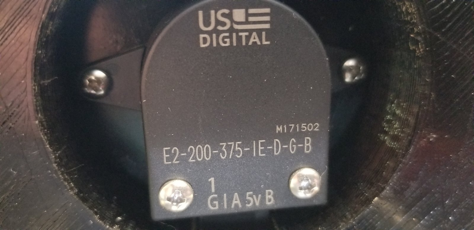

    I ordered another encoder from US digital today but this time I ordered a 200cpr instead of the 50cpr im currently using.

    This is the encoder I'm going to use. Its 200 ppr instead of 50. It gives me 7200 reference points total after tune compared to the 1750 with the 50 ppr.
    This is live for speed heave as i run over curbs.

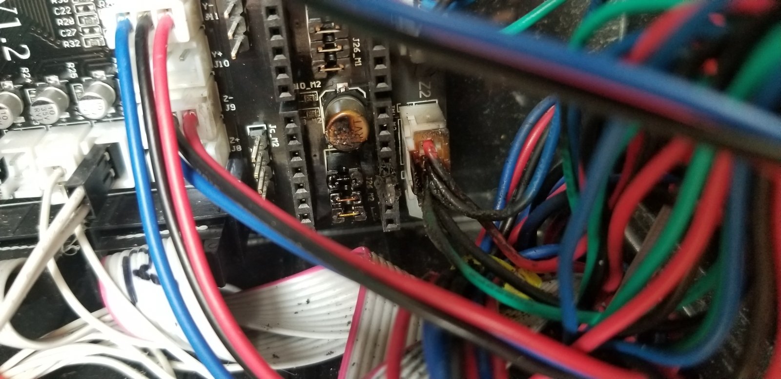

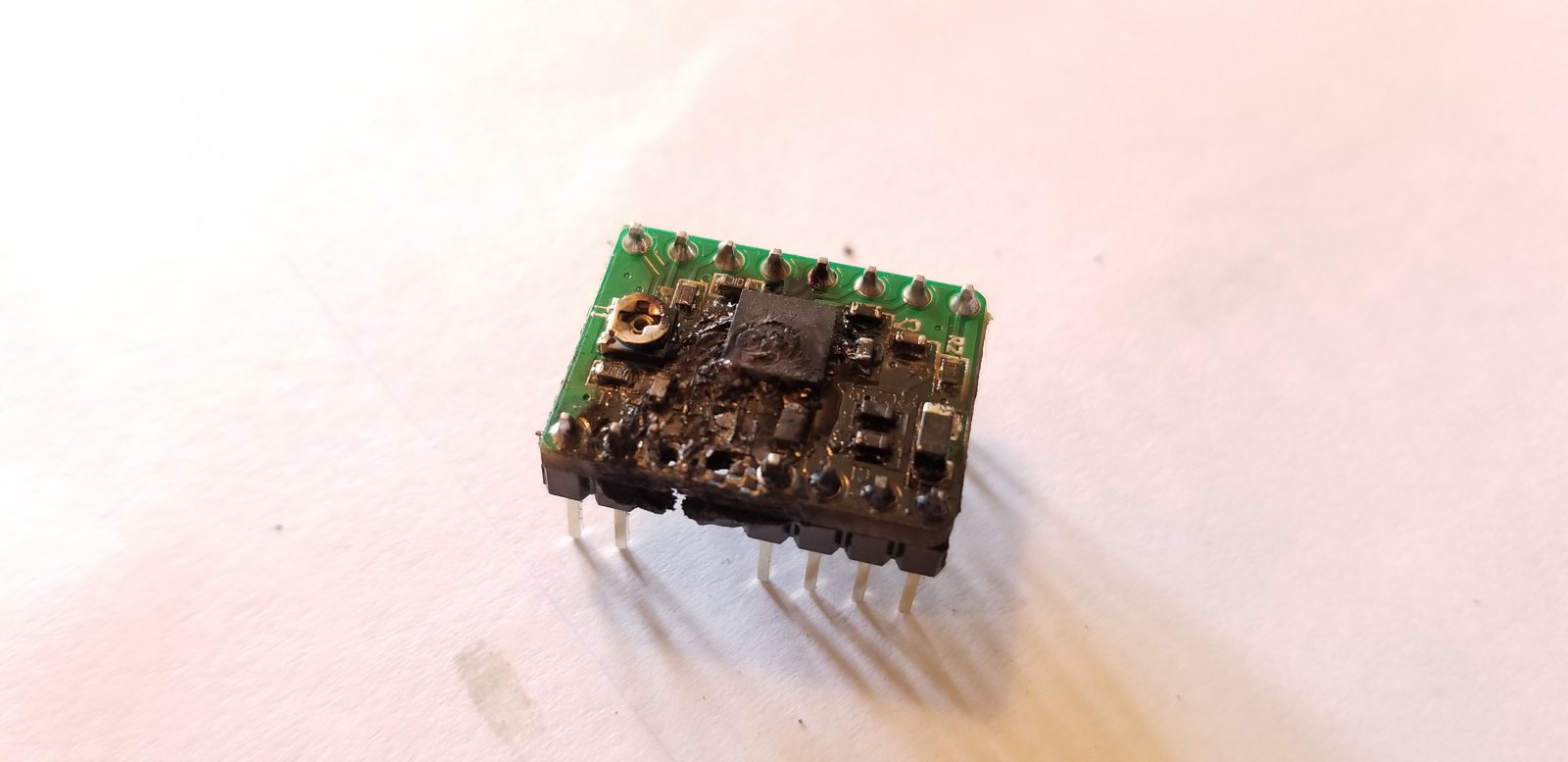

    I was printing more components for the actuators today when my 3dprinter started smoking badly. I shut it down and removed the cover to the electrical system only to find a burnt driver. It doesnt look like it killed anything else but we shall see when parts arrive.

    its an mks gen version 1.2 control board but the problem is it has the a4988 ic which has poor heat dissipation. I had been in the control box earlier to swap out a fresh hotend. the printer had been running for a few days. I suspect I dislodged the heatsink while fiddling around. this printer has a ton of hours without incident. good news is the relacement driver costs less than 2dollars. so maybe the control board is ok.....I hope;)

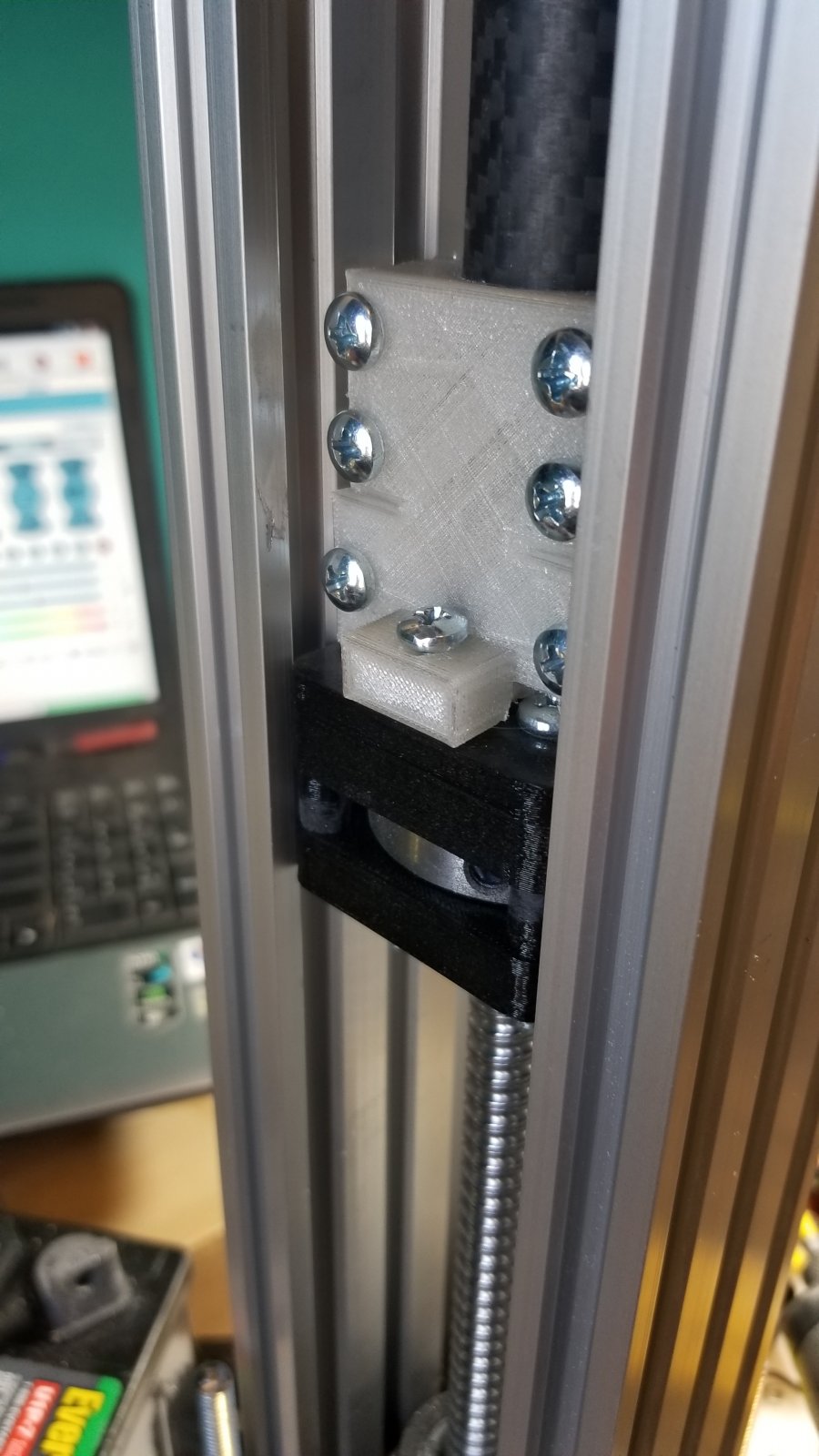

    So i got my printer going finally. Ended up just ordering a replacement controller from the manufacturer.

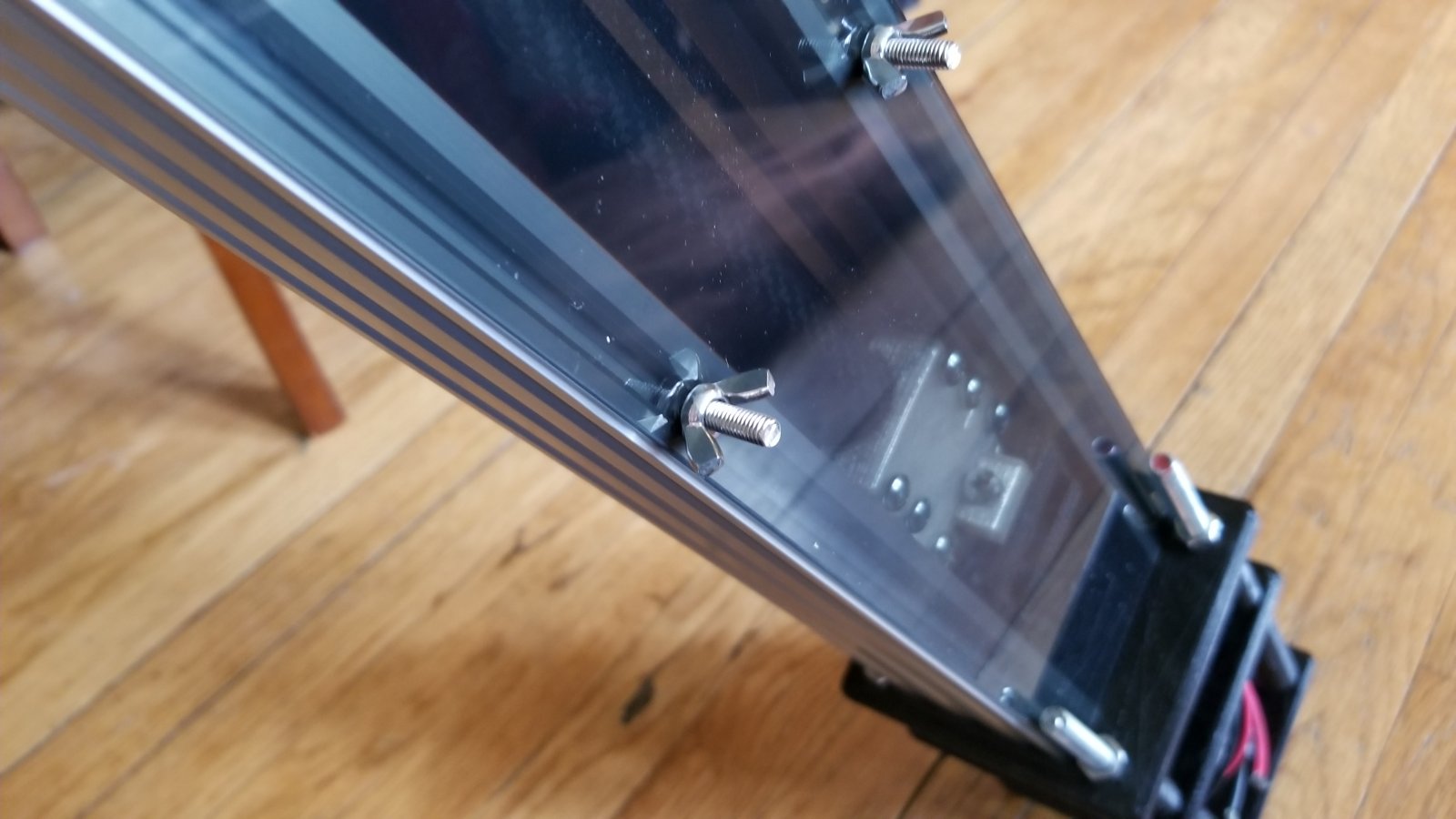

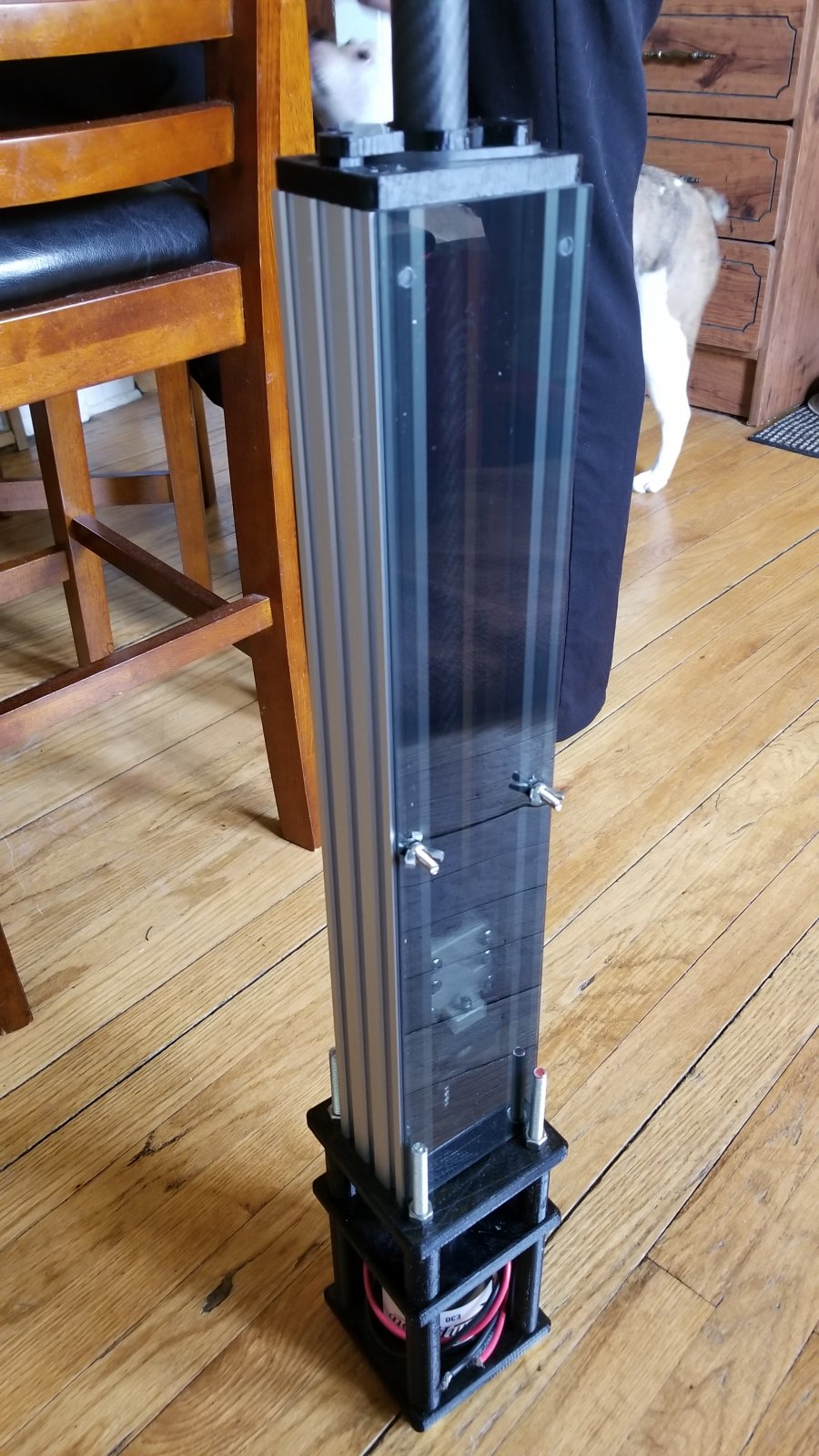

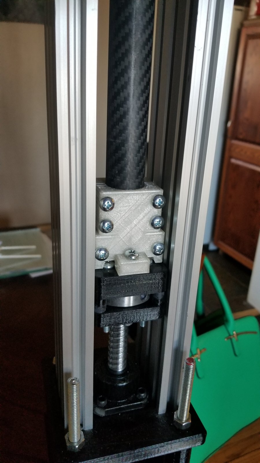

    I took the time to redesign the carrier assembly so that it fits inside the profile of the vslot rails. This will allow me to put covers over the exposed ballscrew and carrier assembly eliminating a number of "pinch points" which will make it safer and give me a cleaner look.
    I printed the clamp from polycarbonate filament as i broke the petg g model by overtightening the bolts. .

    Actuator with cover

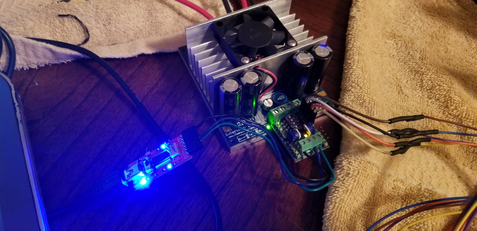

    I have them on 24v finally. version 1 and 2 are shown below using 24v i could turn them up a little more but i am using the axis settings for the old 6 dof. It seems very fast and I am excited to move forward.
