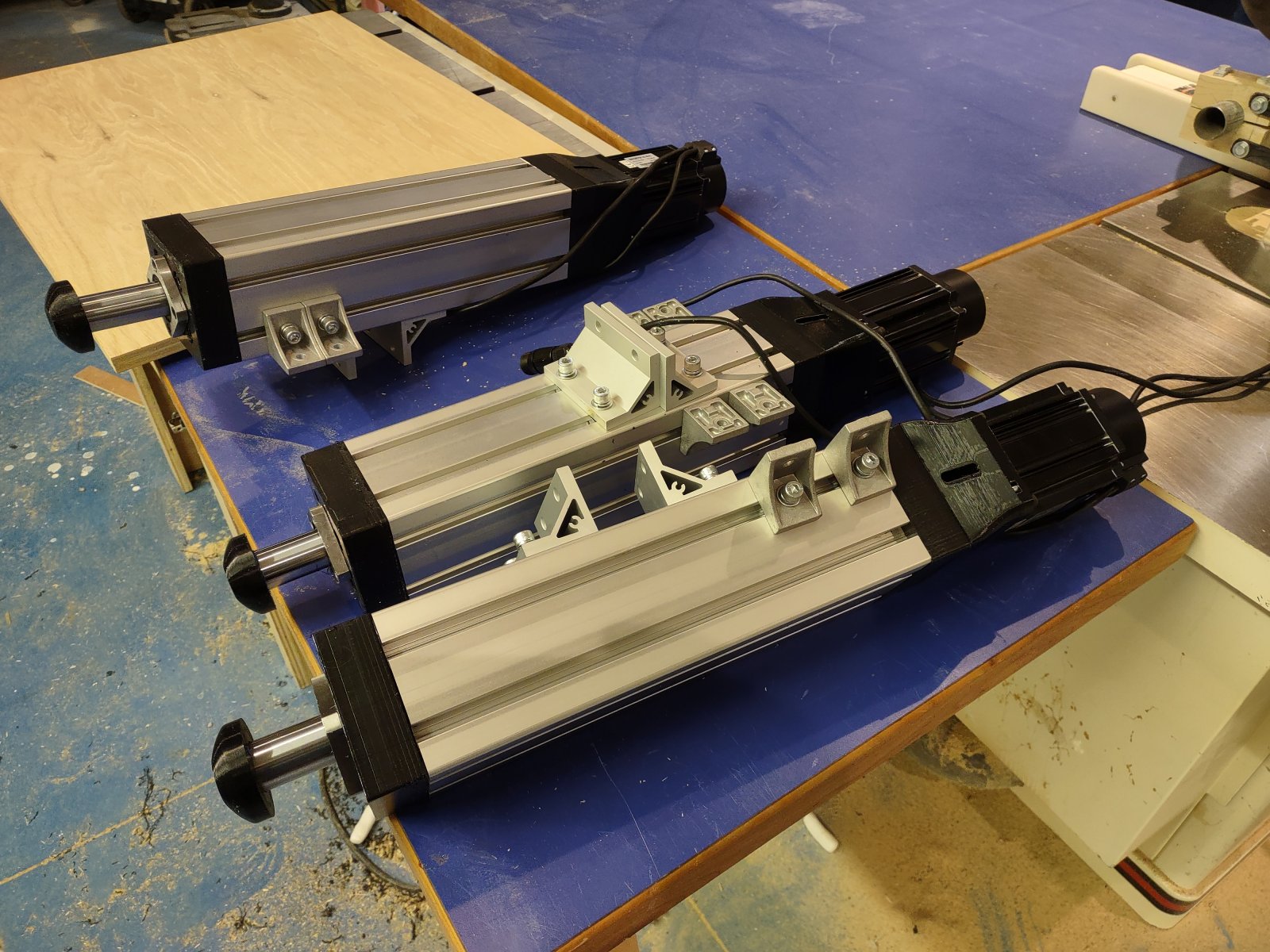

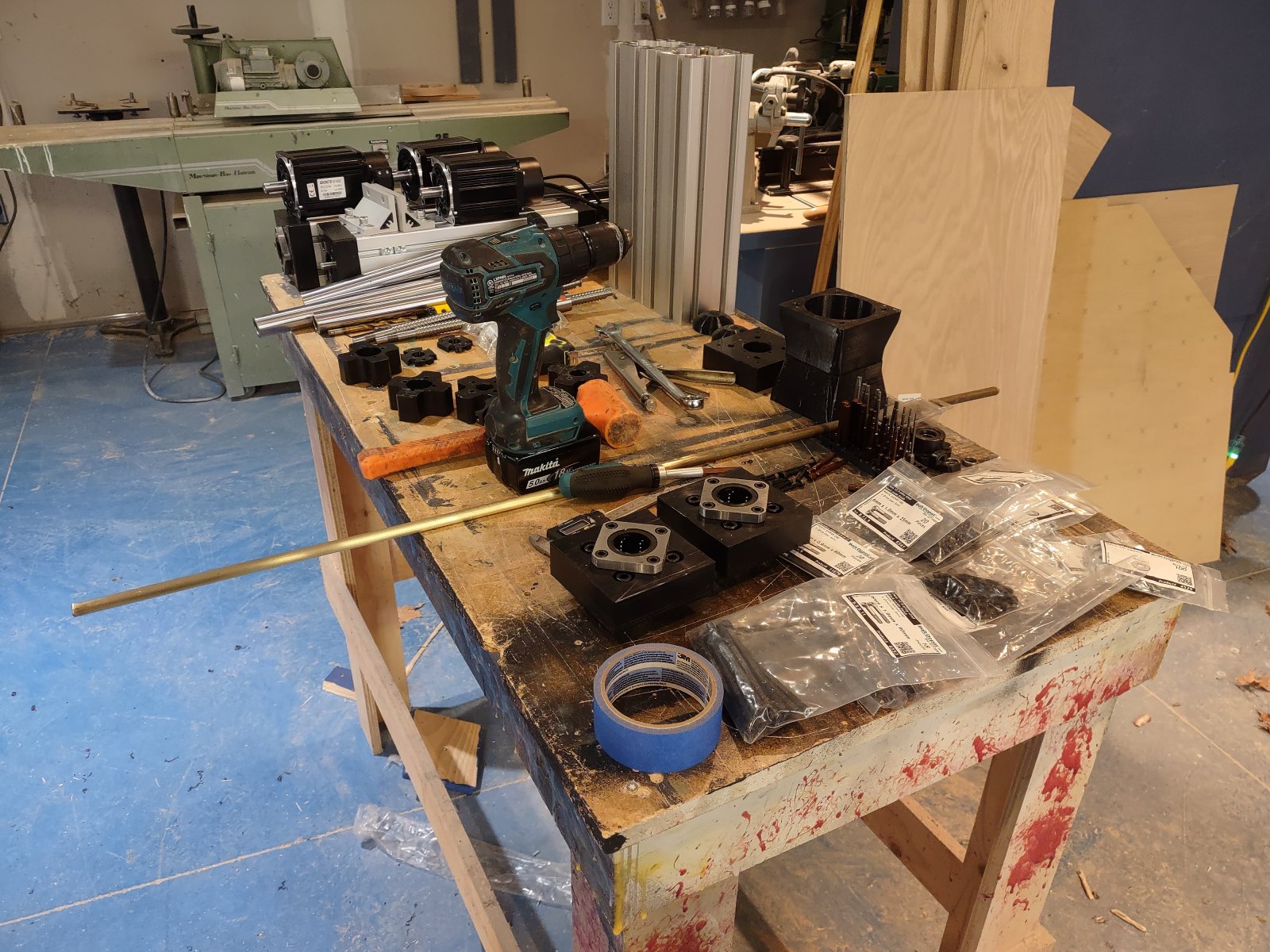

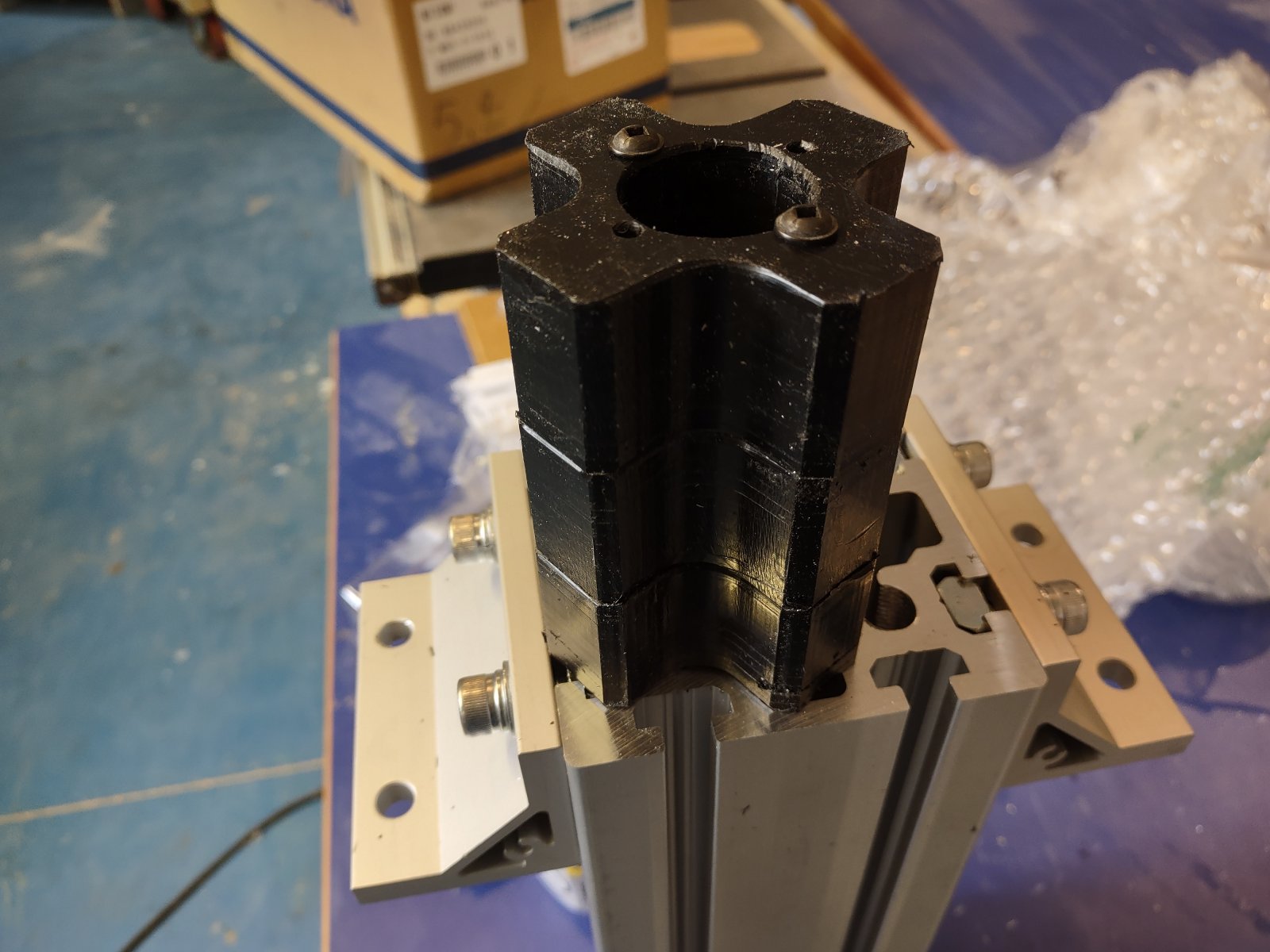

    Due to a delay in an order for threaded inserts (supposed to be located in the US but actually shipping from China) I cannot complete the last actuator. So I have three....yeah...but then again I have three completed so YEAH! :)
    Along with my aluminum profile I also ordered large angle brackets for the top and bottom and smaller ones to use on the sides. I only had to take an end apart twice to remember to put the bracket nuts in before sealing it all up :p
    The HDPE is incredible for the top/bottom and center slider. Easy to work with and reusable threads, as well as holding the bolts tight.

    Hi @Historiker . gotta say tottaly agree with you on the use of HPDE strong /Robust / nice surface finish and biggest Plus easy to machine and holds tolerances well .. def My Goto maaterial :) only wish i had come across a bargin Buy like you managed to get ( i know it came at good price given the amount you Got ) cant you see me drooling LOL :) great workmanship keep it going were watching LOL

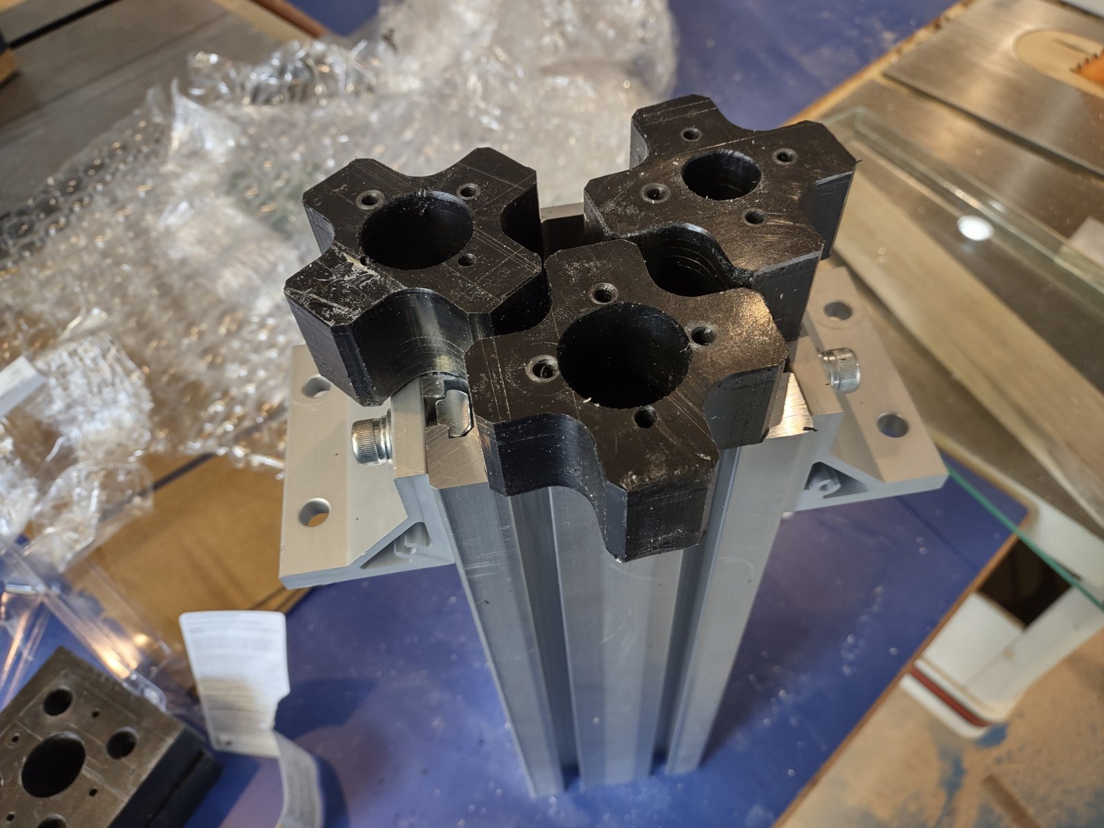

    Again, only three actuators so far but the sure look good mounted

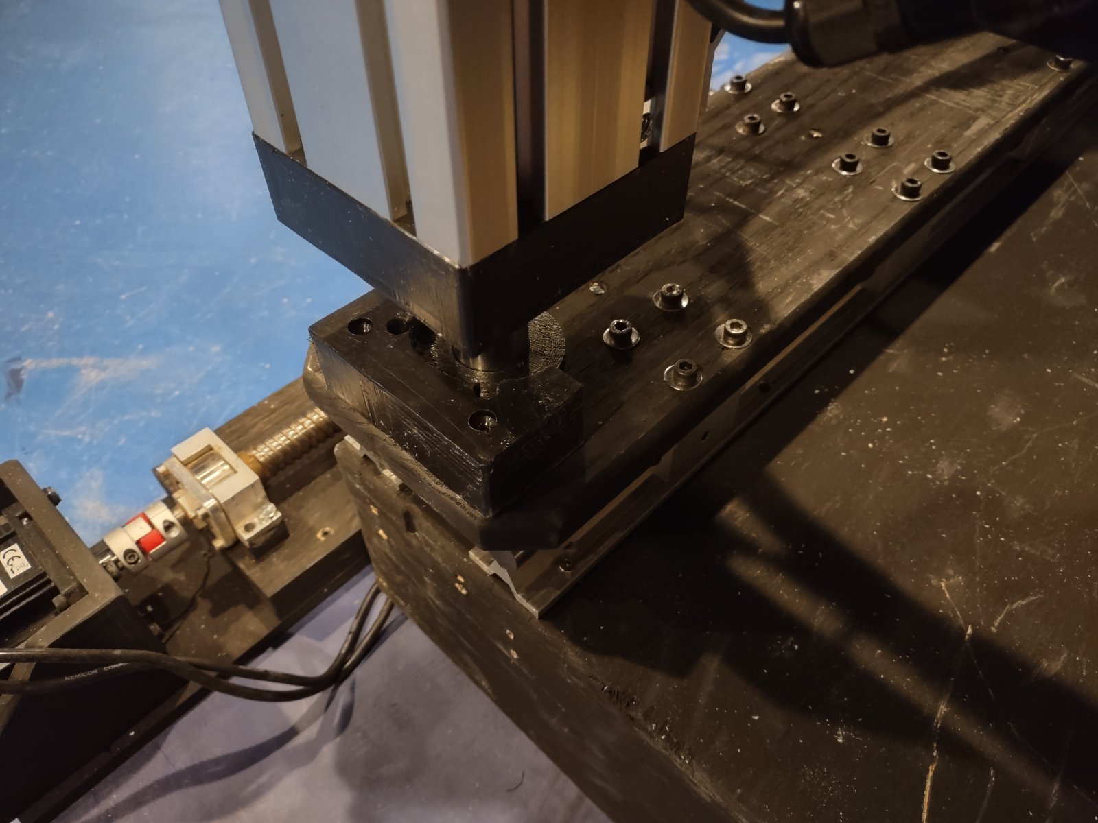

    I was a bit worried about the actuators sliding off the sway platform under hard motion so I put some guards around them. These are half cuts from the first test parts for the top and bottoms of the actuators. I rebored them to 64mm and cut them in half.

    AC motor, 6DOF
    Yes without those retainers the top deck would slide off the bottom platform.
    Up on the SFX website they have some stl files for such a fix. It is a bottom foot and matching cup...

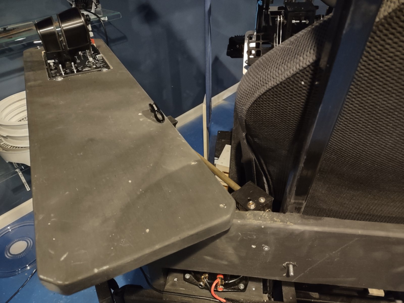

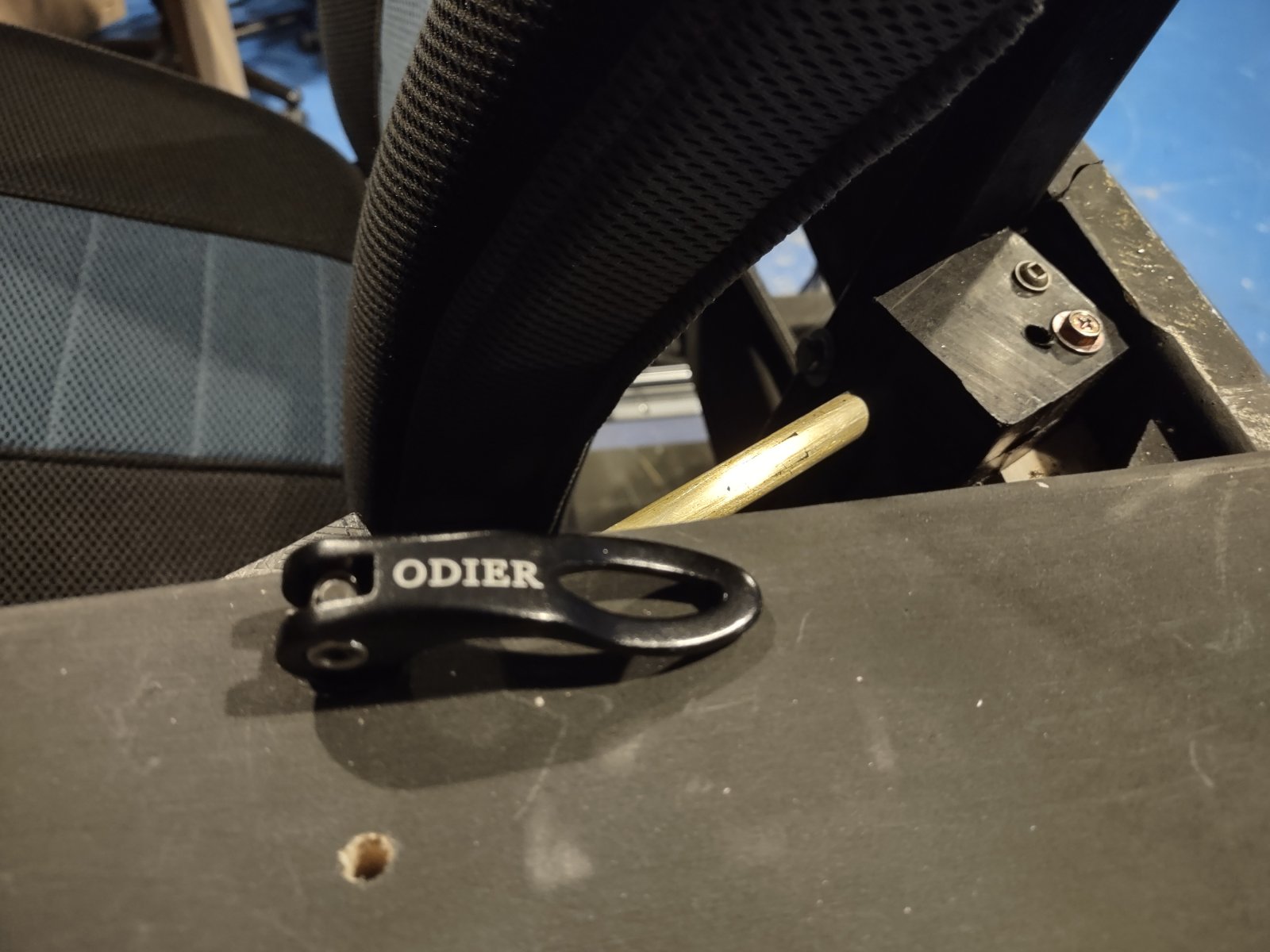

    Finally got around to installing a door slide lock. I need something to keep the side panel locked in place at various angles. Closed all the way for normal use, partial open for using my Huey collective, etc. This works perfectly.
    I used scraps of HDPE 33mm from my actuator build to make the bearings/slides and a 12mm brass rod for the actual slide. A bicycle flip tightener works very well for a friction break.

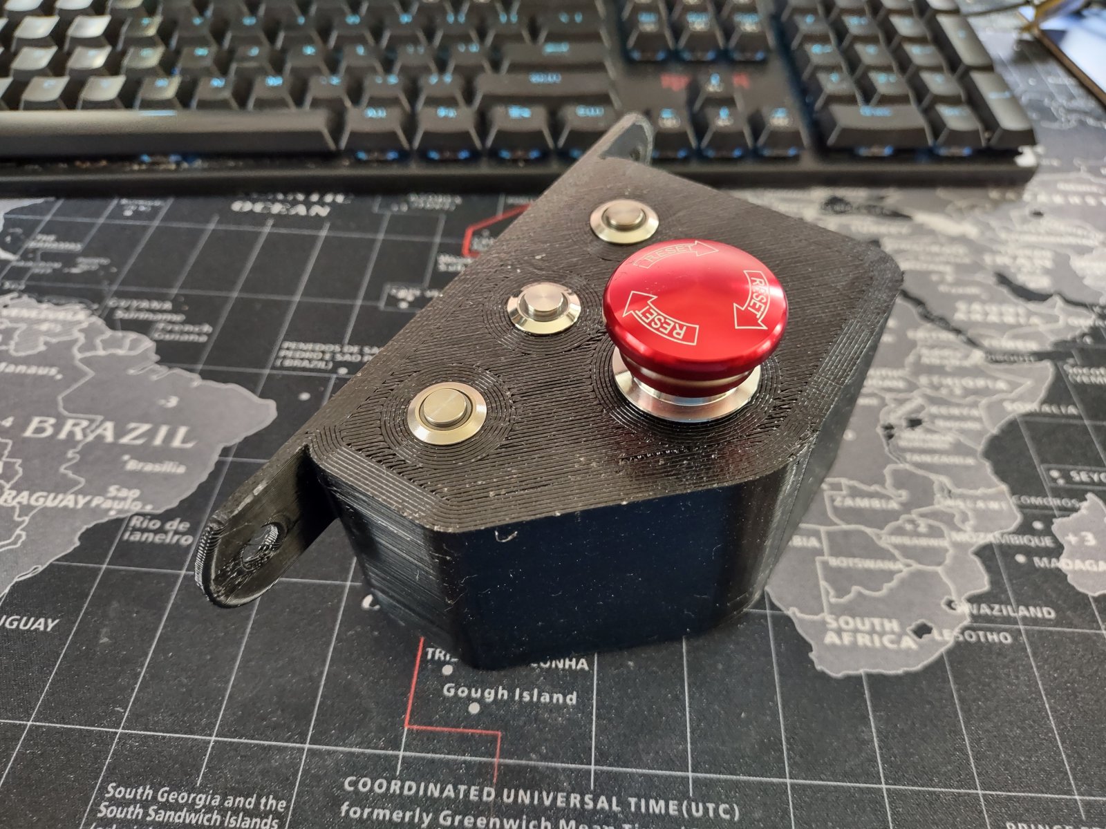

    So people don't think that I am finished (we never are, are we?) I printed this from files from Thingiverse
    Suppose I should mention what this is. The Thanos AMC controller has an RJ-45 plug that allows you to attach an Estop, a green status light, a momentary switch to set your controller (an thereby motors) to standby/Park (amber light) and a force offline switch (red light).
    https://www.thingiverse.com/thing:4751920

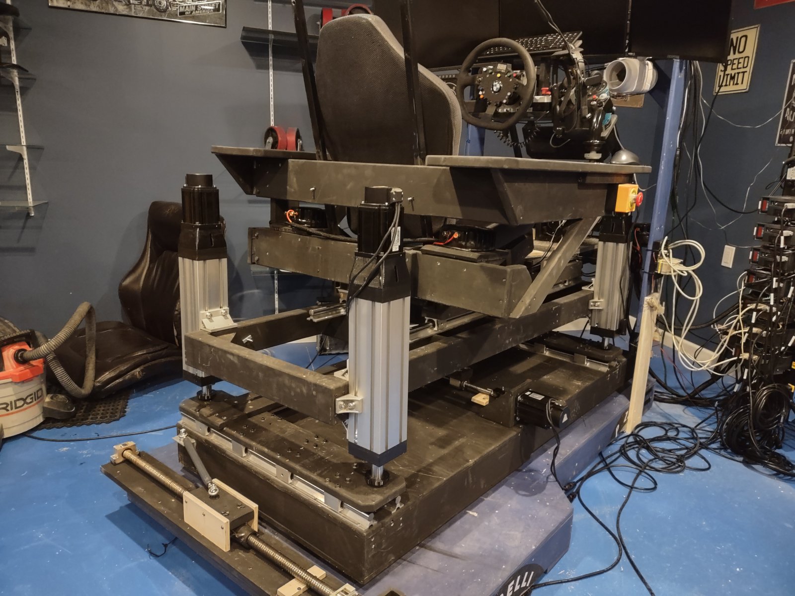

    Here we go. The completed SFX100+100+TL+Surge+Sway 6DoF simpit. (That is a mouthful to say...)
    The motors are detuned to 1500 rpm max, I did that for testing but to be honest it is pretty violent at that speed.

  18. Historiker
    2,162
    9,214Coins
    +2,170 / 19 / -1
    I need to mix surge with pitch I think. Although it feels pretty powerful when I am riding but you almost cant see the surge move forward and back in the video. Otherwise, yes pretty smooth

    May I know which type of ball screw are you using for the SFX100? The screws position on the slider seem to be different.
  20. Historiker
    2,162
    9,214Coins
    +2,170 / 19 / -1
    I am using 1605 ball screws, those pictures only show some screws holding the assembly together, they are not used in the final assembly. They are the same ballscrews recommended by the SFX100 website with the exception of being 100mm longer.
