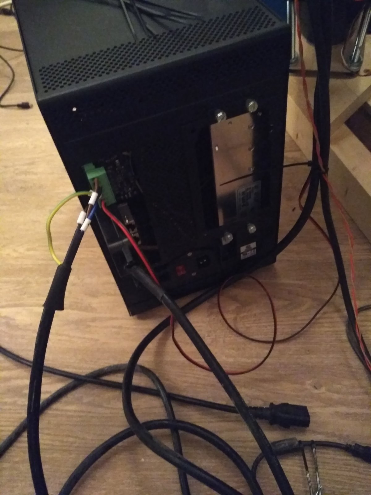

    I have a few issues now that I added my weight on the rig (70kg)
    => The PSU are so easily going in safety, I need to check my sabertooth configuration, When I installed the resistor for the braking regeneration ... but I did not put diode between the saber and the PSU ...
    I will add some asap ... as I don't want batteries ...
    => 1 actuator go nuts, vibrating strongly even without my weight ?, puley is not loose, potentiometer is ok and the ONLY thing that can solve this is reboot of the arduino OR connect with SMC3 software...
    The strange thing is that it is only with simtool ..... not problem when testing with SMC3 soft ...
    I tuned done to 115200 in simtool (and the arduino) and it did not appeared again ... but did not tested long since ...
    Also, I have the feeling the USB wire are important, I think I saw on gregory topic the same behavior with his laptop, by using the front USB3.0 connector my case PC I get stange things ...
    To be looked at ...
    Last question in mind :
    Do you think I need to get my 6 PSU wired together ?
    Right now I've set things with 3 module of :
    - 2 PSU
    - 1 Saber
    - 1 Arduino
    They share commun ground (small wire) because the 5V supply of the first sabertooth module is going throught ALL the end stop of ALL the actuator and finaly in ALL the security input of the sabertooth.
    The other security is a relay on the 220V of the 6 powersupply with the emergency stop.

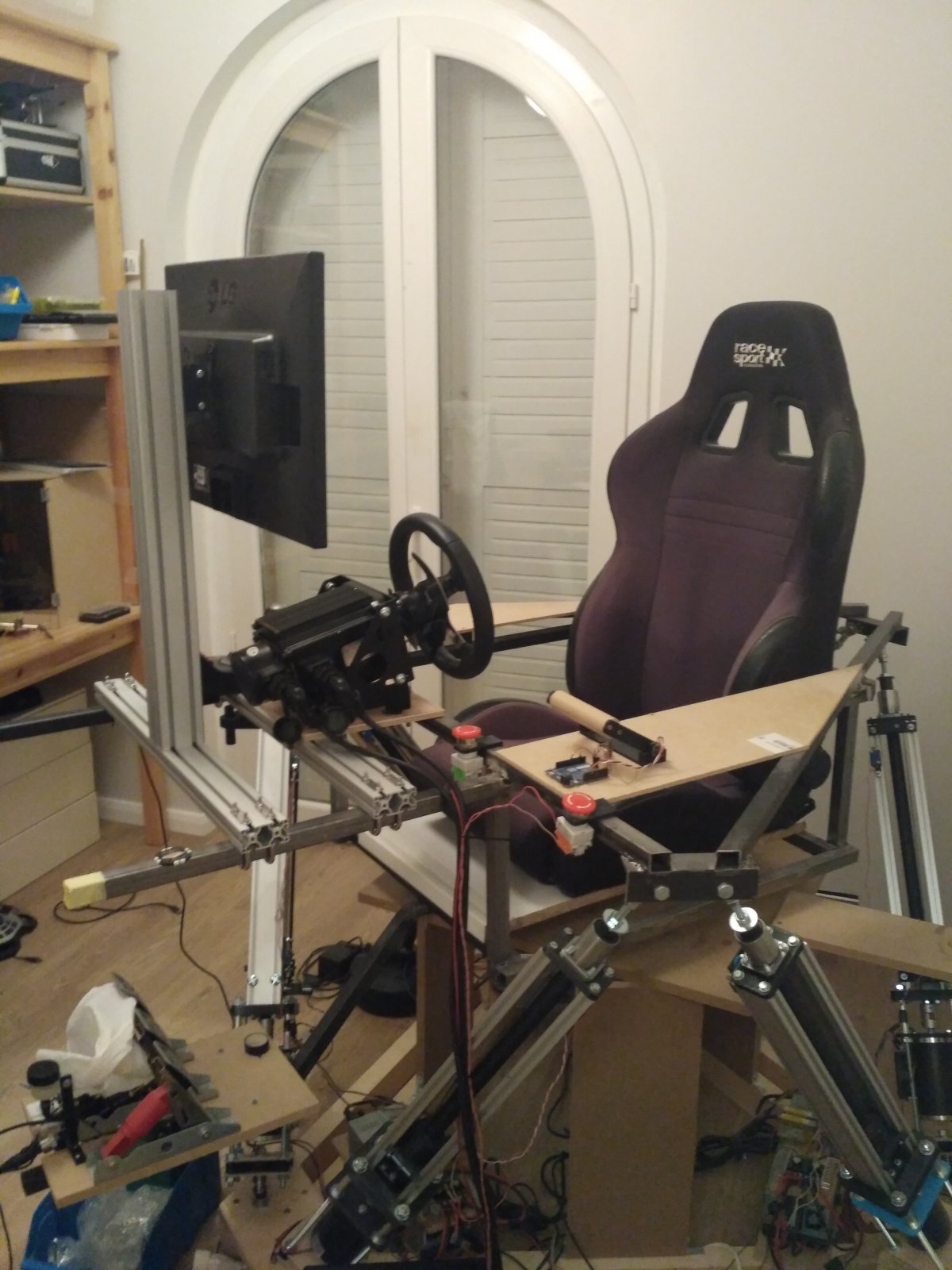

    I got some progress to share
    => Got my seat for 50€, great finding
    => The 100A diode + 47000µF capacitor solved surge on PSU problem
    => I changed 1 actuator to linear bearing, planning to do it for the others (I know it will be noisy)
    => Simtools USB setting solved the actutor jitter
    => I played with my quadcopter DIY google (2D, bad resolution) it's fun but DIY headtracking is not working for the moment.
    So for the moment, TV is ok (I don't want to go VR)
    => Bought dirt rally, made some first setup, I had to invert roll and pitch, don't really now if the other one are ok :D
    Don't, please don't, really don't say a work about my kill switch in the video, please.
    I just saw it now, I forgot to take it back with me :p
    Axe limiting to 25%
    Kp 200
    PWM max 200

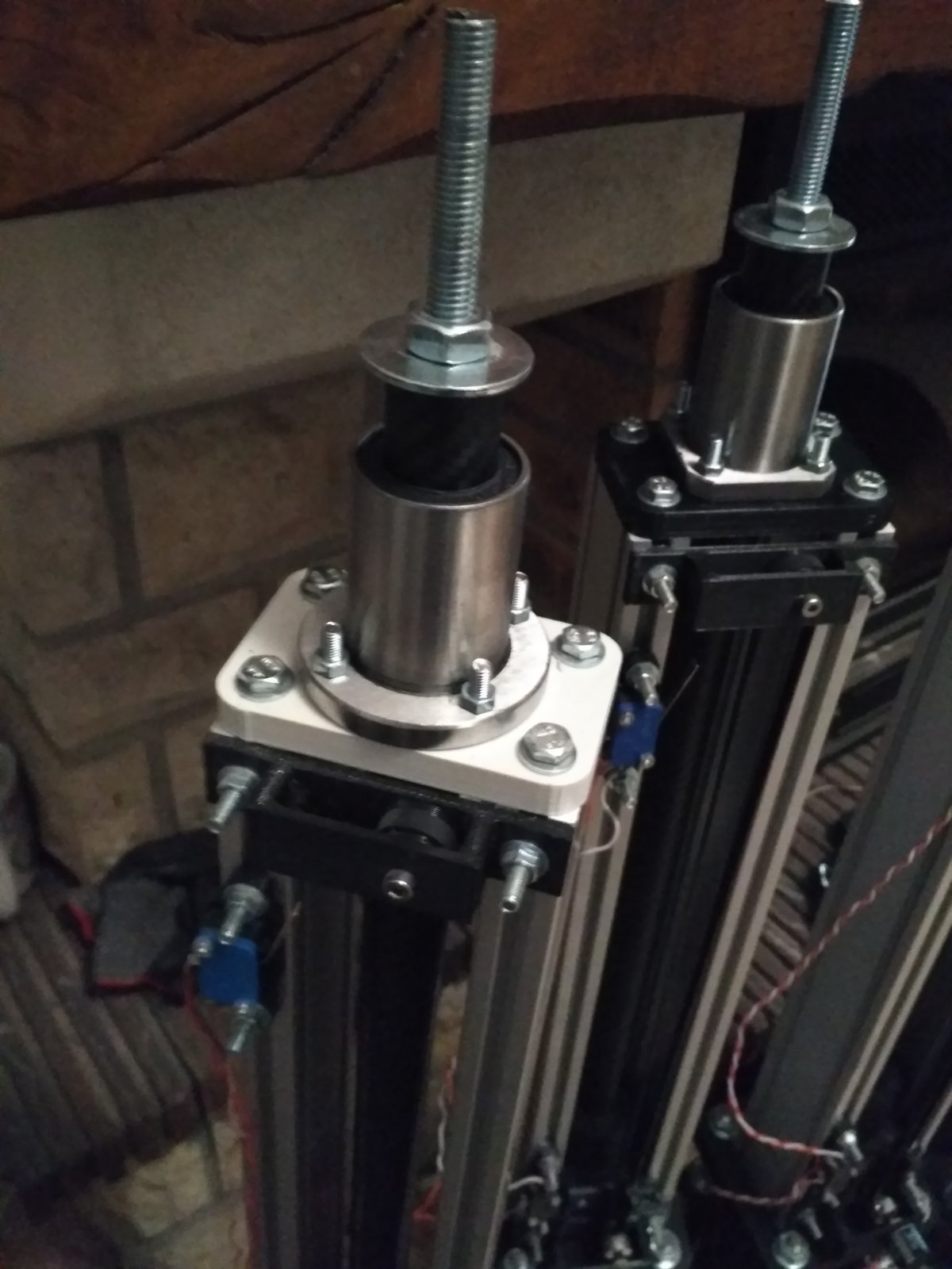

    Hello everyone,
    I received my carbon 25x21x500 tube and the linear bearing
    The tube are 21mm internal diameter and fit great with the end bearing/3dprinter adaptor I putted on the ball screws (I hope no vibration anymore !)

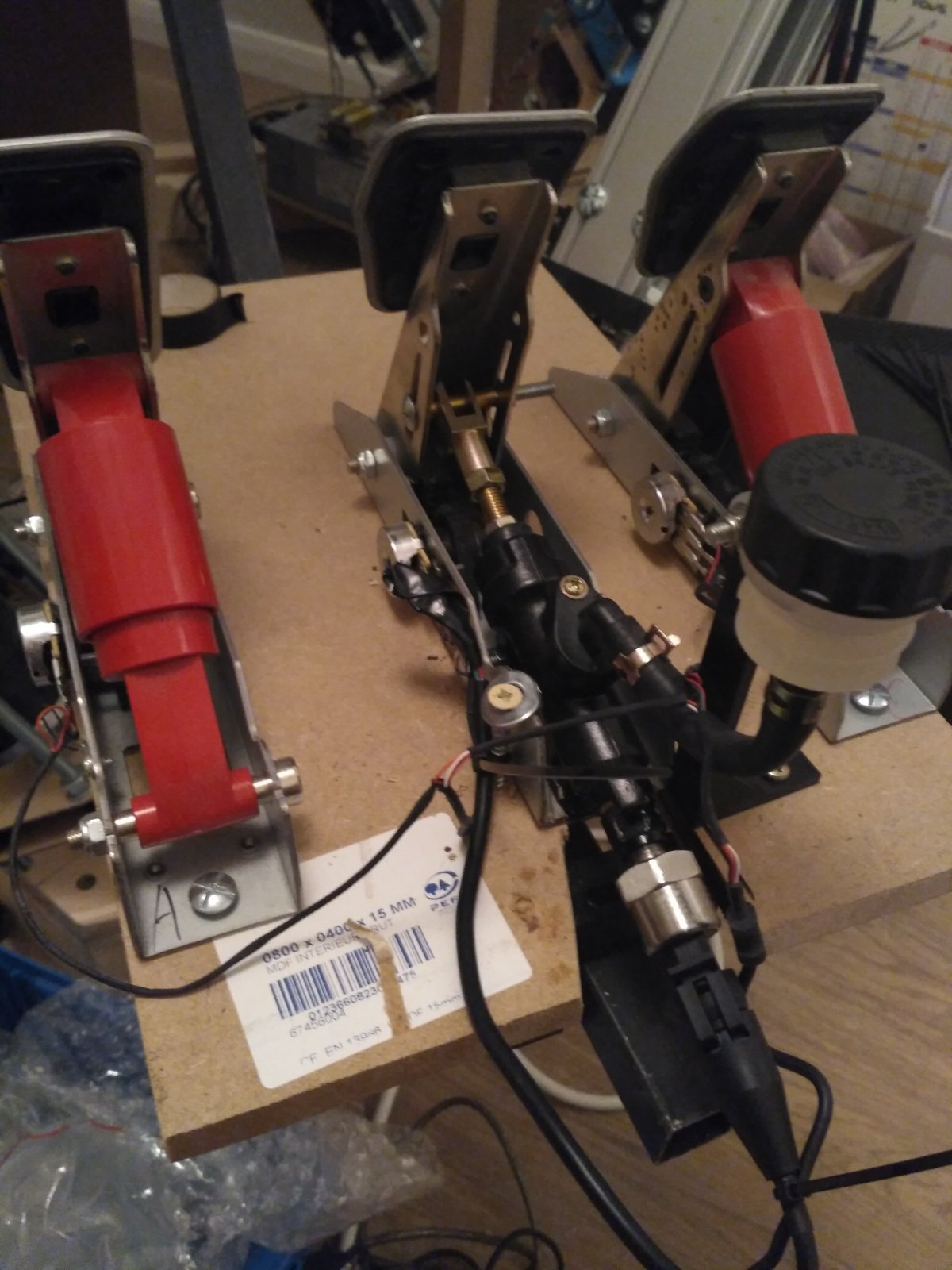

    I bought a broken G25 (no force feedback) for 30€ !!, I modifed the brake pedal to fit a honda 600 master cylinder, testing soon :p

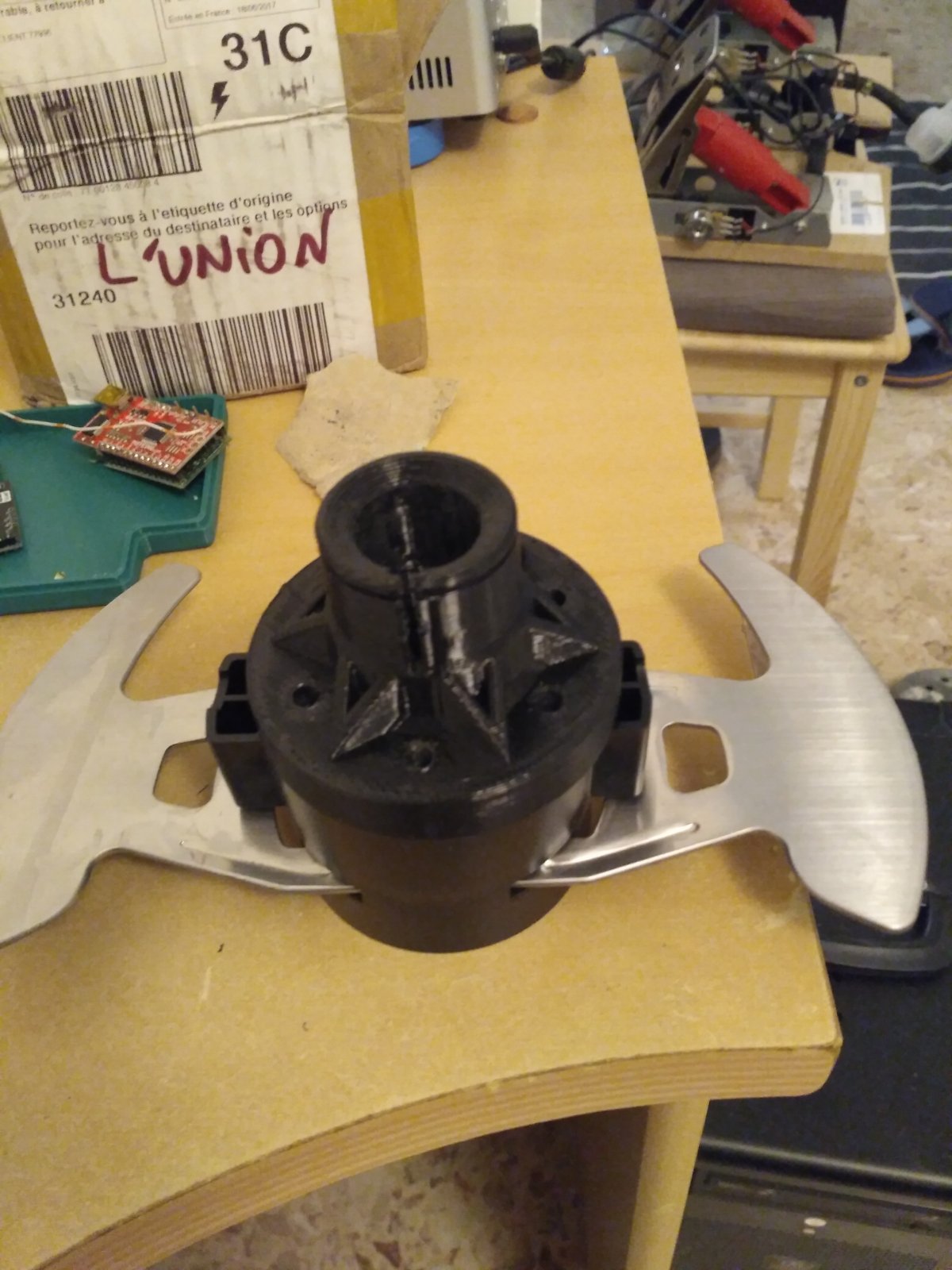

    I will also use the wheel and the shift gear plate on a 3D printed hub for .... ! no not a MIGE !, it's a Hirden a little bit cheaper, but yes DIRECT WHEEL DRIVE !!
    I got the simcube and a 36V PSU ready to go ..
    Last, but no picture, I welded on my rig motorwheel support & support for the screen.
    I'm looking to buy a 34" curved 21/9 2XXX x 1080 pixel ~350€

    Small update :
    => Chassit is ok for now (not light :p)
    => Actuator seems ok for now ! (kangaroo and rotary encoder next year)
    => DDW !!, working :D, MMOS ok and SIMCUBE ok, I just need to try it :)

    => Hydaulic brake !, I received leobodnar adaptor for my pedal / shifter of the broken G25 I got, I modified the brake to fit a HONDA 600 Master cylinder, I added a pressure sensor 0/5V (also following another topic)
    For now, it's working great :D :D, I need to try it, but even with the slightly reduced travel, it's now working "in force"
    => Wheel, I used a moteino from lowpowerlab to send via 433mhz the shifting gear button to an arduino leonardo emulating a joystick in windows (off course with a battery)
    Everything is on a 3D printed quick release
