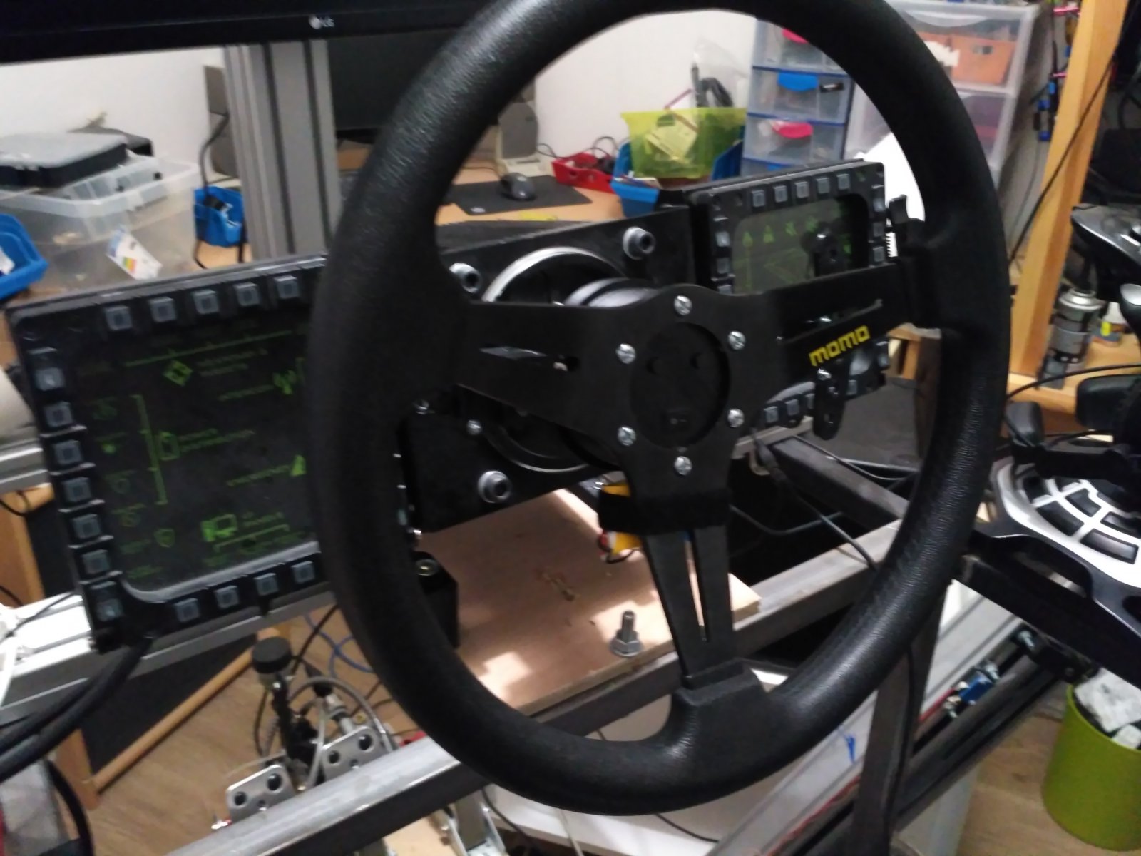

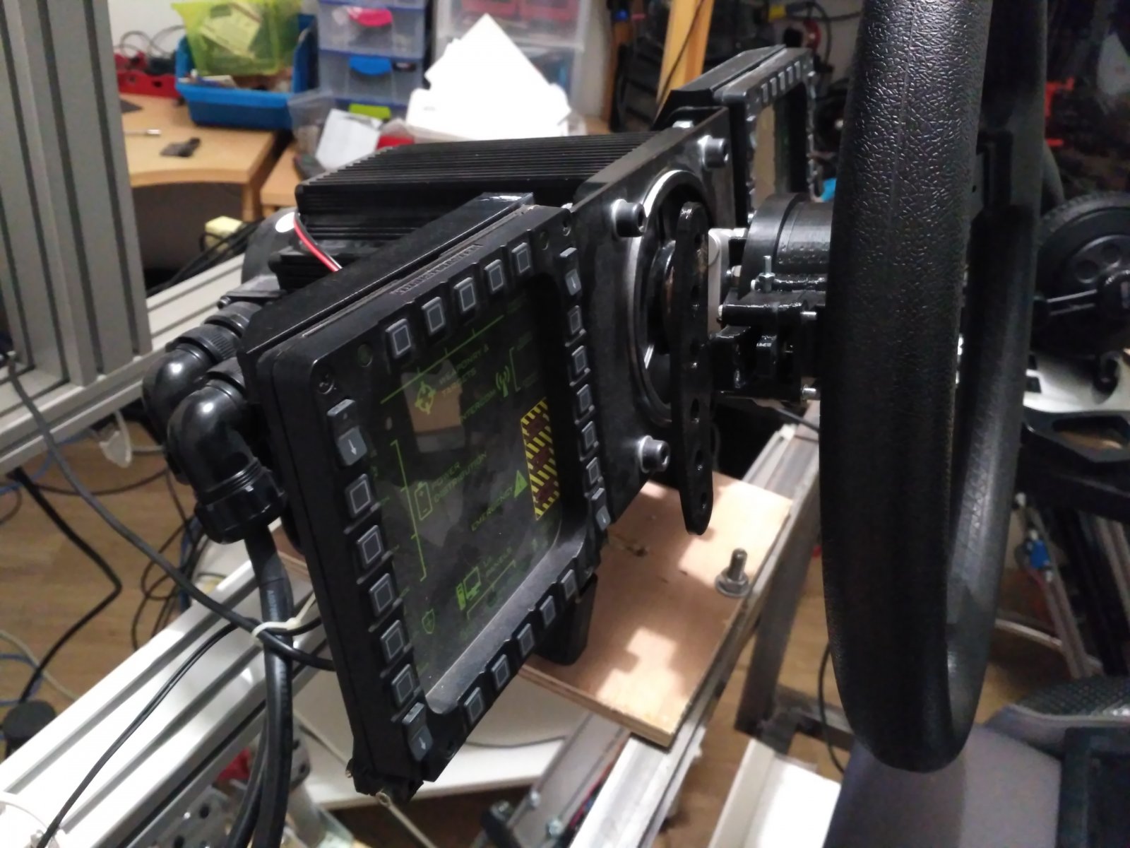

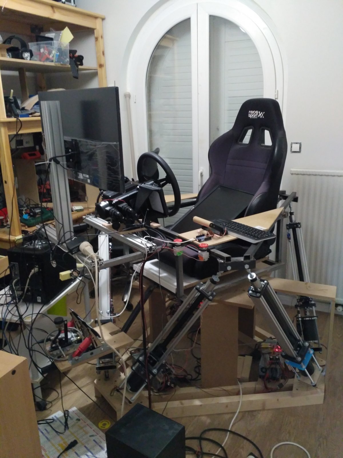

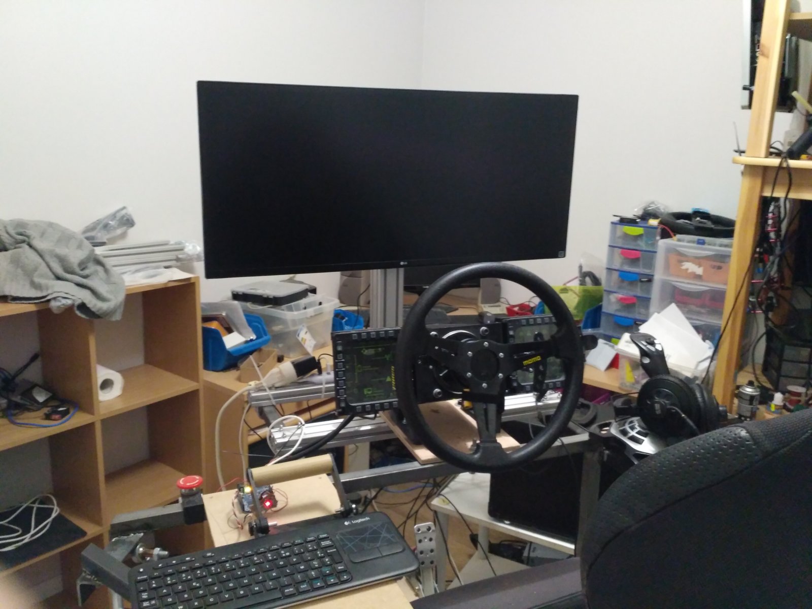

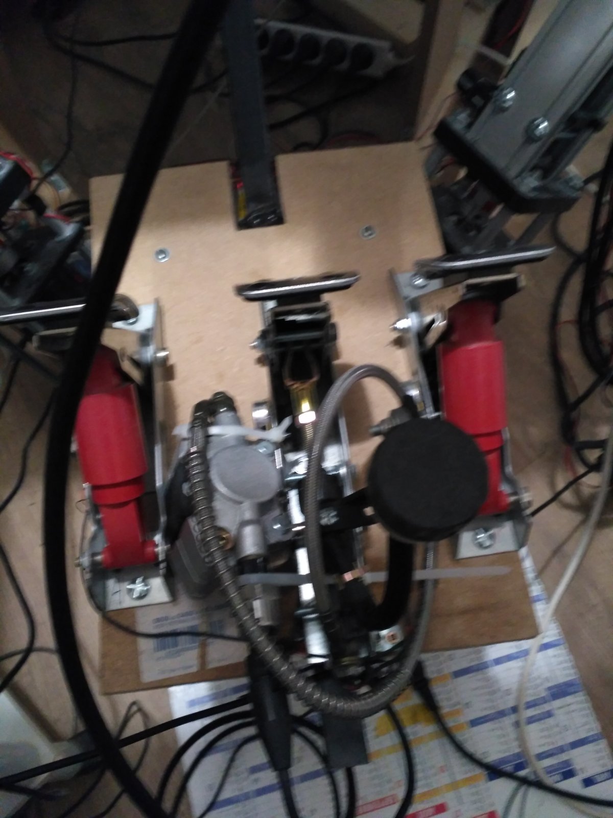

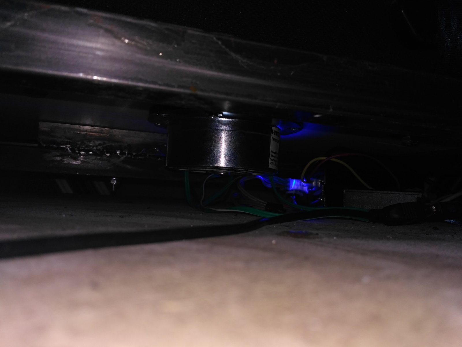

    Hello everyone !
    I did some work the past few weeks ...
    Sorry for the picture with my phone, they are not so great ..
    Anyway =>
    - I ordered from aliexpress a dirt bike complete rear brake, I mounted the pressure sensor on the purge side and voilà !
    It is heavy, ugly, but far better than a spring (but not as good as a real car)
    - I switched to a 21/9 - 2560*1080 - 34" screen, it's great
    - I switched from my G25 wheel to a 300mm wheel, I had to redo the part to mount the wheel on the Hirden servo motor. I still used my moteino (arduino + RF433) to transmit the gear shift to an arduino leonardo that is seen as a joystick.
    - I added on both side of the wheel old MFD cougar, that way, on elite dangerous I remove the wheel and have all the button available.
    - I have started tweaking simtools to provide acceleration and side acceleration to pitech and roll movement.
    I reduced a lot the impact of the orientation of the car (the real pitch and roll).
    I want to feel strong acceleration ...
    Also, switched from yaw to traction loss, and tweaked to have only the rear of the sim going from 1 side to another, and this is great !

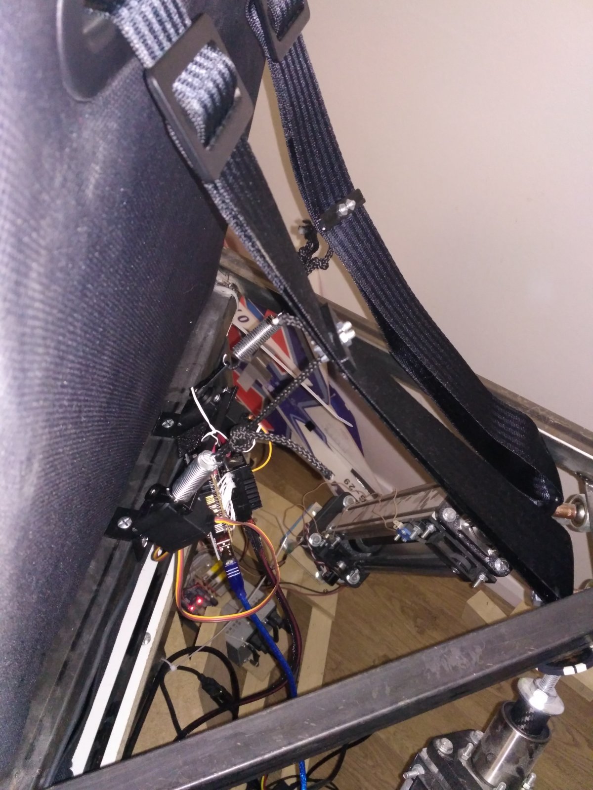

    Santa has come ....
    Just received 8 10kg RC servo and a 4 points harness ...
    I let you gess what I'm doing :D
    @All who worked on Gseat, thanks, very inspiring !
  8. baykah
    baykah Active Member
    Sep 1, 2016
    137
    Toulouse - France
    414Coins
    +133 / 0 / -0
    V1 of my simple harness tensioner working great !
    V2 will mainly change the connection between spring and servo arm (currently limiting range), later I will switch to aluminum arms and to something better..
    I decided to only apply tension when there is deceleration, it's not doing anything during accel.
    Easy to change, but I like it that way, I will probably do something else when I will have a gseat.
    I also fixed 2 bass shaker below the seat and it's working with sime vibe on a 75W amp and another sound card.
    I'm just waiting plugins to be compatible to test it !
