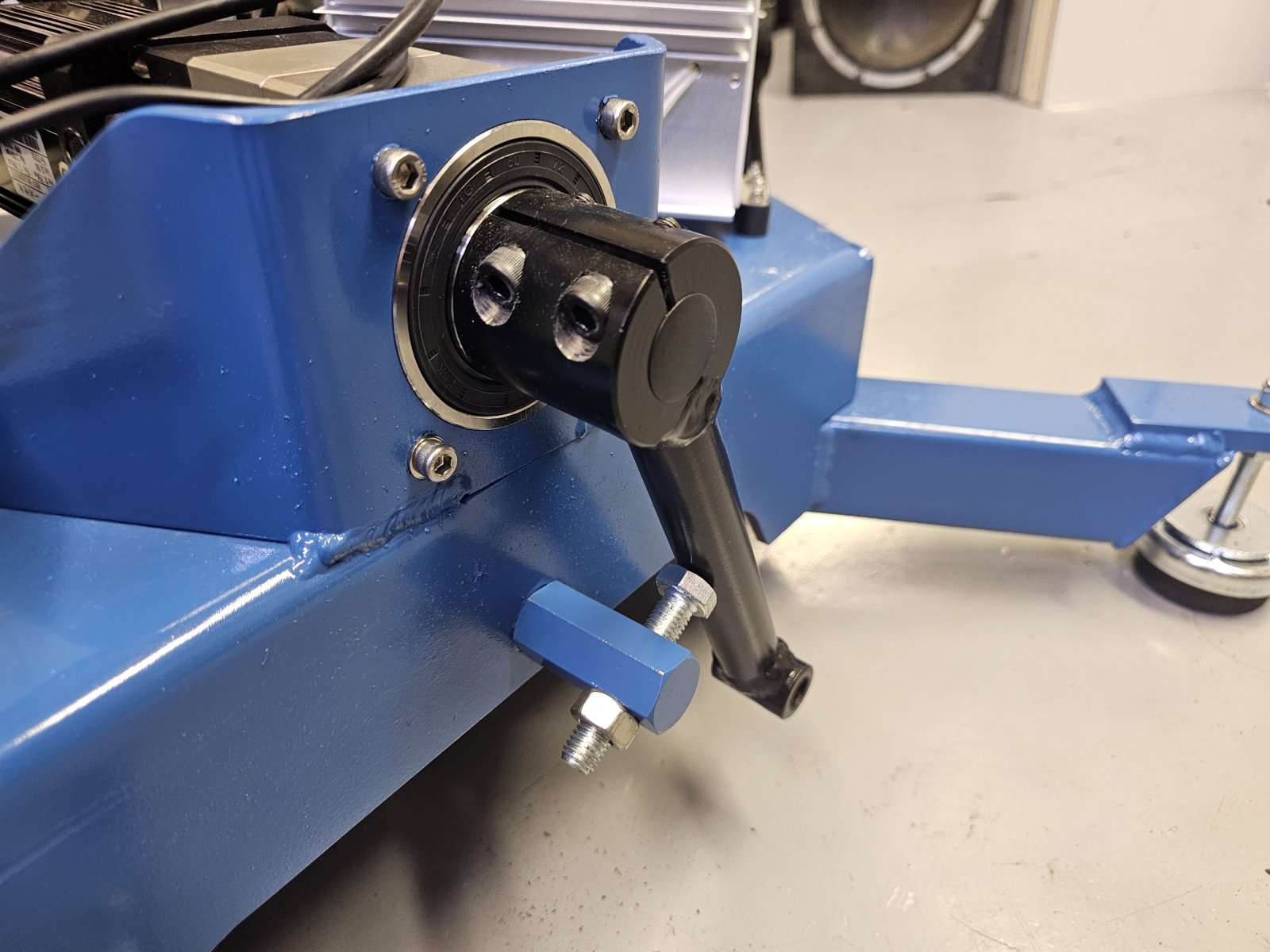

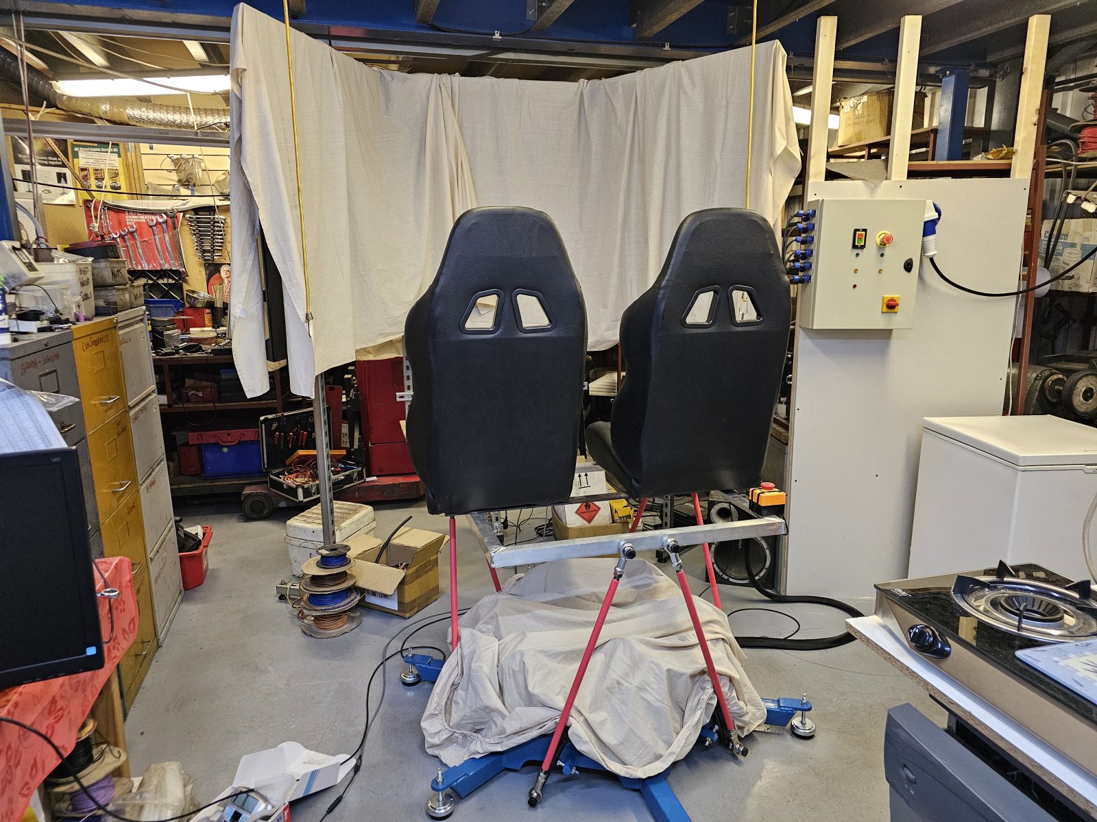

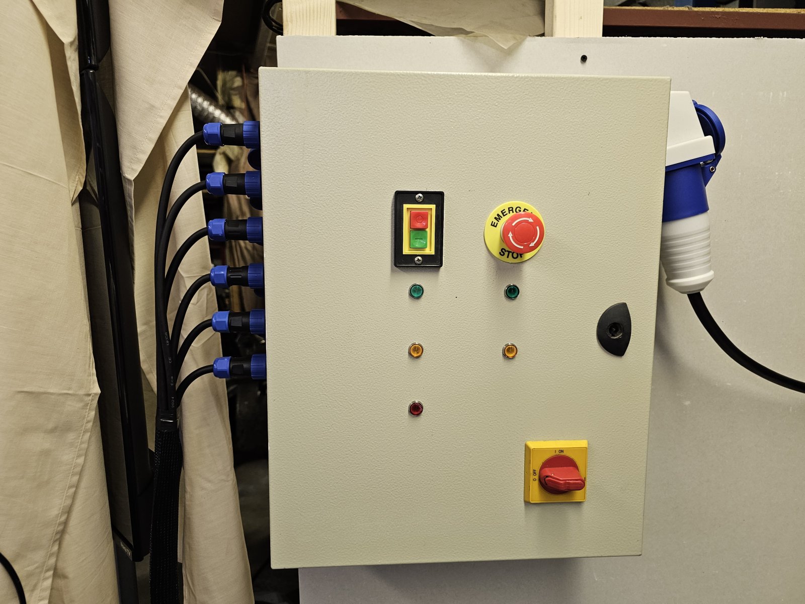

    Just thought I'd post some progress on this toy...

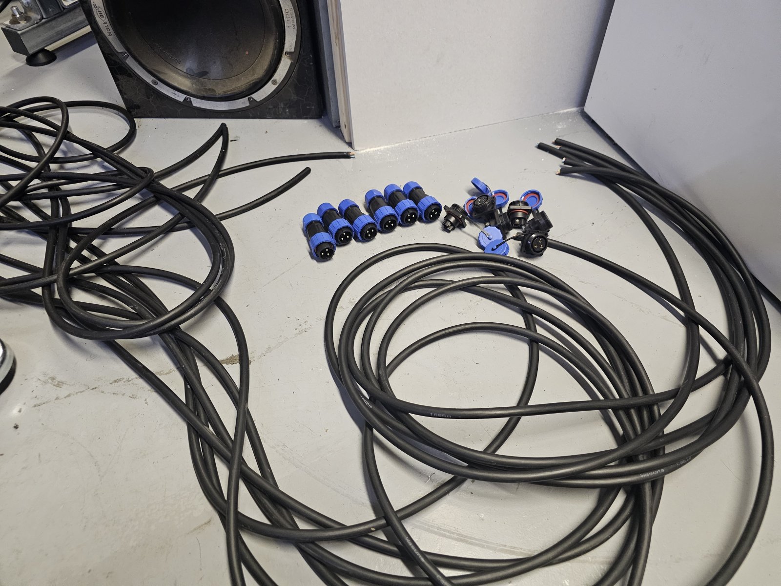

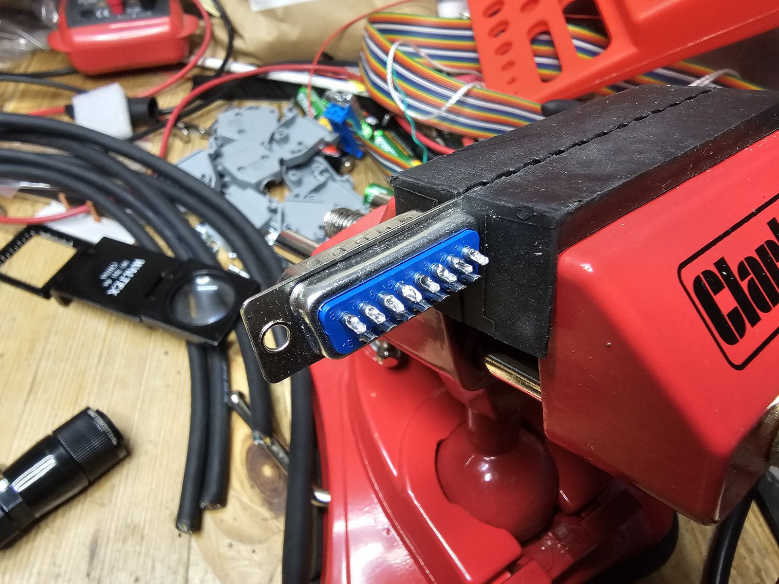

    Connected the cables
    Got the cabinet on the stud wall, its not really, just a bit of platerboard to hide the machinery behind.
    Notice the emergency stop button (yep finally got it fitted and on on the seat platform)
    Shortened all the cables (god what a job)

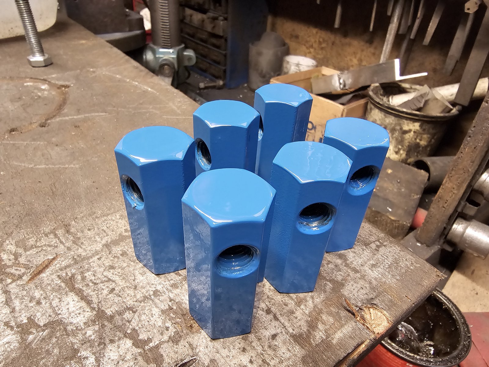

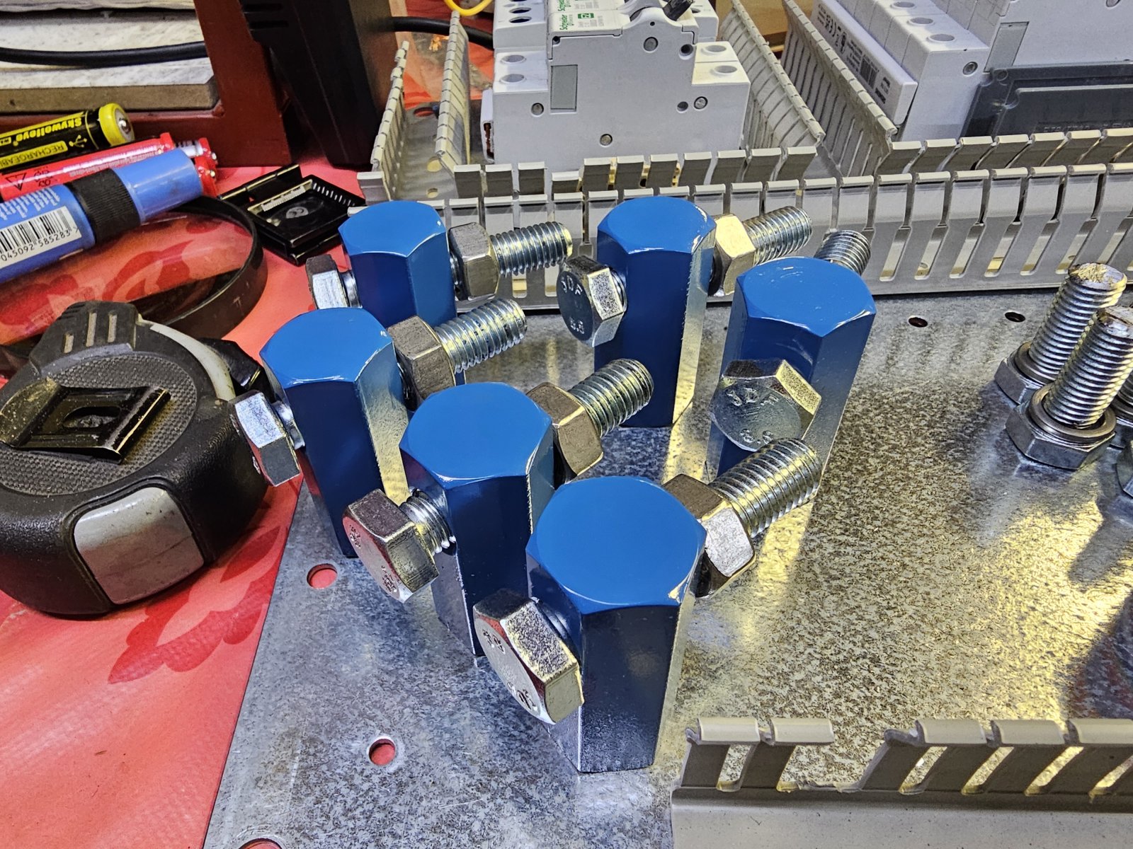

    Made some of these beauts...
    Even got some nice little caps to go on the gearbox shaft.
    Made all the bits fit in a box and all pluggable.
    Did a bit of testing with a lot of help from the @knaufinator and his video on setting the Simtools profile and got this...
    https://wavepower.org.uk/20241208_Progress_Update.wmv
    They won't let me upload a vid so you can get it yourself, should you so wish.
    (and thats my site which I've had over ten years, just to store stuff, and transfer large file back and forth from work mainly)
    Checked the fitting of two seats...then...
    Surveyed this fantastic machine front top to bottom for a few hours...
    Bloody fantastic.

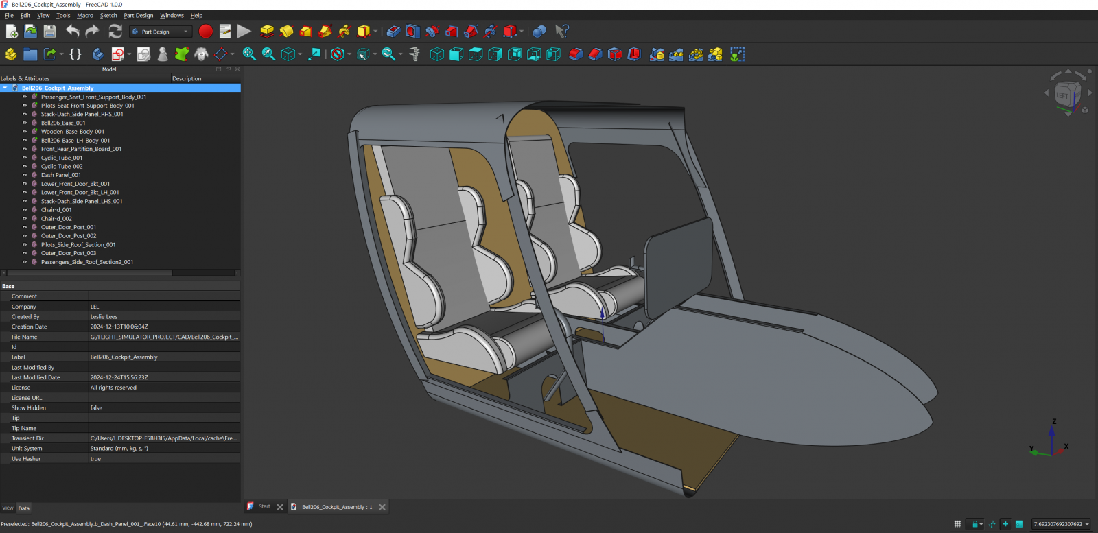

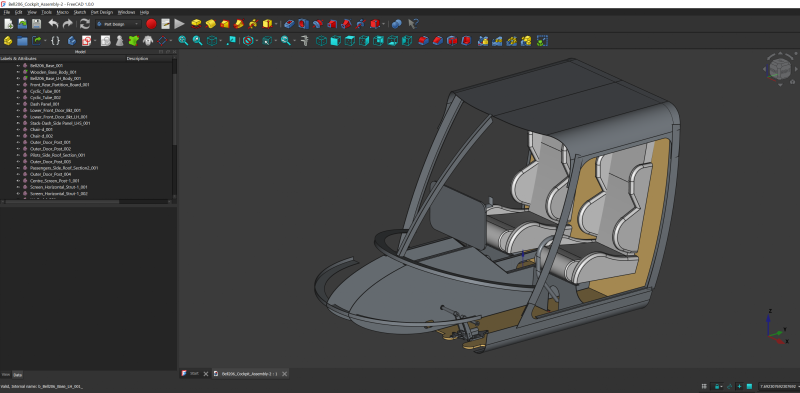

    So I've recently started work on this..
    it needs to fix direcly onto my platform frame
    Here's link to the 3D assembly file, which is an .stl file and windows seemed to find a 3D viewer to open based on it's file extension. https://wavpower.org.uk/Bell206_Cockpit_Assembly-2.stl

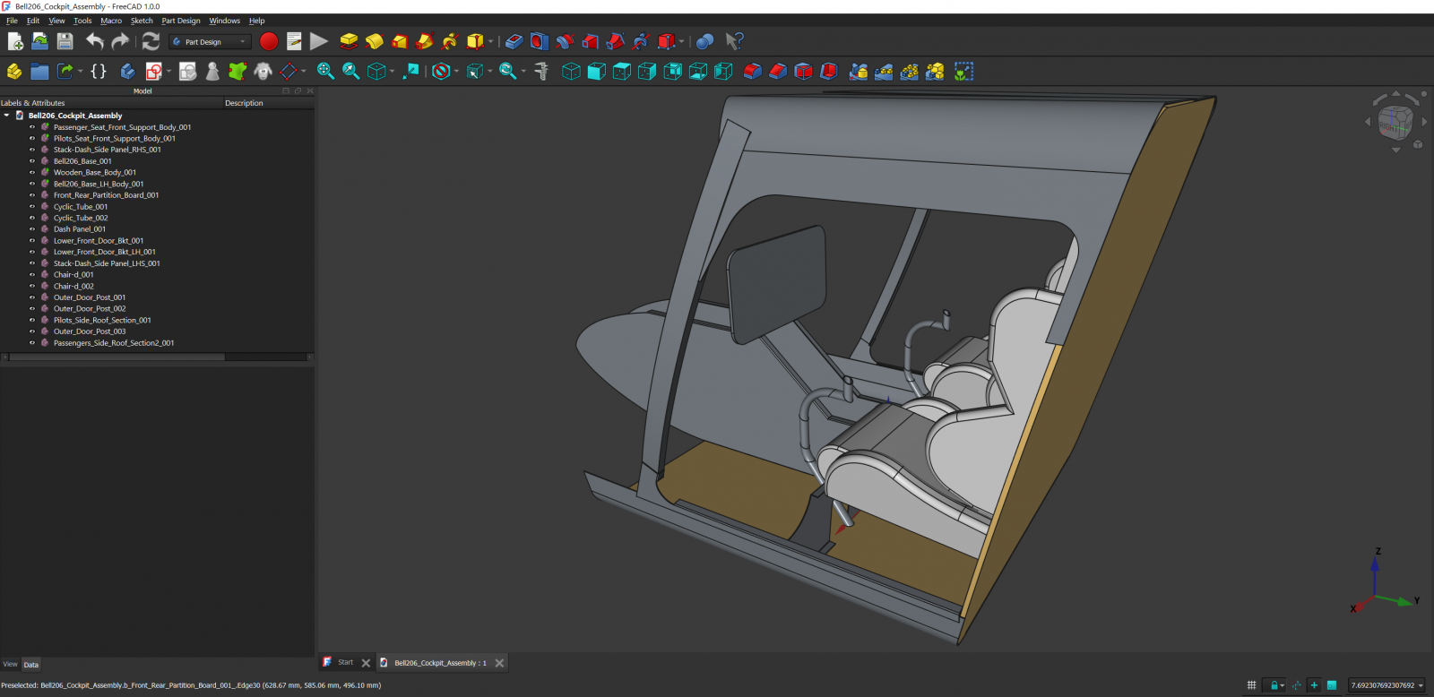

    So I'm hoping to make the Bell206s' dash panel removable, and plug and play a car dash (and pedals)
    The 3D exploration is to see what parts I can make with basic sheet metal tools (shrinker/stretchers/brake folder) , with the more complicated small bits resin printed

    Something I forgot to mention in my previous post was that the 3D model is primarily a method to experiment and explore how the finished article may look if I made it from shapes I can actually manufacture.
    I don't have the luxury of limitless funds, to get every part to look like the real thing, but I'd like to be happy with the finished product (up to a point anyway).
    For instance, I fully expect the nose section to be shortened, as I'll never be able to get close enough to the screens, and to be honest the screens are already looking too small in relation to the cockpit.

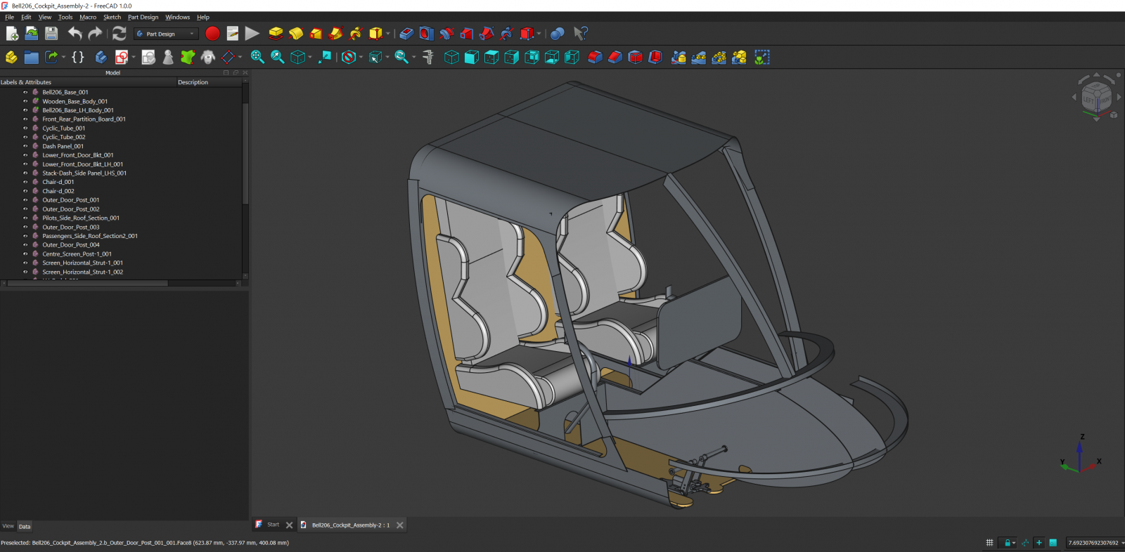

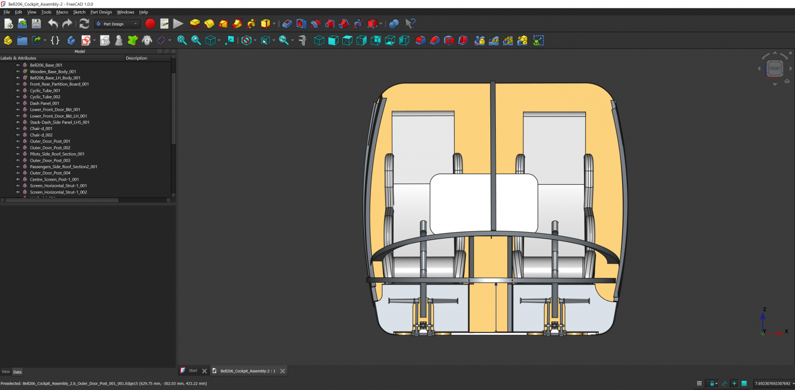

    Managed to get a bit more done on the cockpit model, but won't start cutting anything til I'm happy with dims & scale.
    I'm using FreeCAD version 1.0 as it's open source and as the name suggests, it's free (nope not Free trial, or Free download, it's really free). I've been using it for a few years now, and watched it go from unbearable, to quite reasonable.
    Here's the assembly file should anyone want a deco at it.
    https://wavepower.org.uk/Bell206_Cockpit_Assembly-3.stl
    (drags & drops nicely into Freecad)
    Will be making a new set of pedals, as the ones I bought last year (SN-1)
    are nothing like the Bell206 originals and don't lend itself to fitting in the required space very well. I will of course be using the sensing circuitry which I've taken out of them, and it will be placed in the centre console between the two sets of pedals.

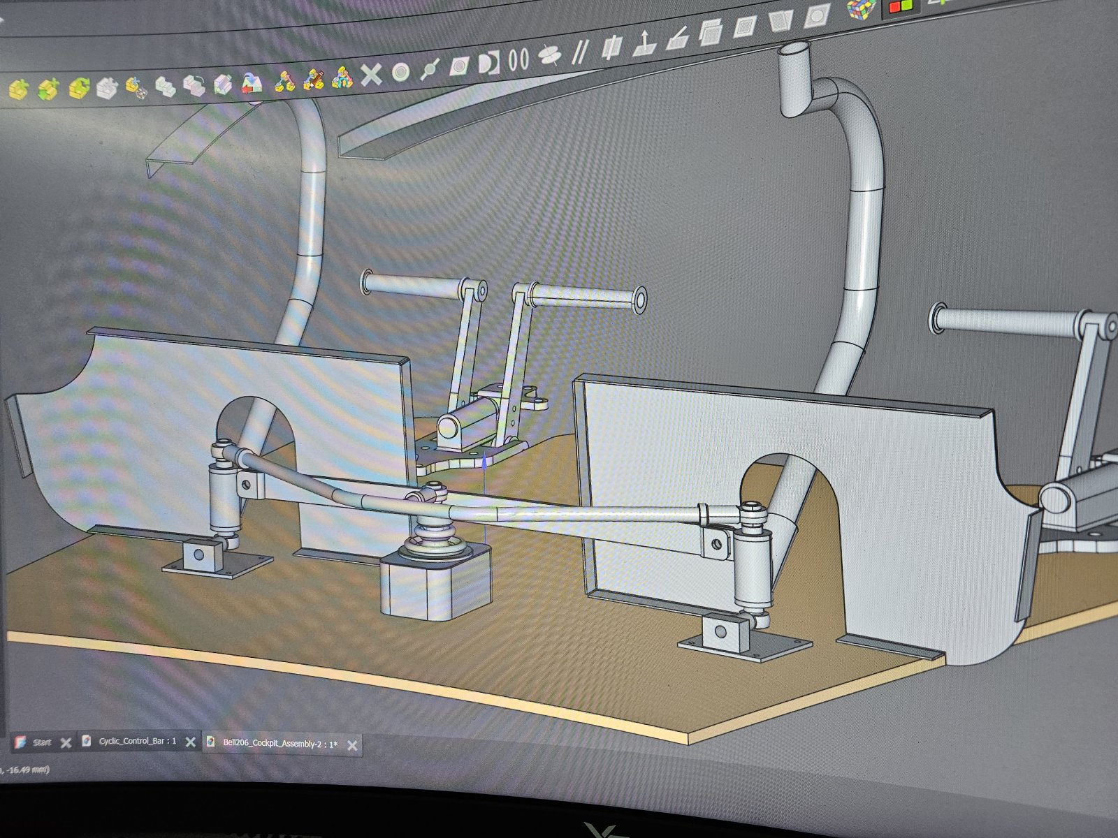

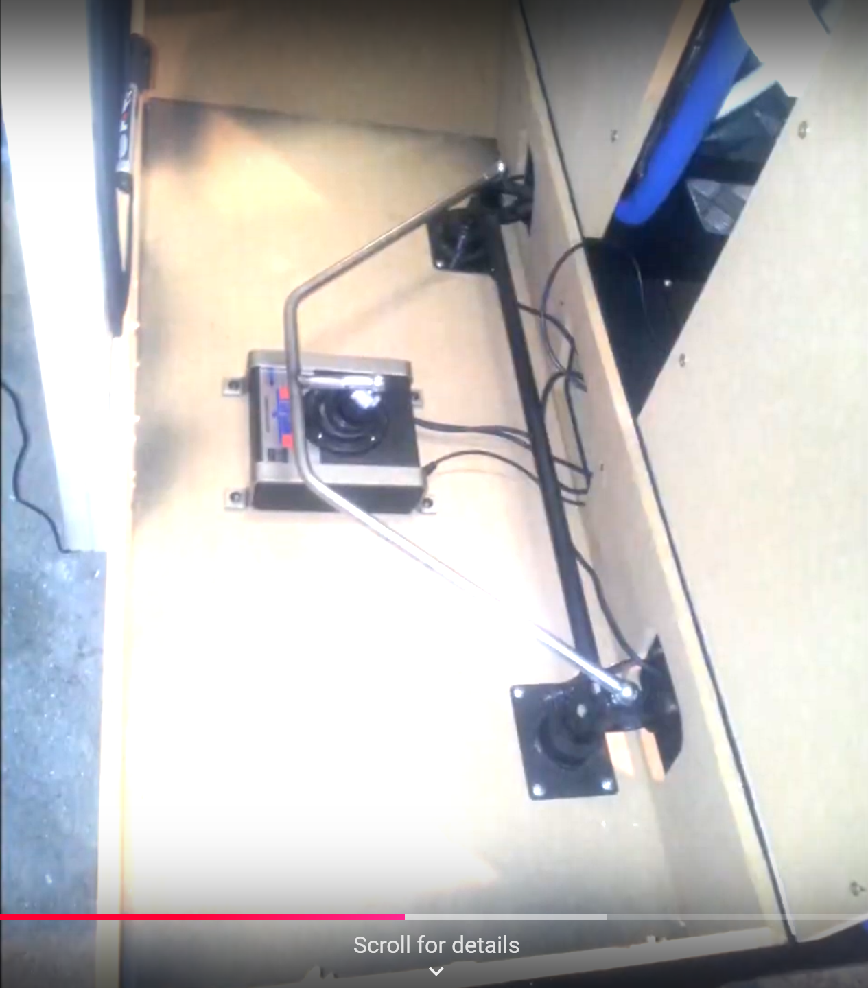

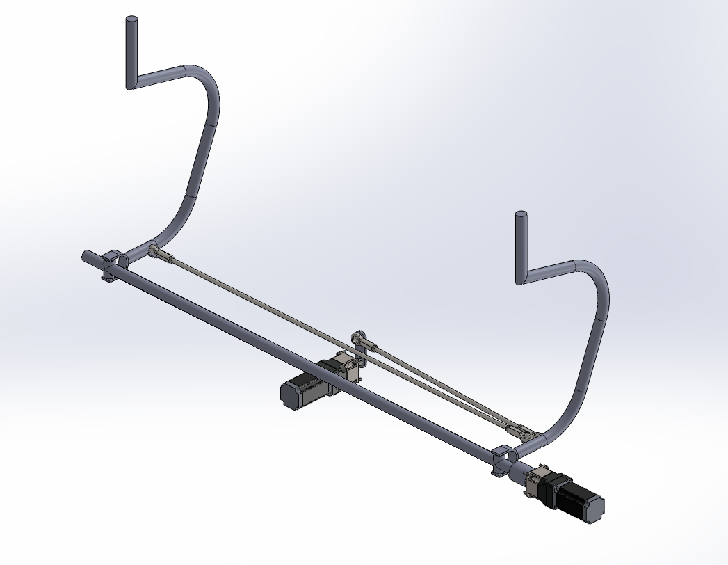

    I can see two cyclic sticks and two pedal pairs in your CAD drawings. Do you plan to couple them together? An instructor/student combination would be really interesting.

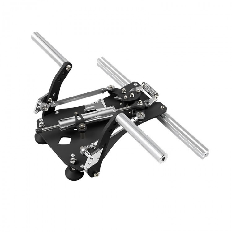

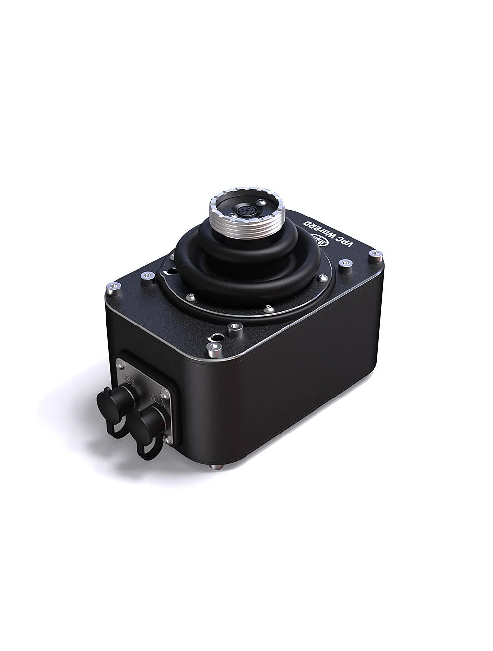

    I found this on the internet,
    which I figure is doable, and I have a Virpil joystick base.

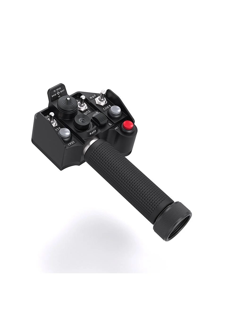

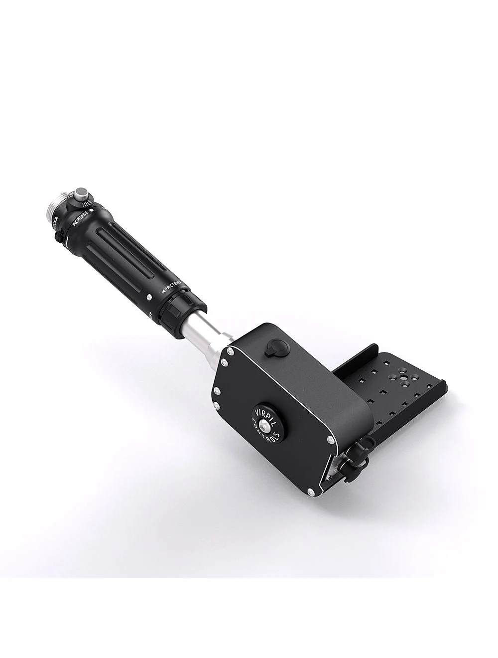

    I also have the Virpil collective, so I may have to copy the basic lever/throttle part (or buy it), then run the tube underneath the seats.
    I'll add those bits to the CAD model as I progress.

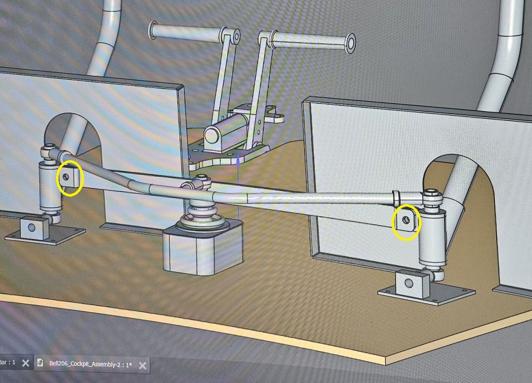

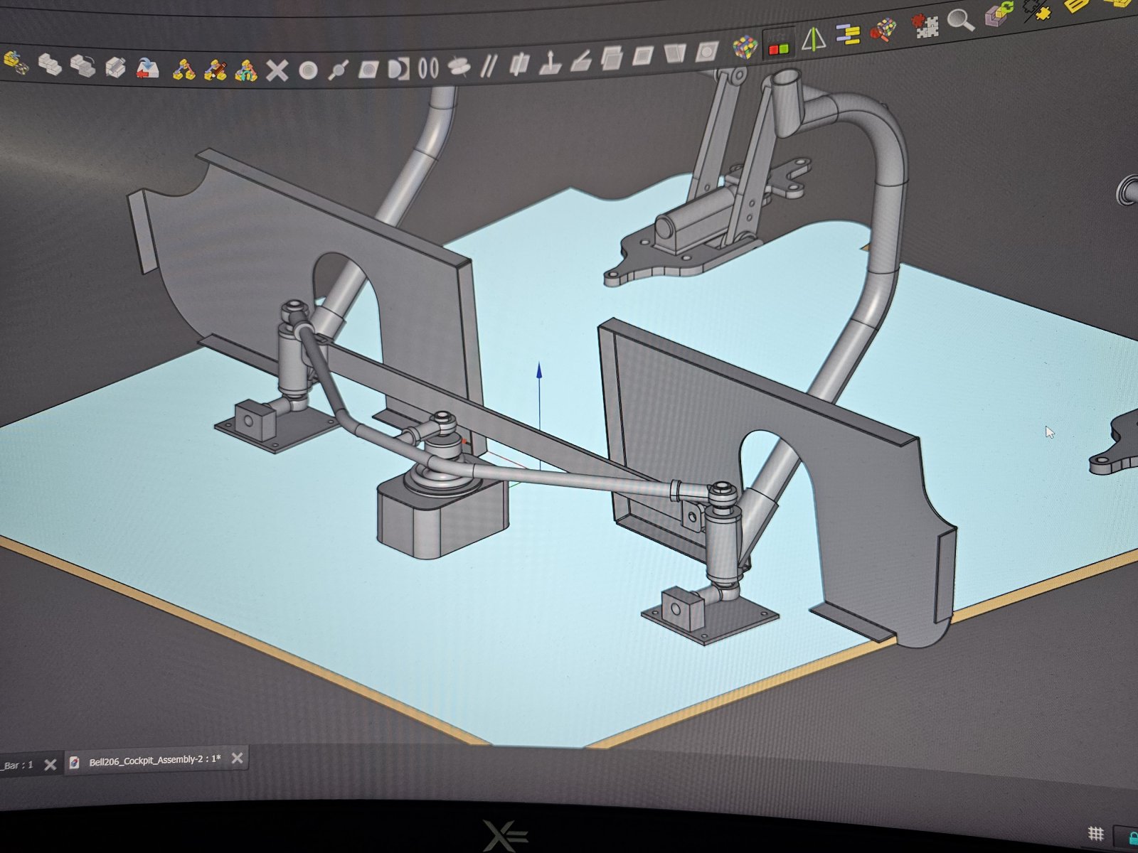

    Cant get on my PC tonight. But heres a few pic s I took to show the lads at work.
    Getting closer to the point where I can start cutting.

    I like the idea of putting the cyclic coupling mechanics under the seats. But is it intended that the joystick box in the middle sees the average of both inputs? The connecting bar made of sheet metal can't transfer any torque so the coupling is not stiff.
    :think
    Also, the ball joints at the base of each stick can't handle torque which is produced by the handle at the top being off-center. So I fear it will rotate around the vertical axis instead of tilting to the left and right.
  8. GettinBetter
    GettinBetter Magna Merchant Gold Contributor
    Jul 22, 2023
    85
    CAD Engineer
    Kent, UK
    477Coins
    +54 / 1 / -0
    The handles are prevented from rotating by the rectangular bar between them, attached by clevises.
    This effectively locks them together regards for and aft movements, and simultaneously for left and right movements.
  9. Aerosmith
    Aerosmith Active Member
    May 30, 2024
    419
    self employed
    2,457Coins
    +249 / 0 / -0
    3DOF, AC motor

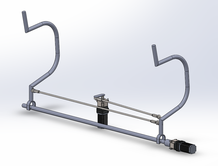

    Yes, should work but IMHO has a weak point:
    The bearings at the connection to the bar have to transfer torque. Even a tiny amount of backlash or elasticity there will make the control feel floppy. And the connecting bar definitely has to be stronger than in the picture, e.g. a stiff tube instead of a stripe of sheet metal.
    I'd do it that way:
    It's like two U-joints but with the inner bearings removed and connected with a torque shaft. The shaft transfers the pitch movement while the pushrod takes the roll movement. This way the torque is transferred with a single solid part with no bearings or joints in between so no backlash and less flexing should occur.
    The pushrod is connected with ball joints like in your design. It can also actuate the joystick box. But I'd make it straight and not bended.

    I agree with Aerosmith's torque tube being necessary. I'll add that you should ditch the virpil and go with VPforce FFB diy motors & gearboxes, so the balance, feel & friction is fully customizable

    Much better. But I'm still confused.:confused:Could it be that the curved stick is rotated somehow by 90°, @smitty ? I mean, the stick can't be moved in the roll direction. It would rotate around the vertical axis, instead.
  12. smitty
    smitty Active Member
    Aug 24, 2021
    149
    925Coins
    +207 / 2 / -0
    haha! yes you are correct, my drawing was quick and dirty, just for the general idea, and i hoped you didnt notice :D
    here's a better geometry
