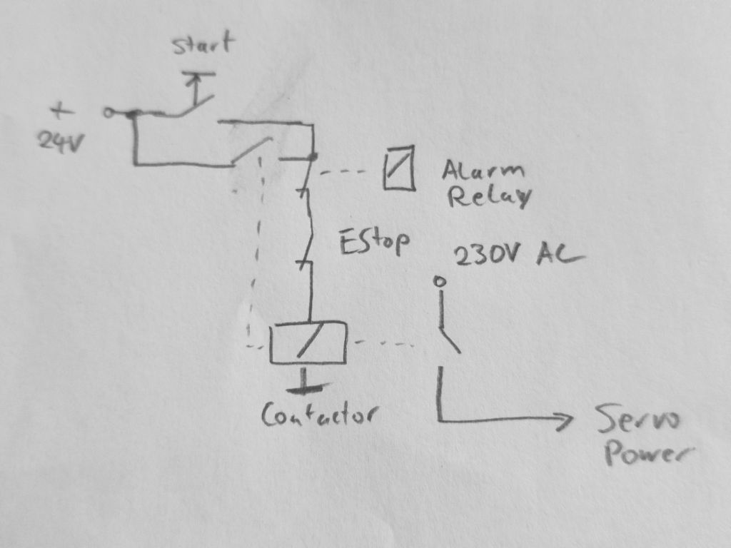

    A simple latch circuit will do.
    Pressing the start button powers the contactor which holds itself latched in the ON position with the NO contact. An alarm or an E-stop will cut power with one of the NC contacts. For the alarm you can use a relay that is powered from all the alarm outputs of the servos in parallel, or servo-ready signals (alarm inverted) in series.

    Thank you, I understand your thinking.
    Looking at the manual, the servos have a dedicated configurable fault output but the circuit board I have, doesn't have any connection to it, and I'm not sure if the cables have been wired internally to use those pins.
    I want to check my docs, and see what I have, before I can create a solution.
    To keep it clean, I'd like to have the servo signal define the fault, and all cabling contained in the existing cables. From memory, I vaguely remember counting the number of wires required and buying a multicored cable to suit. Whether I had any redundancy built in or not I can't remember.

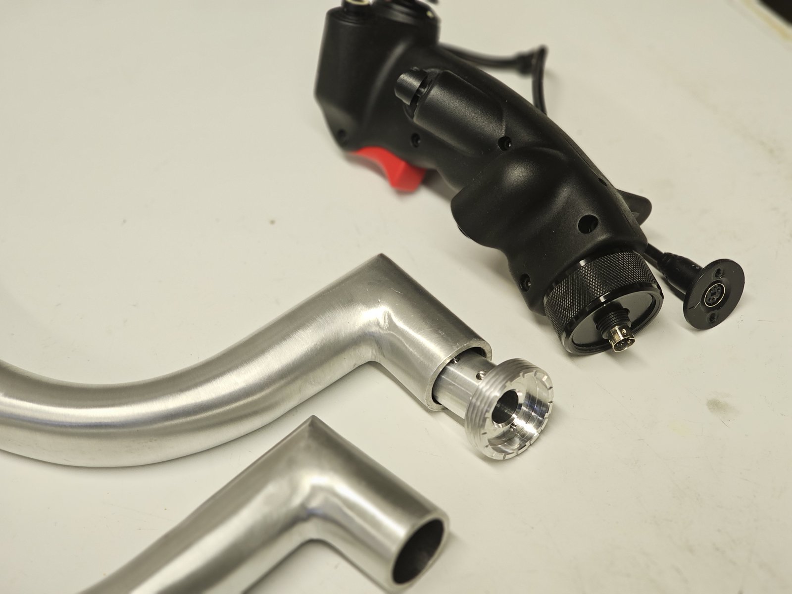

    Got some more bits... not quite finished, but I plan to heat shrink tube them so... they're probably good enough.
    So thought about getting the cyclic control on the top of them..
    Almost but no cigar, so I can either make two new ones that are a better fit, or make one and sleeve the other. I'll see what mood I'm in when the time comes. :popcorn
    Will at some time need to identify the plug/socket to extent them....
    I also need to buy another one, ideally simpler for the passenger side, but looking on the Virpil site it doesn't look like they do one.

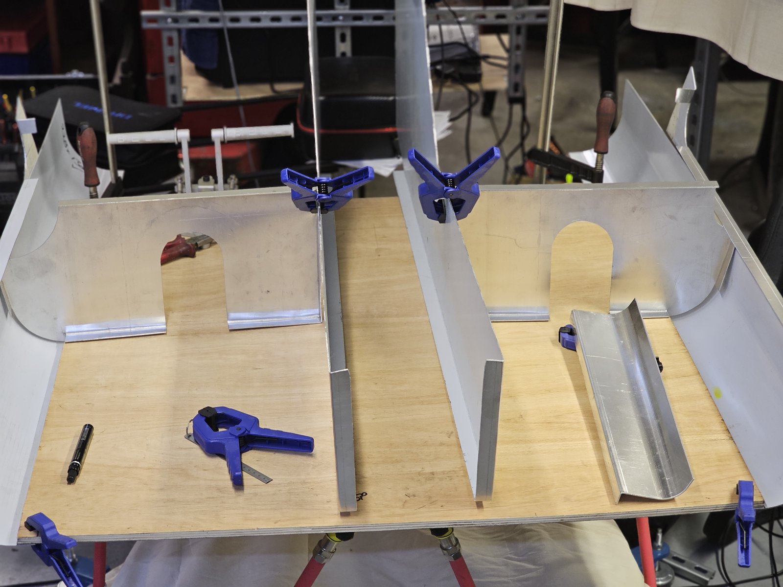

    I thought it must be time for an update.... :popcorn
    Done lots of stuff, but it's all related to the base frame assembly.
    Drilled the top holes in the moving platform & made the gas strut lower brackets to attach the gas struts (at a later date).
    I can't really do it yet as it'll sit too high, because of the lack of weight.

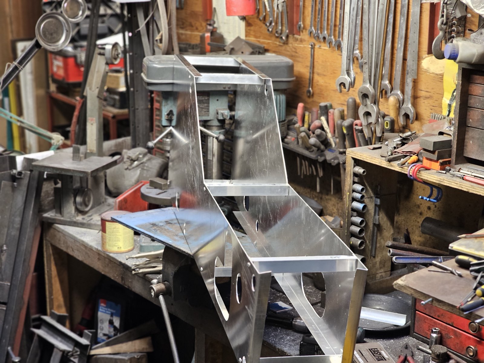

    Having laid the two centre panels out on the wooden base, I was reluctant to start drilling any holes due to them constantly moving, so I decided to assemble them as a complete standalone assembly.
    I made half a dozen spacer brackets to maintain the centre consol at the 210mm as per my survey this should allow the avionics panel to sit correctly.
    It was still bowing in places that were important building to survey, this prompted me to add some angle to the lengths, which I was going to do anyway.
    I have used wooden fixings to see where they came out, now that I see they are accessible, I will replace them with bolts.

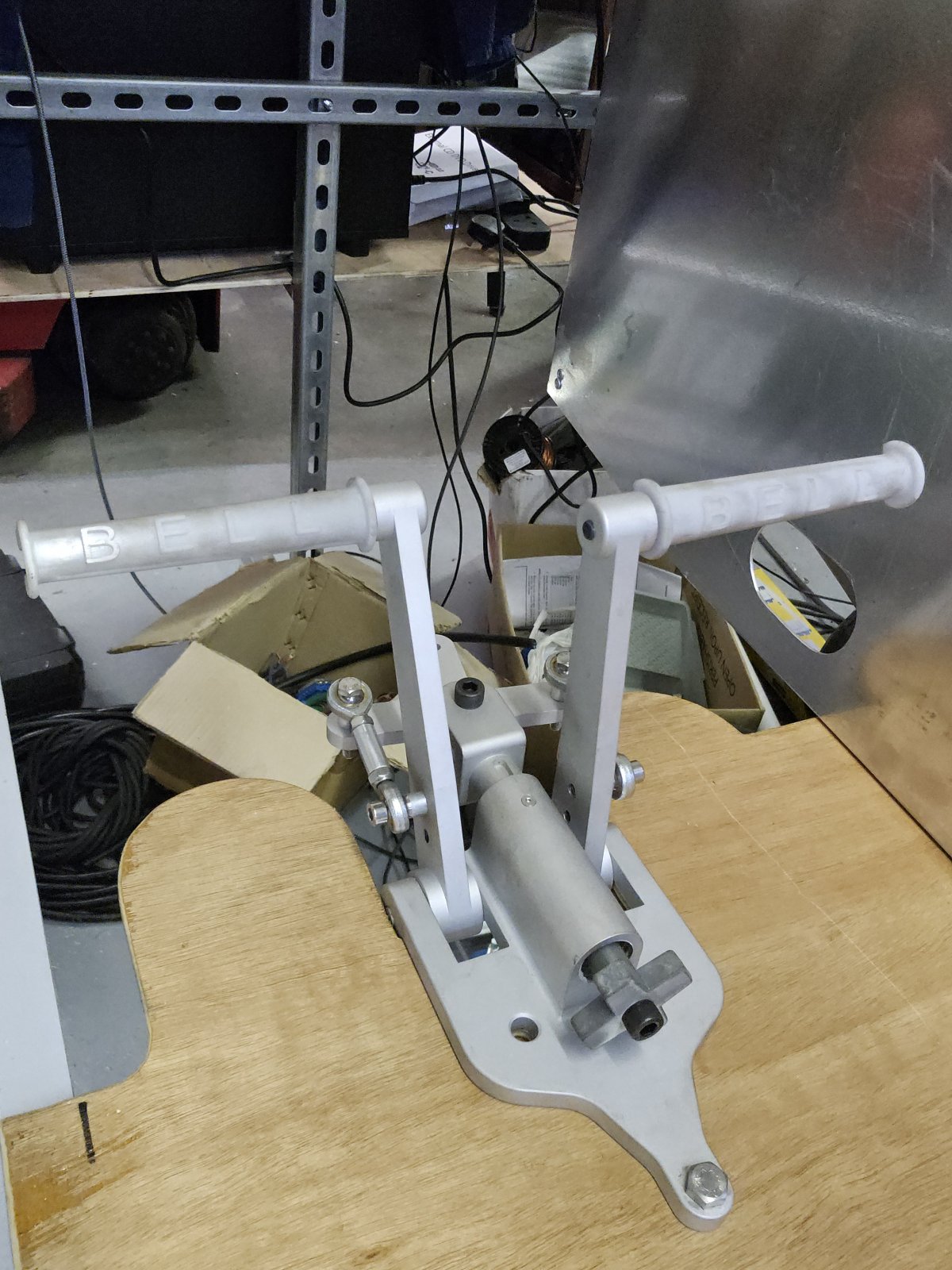

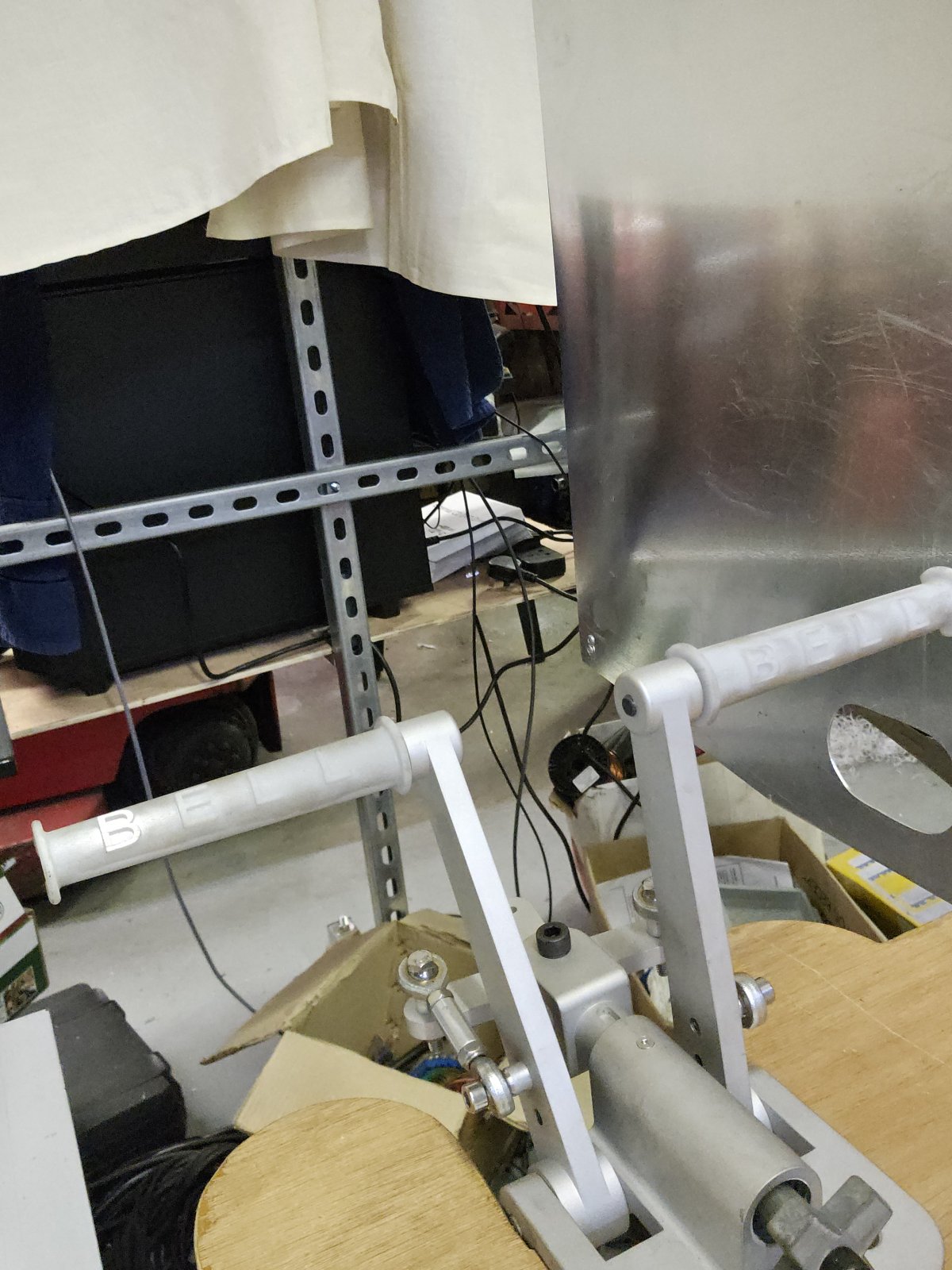

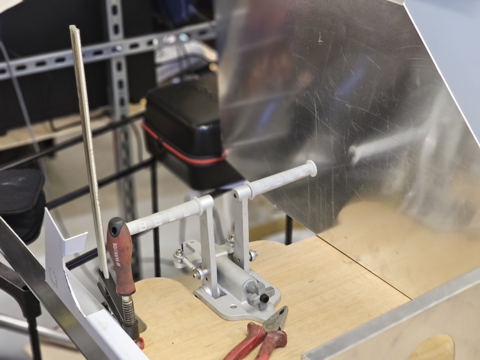

    Pedals all done, with keyway and nylon bearings completed. I'm very pleased with the result.
    I have used some temporary bolts to attach pedals and base, but they will be here by the end of the week and I will replace the temp ones.
