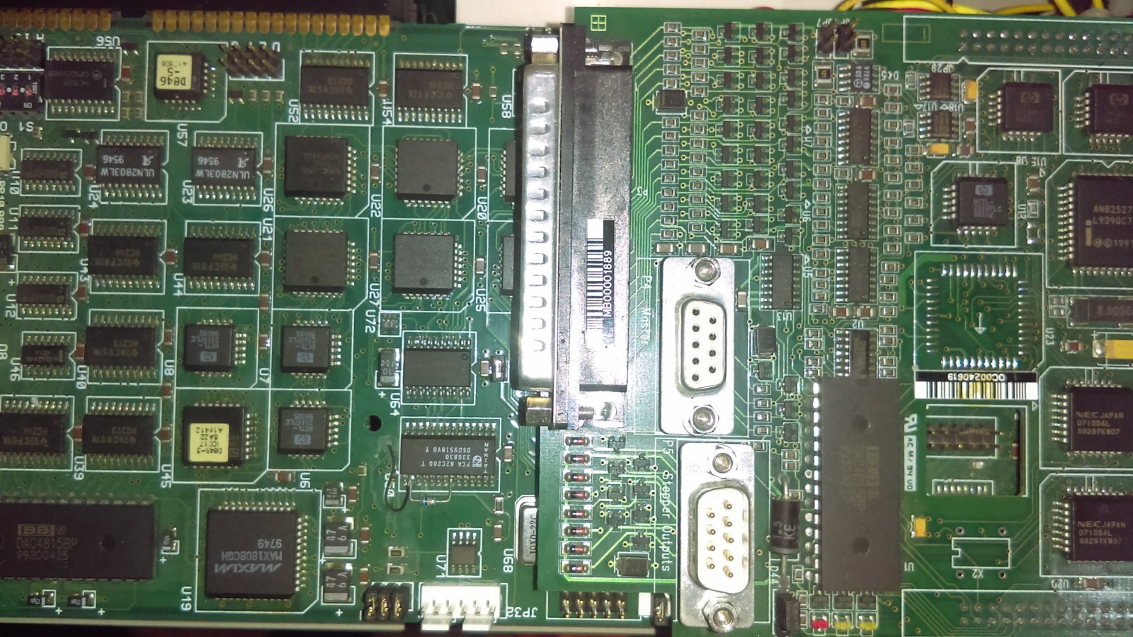

    Came across this document not sure it where you found your info from?

    So got pretty much everyting working apart from hit a slight snag. Hopefully should be a simple fix otherwise im screwed for the moment. The pc which has the mcc powers up but doesnt show the display. Fingers crossed it something as simple as a bios battery or a ddr ram that needs changing.

    You may need a new video card. With a dead battery or bad ram it should still boot into bios settings.

    Ive finally now have the simulator in my possession! It looks like the motherboard is dead on the motion pc so i am currently replacing the motherboard.

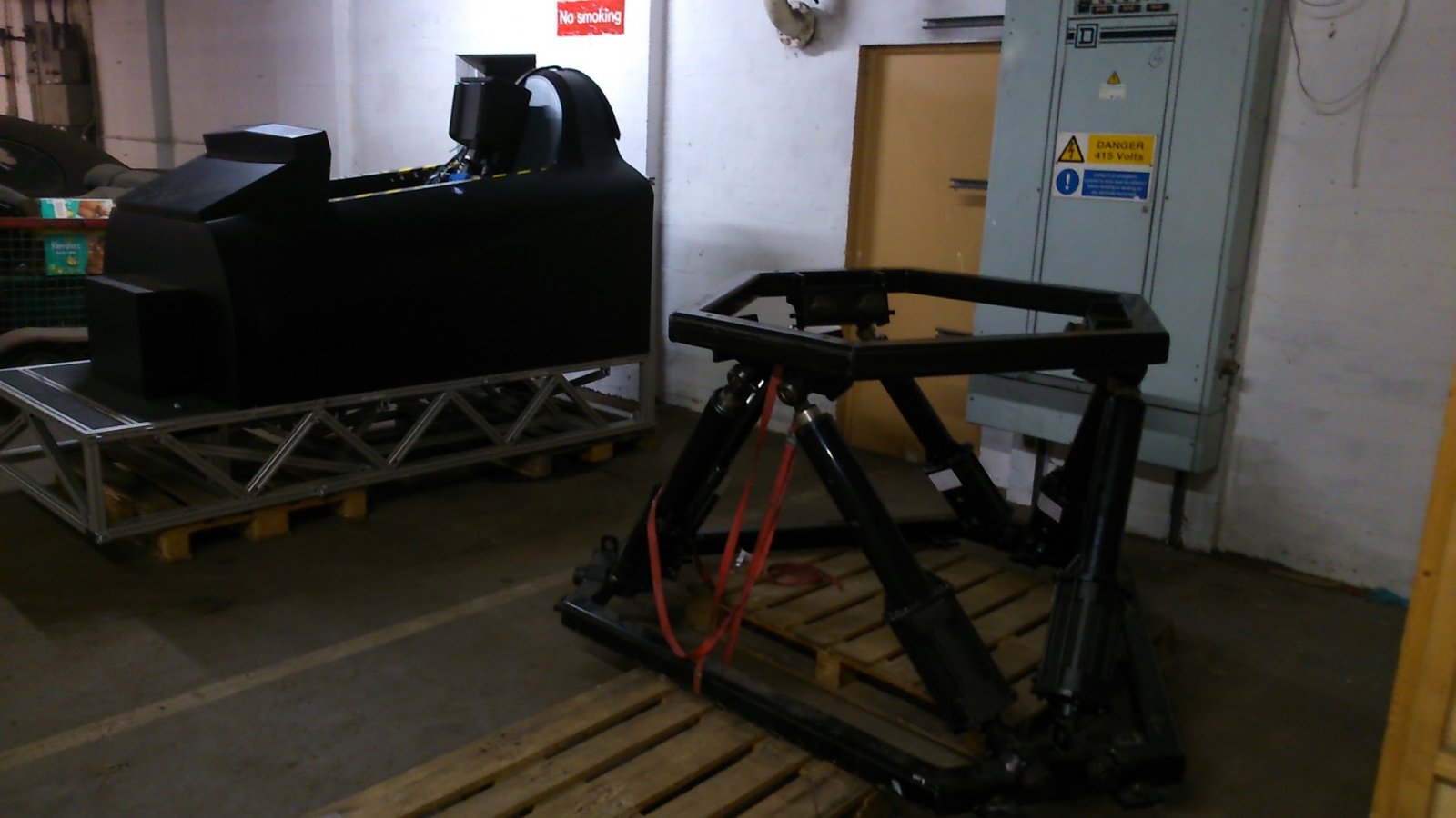

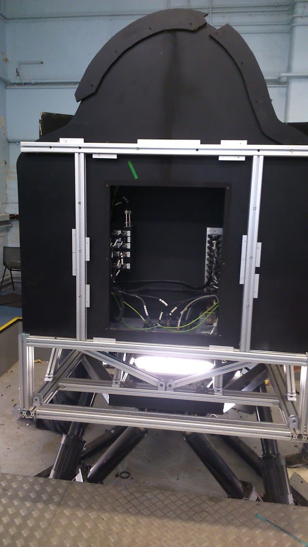

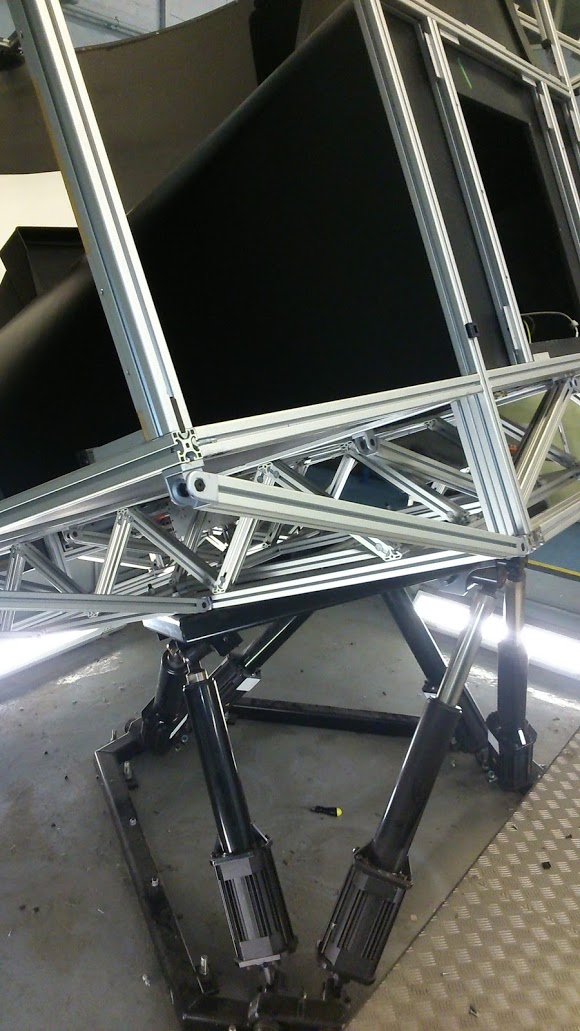

    just a few photos i took while dismantling. Originally the cockpit was fully boxed in with a 4 meter curved projector screen.

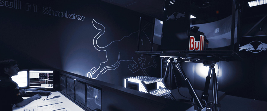

    No updates as yet. Although ive found out RedBull use the same motion base in there simulator! 890_Simulator_Bild_01.jpg

    Wow, this is awesome! how lucky are you!!

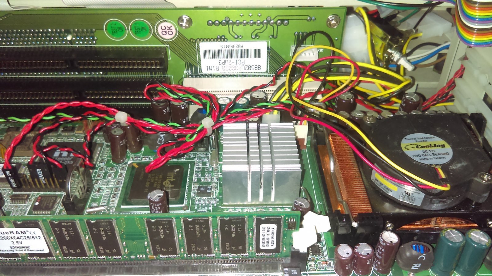

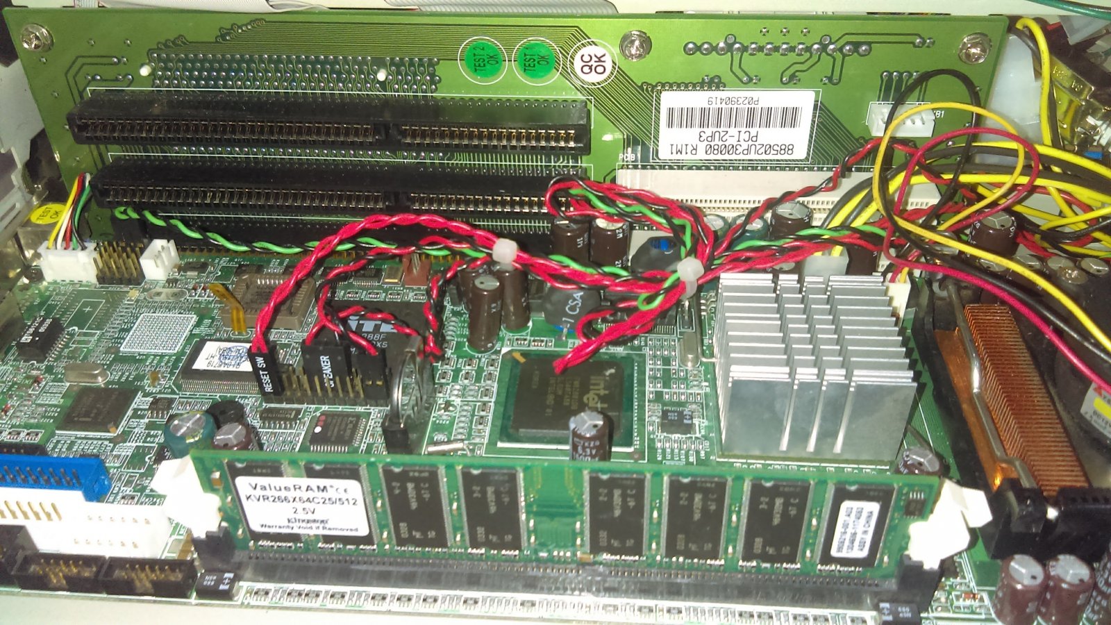

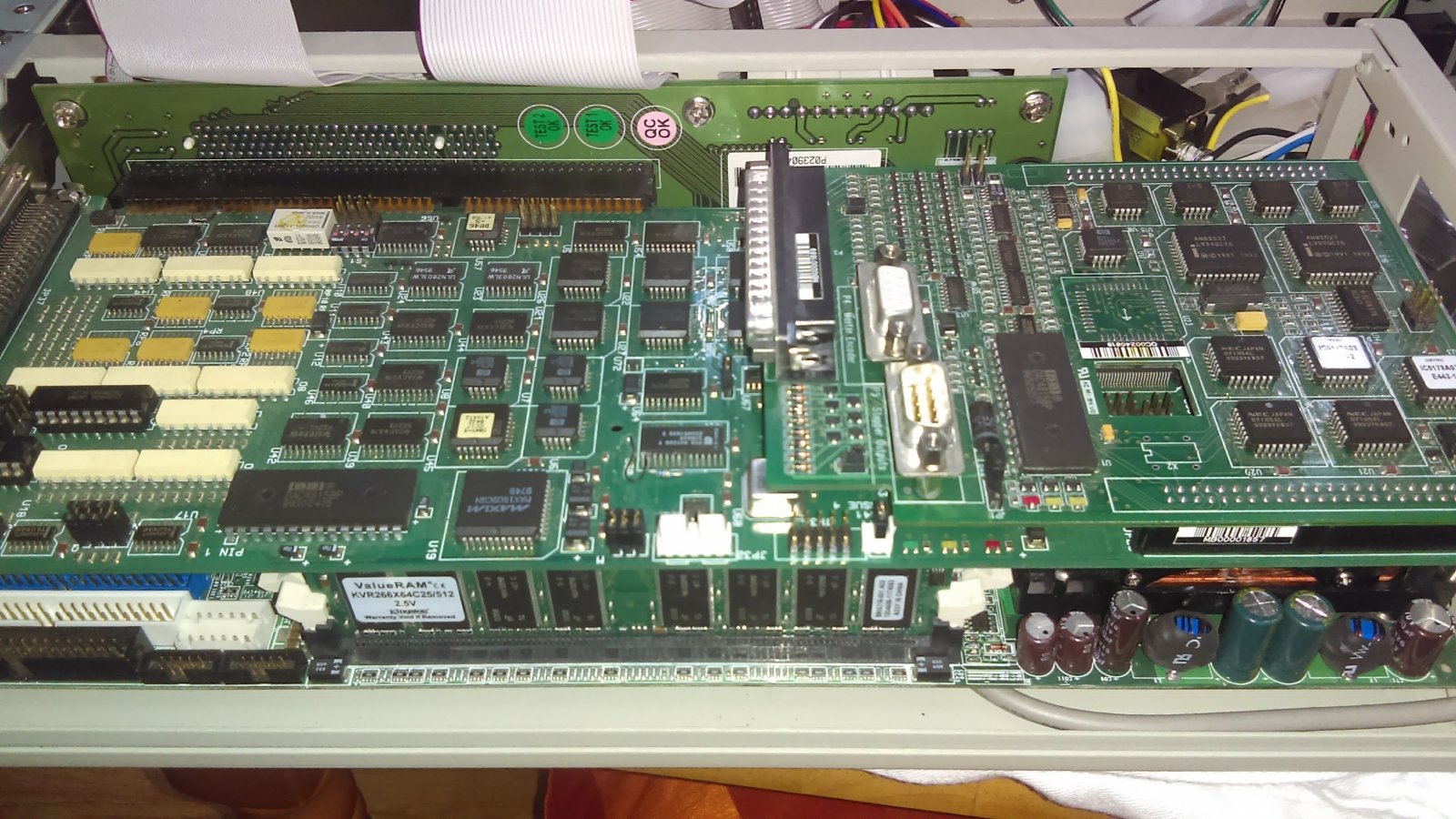

    so still working on this arhhh!!! It seems the motherboard is an industrial isa slot one with a built in graphics card ! Any ideas anyone?
  20. SeatTime
    2,572
    May be easier to get rid of all the old stuff and just replace it with modern equipment that has a known configuration. Although I'm not paying the bills :p.
