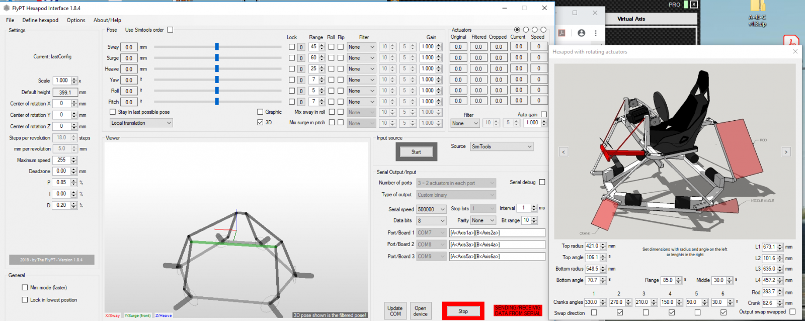

    So, I tried out FlyPT but with a minor disaster. The good news is that after welding on some reinforcing steel brackets the gas struts should be more secure. Lots of reinforcing steel....lots. Like, a obscene amount of steel. There is now an official shortage of usable steel in this part of the country.
    Not sure what I did wrong, as soon as I turned FlyPT on the motors went nuts and moved far past their software stops, and kept going. It was odd. I am sure it was my fault, just need to double and triple check my settings. And then toss them out and ask someone who knows what the hell they are doing to check them for me. :D

    You might have used the wrong bit range or type of output!
    If you have a picture of your screen to show (and measures of rig) I could take a look.

    @pmvcda I figured out my issue! (ok, one of many many issues at least).
    The Crank Angles in the define hexapod screen had me confused. I assumed that it meant the angles between the cranks and the rods. I had to set up the angles between the motors and the base. Once I had those done and set all movement to 10 (to start) I was able to get it running very well. This is a really impressive interface for 6DoF rigs. HUGE thankyou! (and of course if I come across you in Europe this summer you are entitled to a hug) :D

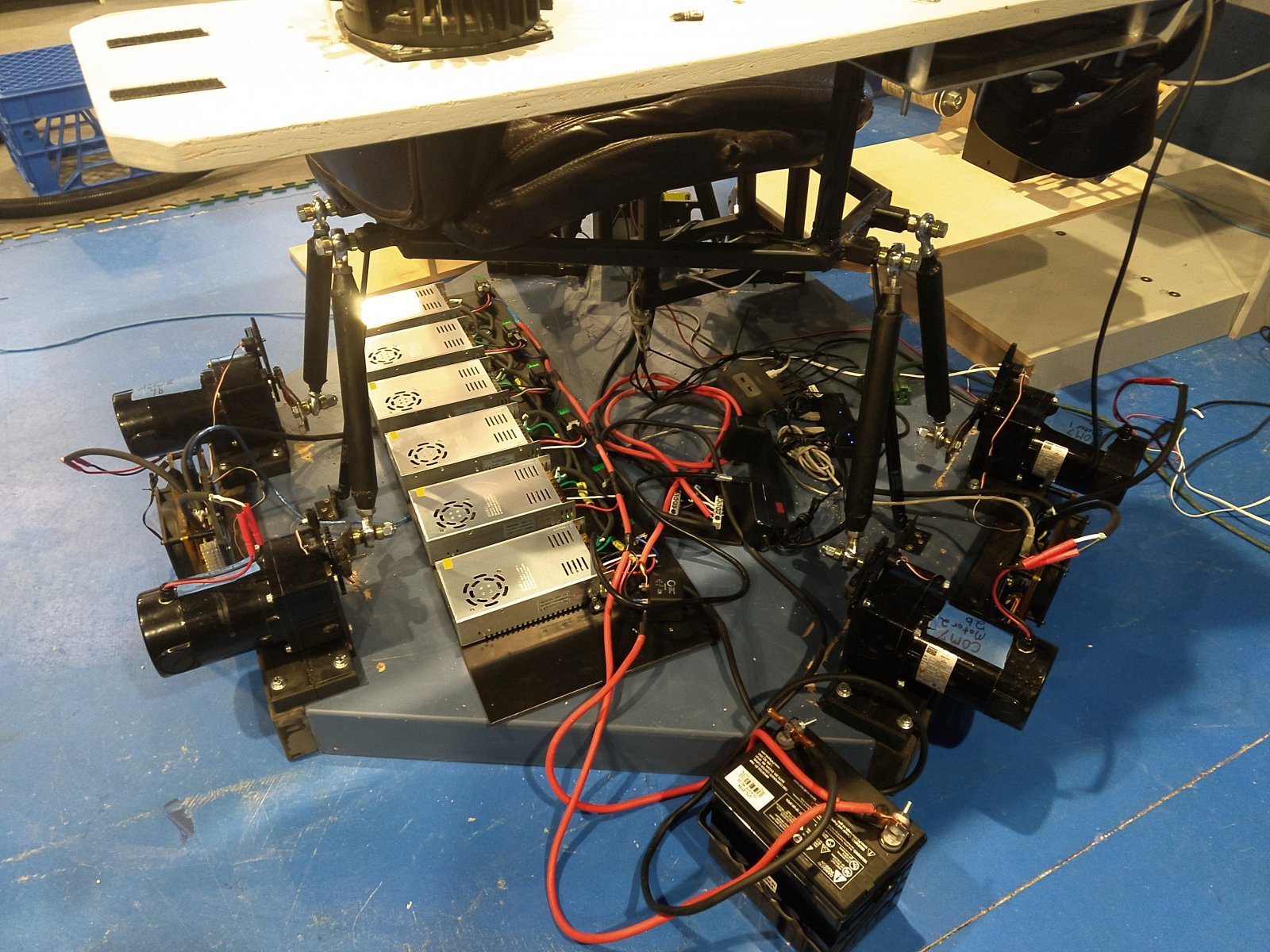

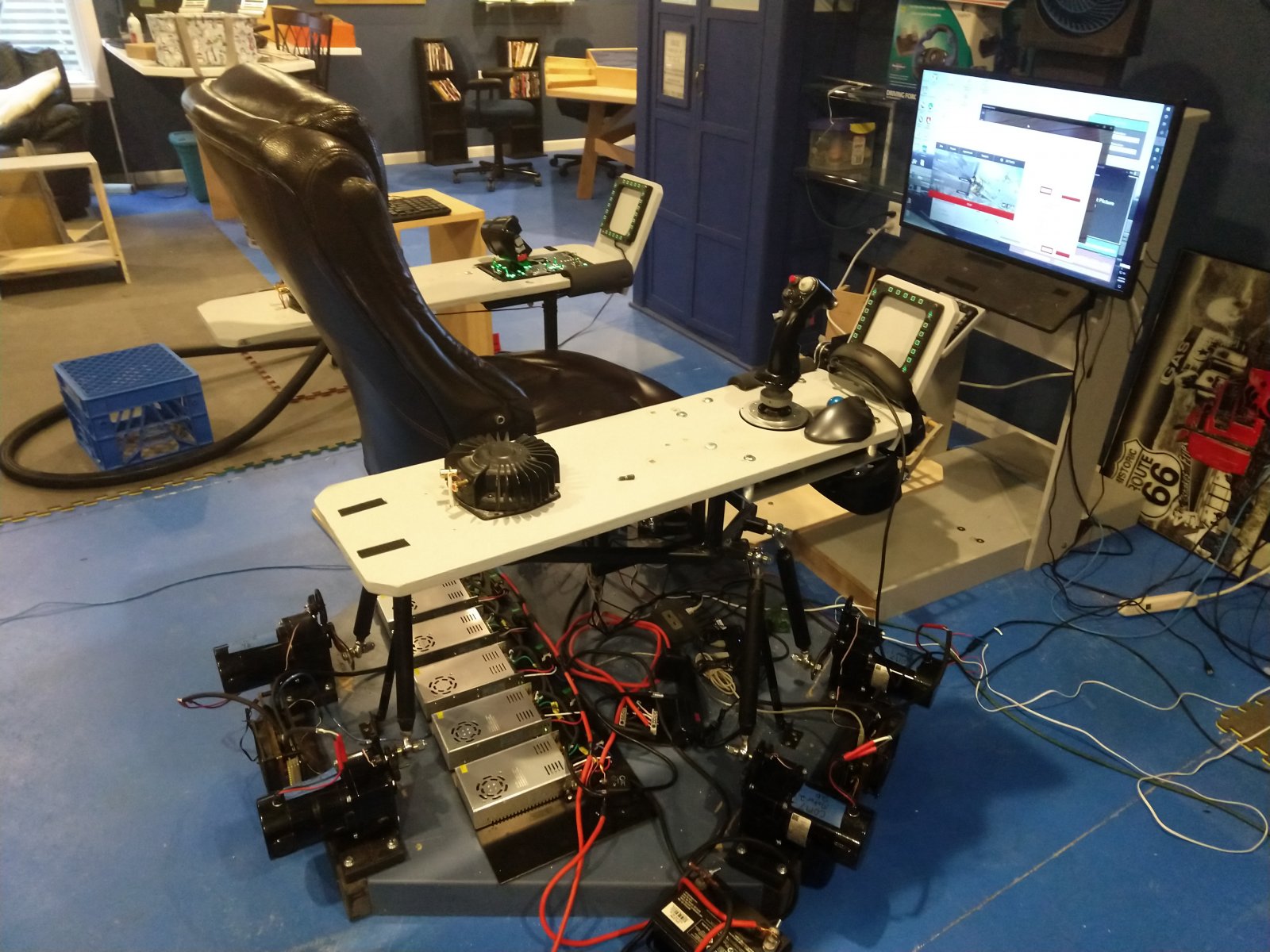

    It is finished. I wired up the power supplies and battery. Each power supply has a 30amp fused relay and they are connected to the battery which is then connected to the saberteeth via a 200amp relay. This way when it is shut off the battery isn't back feeding into the power supplies.
    The power supplies have their own mounting panel which will be moved, eventually, to a small cabinet that will reside between the two 6dof motion rigs. I will have a switch so I can use them for wither rig.
    Another HUGE thank you to everyone for their kind words and ideas, but especially for their experience.
