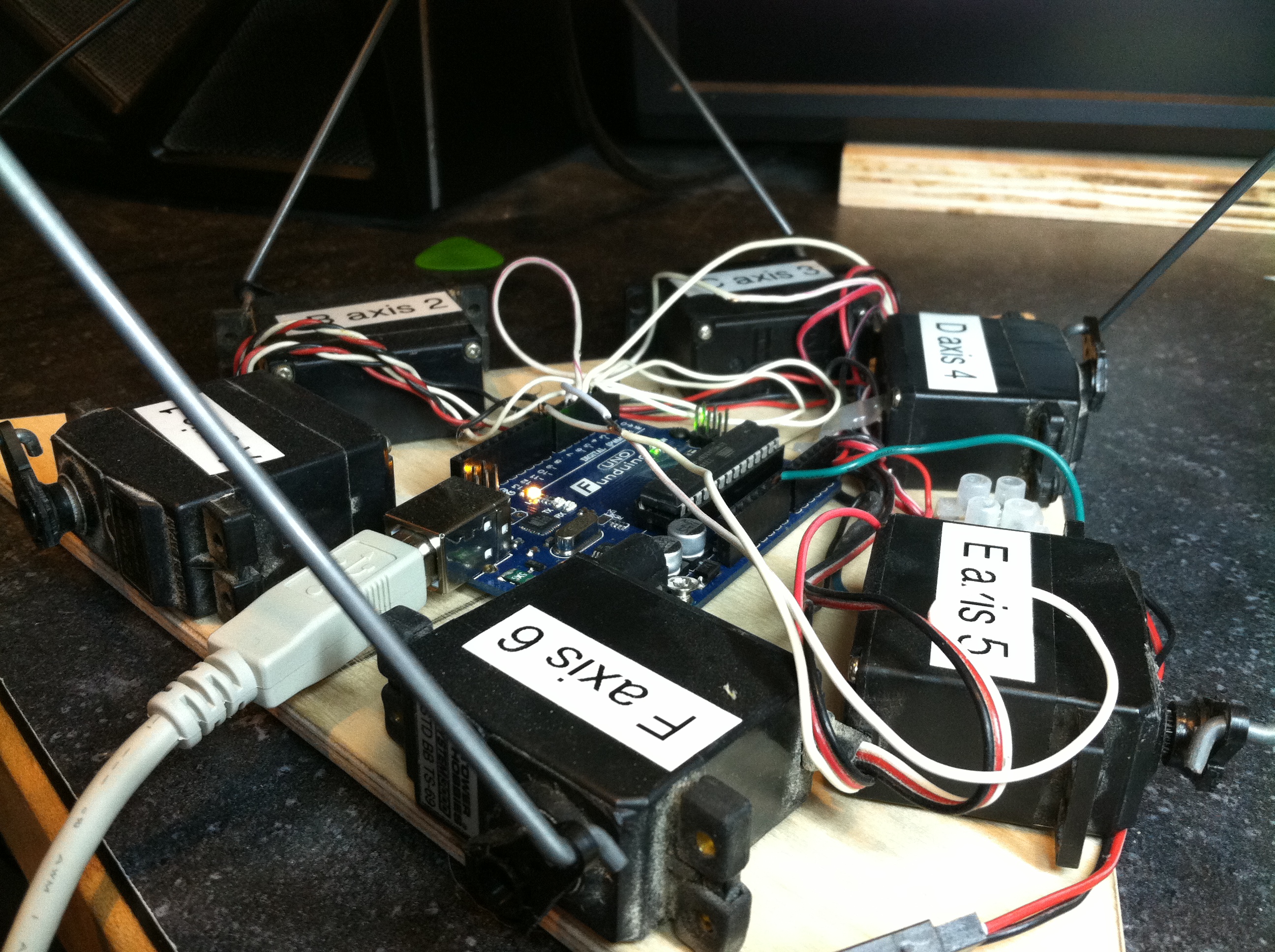

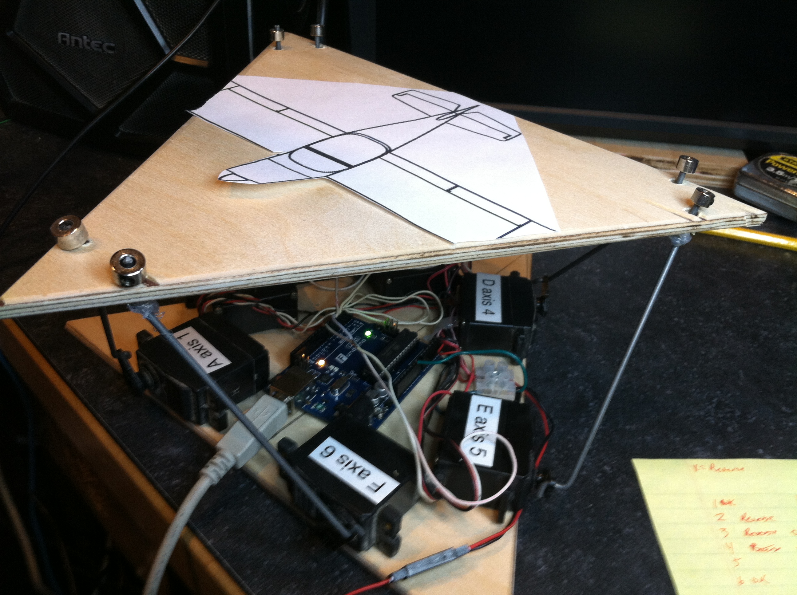

    Here is a short video of the test platform in miniature that I built today. Mostly I wanted to do a proof of concept that would allow me to work with 6DoF setups in SimTools.
    The servos are Futaba 148 types (also known as 3003) controlled by an Arduino UNO and and edited version of Eaorobbies excellent servo motion platform sketch. I changed the servo names from R and L to A, B, C, D, E, F etc.
    Tested in Simtools by changing the default assignments (axis) it worked perfectly by changing the slider positions for each DoF. In the game of DCS P-51 however I noticed that heave, roll, pitch and yaw worked but surge and sway did not seem to. It might have been that I just did not see them with the other movements and of course I did not remember to let it adjust the min/max settings. I might redo the video at some point after I do that.
    All together I am very happy with this test. Simtools works flawlessly and is simple to set up!

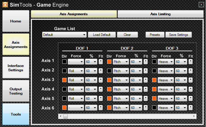

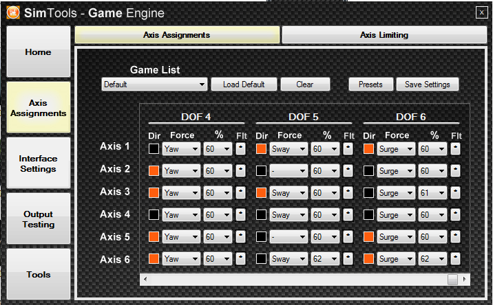

    A fellow member has asked me for my axis configuration for 6DoF so they can use it in their own experiments with Simtools.
    Here are both the Axes Config and the interface Config. I included the interface so he could see how I have my axes lettered A-F. This will not work for everyone as they may be using more than one controller or their axes naming convention might be different. It is just an example.
    The same is true of the axes themselves of course. If you have a different motor configuration or your motors are reversed from what I have you will have to tinker around with them.
    Included is a picture of how I have my servo motors configured and which way is forward (notice the plane drawing on top of the platform).
    The best help would really be a video showing which motors lift the platform, which stay stationary and which lower the platform for each degree of freedom. I have so little time these days that I doubt I will be able to get to that any time soon, sorry.
    As far as axis percentages I just set everything to 60% on each axis for testing.
    Once I have a usable full scale platform I will post more detailed profile settings, etc.

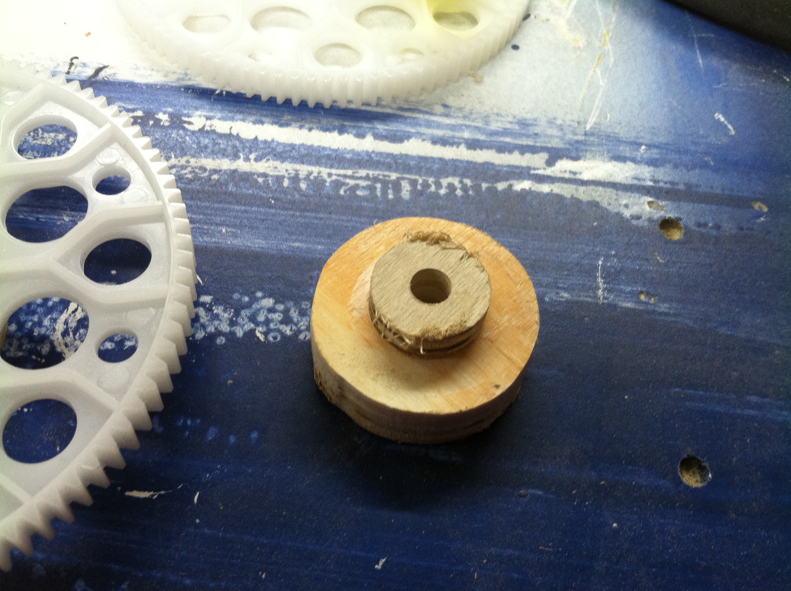

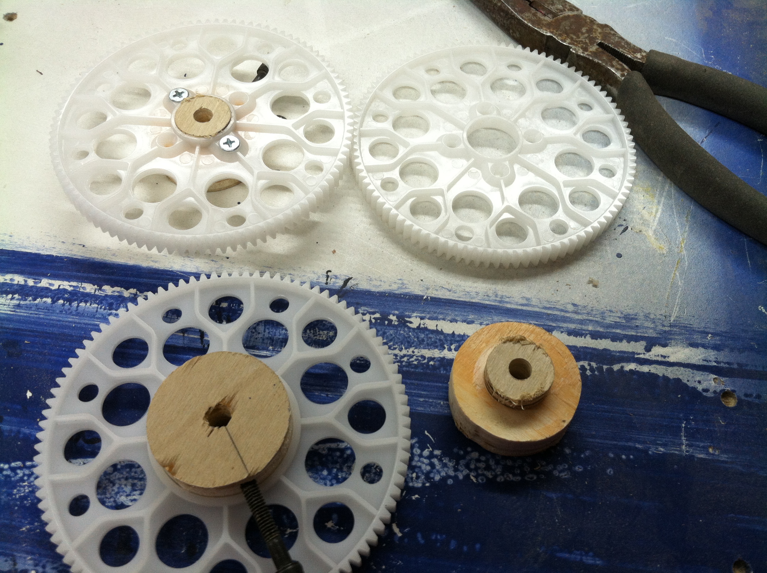

    Slowly getting parts together to complete this build.
    I have all of the winch motors (thanks to the Menards 11% off sale), gears, steel, Heim joints, steel pipe, and Arduino microcontrollers that I need.
    Still need two more 10k 10-turn pots, two more motor drivers (looking at the cheap Chinese drivers that RufusDufus points out in his Arduino thread).
    I made these today to connect the potentiometers to the gears: (see Rene? I am dragging and dropping my pictures directly into Xsimulator, happy? :grin) IMG_0583.JPG IMG_0584.JPG IMG_0582.JPG

  19. RaceRay
    Nov 8, 2006
    4,658
    Hamburg, Germany
    23,884Coins
    +2,094 / 13 / -0
    Great to see you are doing progress and i am very delighted about your dragged and dropped images mate;)
