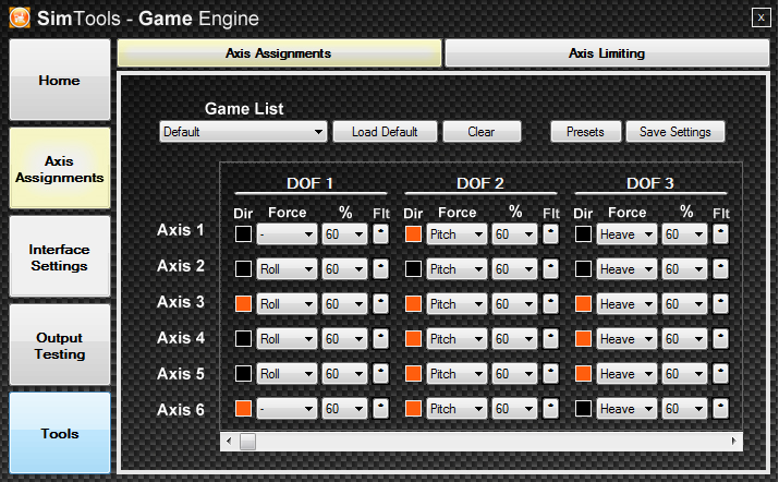

    Hi Hooshang, thanks for the questions.
    On the Simtools configuration; you can find that information on page 2 but to be honest it will be slightly different depending on how you have your axis named, etc. The info on page two will help with configuring your axis.
    If you are using multiple controllers, like this project does, you will need to set each one up in "Interface Settings" in the game engine window. For this project I have three Arduino Uno micro controllers. All three are set up in Simtools as SER output types, then each has a different interface tab (1-3) where I input the correct comm port for each. Since I am using Prilad's Arduino hex code I use his Simtools settings but assign each separate Arduino with different Axis commands. Arduino Interface tab 1 will have Axis1 and Axis2, Interface tab 2 will have Axis 3 and Axis4 and so on.
    I am in my office right now but later, from my shop, I will save and upload my interface settings.

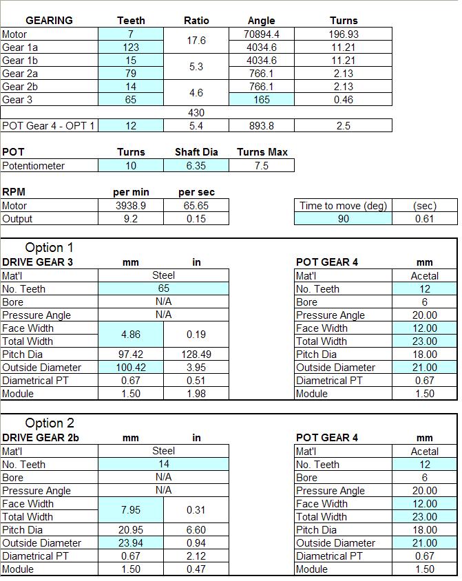

    Not at all sure what the torque is but here is the data shared with me by a fellow Simtools member about these winch motors. I hope he (@boosted-lt1 ) does not mind me reprinting it here.
    Much of what he is discussing is about the potentiometer gearing but there is a great deal of valuable info there. He did a lot of work and deserves a round of applause.
    Anyway, I hope this helps to answer your questions.
    Basic info:
    • 430:1 final gear ratio
    • ~9 RPM output gear speed (based on book speed of 6ft/min and assuming a 2.5" spool diameter). I guess I'll probably measure the actual as well!
    • Output gear is Module 1.50 (so any metric 1.5 gear will mesh). A 12 tooth pot gear would give about 2.5 turns. I suspect you may be running yours off of 'gear 1' with potential for more turns on the pot. I started looking at driving off of the final output 'gear 3' thinking that is the gear that provides the most torque so impact of the pot friction could be minimized. I may look at other drive options though and will keep your spur gear insert in mind for sure.

    this configuration seems smooth and you have 6 axis that each get information
    and work separately, but in 6d0f (stewart platform) supposed all axis
    work and move together how do they synchoronize with each others ?!
    waiting to see your Axis Assignments setting picture,probably it can help
    much.
    thank you for answers again and make it clear the real RPM,9 which works
    for you and around 15 which work for me and not 60 and 80 and 180...

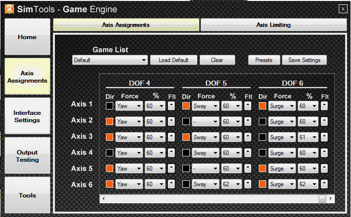

    Hi Hooshang,
    Everyone has their opinion as to what is "correct", I just let my butt decide, lol. I am also an R/C pilot, and focus on WW1 planes. You will hear loud, and sometimes violent, arguments about the proper shade of PC10 (UK WW1 camo color prevalent on most of their planes at the time). Personally I believe that the correct anything is up to the person who owns and enjoys the platform (or airplane).
    On page 2 you can see the axis settings, they work very well. With 6DoF not all axis are moving for a particular direction of movement so those axis are turned off to perform that movement. Roll for instance does not use axis 1 or 6 allowing for a pivot point.
    Simtools takes care of synchronizing the axis, as long as the output data from the game is good then the motion should work, and of course the plugin has to use that data.

    I am actually using the old winches for what they were intended; putting my 2DoF platform back together.
    Another thing to consider is the data that @boosted-lt1 passed on to me above, the pot gears must all be the same to get the same amount of movement out of all six winch motors at the same time.
  9. eaorobbie
    20,491Coins
    +1,687 / 23 / -2
    I measured my winches to be a lot faster , but they are a similar make but not the same as you have. Have you actually tested them , IE count the turns in a minute of time under full power - recommended 13.8v which they are designed for. Would be interested to know.

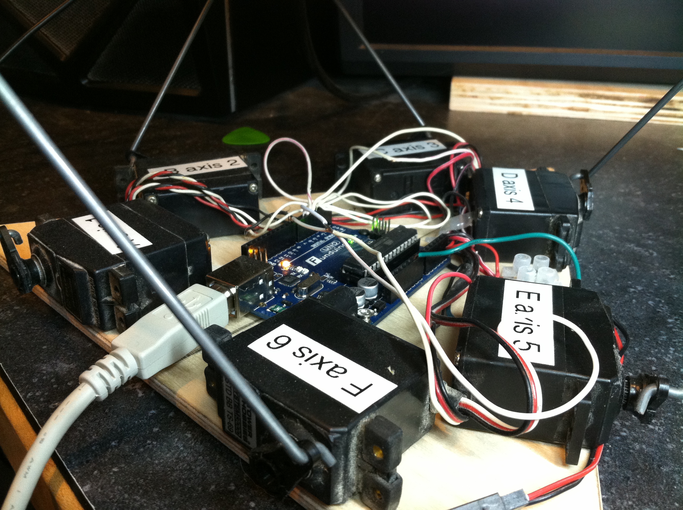

    Hi Historiker
    thank you for information and also your advice ,we all sharing our experience(to me just problems:grin) to help others,it helps community grow
    all seems going to be smooth now.i am going to start my 6dof project too. one more thing! ,I also saw your set up with RC servo, would you please tell
    which code do you use for your Arduino uno.
    thanks a lot friend.your information got a lot of help.

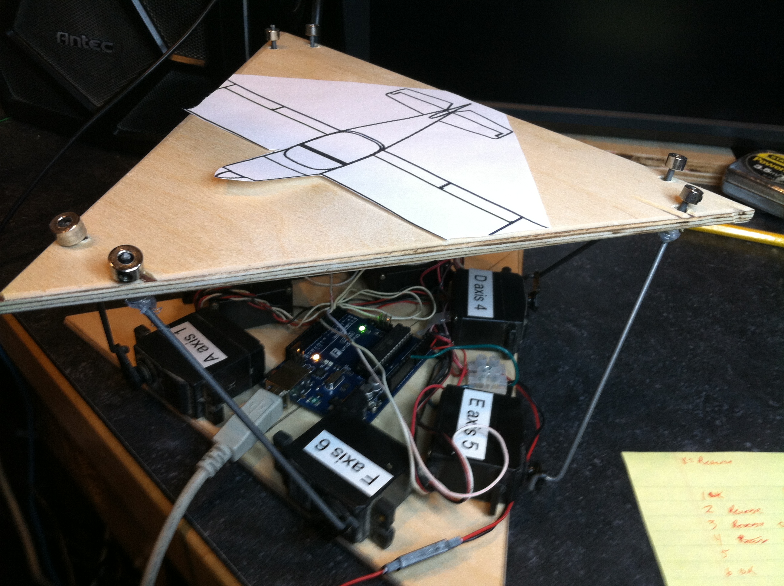

  11. Historiker
    2,162
    9,214Coins
    +2,170 / 19 / -1
    Hooshang, I edited a version of Eaorobbie's two servo code. I believe he has released an updated version of the code to include six servo functionality. I do not remember where he had posted it though; Rob could you throw up a link?

    164Coins
    +12 / 0 / -0
    Hi, I want to build a 6 DOF platform with only servo motors. But I do not know what firmware I have loaded into the Arduino. Just one that can be downloaded from this site? Because i have in my Arduino firmware for controlling two motors.
  18. berty
    berty Member
    Sep 10, 2014
    72
    164Coins
    +12 / 0 / -0
    Hi, Please do some more detailed scheme to involve the servo to arduino you could not see? Sorry for my english.

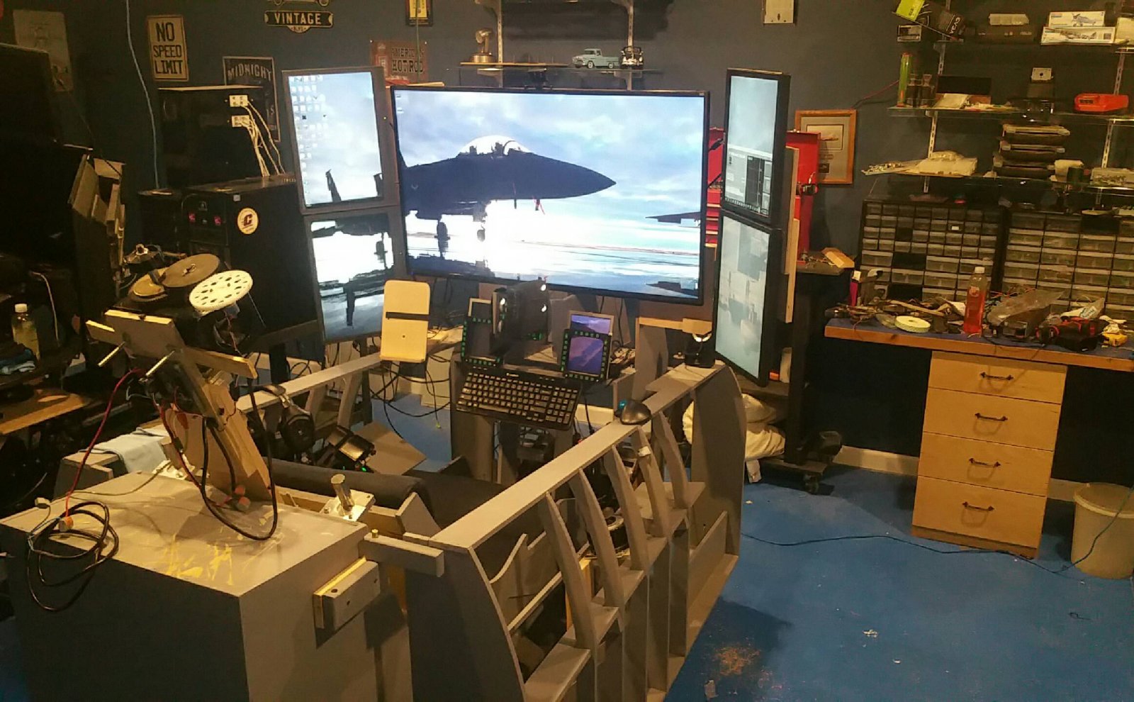

  20. Historiker
    2,162
    9,214Coins
    +2,170 / 19 / -1
    Never did get my flight motion pit up and running. I have bagged it until..."someday". I still have a flight pit, this is what I am sitting in right now.
