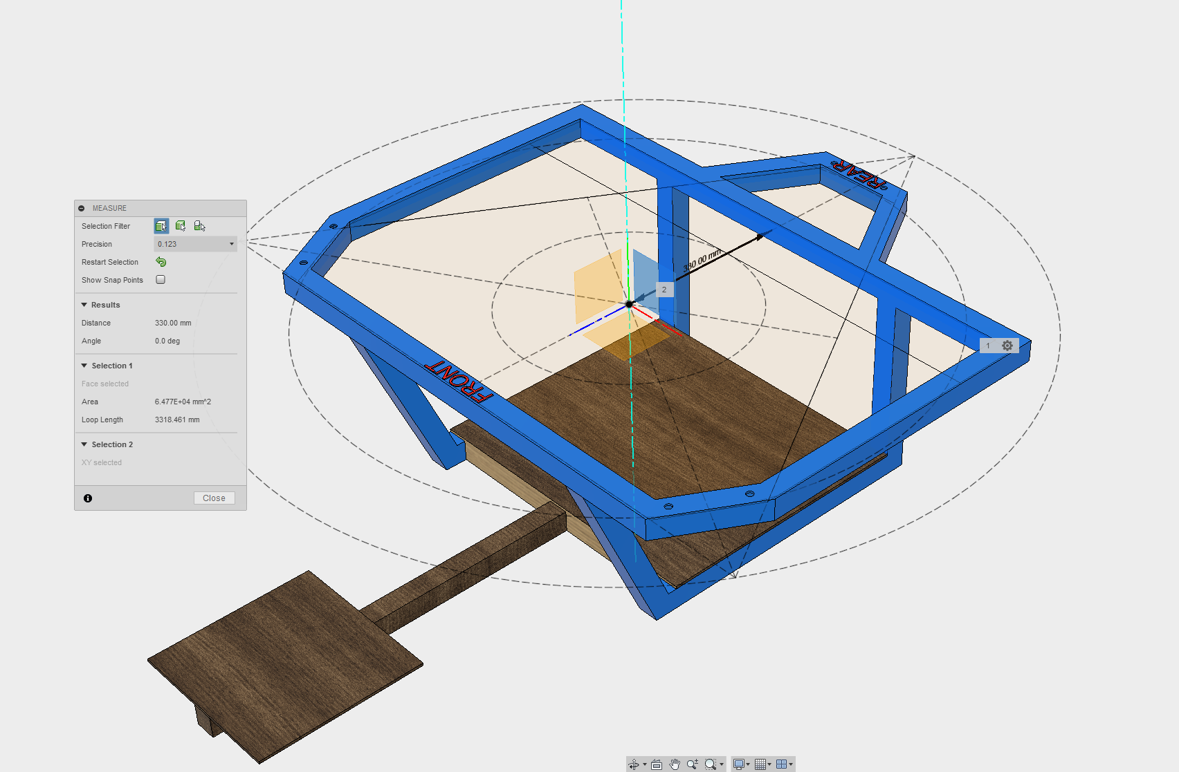

    the other problem of my rig is that I only have 200cm between ground and top in my room
    I made a design like this but I really don't like :

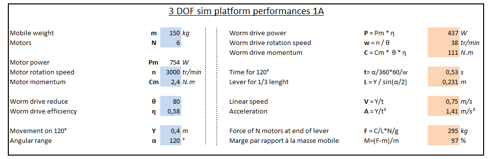

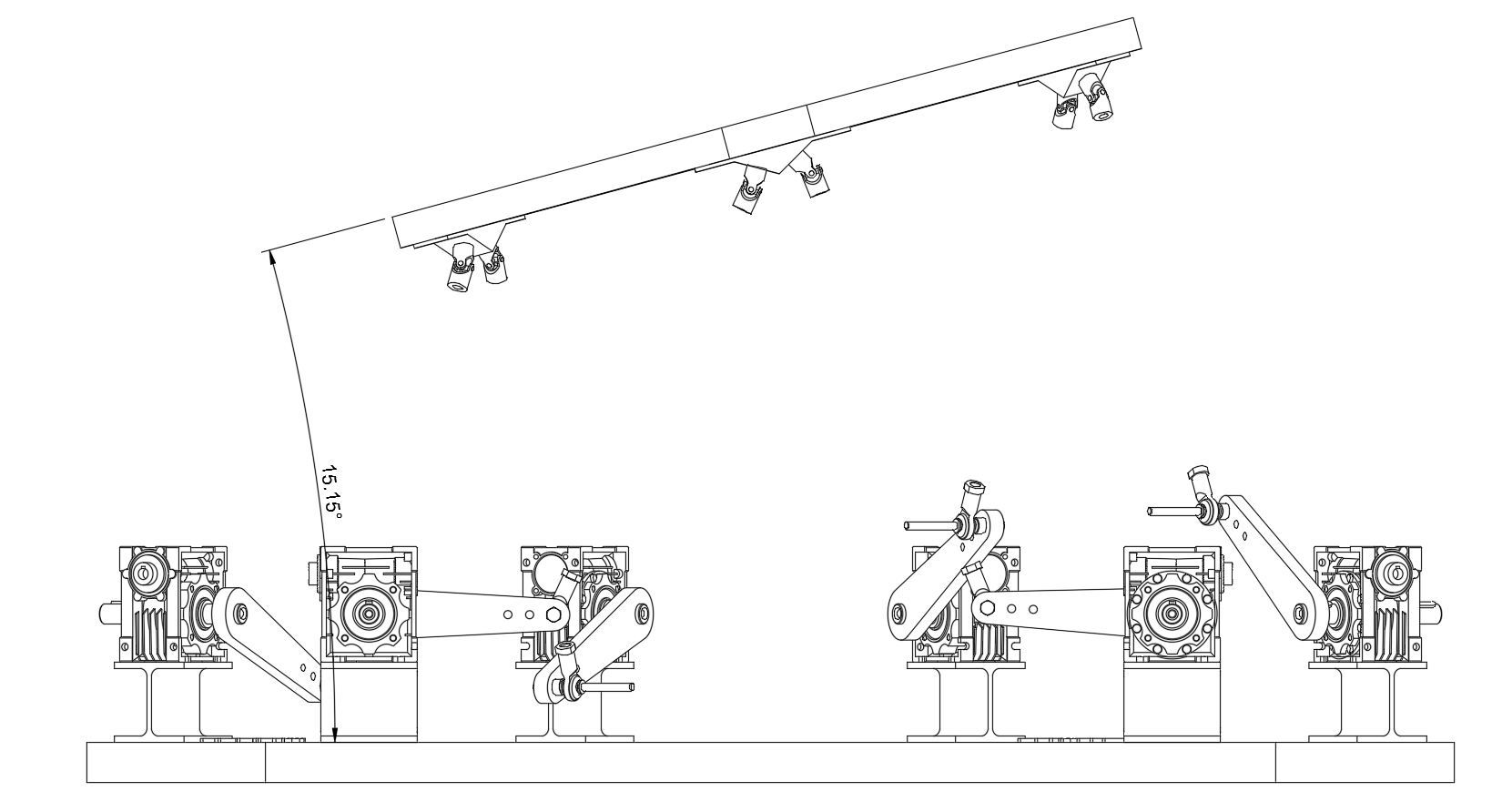

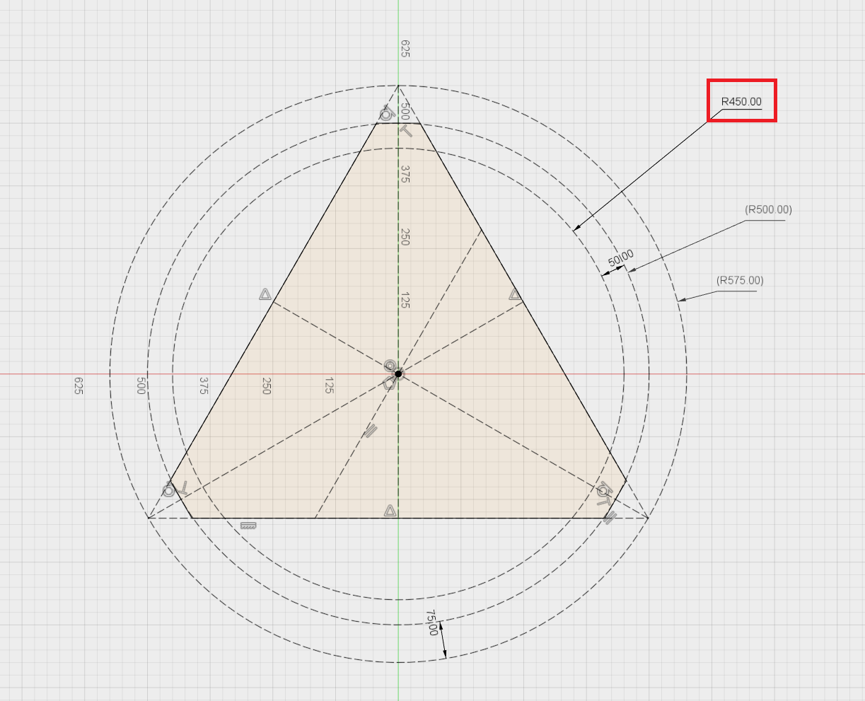

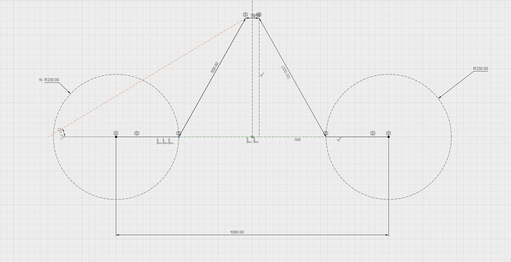

    I am going back to wormdrive for now.
    I would like 400mm heave, 120° of motor rotation, 6DOF, 35° pitch/roll
    In term of angle :
    What gives me 450 for platform radius :
    Mobile :
    Fix :

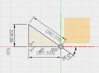

    In a vertical plan (trying 2D before 3D), does the neutral position should be like this :
    Or should I put the axis of fixation at the middle of lever, like this ?
    I think I'm wrong because after having done all of this, I only have 15° of roll :(
    Thanks for your help guys !
    22,096
    154,196Coins
    +11,175 / 57 / -2
    Others with 6DOF rigs like @SeatTime and @SilentChill are better placed to comment, but I would think 35 degrees excessive.

    BTW I only have 15° lol

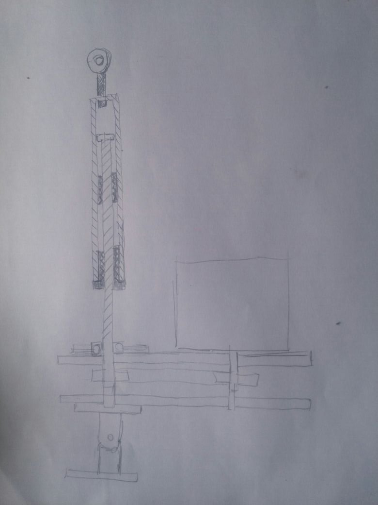

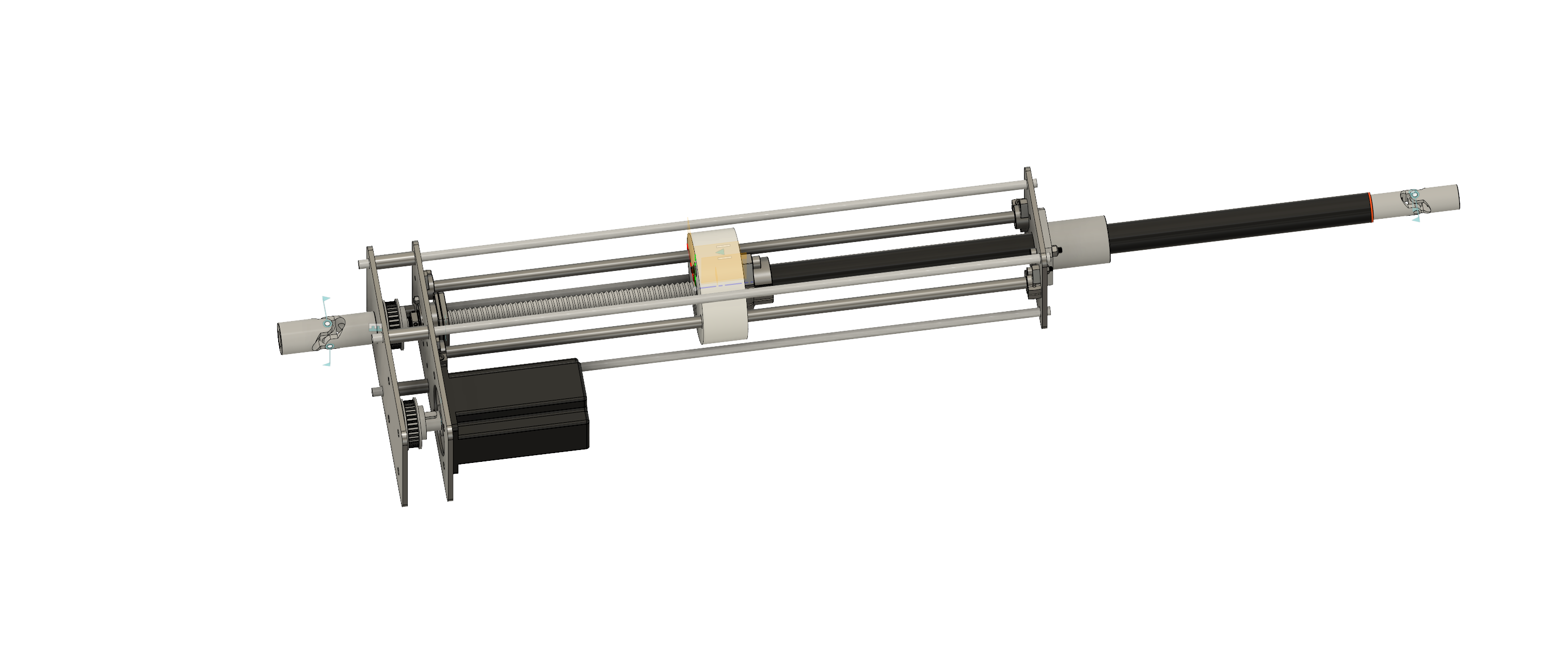

    Hi
    do this kind of actuator work ? or is there something wrong ? (except there is no screw ball and gear between motor and screw ball !

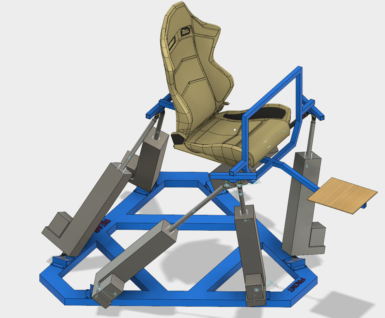

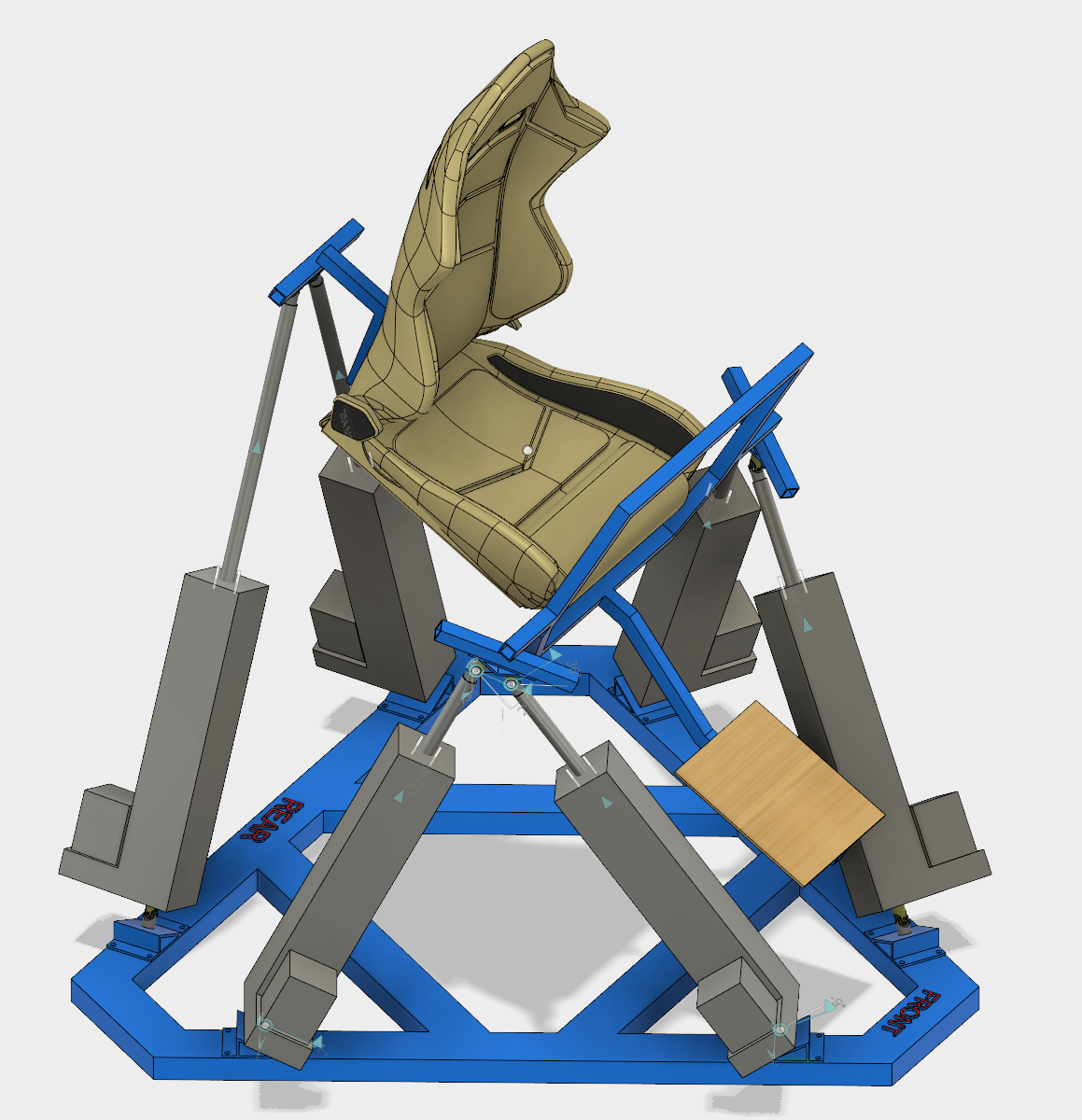

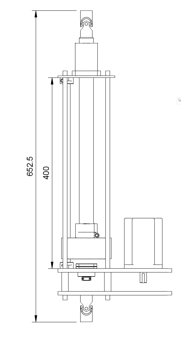

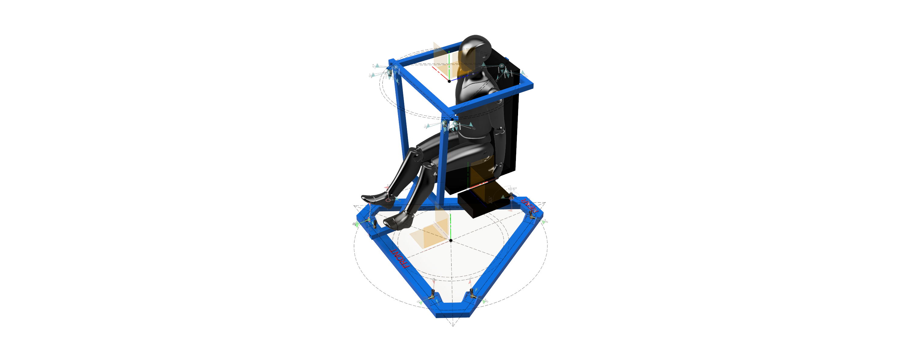

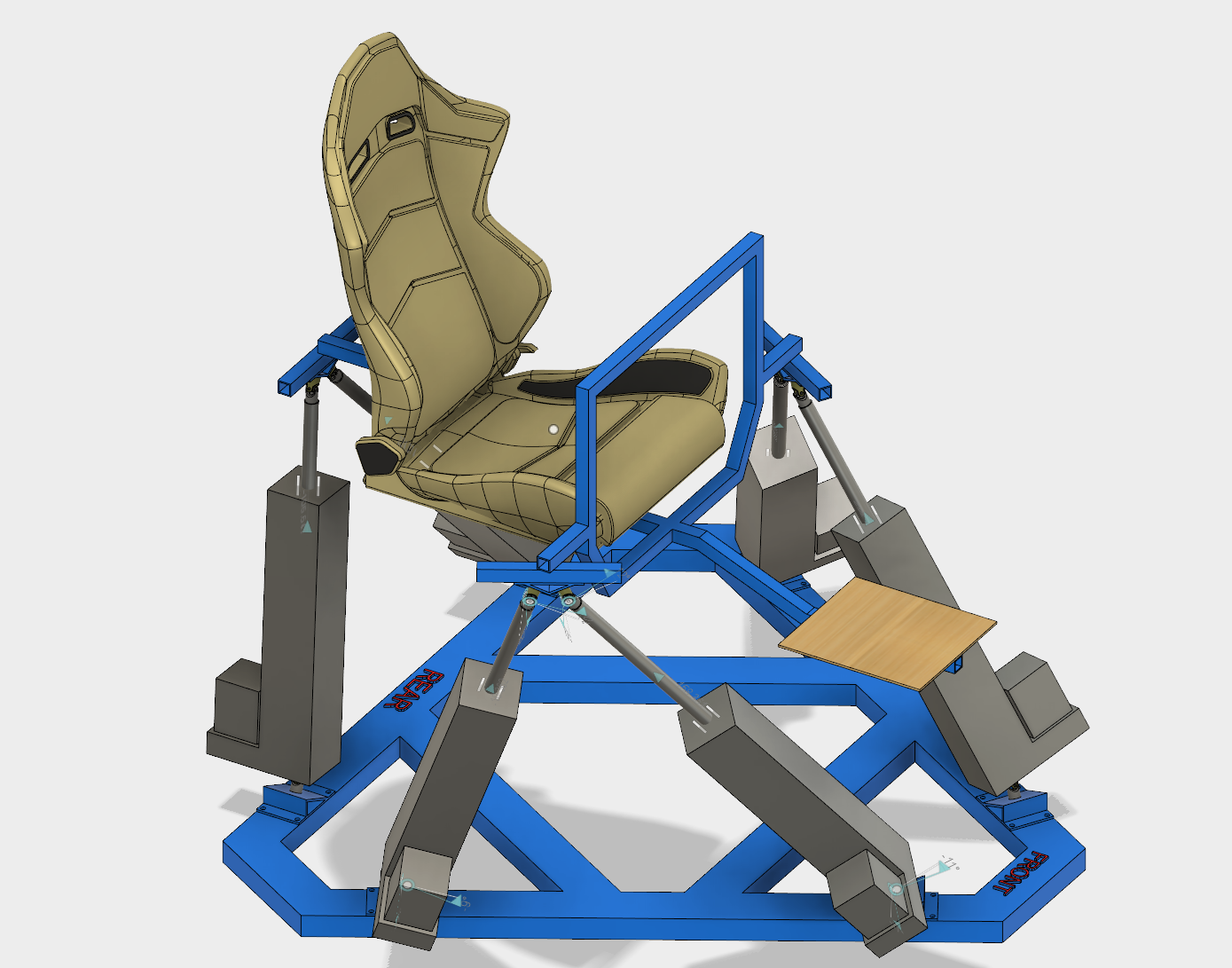

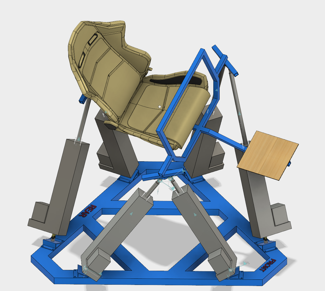

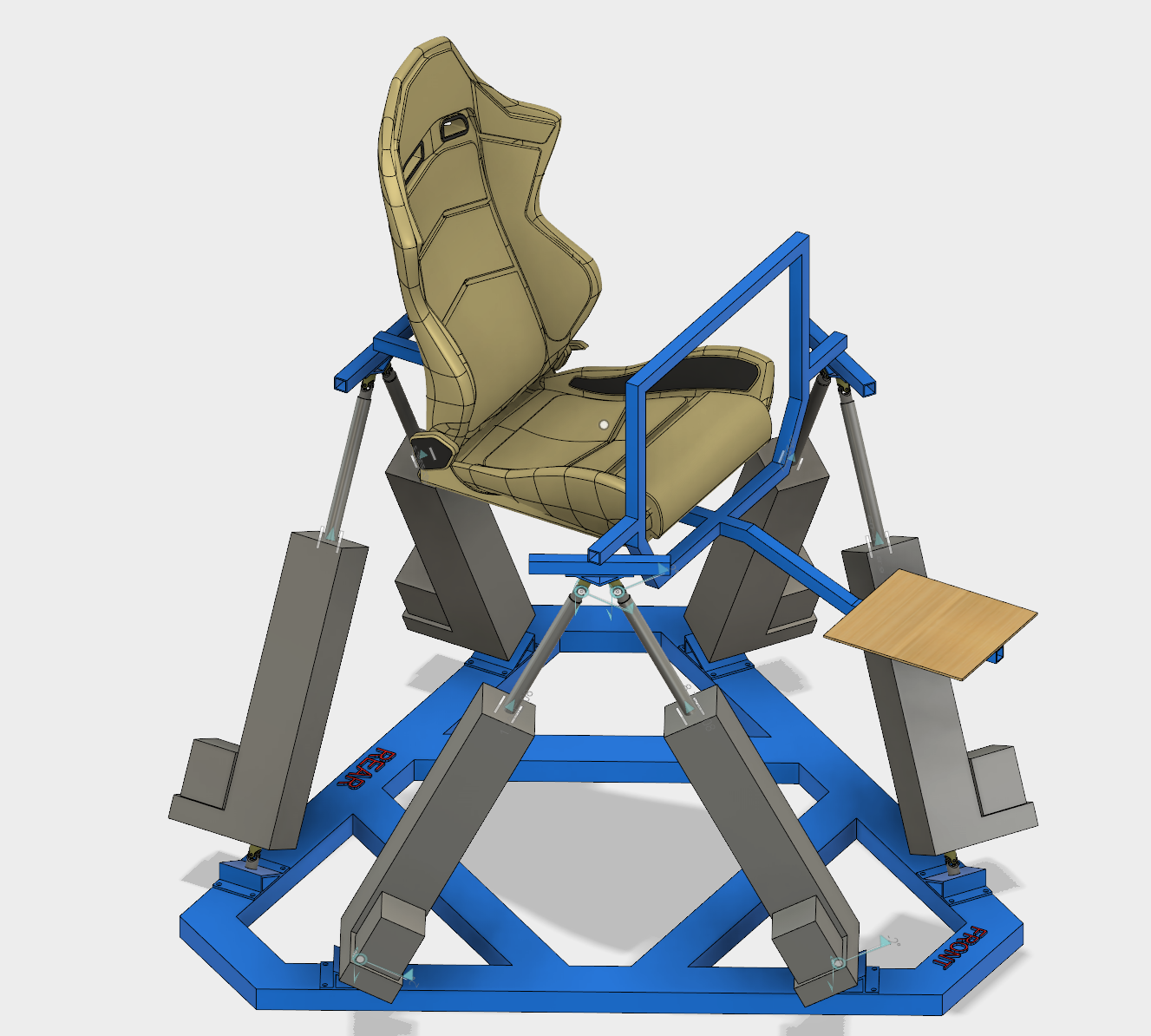

    project keeps going !
    30° pitch and roll, 70° yaw
    [​IMG] [​IMG]
    400mm for/back and left/right and 500mm Heave
    [​IMG] [​IMG]
    Do you know where I could find a seat where I can put my warthog joystick between my legs ?
    And where to find gear wheel ? with chain ? would it be able to transmit 750w ?
    thanks

    I wil go with AT3 or AT5 thanks a lot
    is 0.5m/s and 60°/sec good specs for VR ?

    2DOF, Arduino, 4DOF
    500mm/sec it's a lot! (and difficult to achieve)

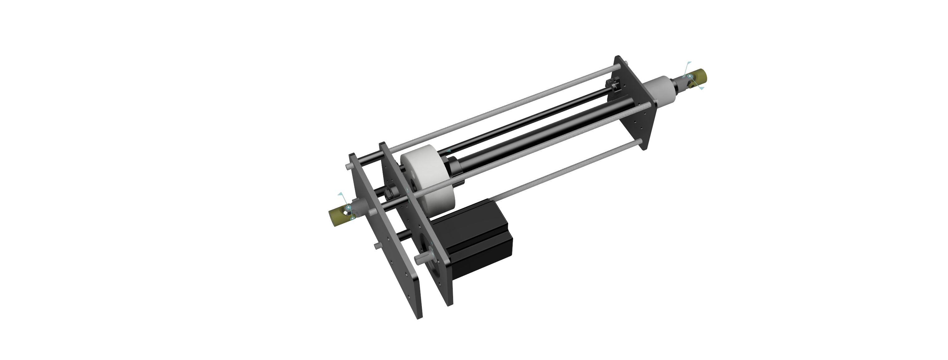

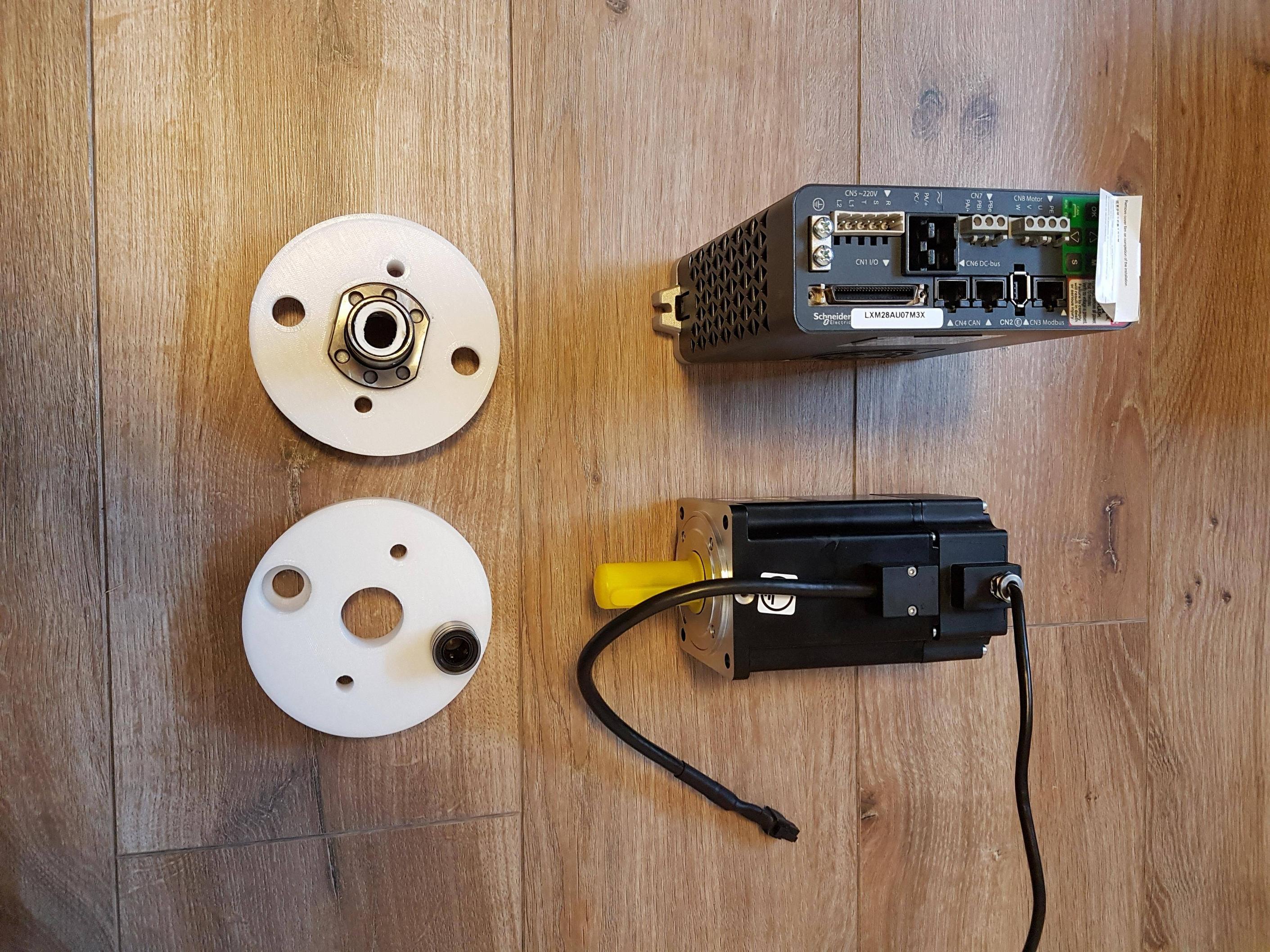

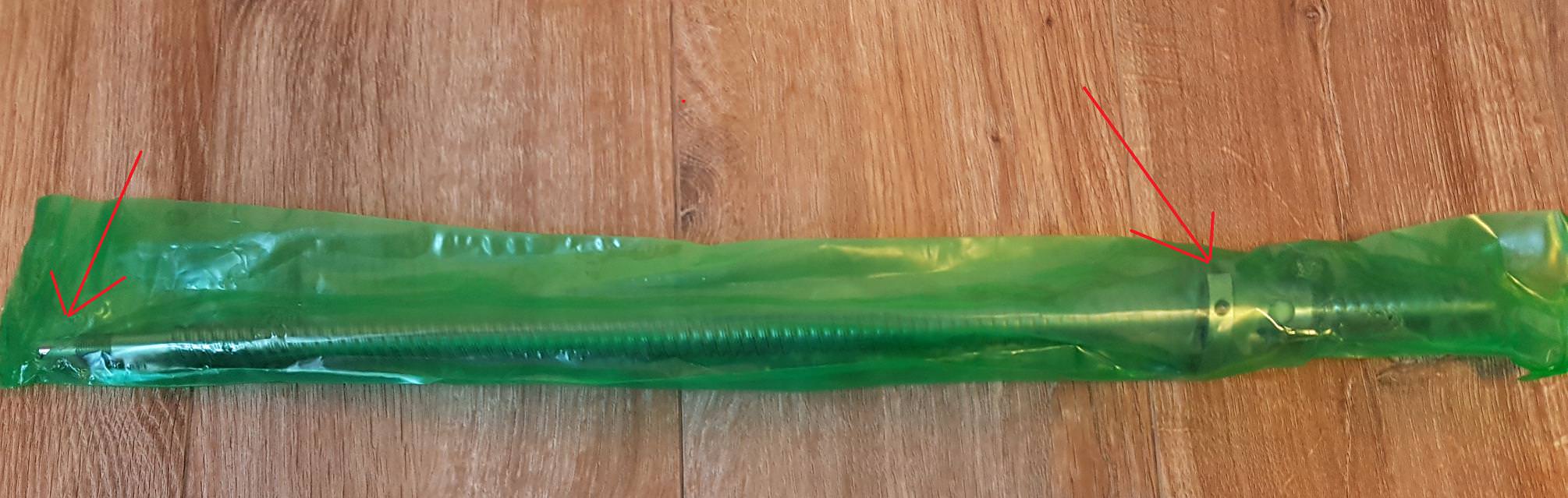

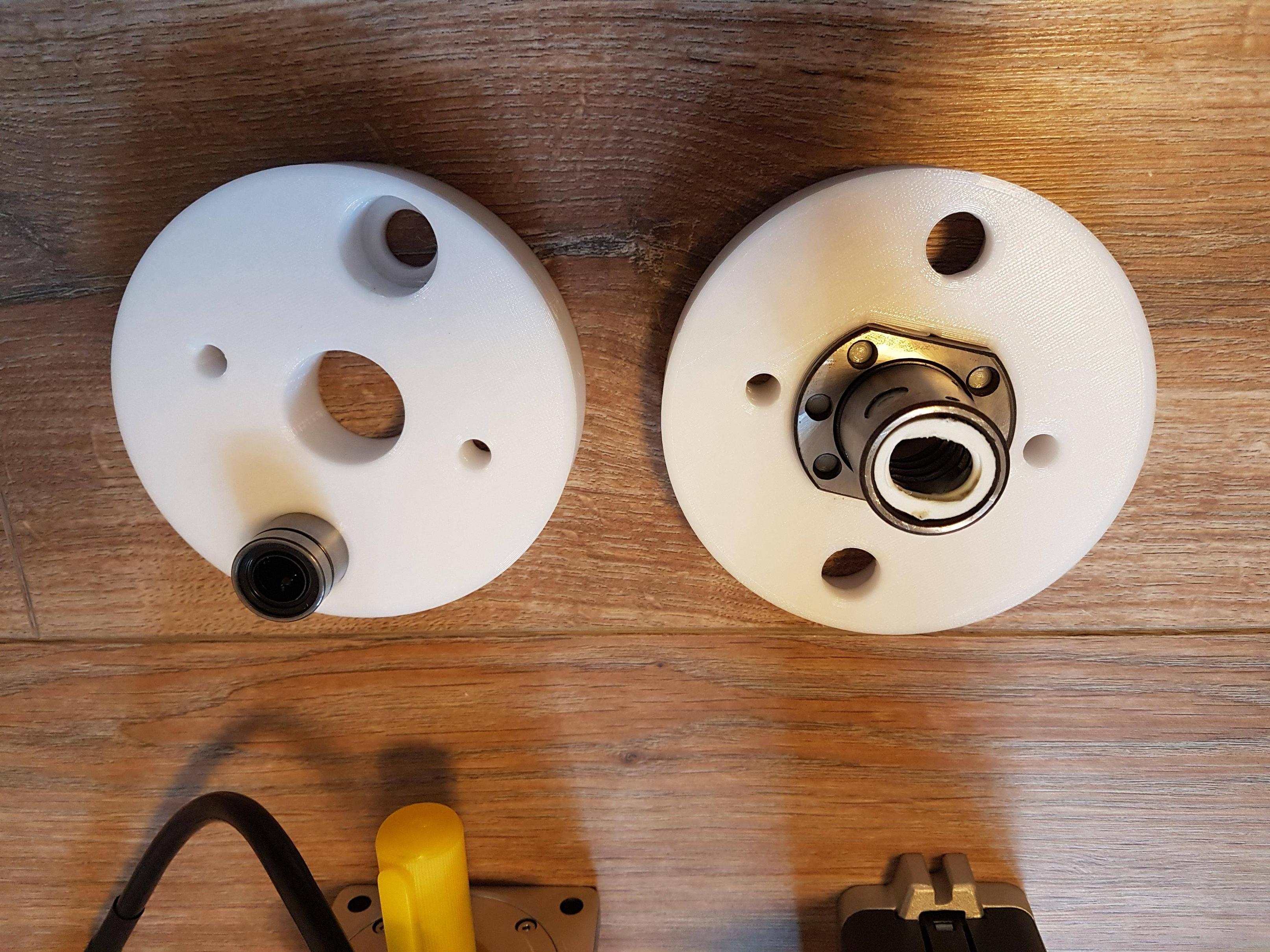

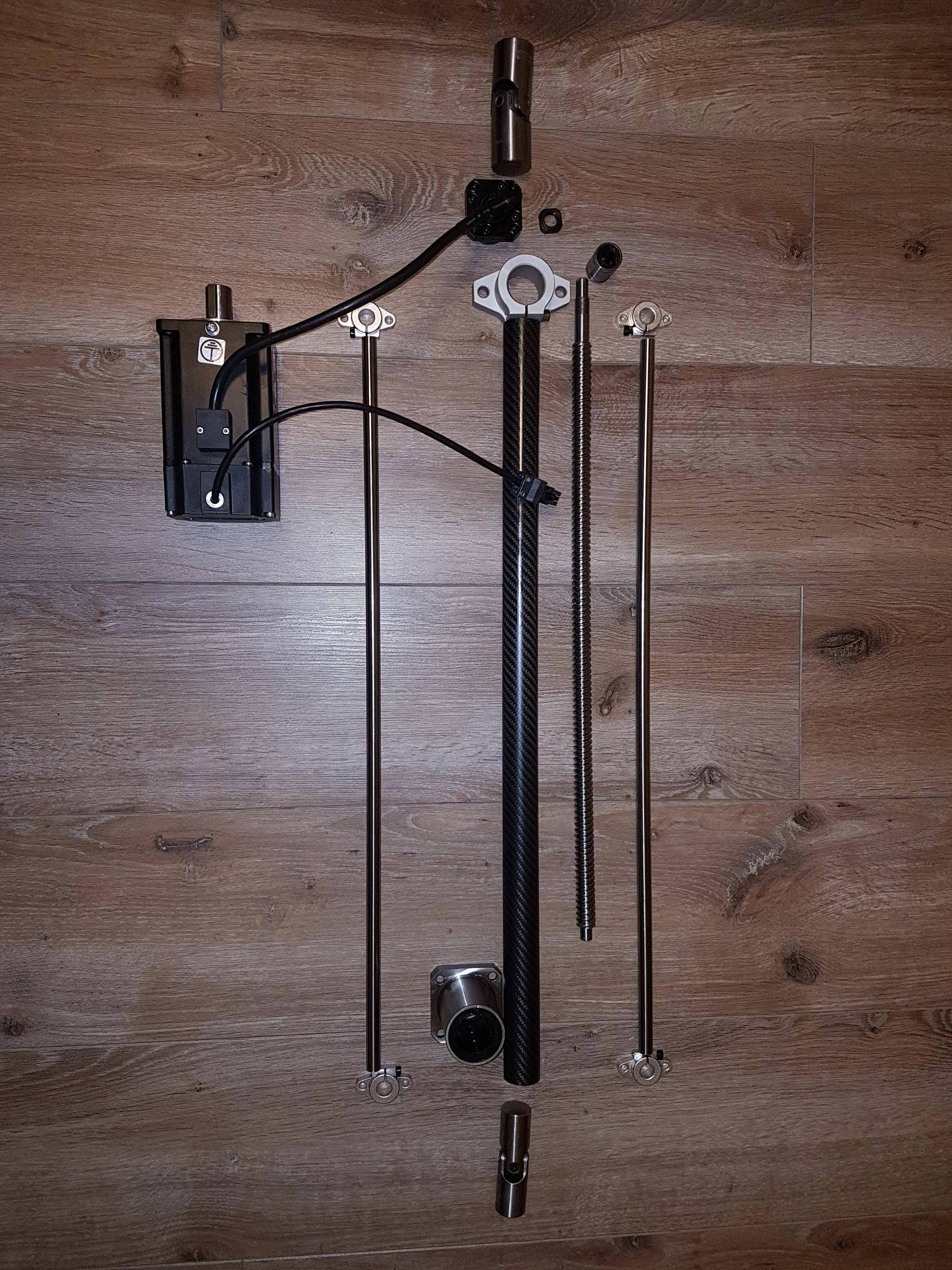

    Hi guys,
    still not dead, project keep goes up ! @wannabeaflyer reboosts me a lot !
    Under fusion360 :
    Screw lenght : 550mm, total travel : 480mm
    And hardware in real :

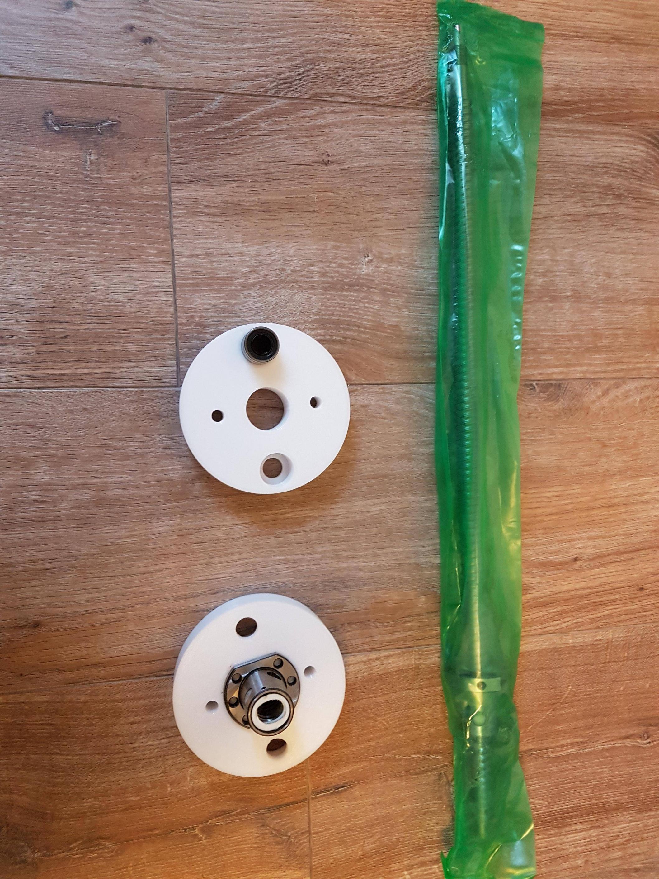

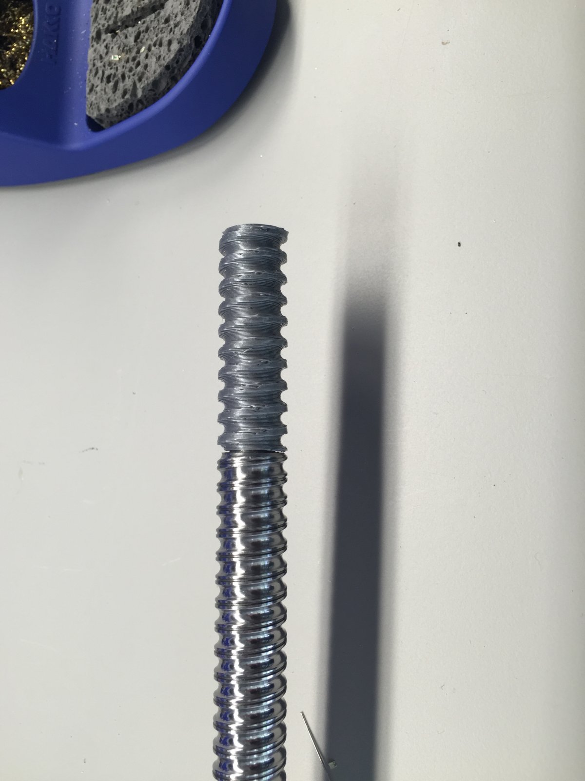

    I have a problem : the ball screw nut is in the wrong side compared to machined size, can I remove it and reverse it ?
    What do you think of my design ? @SeatTime @wannabeaflyer @baykah @Hoddem @noorbeast
    Thanks a lot :)

  19. mariano68
    mariano68 Active Member
    Nov 15, 2014
    574
    builder contractor
    Argentina
    3,341Coins
    +394 / 2 / -0
    2DOF, Arduino, 4DOF
    You can unscrew it, but you need a piece of tube of the same size of the screw, or a printed screw.
