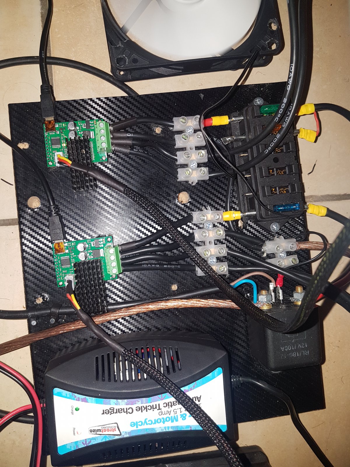

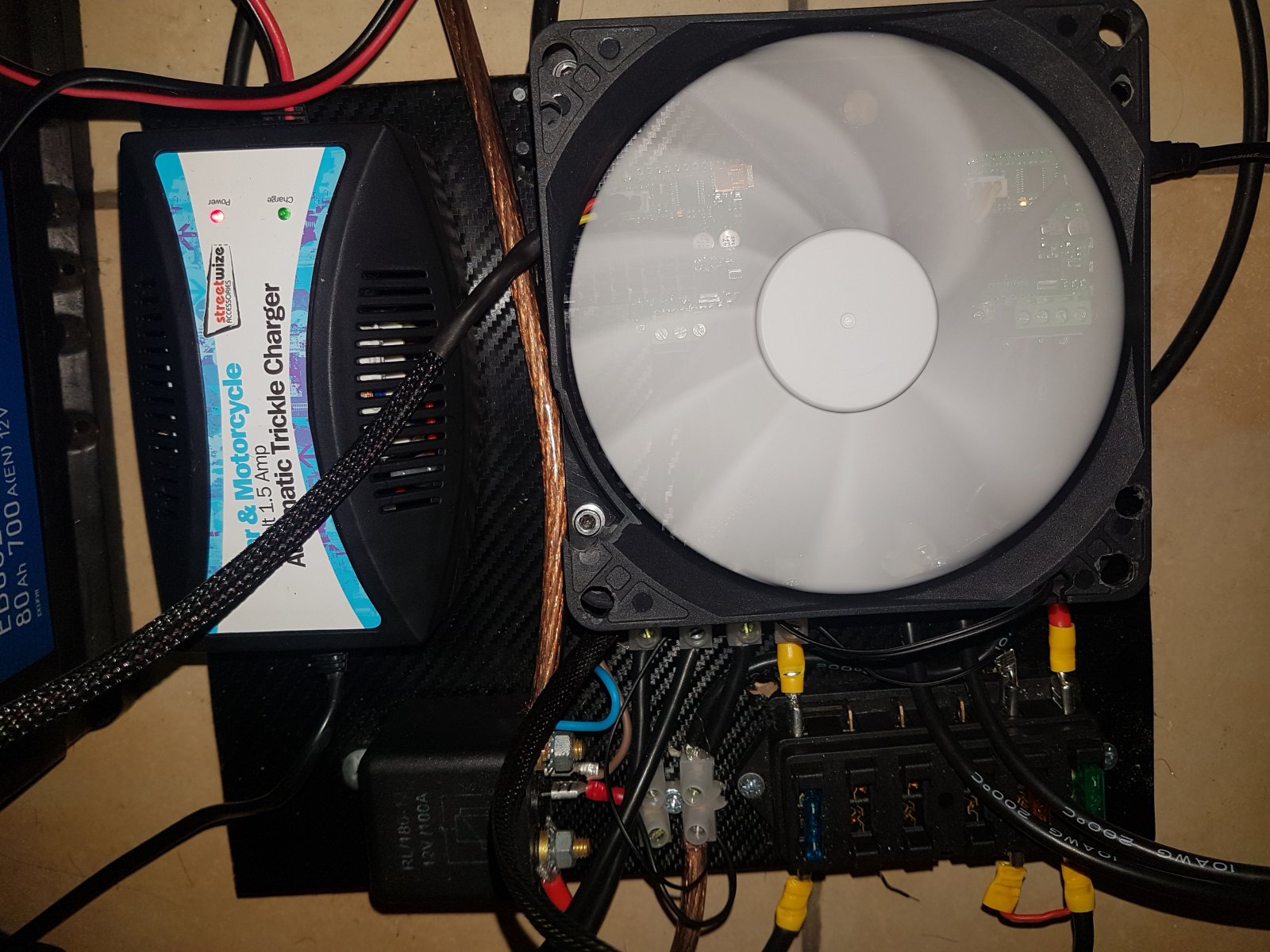

    I ended up ditching the power supplies as nether worked properly. Unfortunately because I bought them so long ago I couldn't really return them. I've found this on a few of the components I've been buying. This seams to be what to expect when buying used/cheap stuff. The mm's were hopeless and I had to return the first battery I bought because it didn't work. It was only from the local scrappy though so I've swapped it for a good one now and everythings working.

    Just one question. With the JRKs could someone explain what "Max Current exceeded? "
    In the JRK documentation it sounds like it's there to protect the jrk and the motors or is it to stop the psu shutting down from the jrk trying to draw too much power?
  9. Zed
    Apr 4, 2017
    1,040
    USA
    5,847Coins
    +1,043 / 4 / -0
    In the JRK configuration utility, you can limit the current the JRKs can deliver before tripping out. I don’t remember what the max value is that you can set but you can also set it to unlimited (0.00) where the JRKs won’t trip at all on overcurrent. The H-bridge that’s used does self-limit the current to about 50-55 amps though. It’s a built-in protect but also leaves damage in the bridge chip over time due to localized heating in the chips from the current.
    The reason the limit is there is probably multiple reasons but the heat dissipation of the bridge chip is limited by the small board area and it can protect the 12v12 itself. But like any fuse or circuit breaker, it can protect multiple things in the circuit. They are rated at 12 volts and 12 amps but with proper heat sinking you can go much higher. I disable the current limit in my JRKs and use fuses rated at 40 amps.

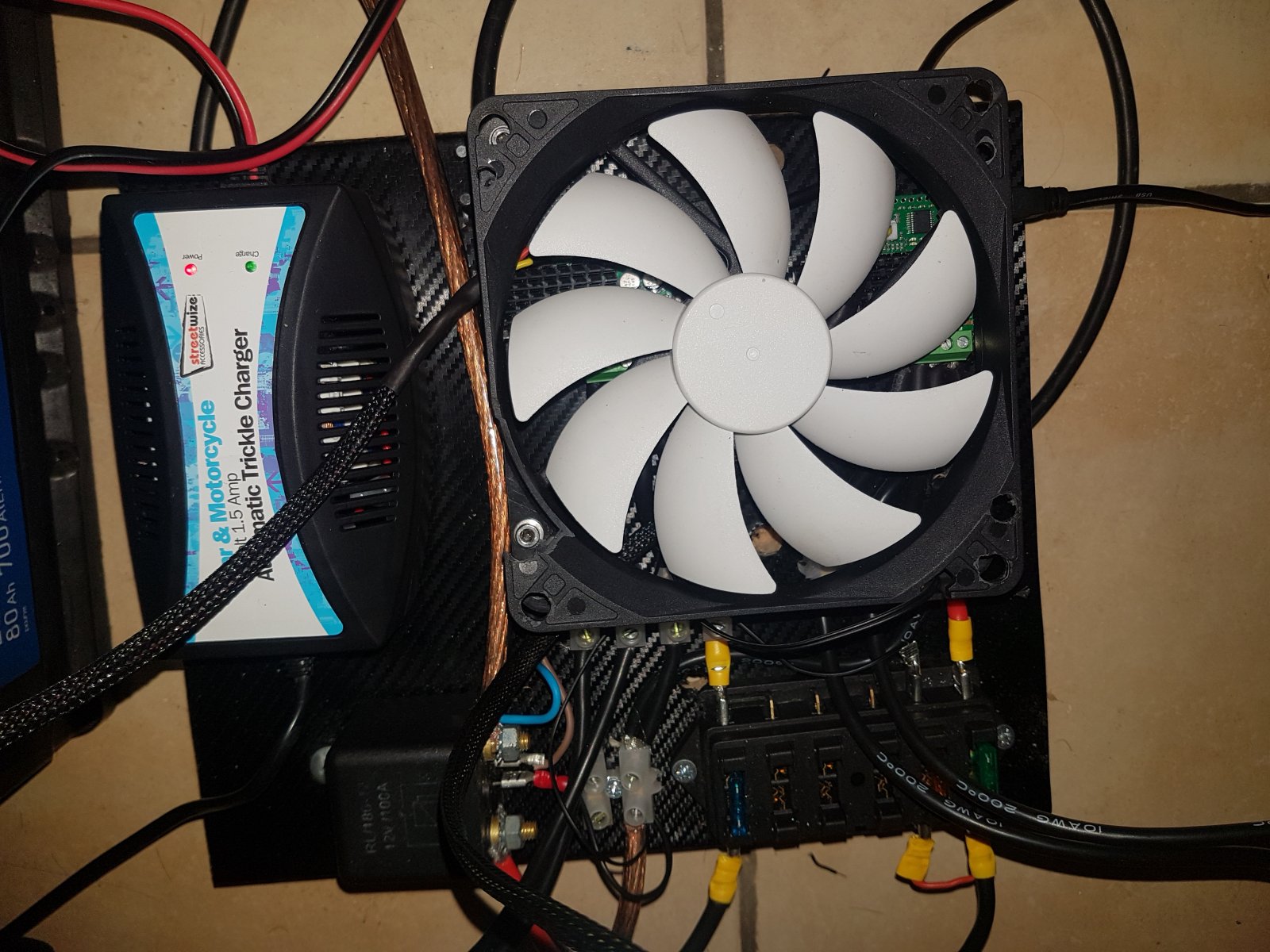

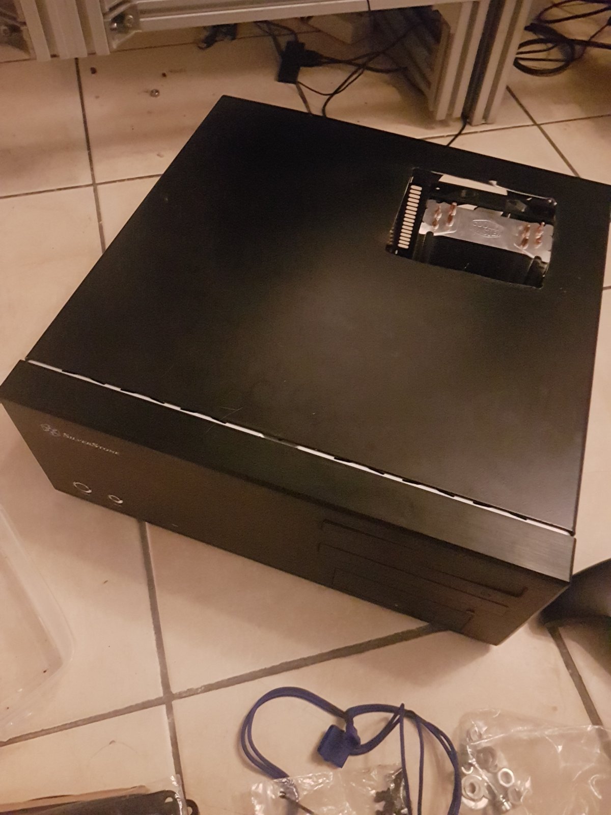

    I was using a Factal Design gaming case that was great but didn't really fit into my plans as I'm putting the pc underneath the rig.
    I had a Silverline htpc case in the garage that wasn't being used and is the right design, only problem is its not big enough to fit my evo 212 cooler and the case fans aren't really enough. What to do?
    CUT SOME HOLES!
    It's not particularly neat but it won't be seen and it'll do the job.
    Now to cut some holes for 2 140mm fans.
  12. principiamacb
    principiamacb Member
    Nov 18, 2016
    60
    United Kingdom
    128Coins
    +28 / 2 / -0

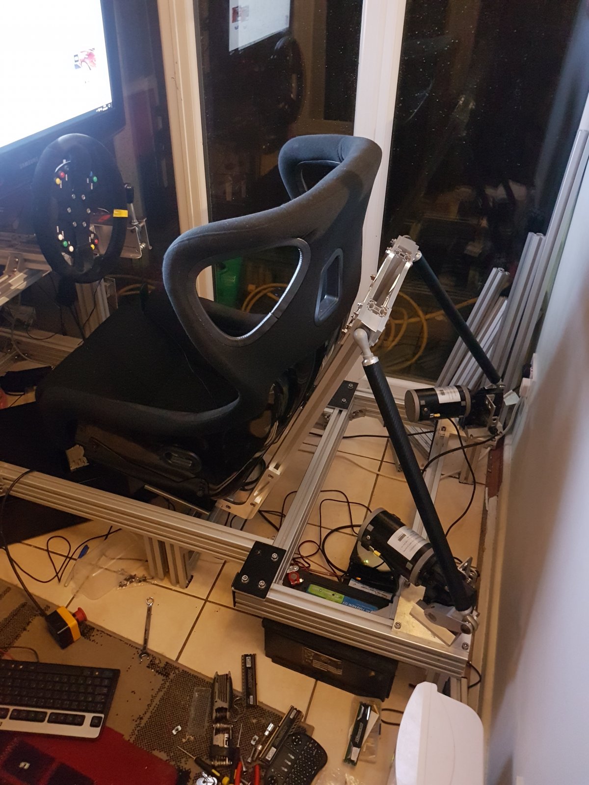

    All ready for testing. Looks pretty messy at the moment but all works!

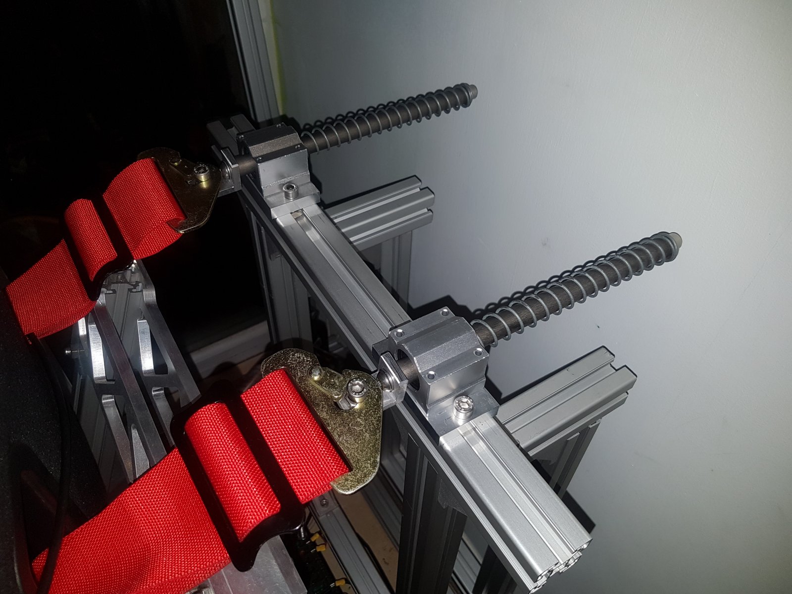

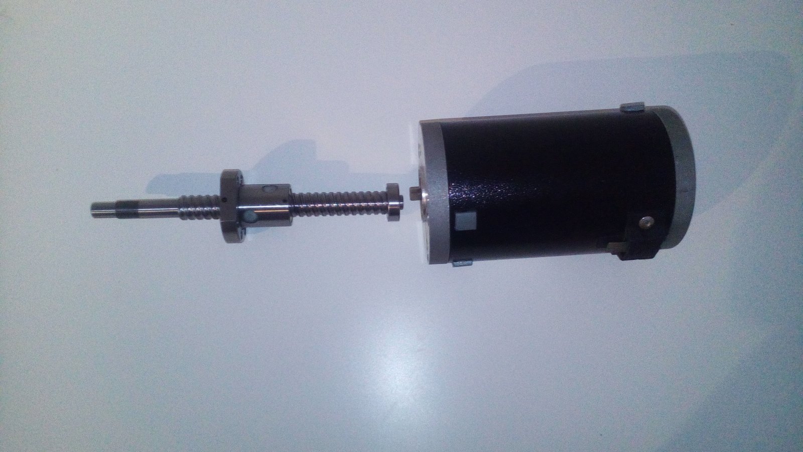

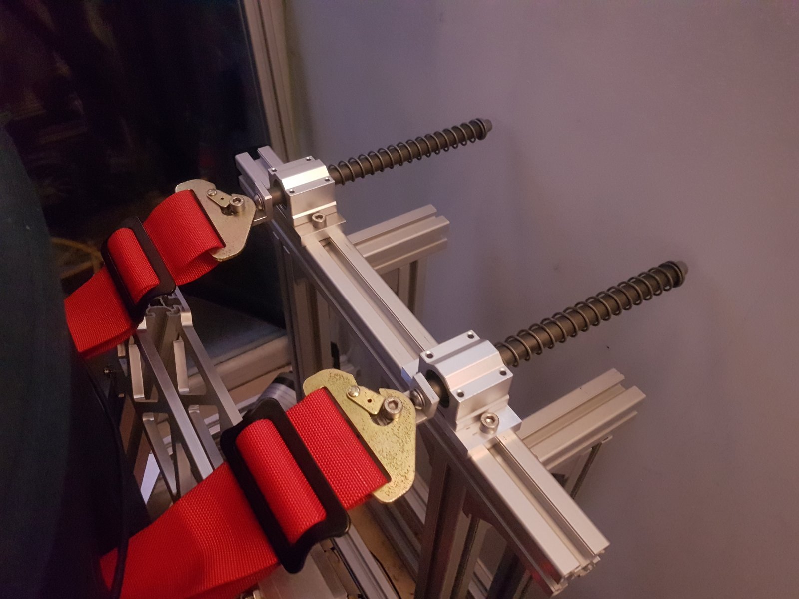

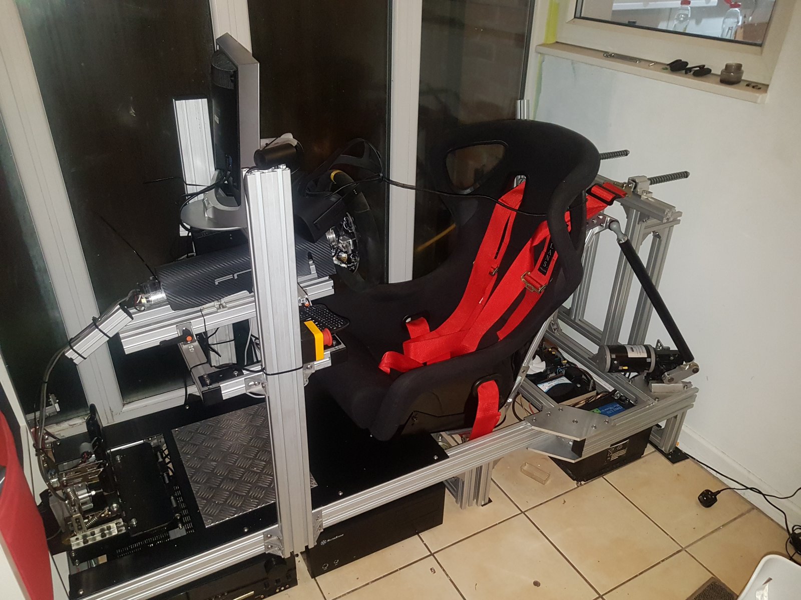

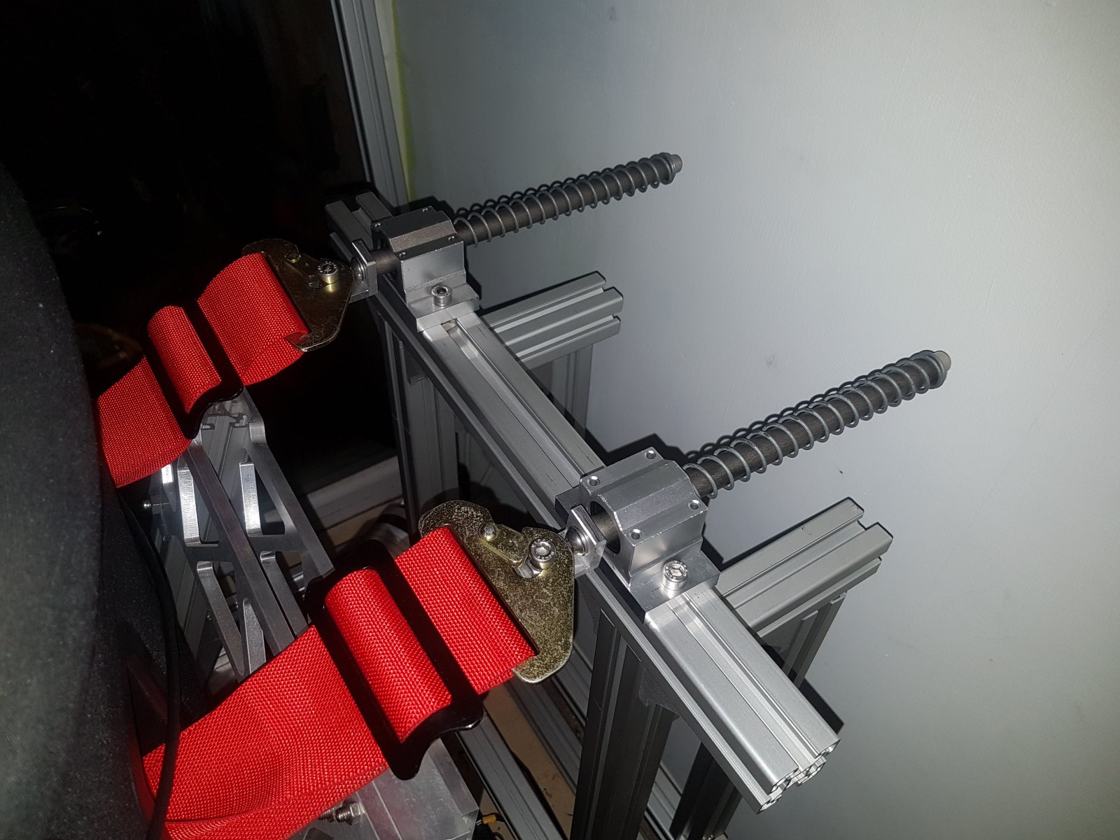

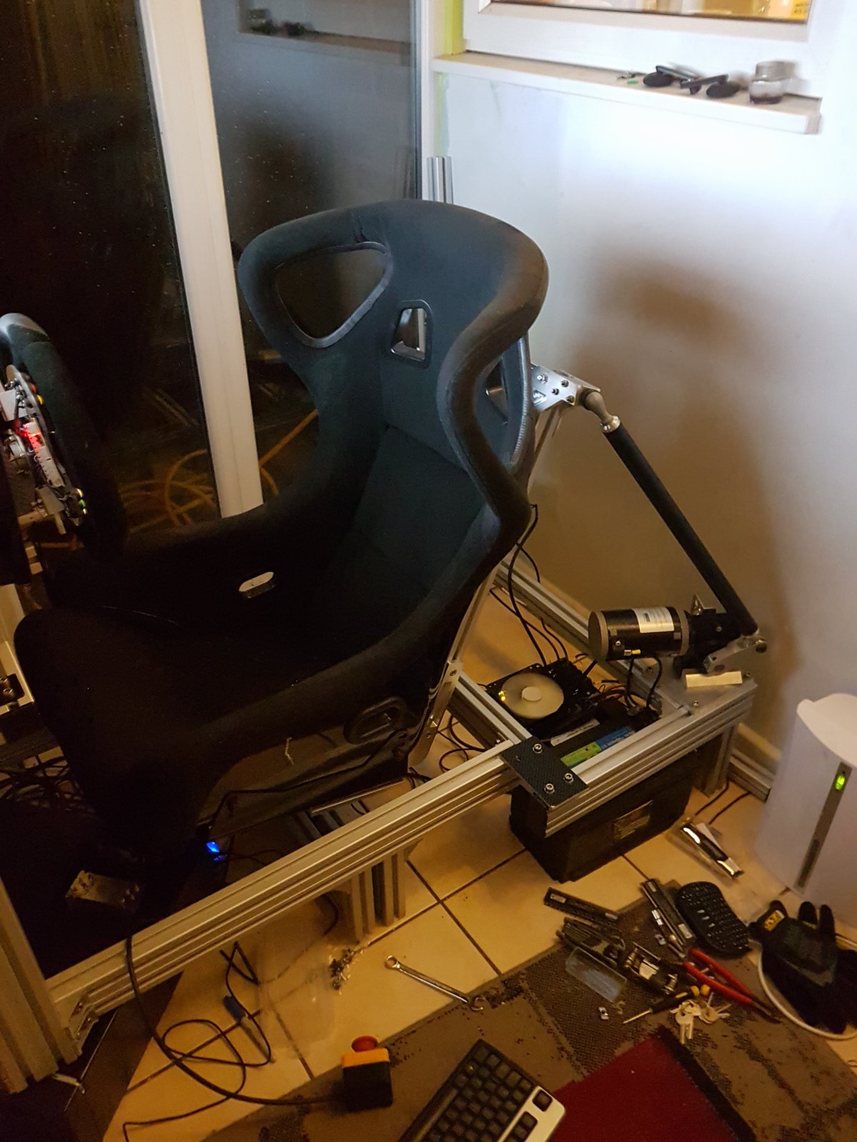

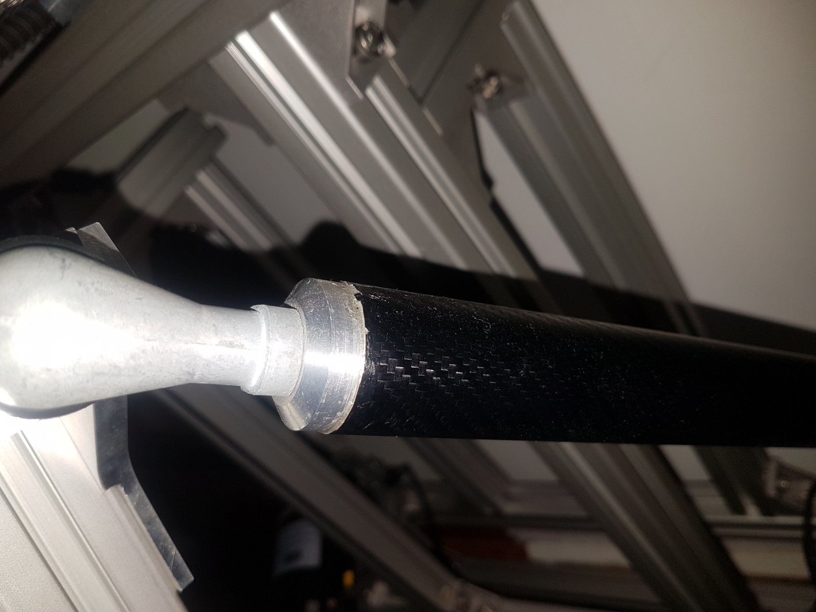

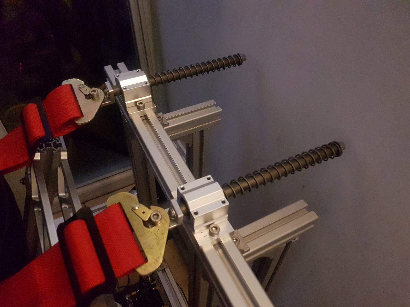

    The plan was to get it finished completely then take photos however that's not happened yet.
    The rig has been working for a few months without any real issues apart from backlash in the gearboxes. I can tell i'm loosing a lot of fidelity and its so loud its keeping the rest of the family awake at night.
    So, what to do?
    1, Leave it as it is.
    2, Change to 25-1 gearboxes so I can run shorter arms to get rid of some of the backlash.
    3, build some actuators.
    Ive decided to build some short actuators especially as ive not seen any on the forum for a 2dof (please link me to a thread if there is one!). I've ordered some 200mm 1610 ball screws. They should be here in a few weeks. Im thinking of a similar design to the existing designs for 6 dof, just shorter.
    Im planning on using my existing 180w motors at least for the time being and also my jrks.
    Ive read up on all the threads of actuator builds on the forum but if anyone's got thoughts on any specific issues I might have with shorter actuators im all ears.
    Anyway, here's some up to date photos.

    That’s a 10k 3 turn pot. Are you going to gear it? If you direct connect it and have 90 degrees of throw on your motors you will get only 1/12 of the resistance change which will be 1/12 of 5 volts worth of feedback. The JRKs do a good job of scaling but I’d bet that’s too low of a change to work well.
    Most here will probably recommend Hall sensors since many models of those don’t have stops and won’t be damaged by overruns of travel. Resistive elements and windings can also wear out over time.

    These are for the actuators I'm building. I'm going to use a rack and pinion system so was looking for a 3 turn pot.
