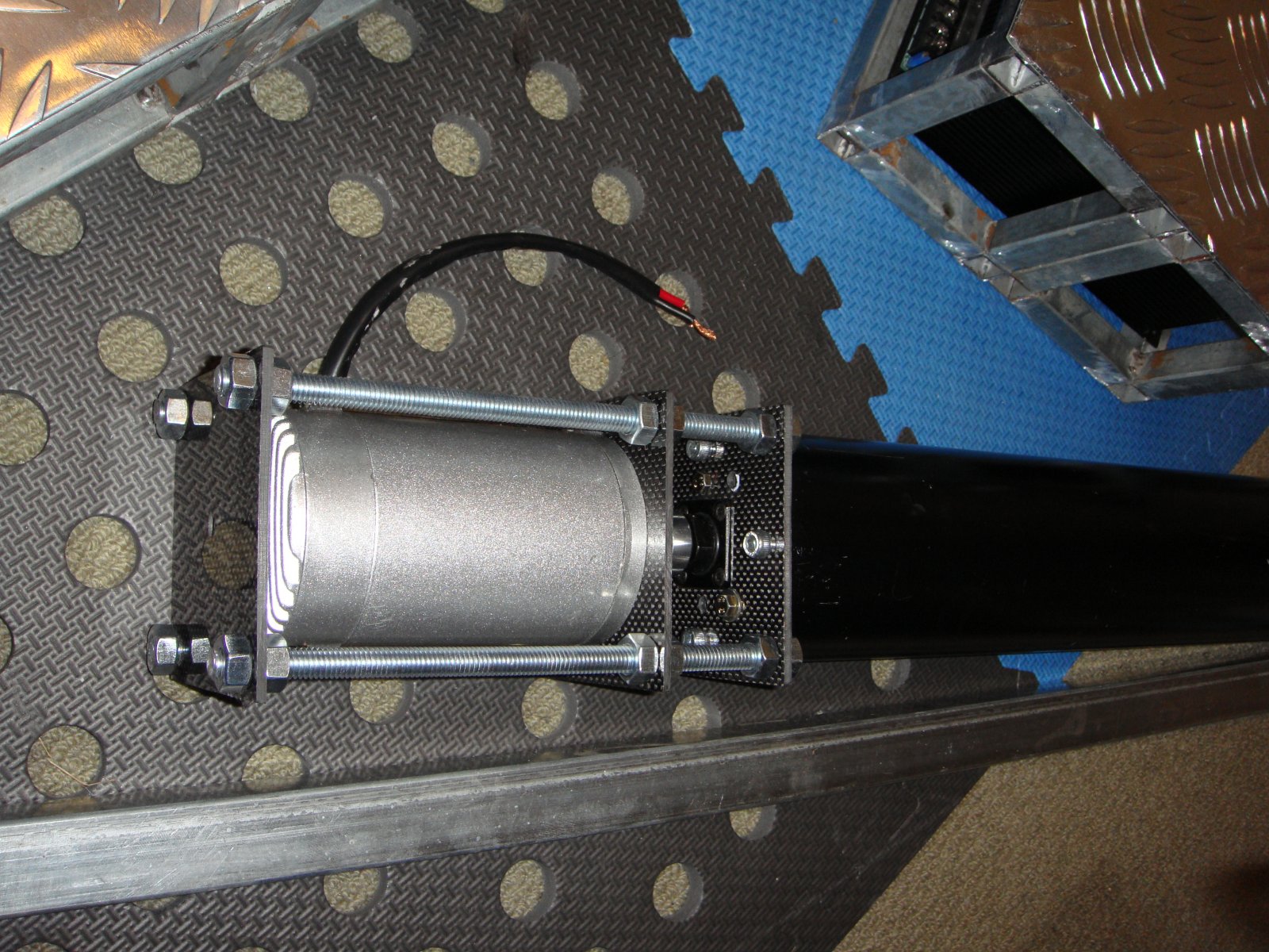

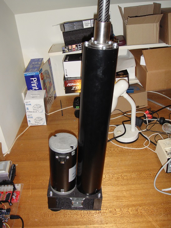

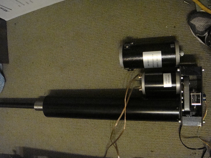

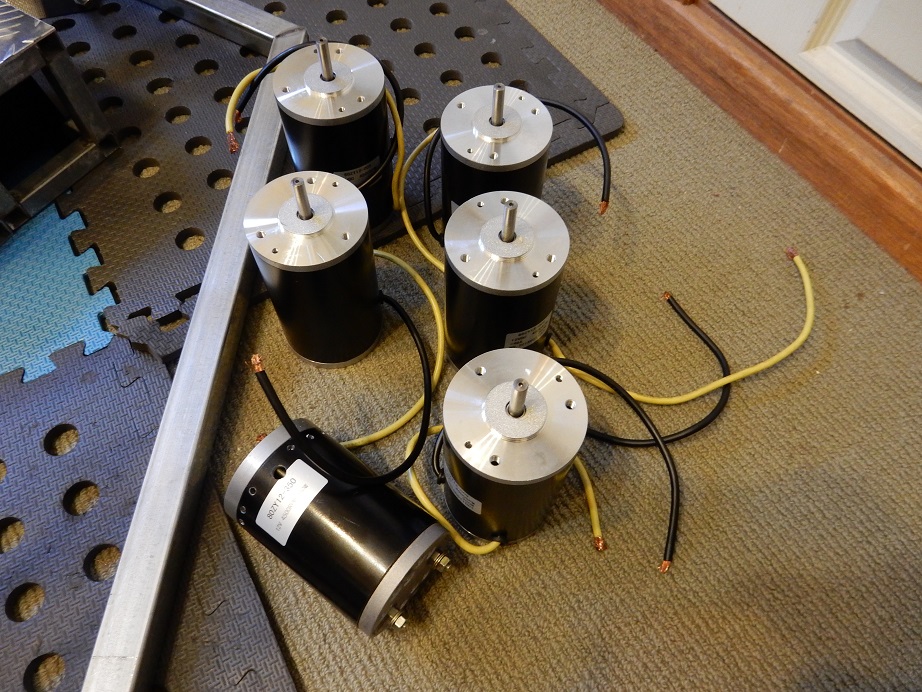

    Often hard to know what the specs actually mean for a Chinese produced motor, hopefully the 40amp motors will not overload your sabertooths 2 x 32. Often specs can be a bit confusing, especially when the items are coming from China. As a example, images below are four motors that I testing out for my 6DOF many years ago (just initially purchased one of each). The larger one is a industrial grade motor rated at 200W and the three smaller ones are commercial grade motors rated at 350 W. Hope it all goes well for you.
    Actuator standard against bigger motor.jpg Actuator with motor_gearbox attached.jpg DSC02337.JPG New Motors.jpg

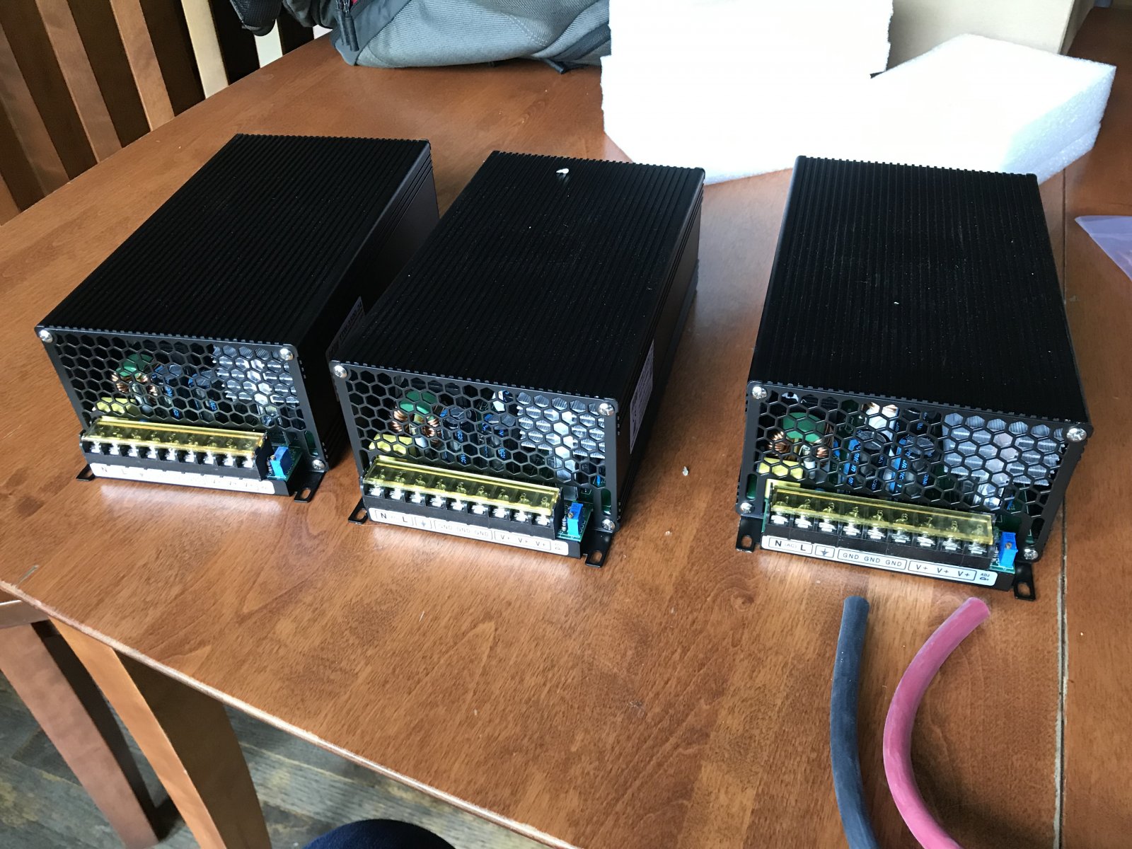

    Just got my power supplies in the mail, and they seem to be good so far (no visible damage).

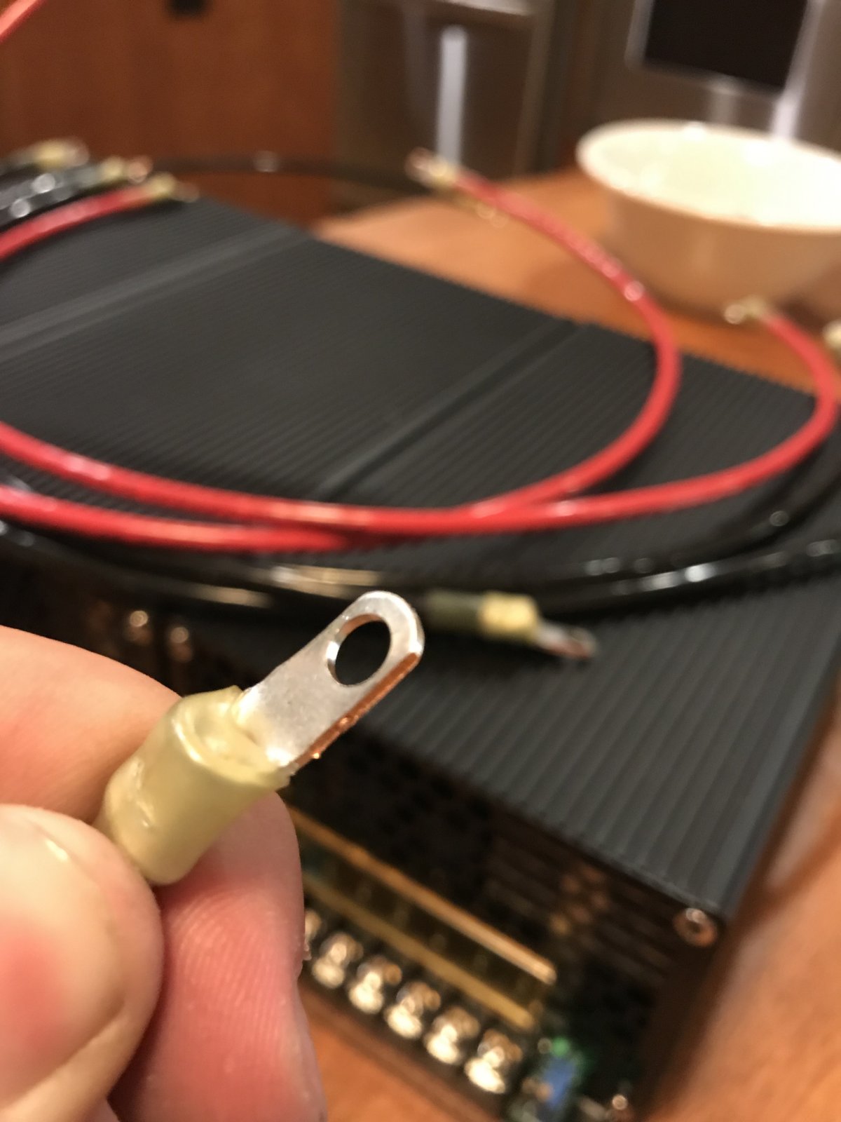

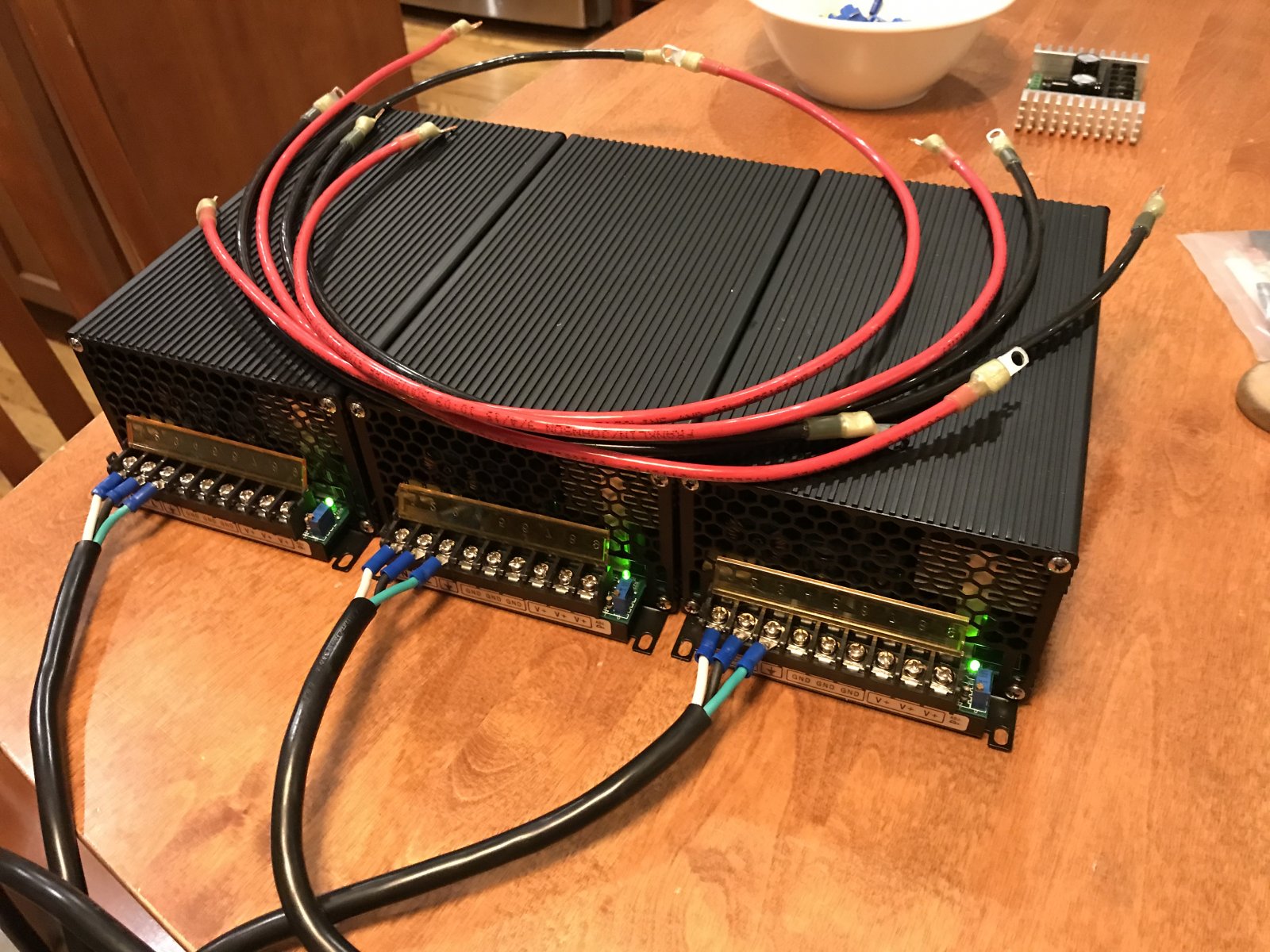

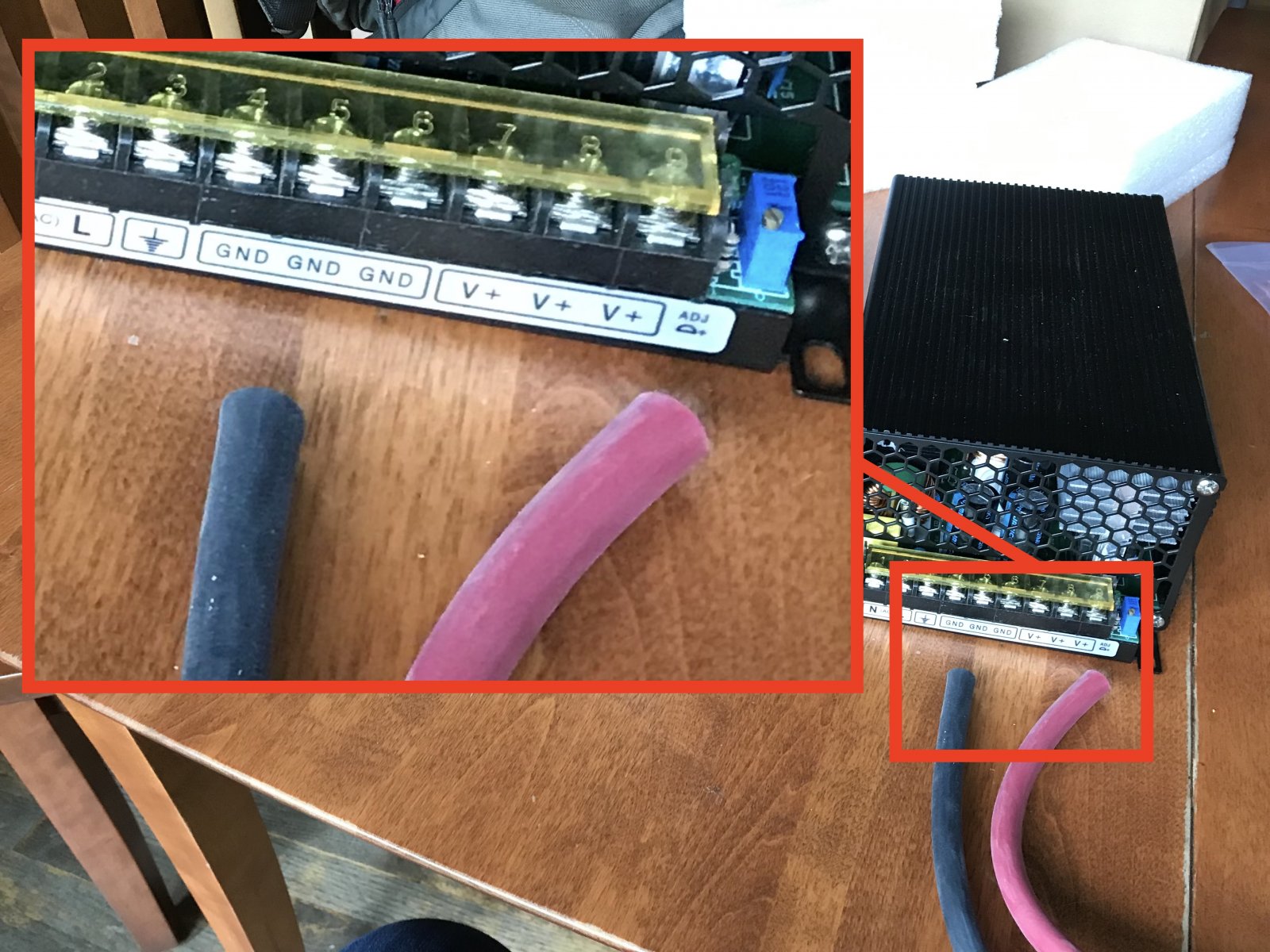

    There is a slight issue though, in that the wire I'm going to be using is extremely thick (4AWG), as it needs to handle 1500 watts (24 volts at about 60 amps), and the terminals on the PSU are not large enough to accomodate the connectors I bought, or even the wire itself.
    I'm going to look for wire-terminal connectors that will fit the PSU's terminals, however if anyone has encountered this issue before, any product suggestions would be greatly appreciated.
  15. _Gus
    _Gus Member
    May 16, 2019
    51
    406Coins
    +29 / 0 / -0
    Ok, so it turns out that when I was looking at how much current I could allow per wire gauge, I was looking at requirements for house wiring, which assumes a 100ft. cable. I'm only using 2 ft, so I just stepped down to 10 AWG wire, which means there will be about 3-4 watts dissipating into the wire on the way from the power supply to the sabertooth. This shouldn't cause any over-heating problems, and it also makes fitting the ring connector into the PSU terminal a whole lot easier, as with a little bit of time on the grinding wheel, I was able to coerce the ring connectors into the terminal slots.
    Here's an updated pic. I wired up the PSUs to AC, and the wires going to the sabertooths are on top, not yet connected.

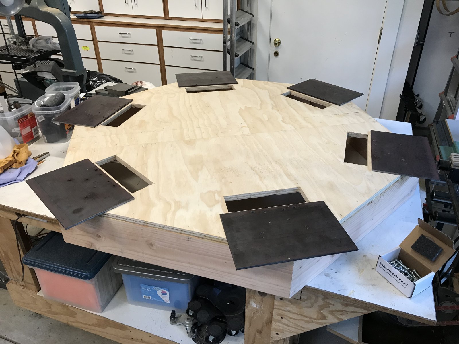

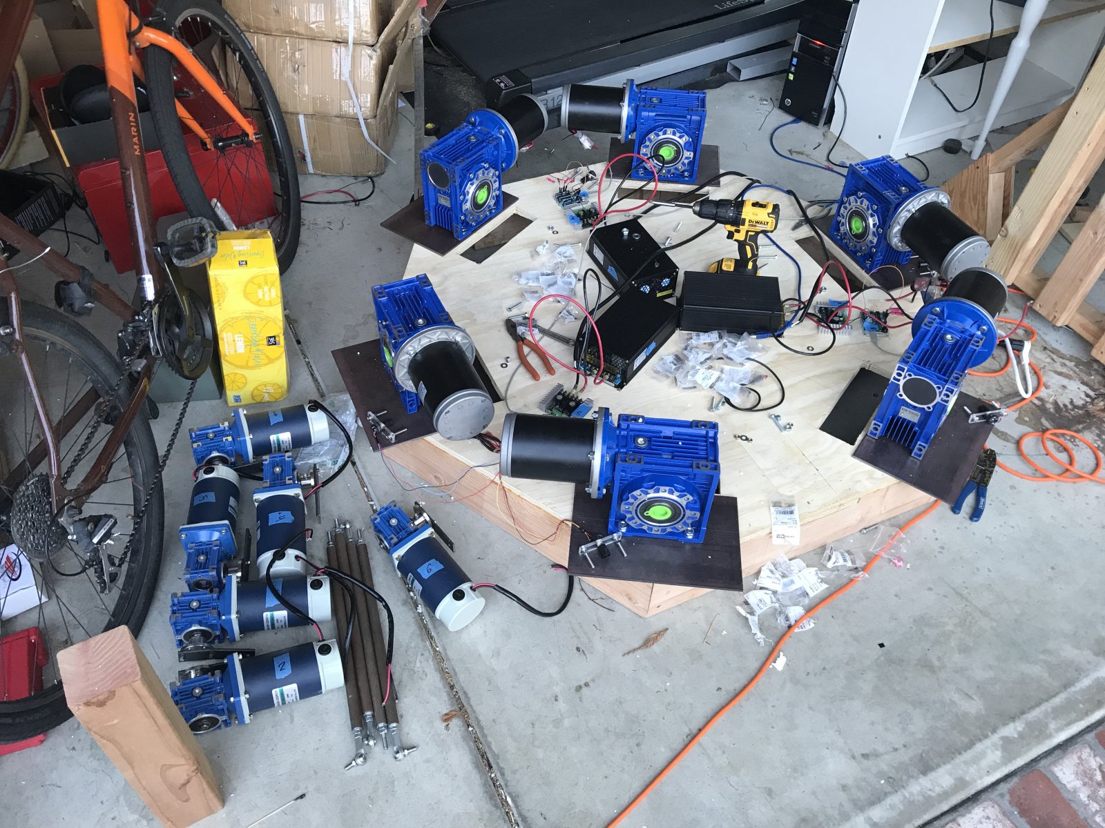

    I've decided to change up the design of my base quite significantly, and completely rebuild it. Instead of having the complicated structure of 2x4s, I decided to simply cut a 3/4" thick piece of plywood into a hexagon, and build a foot for it out of 2x6s. This gives me the lateral stability I need for the motors and also looks a lot cleaner.
    On top of the new base, I'm placing six 1/4" thick steel plates, which I've milled to have the correct hole placement for mounting the motors to. I'm running a bolt through the holes in the motor's gearbox, through the plate, and through the plywood, so everything will be super solid, and I also will avoid having to fasten the plates to the plywood separately.
    I haven't yet mounted the motors to the base yet, as I'm planning on cleaning up all of my electronics and making it all look a bit nicer. I know that once I hook everything up and get it working, I'll never want to come back and change anything, so I figure it's better to do it now and get it out of the way. My plan for this is to just drill directly into the plywood, and probably use some zip ties to get everything in place.
    Here's the new base, with the steel plates on it:
    It's exciting getting all of this stuff done, but unfortunately, the new motors I ordered have still not been shipped from the factory in China, and so it's still going to be quite a while before I can actually ride on this thing :(.
