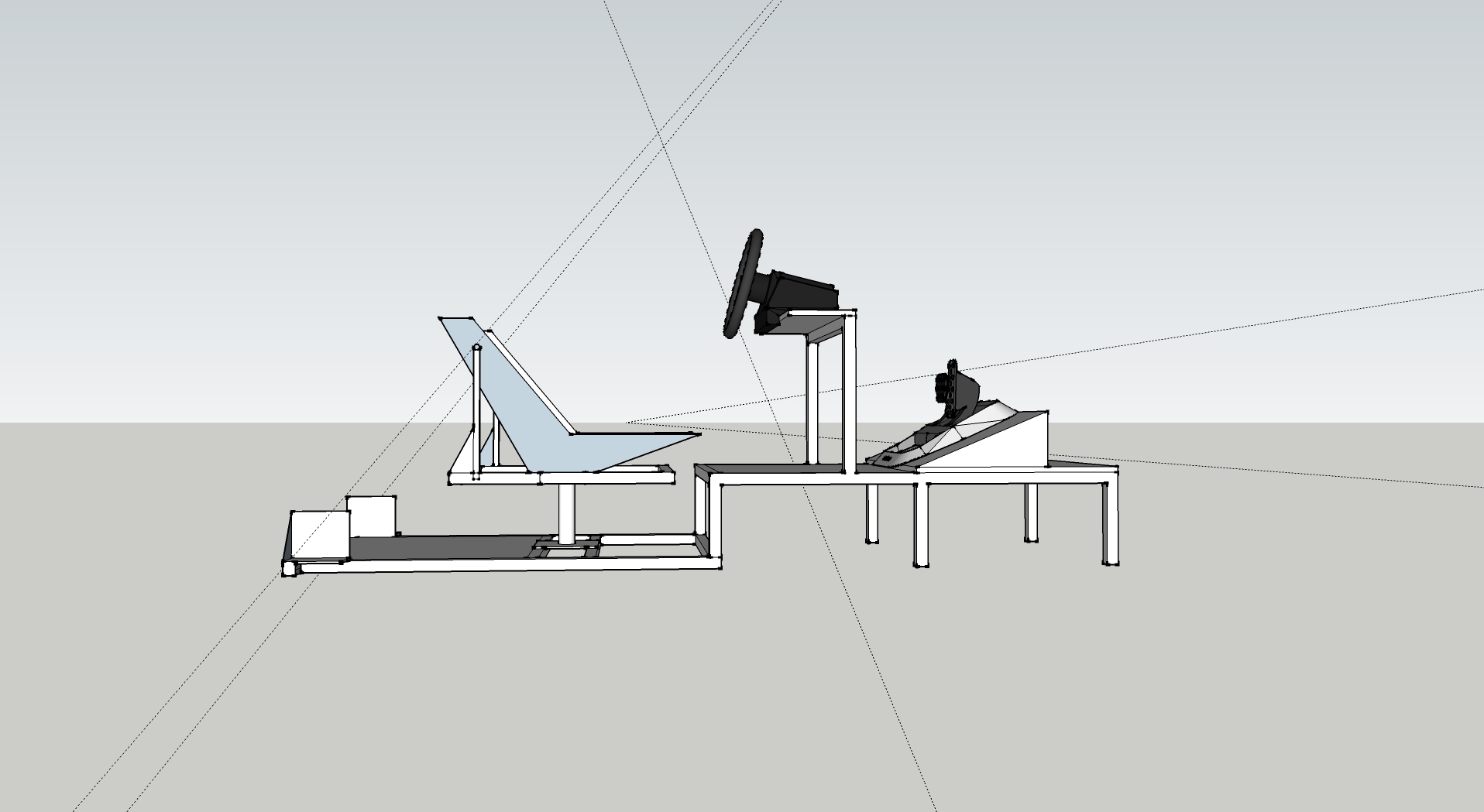

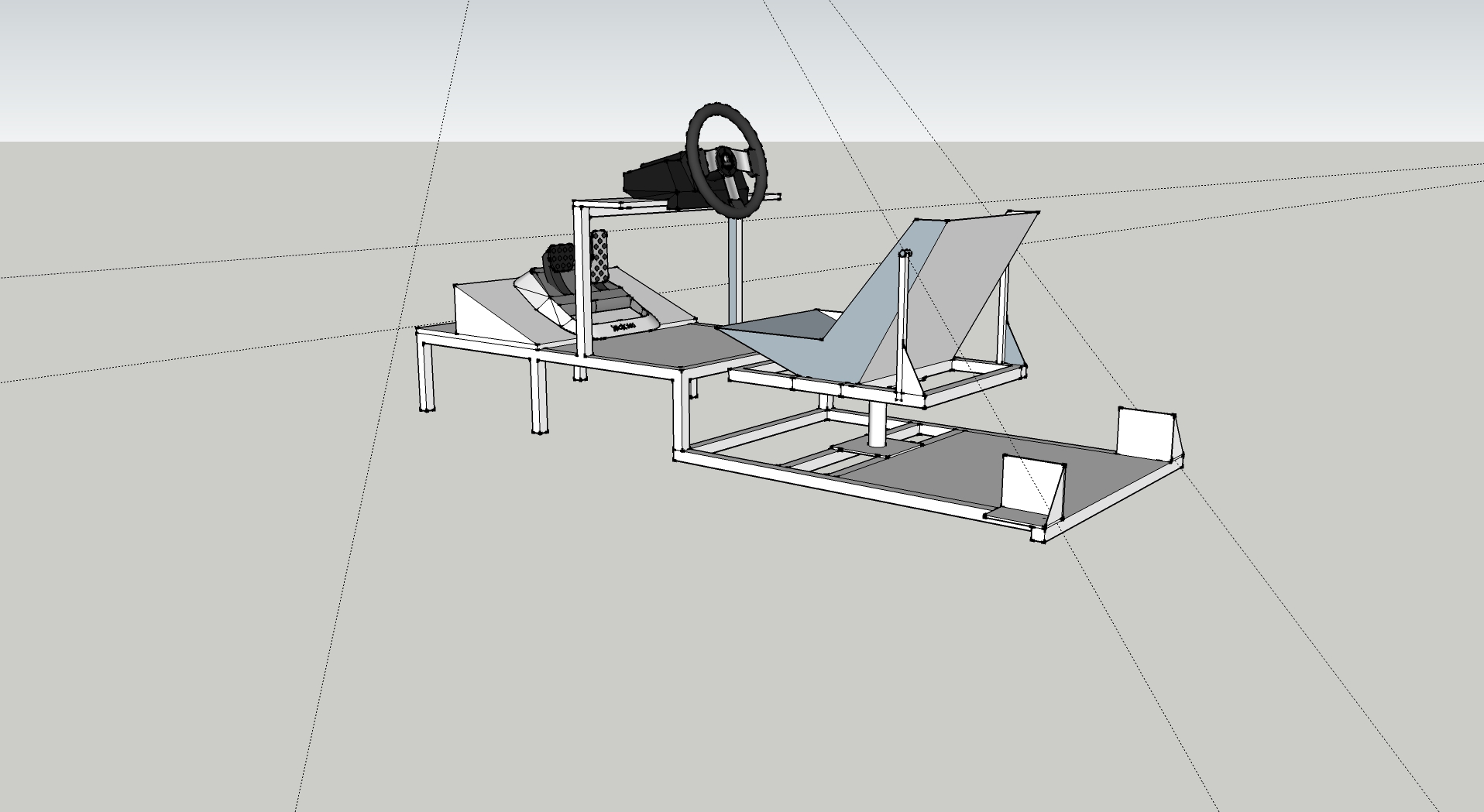

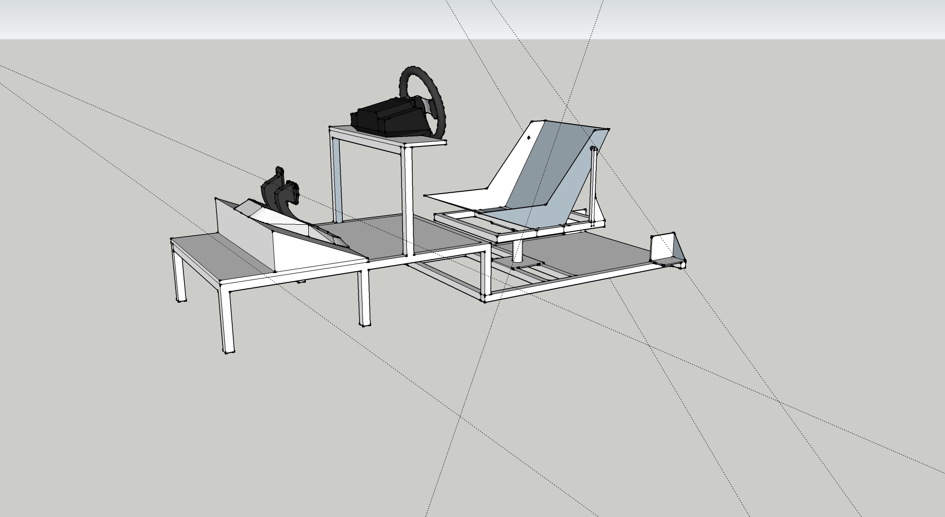

    Hello motion guys, I'm back. Had a great summer, did lots of racing and now the snow is about to fly so it's time to get serious about sim racing. I've got all the parts needed for my build and I've been working on some plans which I thought I'd share. Let me know what you think.
  9. bsft
    Looks fine to me, a "go kart" style frame

    Yea I also decided to use a fiberglass kart seat which weighs almost nothing so should hopefully help make this a snappy rig. I'm thinking about shortening the back piece by 6 inches cause the angle of the rods seems a bit much??...

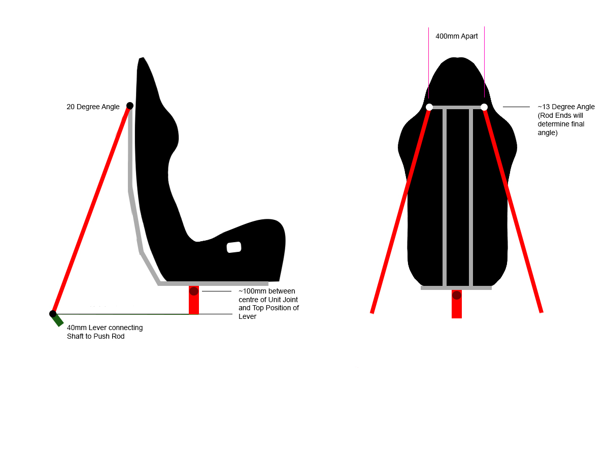

    This is what I built:
    This works well for me and should give you a starting point at the very least.
    I can't really say that I have any issues with this setup.

    @getti , check the height of the wheel in your design, or make it adjustable

    Yes, wheel height and distance will both be adjustable. It looks like it's high in the sketch but thats just cause its a kart seat. It stops below the armpits, the upper body is above the top of the seat.
