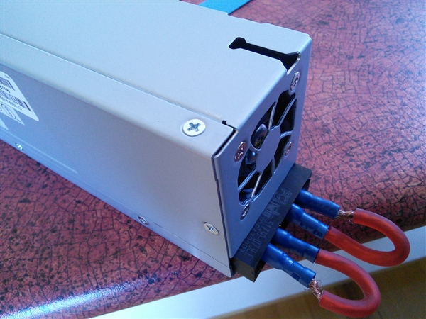

    The connections for positive and negative need to be bridged together. In @Slider's original guide the suggestion is to solder each pair of tabs to the wire: http://www.xsimulator.net/community/threads/how-to-modify-a-server-power-supply-for-12v.5774/
    As an alternative I have pinched each pair of the blade terminals together and used two 6.3mm female connectors each side to bridge the bade terminals. I then soldered and shrunk wrapped the power cable to the wire bridge just behind one of the terminals: http://www.xsimulator.net/community/threads/dx-racer-compact-simulator.5866/page-16#post-86634
    With the small pins 6 and 10 go to one side of the switch and 4 and 8 go the other side.

    Awesome thanks for that. I like what you've done to bridge them but where are the leads?

    Can I ask why are we bridging the 12V contacts on these power supplies, what's the reason? I put my ohm meter across them and there is already continuity between these contacts?

    I soldered then shrunk wrapped the power cable to the wire bridge just behind one of the terminals each side.

    One good reason is to increase the contact area of your wire terminals on the PSU leads.
    Even though I doubt that there will be a noticable benefit in amp draw, you might end up with slightly lower temps on your psu leads.

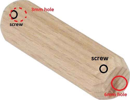

    Got the little motors today!! They have a 3mm D shaft and the 5k pots have a 6mm shaft. Any suggestions on how to mate them up for some testing? Also any ideas on have to make a little lever arm for the motor? Thanks!

    I was thinking about some kind of poly tubing but the shaft diameters being different I'm not sure how to step one up or the other down.

    you can use something like a dowel and open one 6mm on one side and 3 mm on the other side and then tighten shafts with one screw at each end like a coupler

    Heat shrink did the trick. Thanks. Now I need to make a lever?...
