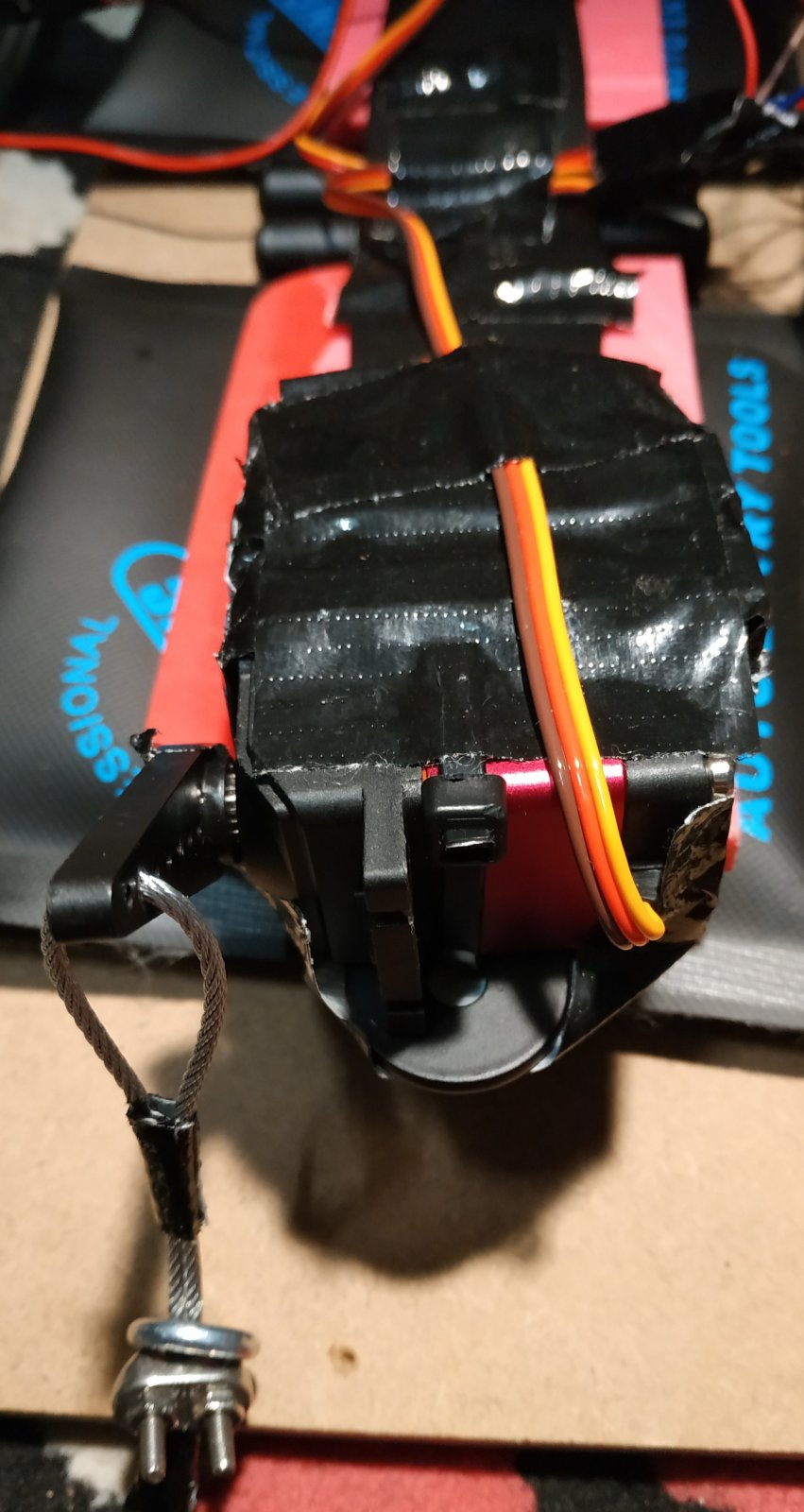

    First thing a note on the reliability of the system.
    I started to use plastic ties to link the servos and the plate but they were breaking very often, so this is a bad design.
    Then i used steel wires but it started to wear the servo arm with the friction. So I went back to the hardware store and finally found steel wire with PVC galvanisation.
    No wear anymore, no breaking, works very well

    here is a picture of the wire and the clamp i use to keep it in place IMG_20200726_105818.jpg

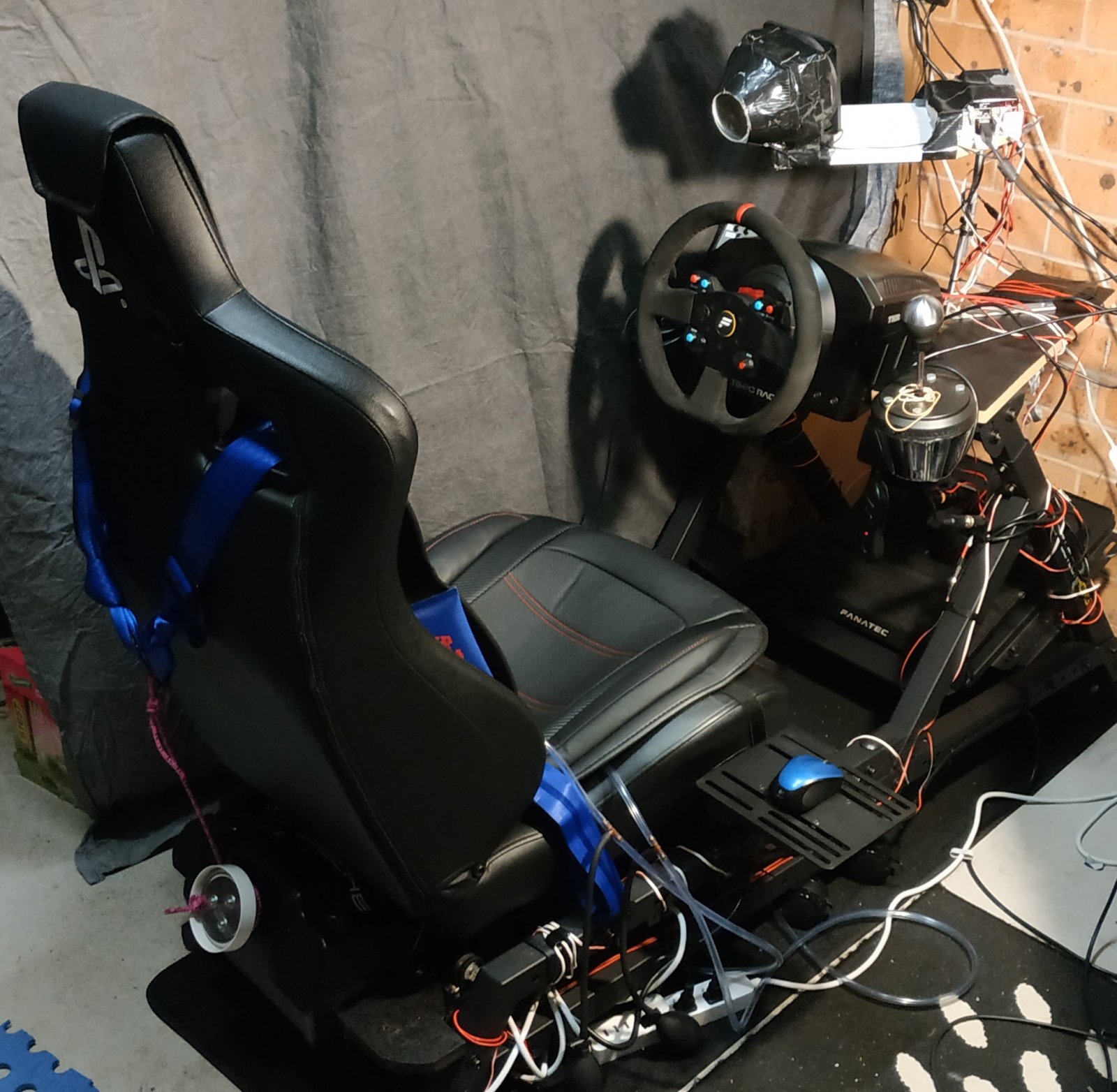

    With the lockdown, I am not travelling anymore so the 'foldable' being not a requirdment, this capability is gone ;-)
    I picked a next level racing GTTRACK on the second hand market, nice and robust

    This picture shows the RIG, still as a work in progress. Cabling need improvement and the wind simulator has been simplified since.

    You can still see the G25 seat belt tensioner, works like a charm, very easy to adapt from the old RIG to the new one.
    As well , the GSEAT servo plate fit perfectly under the seat and I have build a second one with 3 additionnal servos that I have put under the pedal plate thank to the low profile of the system.
    So the 'tech' part is fully hidden

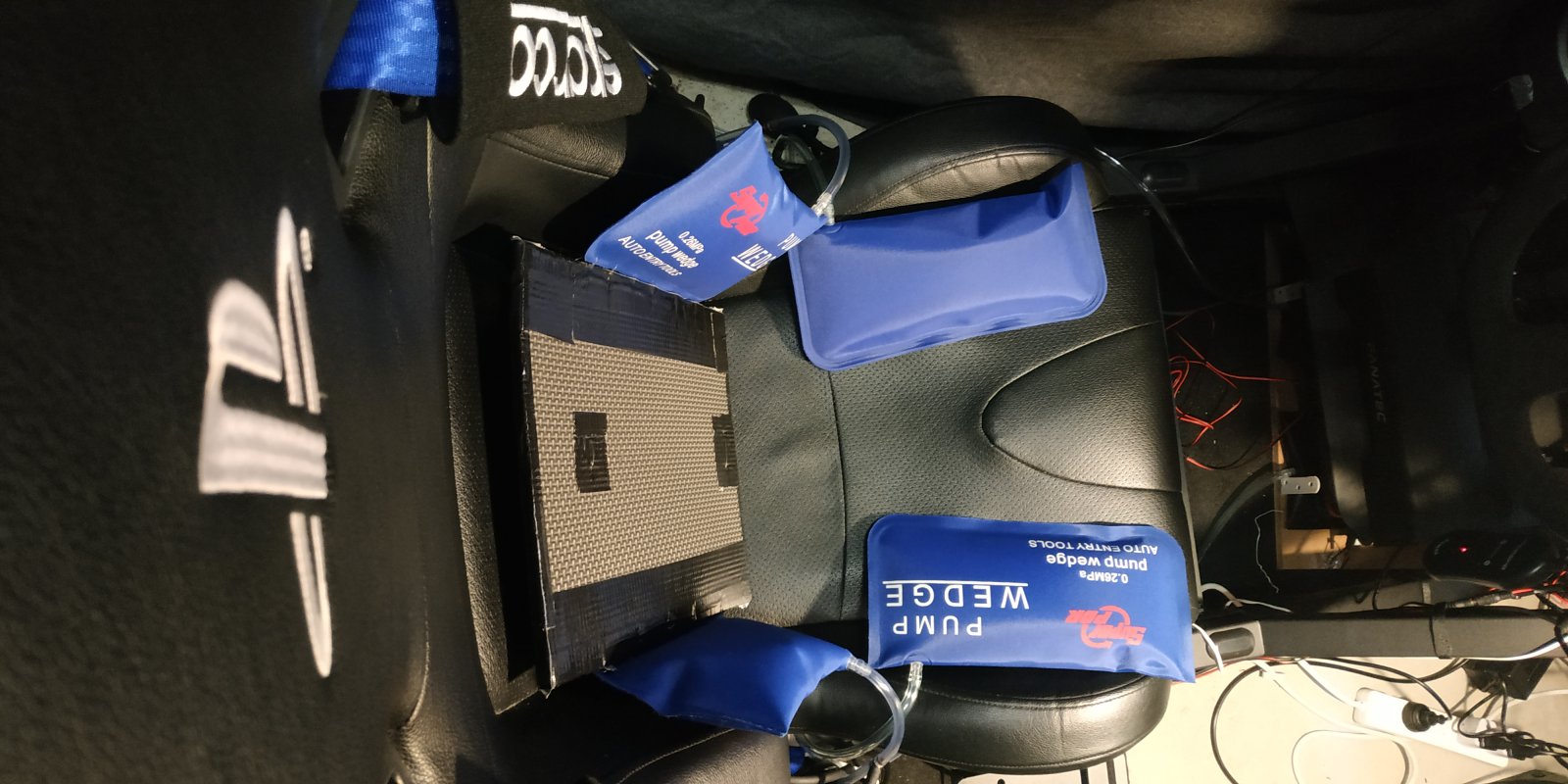

    The good thing is that I did not had to adapt my GSEAT system, I could just transfer it to the new rig.

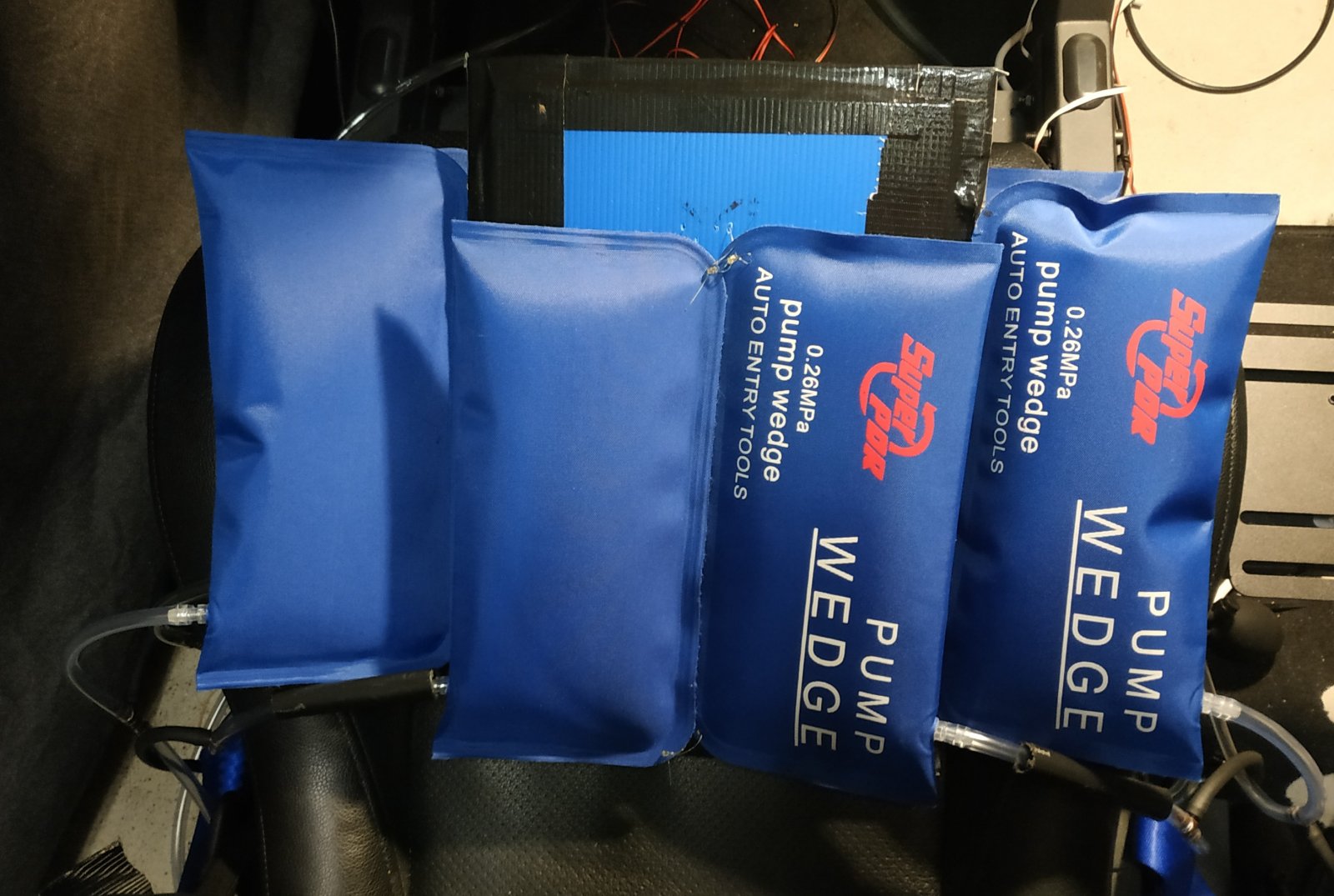

    I have improved the wedge positioning and support:
    firstly by adding 2xsurge wedges in the back on top of the right/left sway one. All fixed together on a tiny foam section.
    The secret to hold them in place is to stitch them with a fishing line, this works very well, see pictures below

    this is how it fit into the seat
    You can see 4 wedges, but there are 6 of then in fact, with the 2 in the back IMG_20200718_110037.jpg

    View from the back

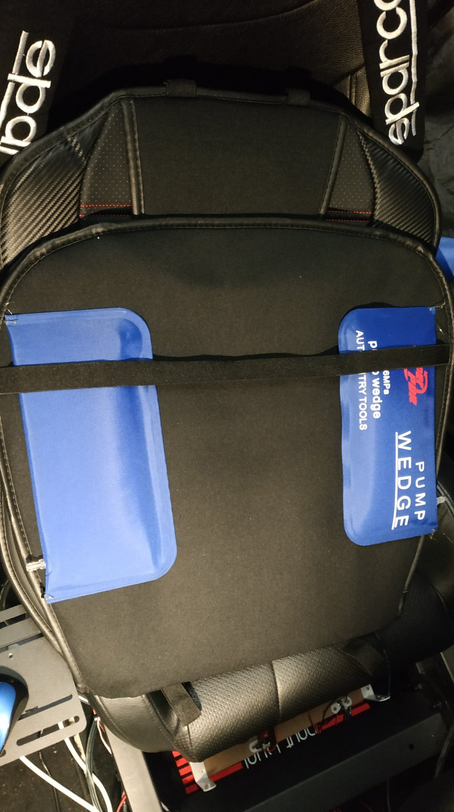

    You can see the stiching (very amateur but does the job)

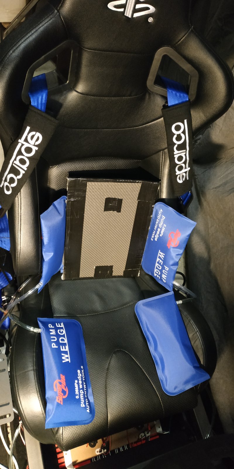

    airplane view.
    The wedges are just dropped IMG_20200718_110119.jpg in the seat, and it stays in place, no need to do any transformation to the seat it self

    I am still using my seat cover to hide the wedges and the Playstation logo ;-) IMG_20200712_225441.jpg

    I have 2 wedges at the bottom and actually now a third one at the form heave and surge (breaking), stiched under the cover
