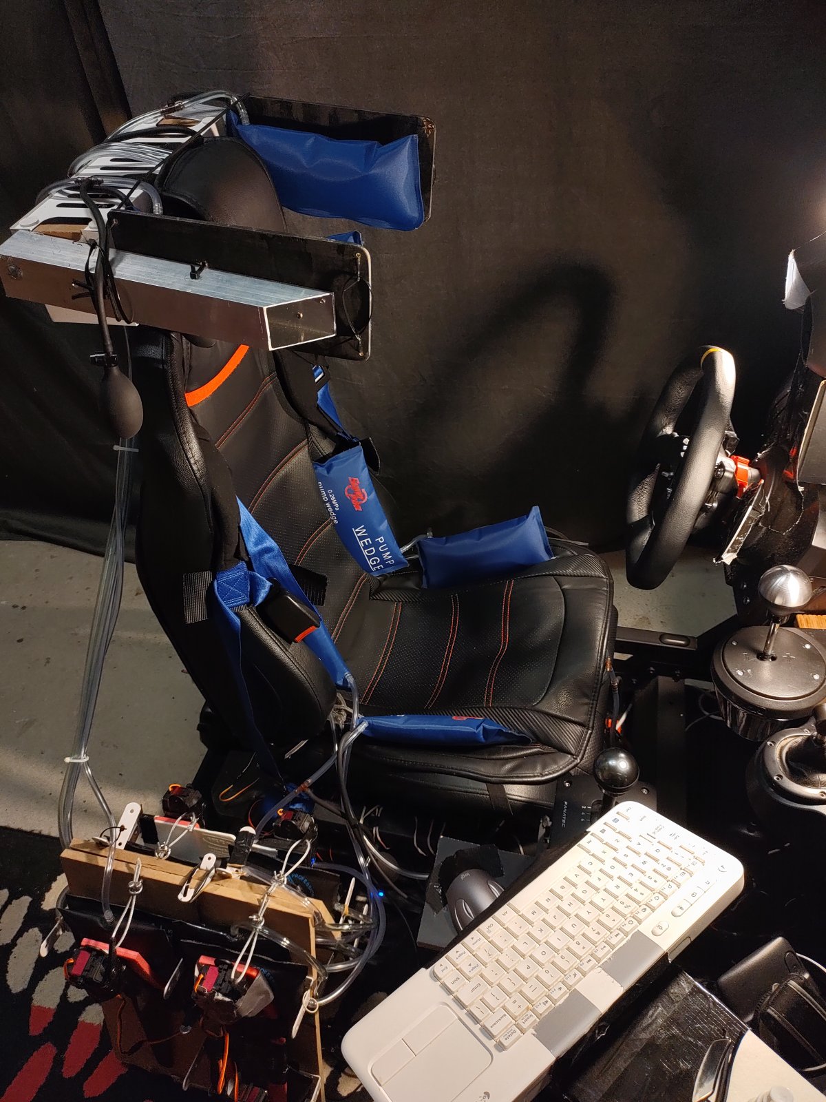

    Hi all
    In my eternal quest to find out which new feature i could add to the sim rig, i have been looking a G-HEAD systems.
    Finally i have just put a bladder behind my head, under the seat cover (red spot) and it give quite good results considering how simple it is to implement ;-)
    I can set it either for breaking or accelerating. I prefer the acceleration mode (simulating the helmet being compressed to the seat)

    After few hours of testing, quite happy with the results. Having your head being moved by an external device feels really like having a helmet with G-Force.
    2 more bladders for right / left should be quite nice as well. Not in my roadmap though ;-)

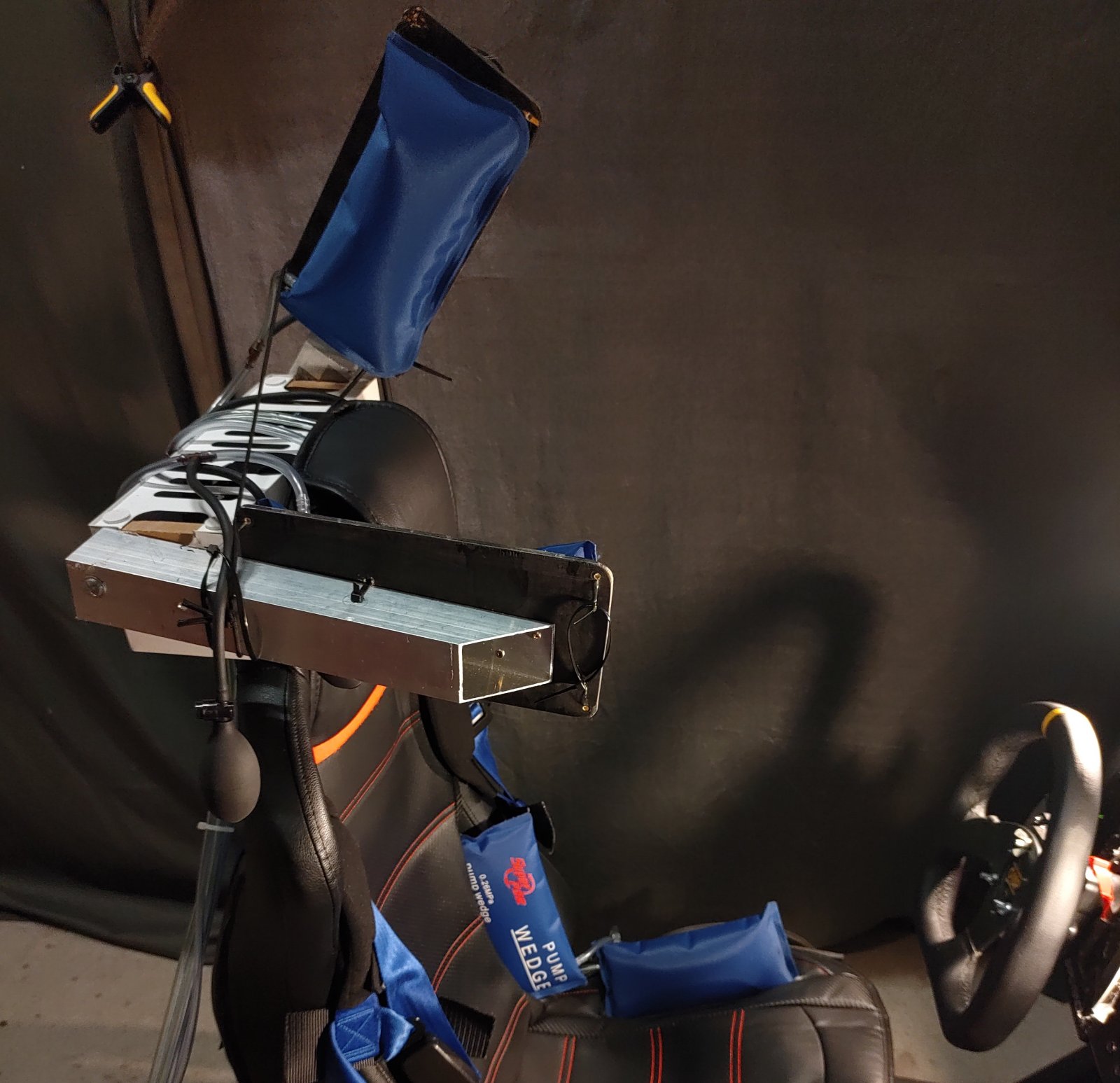

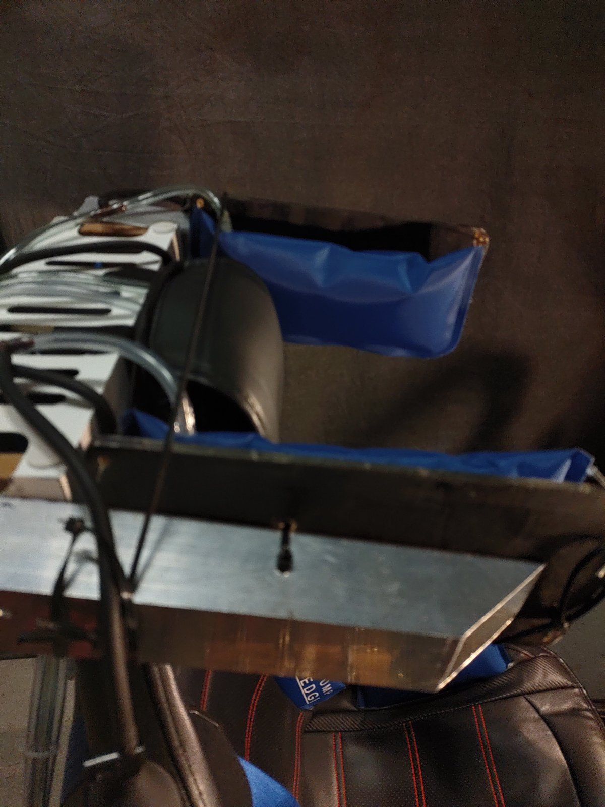

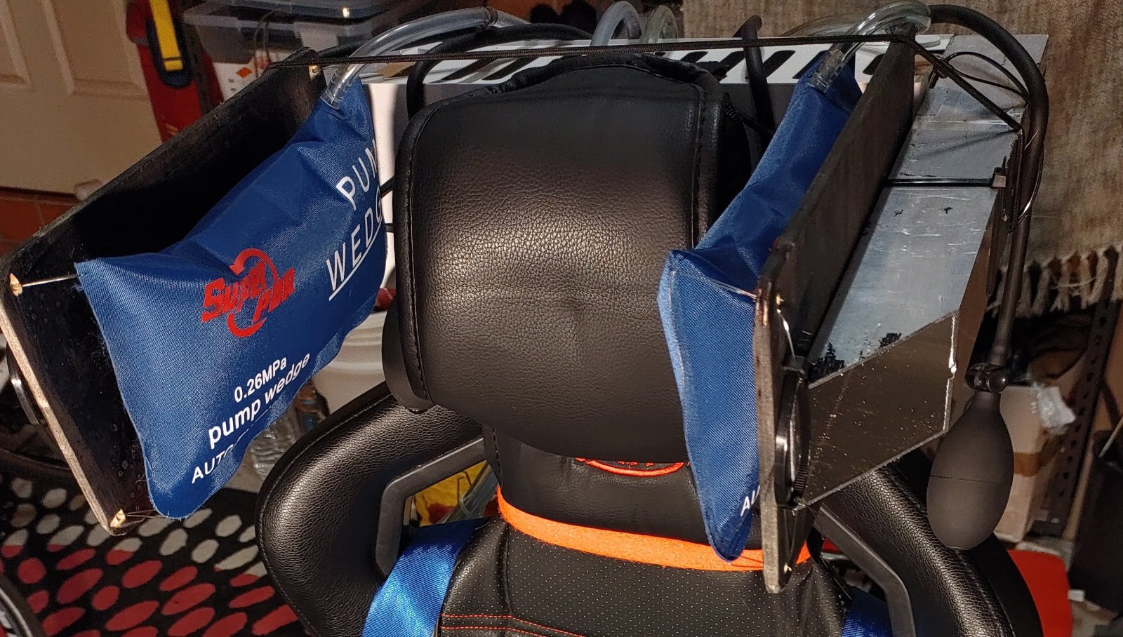

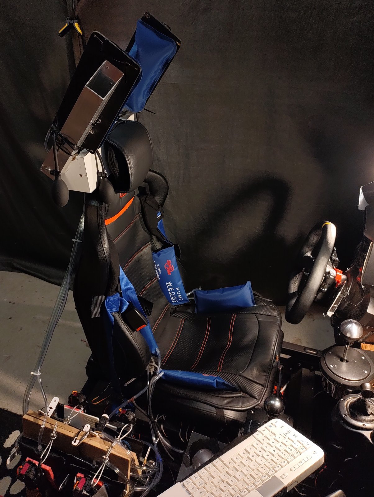

    Hi All
    I have upgraded the G-Head from surge only to:
    -Surge/heave at the back of the head with double wedges instead of one: great improvement and probably the best effect of the whole RIG
    -And at the sides , 2 wedges for Sway and Heave with a removable and articulated system. It allows to use it or not. It is a nice addition for very extreme cars (open wheel, GT3 and above race cars) but can be a bit annoying for more casual racing.
    See some photos below
