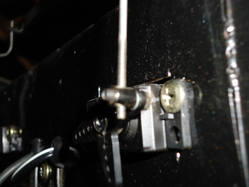

    Is hobbyking.com.au any good for buying (small) servos and pushrods and stuff?
    Or can you suggest somewhere else?
  9. eaorobbie
    20,502Coins
    +1,687 / 23 / -2
    I used my local hobby shop, cheap servos can be bought for under $25, for model purposes even miniature servos can be used too, I just asked them whats the cheapest servo you have, they handed me 2x Futaba s148 servos for $25 each. Push rod and bits are Standard servo rod 1.6mm I think and connecters are cheap and as pictured below.
    Please excuse the blury photo couldn't find the camera, lol off me old iphone.
