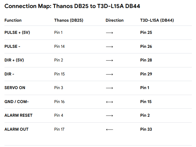

    I insert an image of the output 44 pins from the T3d-L15A to the male connector db25. Can you see it and confirm if it is correct?
    In addition to the cable, I will have to configure the servo-driver:
    - Press input mode: Press + Direction.
    - Pn001 = 0 (Control mode in position)
    - Pn008=0 (press + direction).
    - Pn009 = 0 (pulse logic direction)
    - Pn052 = 1 (configure Pin 4 as S-ON)
    - Pn053 = 2 (pin 5 as ALRS Alarm reset)
    - Pn190 = 1 (Open/Closed).
    - Resolution Pn010/Pn011 = 10,000 pulses per revolution
    - Pn003 = 2 ( avoids the "External Emergency Stop" error)
    - Supply 24 v to pin 20
  9. Joe Cortexian

    Looks about right. You will get a 44 pin cable with those wires broken out. If you look carefully you find a 44 pin connector in the picture with the bunch of cables.
    I assume that the Thanos has a +5v output to the T3D. I was very confused about this at first but it uses your (aka Thanos) 5v supply to drive the optically isolated inputs and outputs. This means that the grounds in the servo and the Thanos are not shared. NOTE: Don’t connect the chassis ground on the Thanos side.
    I did not have to set any of the modes or other parameters. By default it will respond as expected to the pulse/direction inputs.
    I also have an estop. That doesn’t necessarily go back to the Thanos. I map it to an input on the 44 pin connector. There is also a parameter you can set to keep the motor energized during estop. Depending on your setup the rig might drift down due to gravity.
    I decided on 75ow because that is the official recommendation from Open SFX. Your link came up as 400w but that maybe an artifact of the way the Web page is set up.

    The thanos board also uses a high Torque flag for sensorless homing. Might want to compare manuals and make sure you've got that on alternate drives.

    Good point !! Yes, it is. Bear in mind that these drives are "copied" from the AASD drives. These drives have four inputs and four outputs which can be mapped to a bunch of different functions. I have limit switches but I wouldn't mind using this function for homing myself. I will for sure try it out.
    From the manual's DO function list (Chapter 5, section 5.3 and detailed in 5.6):
    • Number 11 → Symbol TRQL → Function: Torque limited
      • Behavior:
        • OFF: Motor torque has not reached the limit value.
        • ON: Motor torque reaches the limit value (i.e., the actual output torque is being capped/clamped by the limit).
  13. Thanos
    Jul 6, 2017
    1,380
    Electronics Engineer
    United States
    2,925Coins
    +1,080 / 10 / -0
    AI is lying, always making up things like a good sycophant it is. Doesn't know things, it takes random text it trains on (often wrong), and calculates a PROPABILITY it can make up the correct answer. In this case, garbage in, garbage out... but faster :p
