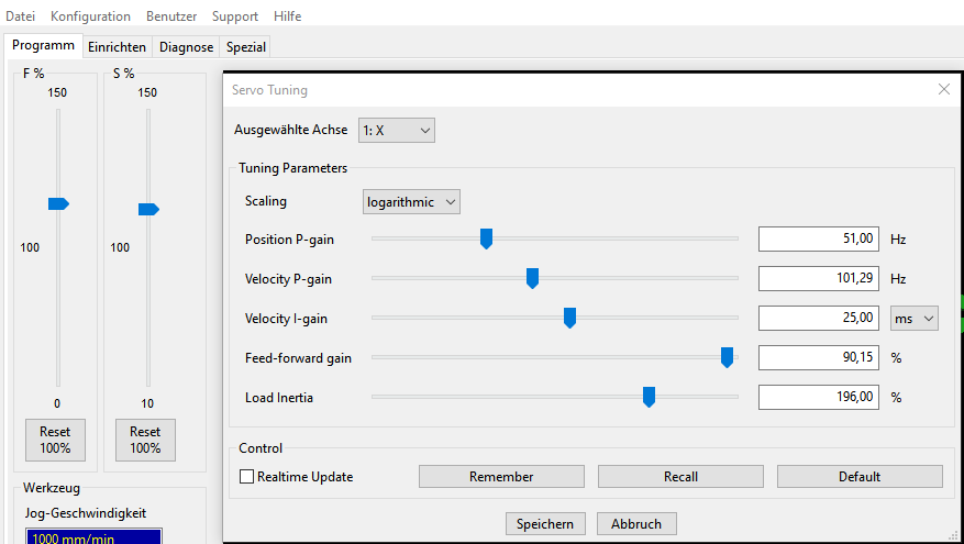

    BTW, I also use MODBUS to tune the parameters. I've written my own code for this and integrated it into my CNC control software.
    It's so much more convenient than pressing buttons on the front panel. But I have to find out how to save the changes to permanent storage. This is done automatically when parameters are modified via the front panel but not when done over MODBUS.
