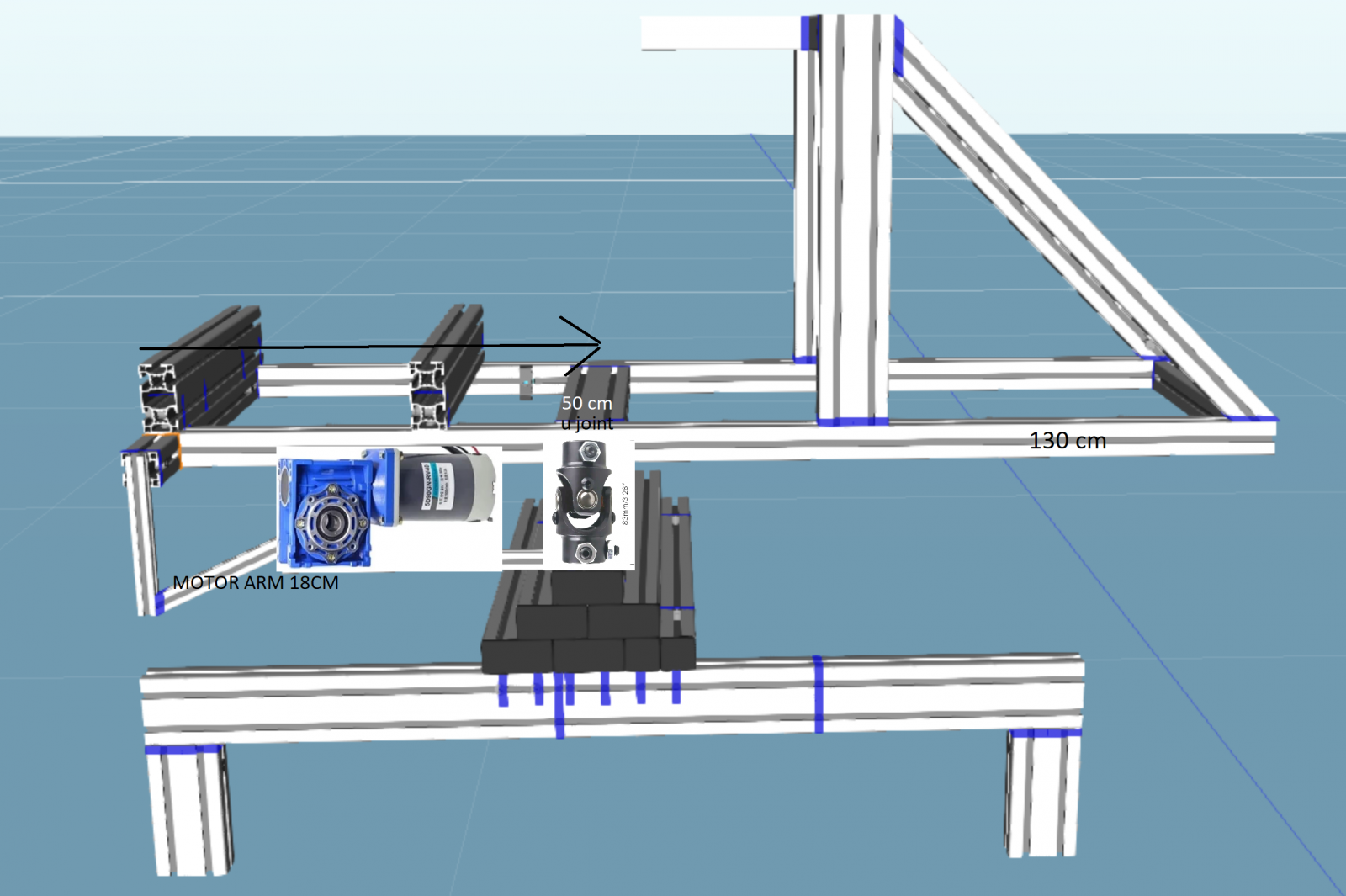

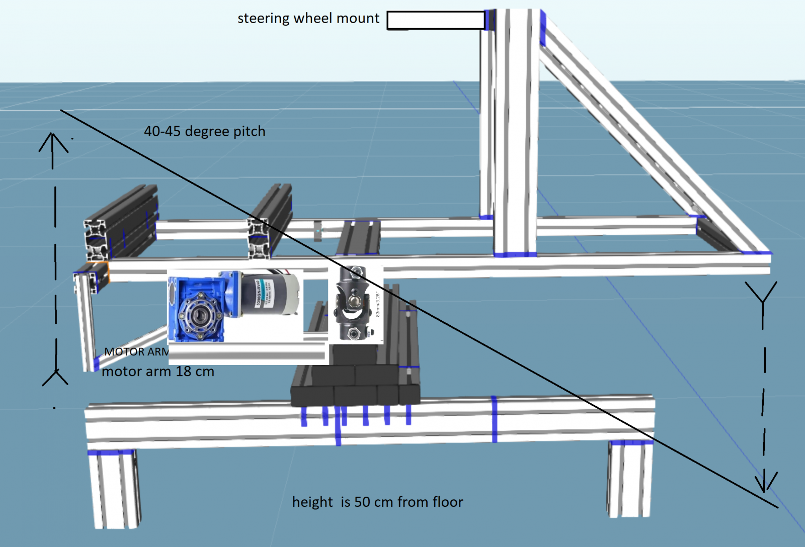

    I want to make it like 35-40 degree of pitch and roll so did u mean that i cant reach that degrees withs ibt2 ?
    and what do u mean about day and night like respons speed? please would u tell more difference

    @Doga Darko Can you post some pics of your setup? what motors etc are you planning on using? actuator, worm drive, gear drive? it's hard to comment with no information about your design.

    +8 / 0 / -0
    hi i use
    https://www.amazon.de/-/en/2200RPM-Stainless-Steel-Motor-XD5D90-24A121SRV-RV40/dp/B08RDHKMFR/ref=sr_1_10?crid=3HX7K3AJC8GHI&keywords=XD5d90&qid=1703854059&sprefix=xd5d90g,aps,109&sr=8-10 these motors 24v 90w 11a 1/60 reduction (36rpm)
    i need 40-45 degree of pitch and roll pictures attached :)
    i also ask a question but its hard to tell in words i make a video for it
  13. noorbeast
    22,021
    153,722Coins
    +11,148 / 57 / -2
    With motors and levers while it is possible to go 180 degrees, in practice it is highly inefficient and puts excessive load on the motors, which in turn means the motors would need to be excessively powerful. The reason is the physics of a lever, over about 38-40 degrees up and the same down effective use of torque drops off dramatically. Think of it like pushing a heavy door with your little finger, if you are right angles it is pretty easy, but if parallel on the door edge it is hard.
    With a motion rig it is not the size of the movement range, particularly in VR, it is the speed and precision of motion that matters. Getting close to the physics limit risks control and precision.

    if i didnt try its always bits my brain ''what if what if'' i must try it :)
    if i make it possible and dont like it i turn it down to 20-25 degrees
    by the way i want to make fun not control and precision lap times.
    and chat gpt says 45 degree is equal to 1g and thats equal to 100km/h to zero like 2 seconds break time

    Totally up to you what you build and experience is a great teacher, with innovation being the lifeblood of our community.
    That said, also keep in mind that a DIY motion rig does not recreate real world forces, it is impracticable to do in a compact form for a variety of axis. Rather, the aim is to give your brain enough crafted ques that your brain accepts something as real, even if it is not, and that takes speed and precision.

    I agree with @noorbeast on the lever range. Although my levers can physically achieve a 180 degree arc, they only operate 45 degree off 90 up and down on my setup. I have actually introduced spring buffers to limit them from exceeding their 45 degrees travel up and down because of inertia, as well as the software limits.
    I found larger rangers of motion although possible, caused them to slow in those regions and heat the motors up more (as like @noorbeast has described) because of the effort they had to make to come out of those angles.
    Hoping I'm making some sense here. And again @noorbeast is on the money. Fast accurate motion wins hands down if you are really trying to emulate realistic motion in a sim. Unless you are more interested in an arcade ride which is OK as well. It just comes down to what you are trying to simulate.

    Hey @Doga Darko I do not have an answer for your question because I have no experience with the gear box style motors. I think you will find that that amount of motion will be very distracting when you are gaming. Maybe in a flight sim those ranges of motion are ok IF your motors can sustain the work load. In a racing sim you will never need so much range. You want short, sharp, accurate motion with racing sims. You need a good quality fast motor controller.

    i see a video on yuotube less motion is best moniton and everybody else use lessmotion I just want to try :)
    Yaw 2 has great degree :) im try to simulate its rotations.
    There is a common Turkish word.
    1 bad exprience is better than 1000 good suggestions. Lets try it then i share my exprience from here.
    im also driver on weekdays when i got home and race without motion i get kinda bored.
    and if i build something like this it must have range for 45 degree.
    thanks for advices i keep in mind them.
