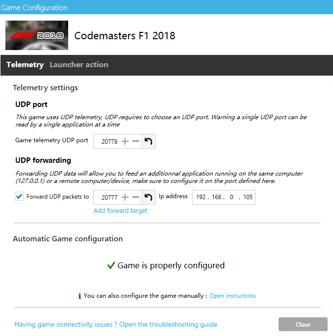

    Excuse me, do you use SIMHUB software?
    I really like this software and want to use it, but I found that in some games, mainly CODEMASTER racing games, such as DRIT series, F1 series, when using SIMHUB, the seat can not move unless re-played The patch can move normally.
    I guess because CODEMASTER's racing game has only one UDP output channel, which can only be used by one of SIMHUB or SIMTOOLS. If one of them is given, the other one cannot be used. I don't know if my guess is correct.
    Like in a game like AC, the two software can run perfectly at the same time.
    So I would like to ask, is it only that I have encountered such a problem, or you are the same, but is there any solution? Let these two softwares work perfectly in all supported games at the same time?
    Thank you very much for your attention and reply.

    I think Simhub has a UDP pass through option. Does enabling that help at all?
    20,567
    145,220Coins
    +10,782 / 52 / -2
    The issue is port conflict and you can port forward in SimHub in the Games tab.

    I have studied it myself. With UDP relay, now F1 2018 can run SIMHUB and SIMTOOLS at the same time, but I still can't make DRIT series. The UDP output of DRIT series seems to be different from F1 series.

    I am done, so happy, now both the F1 series and the DRIT series can run SIMHUB and SIMTOOLS at the same time.

    You can try to install the latest version of SIMHUB, the UDP setting in the latest version has become easier.
    I don't have F1 2019, I only have F1 2018, but I think they are the same.

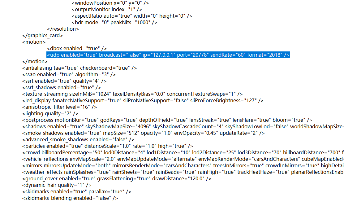

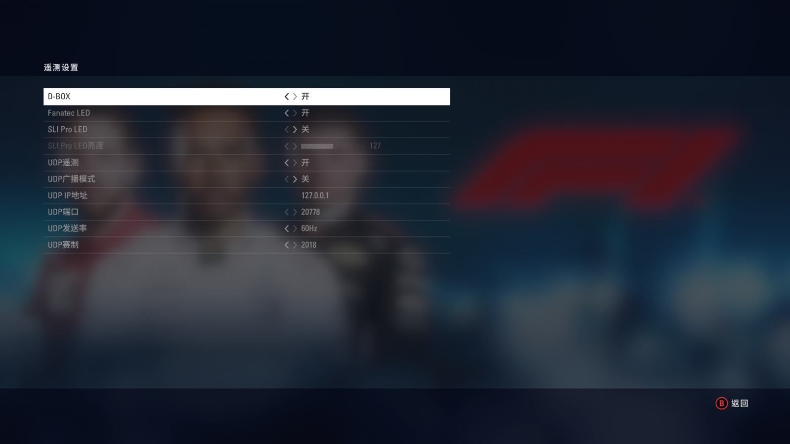

    I have n’t played this game for a long time, I hope this information is helpful to you.

    oWith F1-2018 its working thanks

    First download the latest version of SIMHUB, then find the DR2 game settings in SIMHUB, turn off UDP forwarding, or reload DR2 settings.
    Re-patch the GAME MANAGER, so it is basically OK. If you are not assured, you can find the hardware configuration file of DR2 and check whether the UDP port and IP address are set correctly.
