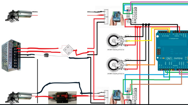

    pwmmax at 80 is very low? yes, I'm going to recheck everything but as said it worked 10 minutes before I did a four minute session to see if it held up and I had no problem. anyway the motor was still powered, even when I came out of the game like a grunt and I can't find what it is even when replacing the potentiometer the cable. It still has a kind of mini movement even though all the software was off, no, there is something wrong with that, unfortunately, my knowledge is not extensive enough
    yes on the power supply I lowered from 27v to mini 22v
    edit:yes on the power supply I lowered from 27v to mini 22v

    ah yes OK, so it is the voltage that is the problem so friends on your PSU especially check that you are not above 22v or even less? because 27v is the end of IBT2!! Description
    This H-bridge is ideal when you need to drive a motor that requires a lot of current. This card is made up of 2 BTS7960 H half-bridges which can support a current of up to 43A at a voltage between 5.5V and 27V.

    small update, the power supply does not go below 22v, but it seems to be ok with the ibt2!!
    it mooving !!!

    This is my wiring,
    @noorbeast In your opinion, should I place the 40 amp resettable fuse between the iBT card and the motor. or rather between psu and IBT on the positive or the gnd?
    this for one motor for one psu!
    rectifier diode bridge kbpc5010 1000 volts 50 amps
    And schottky diode which 30sq050 volts 30 amps.
    21,737
    152,195Coins
    +11,064 / 56 / -2
    I fused my rig on the positive side of the PSU.
