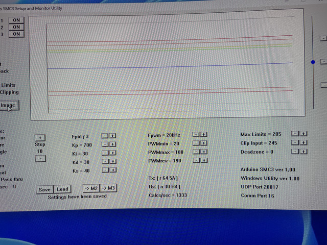

    @noorbeast here I am again after a break, it's better! much better,
    thank you for the links for the noise of the engines...:thumbs
    my parameters for the tim smc3 utils:
    Fpid: 7
    Kp: 150
    Ki: 15
    Kd: 0
    Ks: 30
    Fpwm: 20kHz
    Pwmmin: 0
    pwmmax: 150
    pwmrev: 140
    maxlimit: 215
    clip in: 255
    deadzone: 0
    I can still improve, but already there are no more unpleasant hums from the engines...

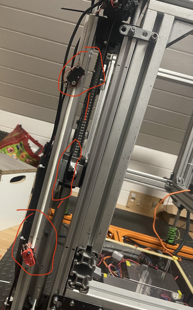

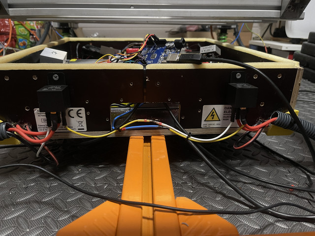

    Hello little, update, addition of springs which allows you to reach the endstop but not to engage them, if there should be a problem, the feet can continue to retract and the chassis will be placed on the springs. I place the electronics in a box too and I could carry out the load tests between 150 and 200 kg..

    by chance I found the noise of the motors, I connected the endstops to the potentiometer signal, so big interference. Now the problem is that I don't know how to wire the endstops, cutting the 220 V, it's useless because it takes between four and five seconds to stop, so plenty of time to tear the motor out. Is cutting off the I BT power supply sufficient and fast enough to shut down the Motor? Or do you have an idea of how to place and connect the limit switches?
    21,705
    151,875Coins
    +11,060 / 56 / -2
    There are a number of ways to implement a kill switch, see the FAQs here: https://xsimulator.net/community/faq/emergency-stop-switch-wiring.56/

    hmmm I don’t know, the limit switch and emergency stop switch are identical?
    since as I said cutting the power is of absolutely no use since it takes at least four to five seconds for the power supplies to turn off and during this time the motor continues to move. And of course it's way too late. The emergency stop, I have already wired it to the 220 V, it is really the limit switches on each cylinder.

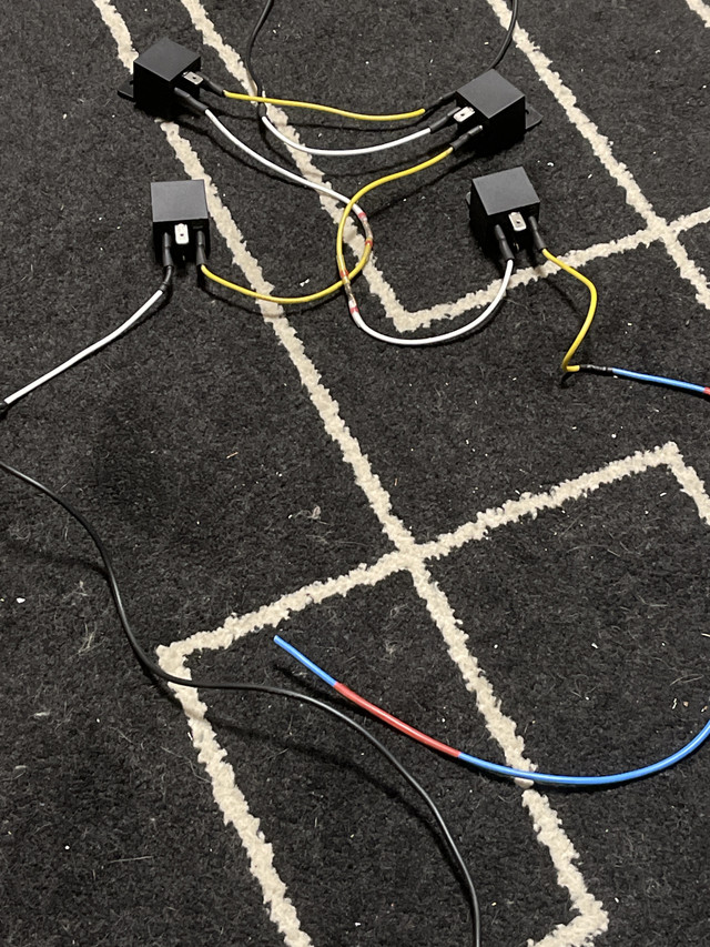

    Well I did the tests and cut a wire on the IBT2 for the limit switches, it's absolutely no use, it doesn't work.
    I have to either cut off the 220 V power supply as soon as it reaches the switch setpoint, or with a relay cut off the 24v motor power supply.
    I think that for the tests I will use the second solution with 24 V 40 A relays in parallel for the windings and also in series on the switches. This way, as soon as a switch is activated, everything is turned off.

    Yes relay and test in 150kg is ok.

    well I wanted to do a test with 100 kg load and it's not good. After a while the cylinders, it's as if they were no longer powered, but only on one side. Namely that I have just done a calculation with myself on it, it must be able to hold the 190 kg so I am missing 90 kg for it to work…. then…. :(
    Hhhaaaarrrggggg why :soso_O
    my params smc3 utils:
