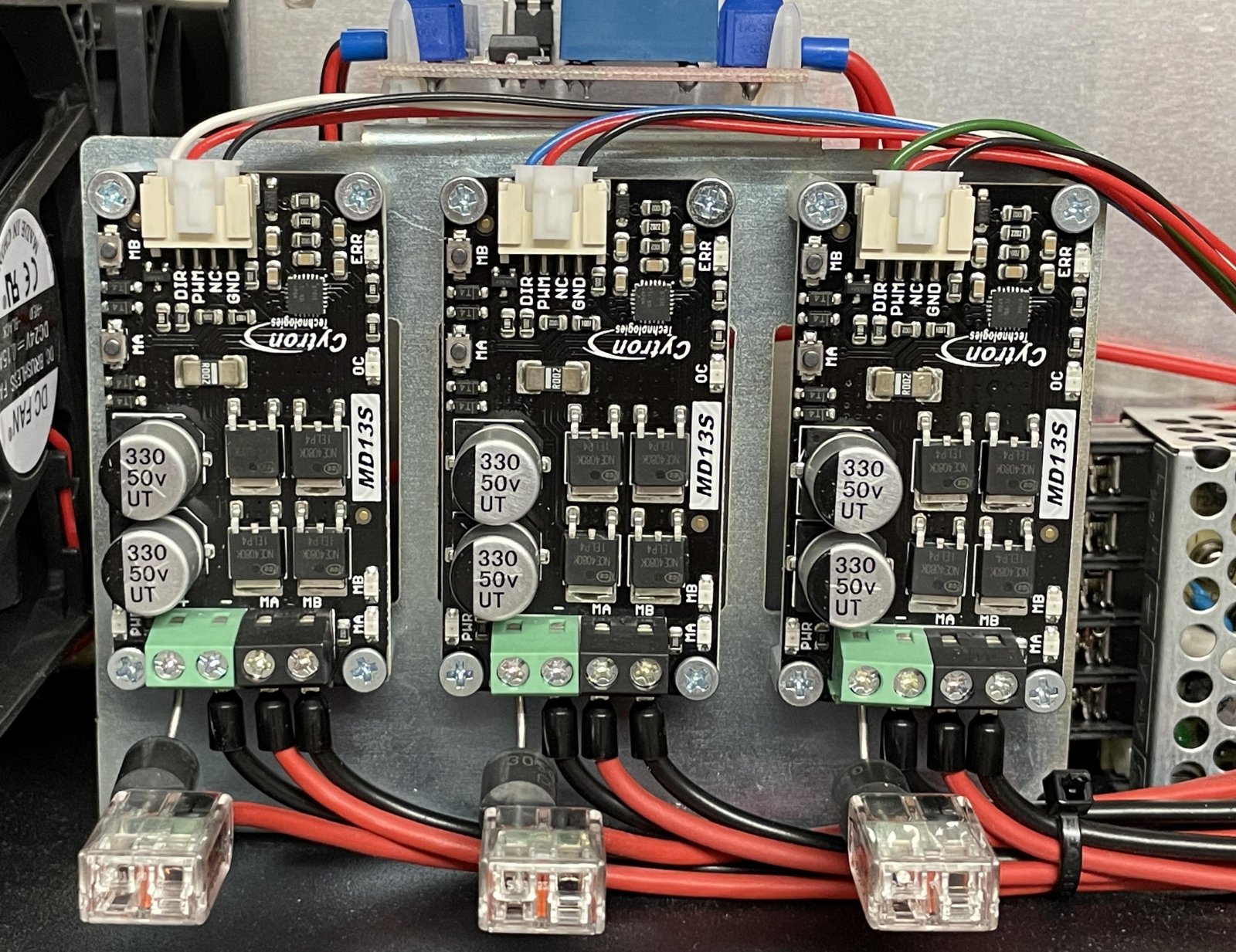

    An important thing too, you have to think about the current return. Because changes of direction consume a lot but with the weight on top, it sends current back to the power supplies, what have you planned to protect the PSU?

    Brake resisor with FR120 mosfet
  5. m50b20
    m50b20 Member
    Jan 4, 2024
    87
    118Coins
    +60 / 1 / -0
    Or you can use just big enough diode but you need your motor driver be capable of two times more volts than your motor is working or it will die )

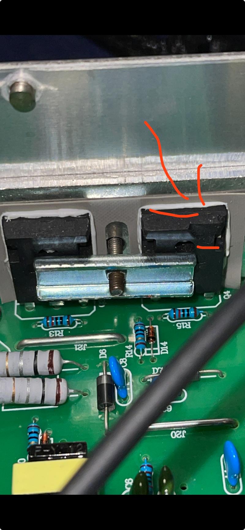

    Black thing on the bottom is a fuse ?? Or what is it ?? I can't realize

    Hello, following some problems, so I switched to two dof, load test at 80 kg after a minute a little smell of burning I stop everything I open the power supply and there disaster... :(

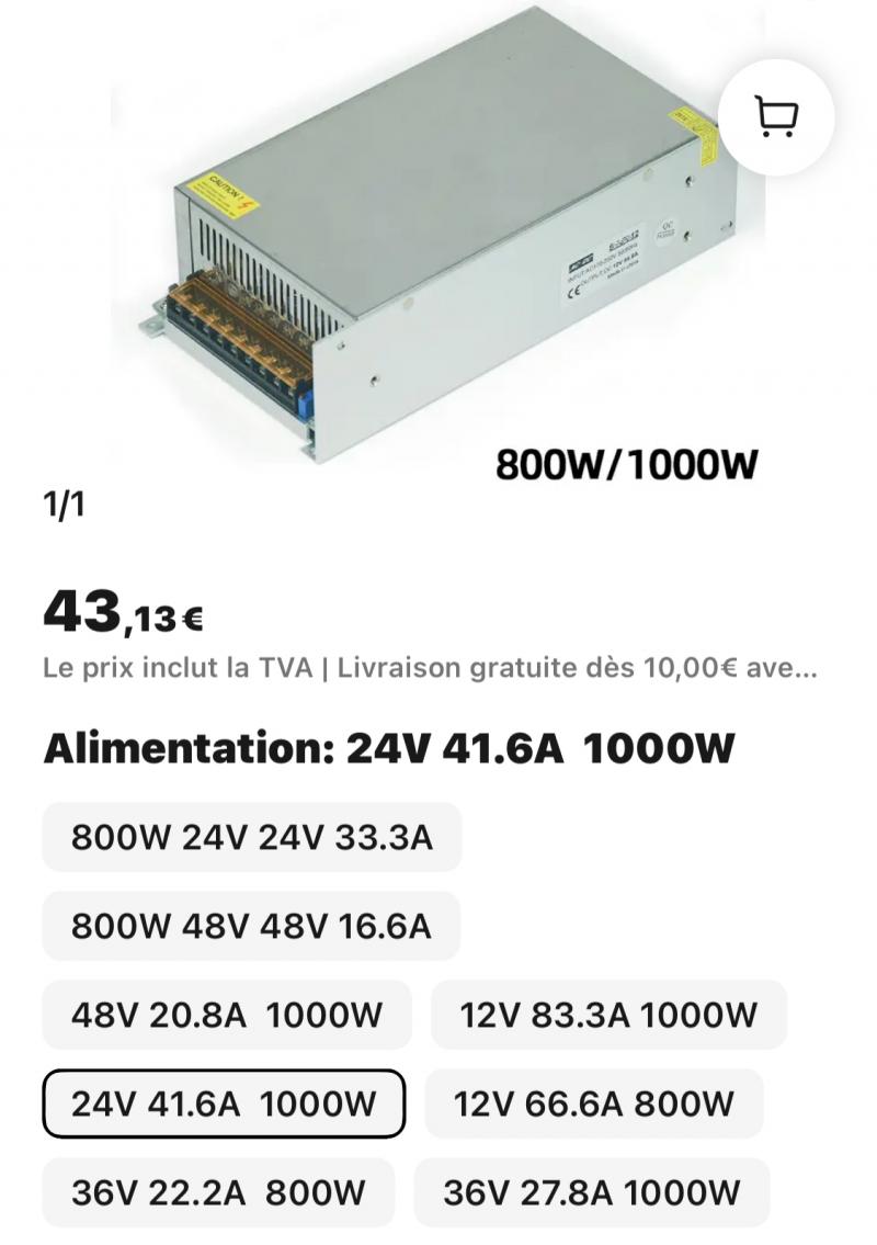

    What kind is your PSU ?

    24v 1000w:

    Erf, psu on fire, There was smoke everywhere...
