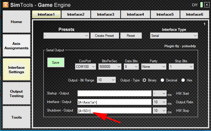

    A question: for the strings below I noticed that the operation is identical to when they are not written, as if nothing changed.
    START OUTPUT
    [A<128>][B<128>][C<128>]
    SHUTDOWN OUTPUT
    Maybe I'm doing something wrong? I have already read the FAQ but I haven't found anything that can help me. Can you explain exactly what they are for and tell me how to make them work?
    I have 3 axes and they work with Arduino.
    You tell me, thanks
    21,695
    151,815Coins
    +11,058 / 56 / -2
    They are positional commands to tell the rig where to go to when is starts and when it exits a game, see the FAQs here: https://www.xsimulator.net/community/faq/startup-and-shutdown-positional-controls.234/

    Hi, unfortunately I can't get the "Startup - Output" and "Shutdown - Output" lines to work.
    I performed the test on a single actuator, entering the data as in the attached image.
    I know that by entering the value "128" the actuator is positioned exactly in the center, but to test the operation of the string I entered the value "50" to lower the actuator when I exit the game, but the actuator always remains in the center .
    Maybe the string entered is wrong?
    Note: I'm using Arduino

    I don't use SMC3 so am taking a bit of a stab in the dark.
    This is the FAQs re startup and shutdown settings: https://www.xsimulator.net/community/faq/startup-and-shutdown-positional-controls.234/
    And from the SMC3 thread the related SMC3 set commands: https://www.xsimulator.net/communit...driver-and-windows-utilities.4957/#post-48122
    SMC3 Command Set
    All commands to/from the SMC3 are sent as data packets each 5bytes long. They start with a left square bracket '[' and end with a right square bracket ']'. Typically the second byte is the command and the third and forth bytes are the parameters.
