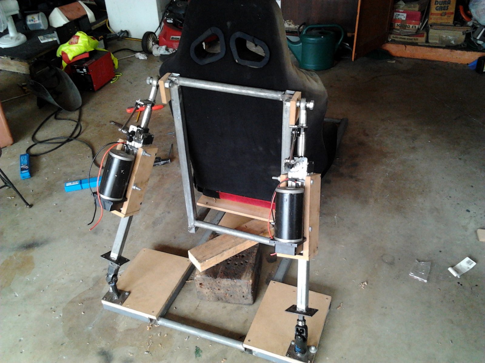

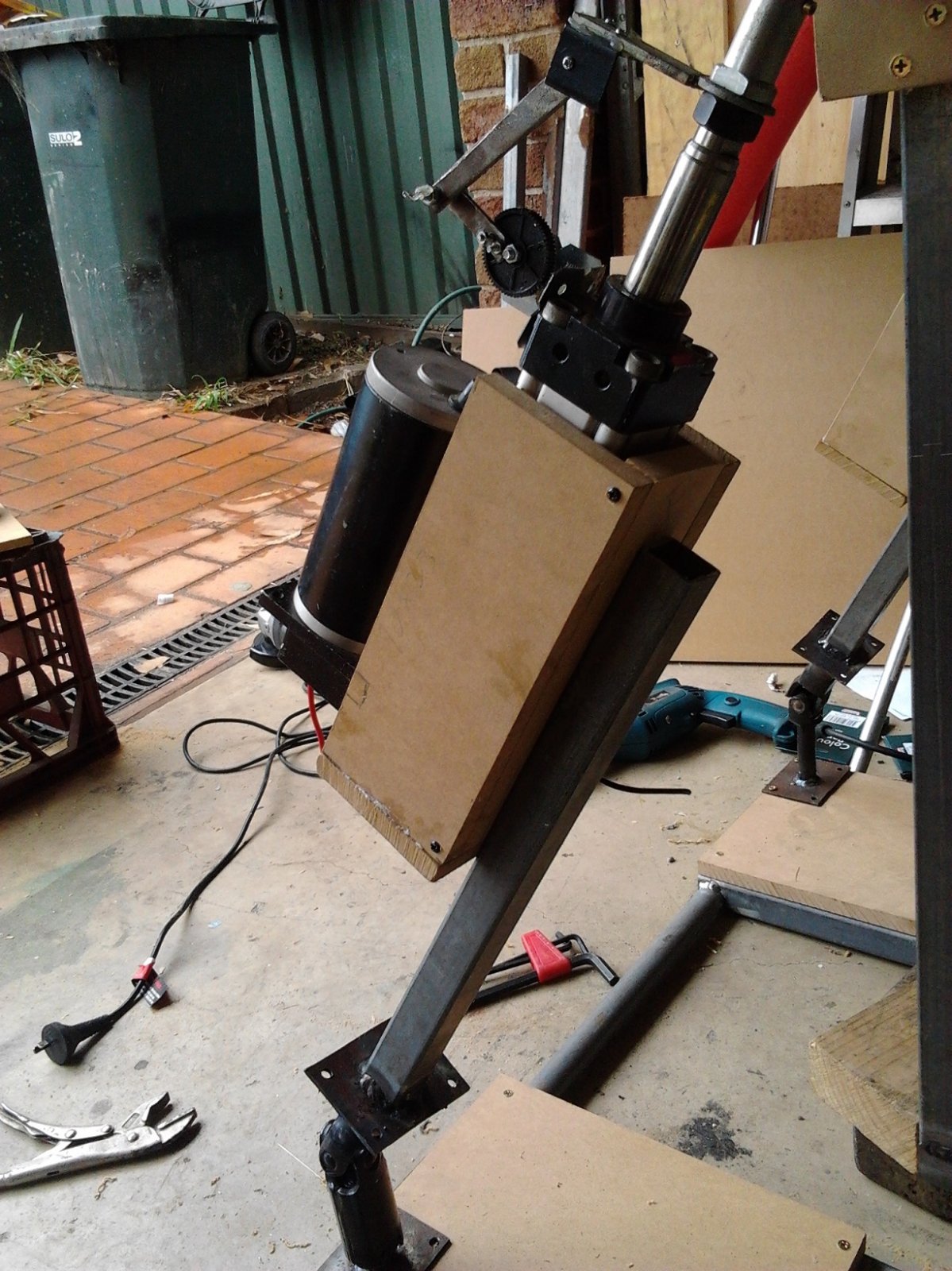

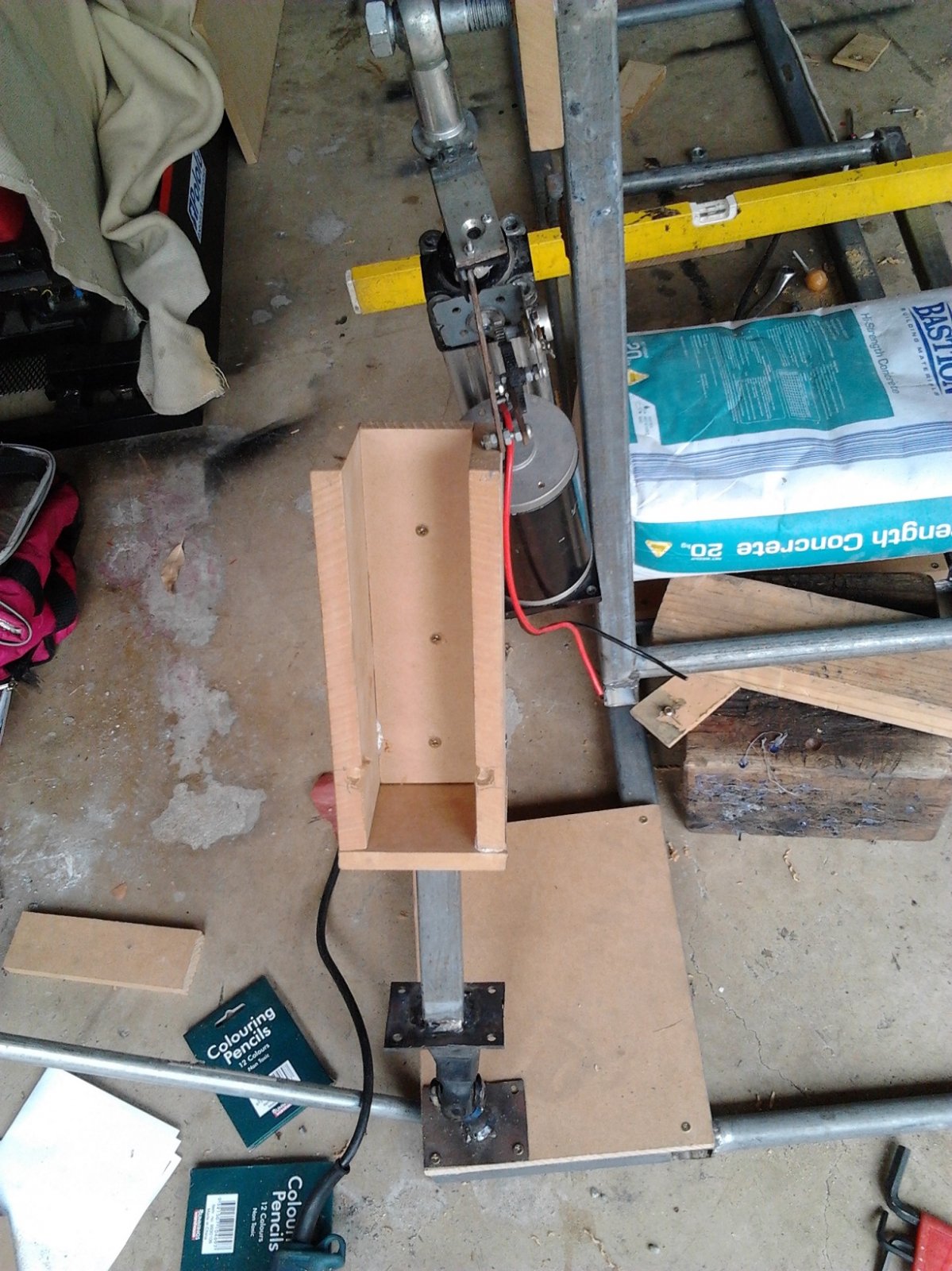

  17. bsft
    I used 16mm MDF sheet to make my actuator holders

    @bsft not sure if would feel comfortable with using MDF, but great solution.

  19. bsft
    sounds good. As said, its what I can afford with the prices charged around here I work with what I can. Good that you can get the metal cut up.
    The MDF works for me and works well.
