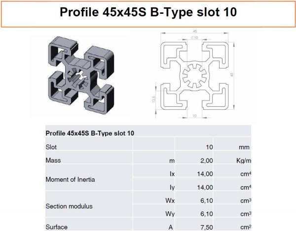

    I have a question about the center bar that moves the seat.
    Do you guys think that a single 80/20 45mm bar like in the picture below is strong enough for 2 SCN6 40Kfg acculators?
    I'm using the stronger type 80/20 with a thicker core
    :sos:sos
  3. Nick Moxley
    17,056Coins
    +2,506 / 30 / -2
    Im going to say Yes, Remember its not Moving your Entire Mass, Just a balanced portion of it.

    Thx Nick.
    Wil try it with one single bar first

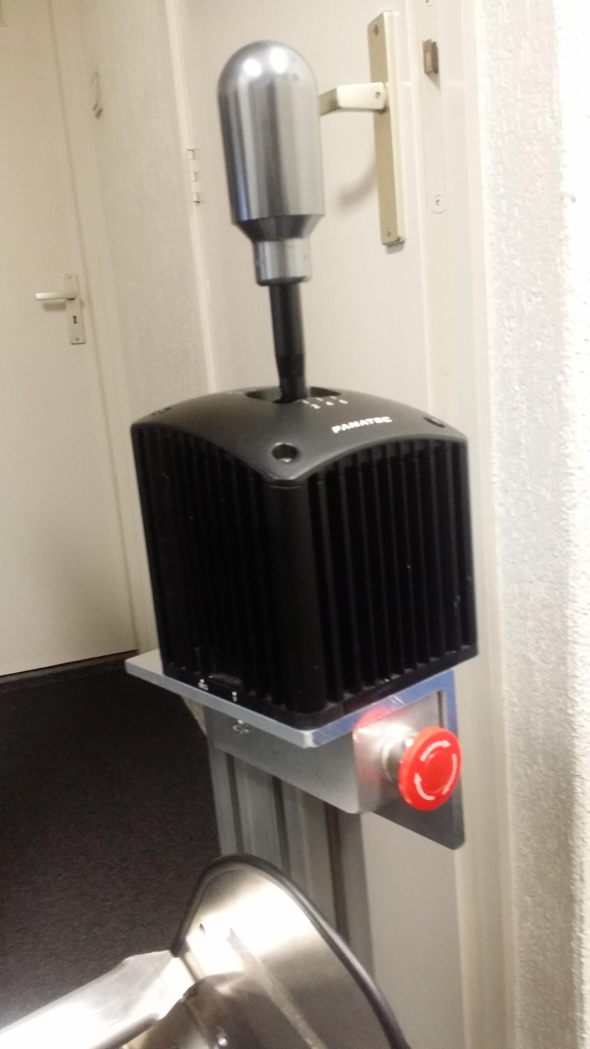

    Spend a lot of time today trying to figure out how to wire everything.
    The GS4 needs power and USB and also has 4 Buttkicker Mini LFE's and a Buttkicker Advance, which all need wires.:confused:
    I also found a place for the killswitch, under the shifter
