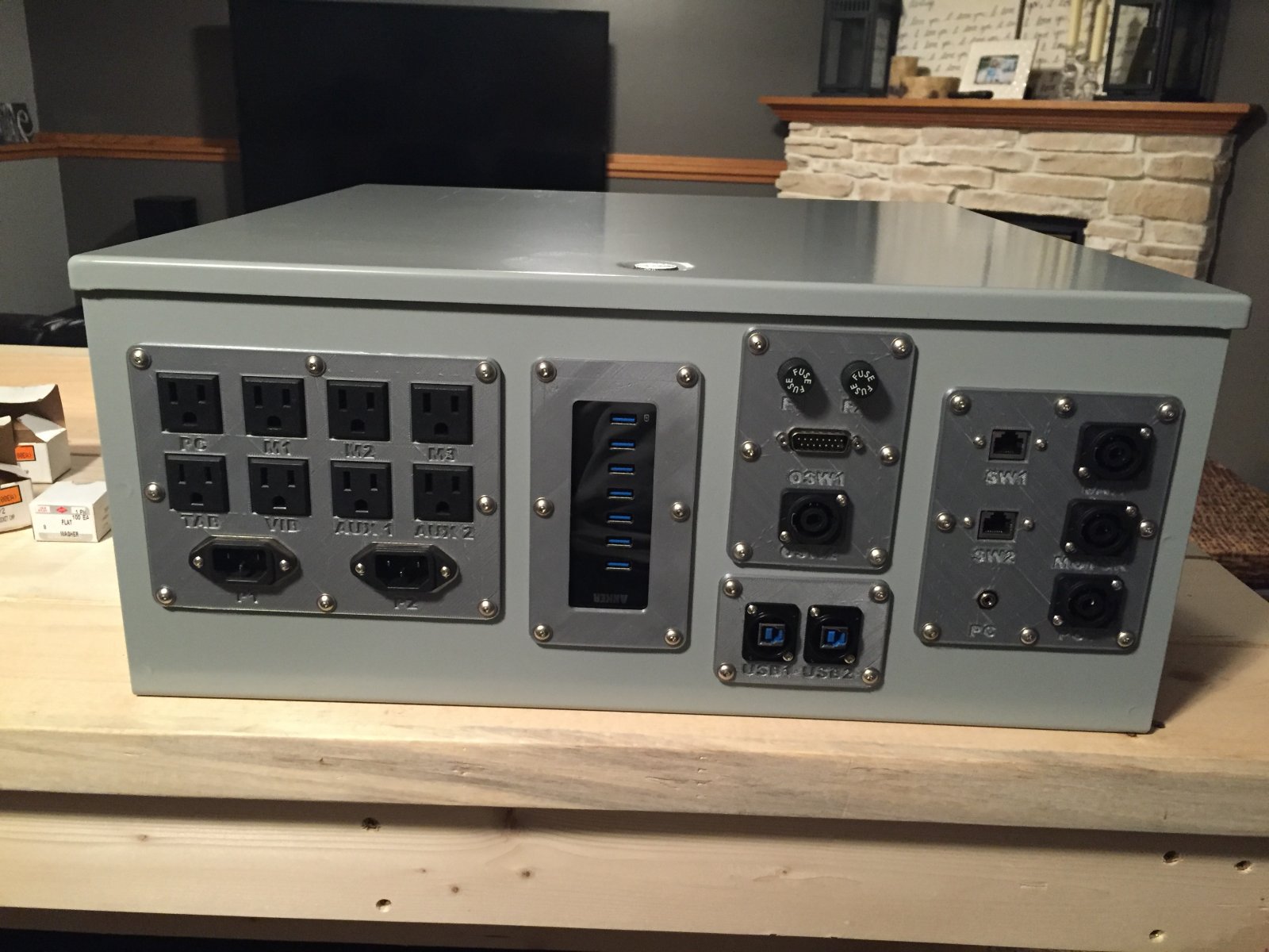

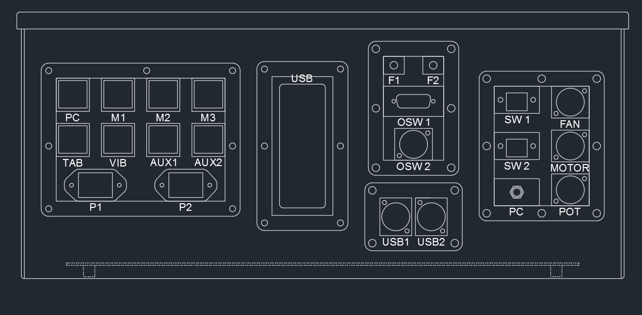

    Still way to busy with family, work and everything else to get much done. I did get some time to finish designing and printing my control box panels.
    I had shown this design in an earlier post, but I didn't have the correct dimensions for most of the parts. so after some test printing I was able to dial everything in to fit nice and snug.

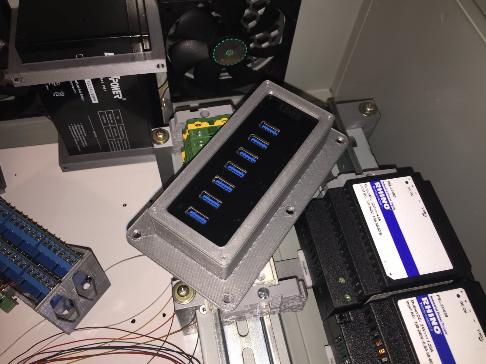

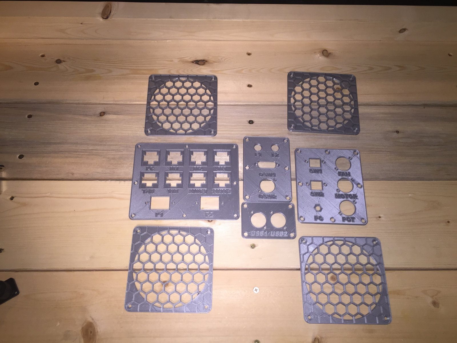

    Here are the printed parts. Not including the USB hub, that was shown in an earlier post. I added 4 120mm fan grilles, I will add 2 fans on each side of the control box. One of which will blow directly on the argon servo controller. I printed all parts in PLA using .3mm layer height and solid fill. I'm not going for looks here as all but the fan grills will be hidden when installed into my rig. I did add some labels to simplify connections later.

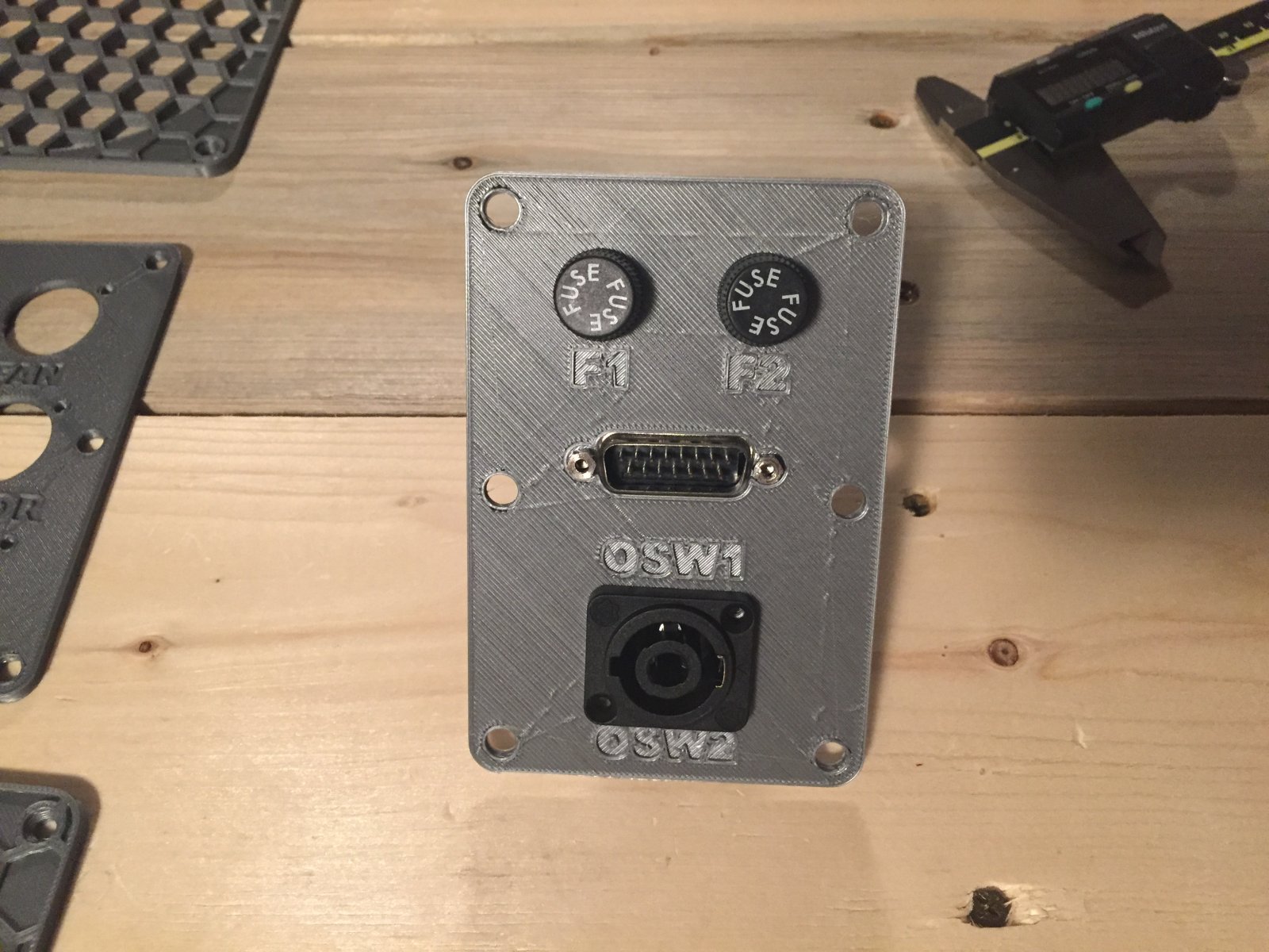

    Here is the mock-up of the OSW connection plate, (servo, encoder and fuses)

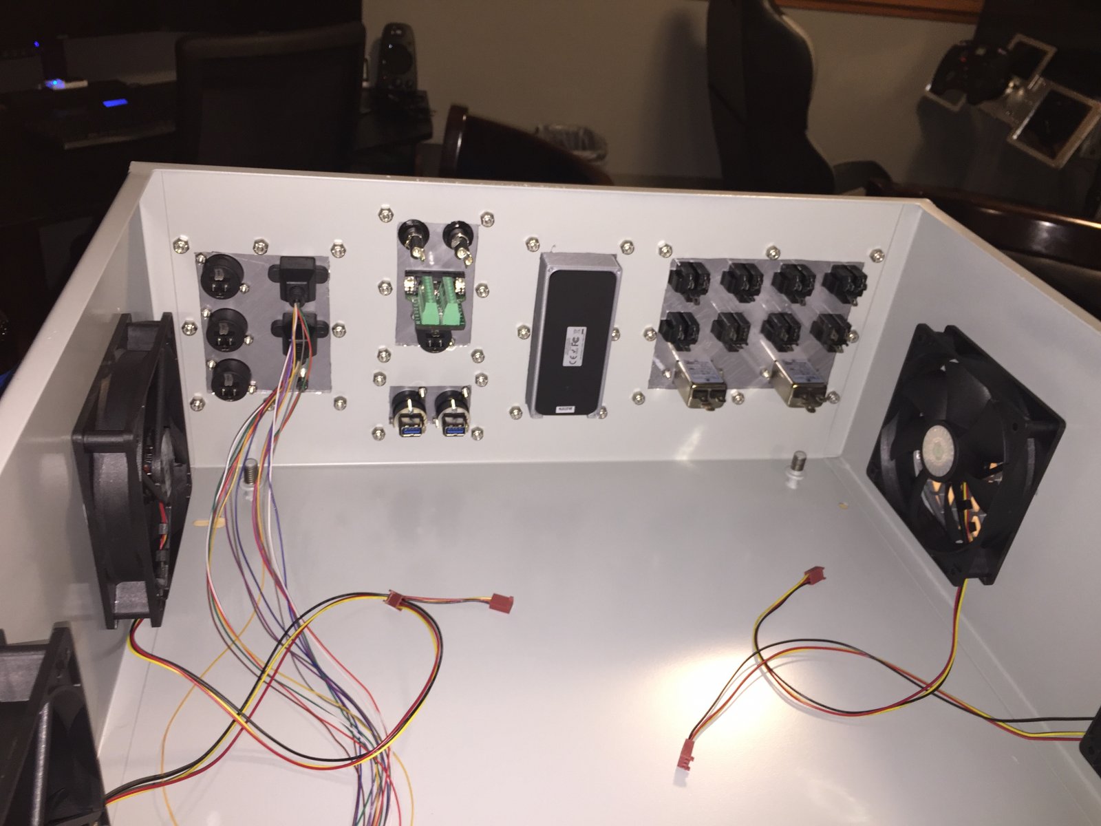

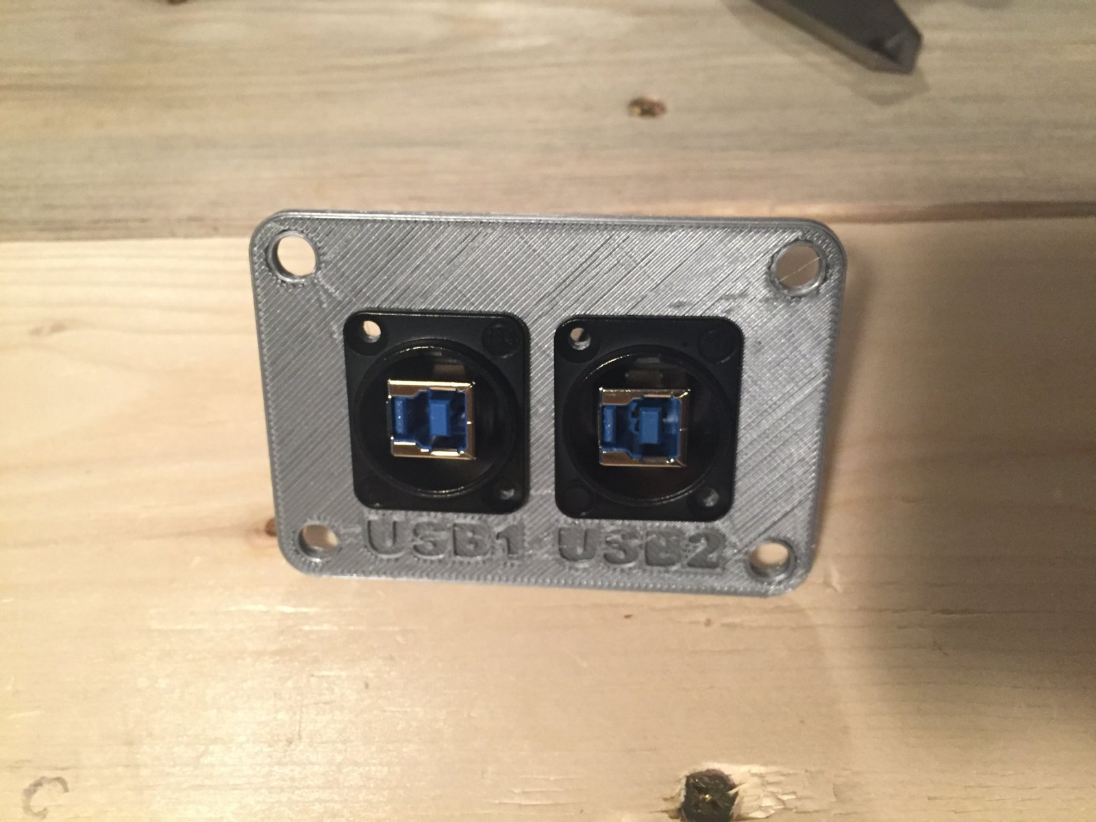

    The USB Plate (One connection for a hub inside the box and one mounted for outside access)

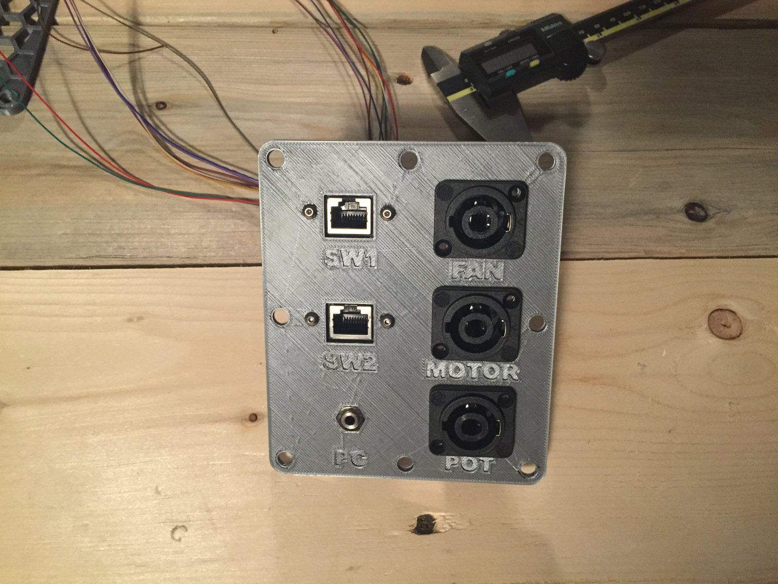

    The Motion Plate (PC power/feedback, Wind Generator, Chair Motion and my two Ethernet connections for the switch box)
    Each of the connectors on the right are audio twist lock with 4 poles.
    For the fan/wind generator I only need two poles, but since I will have two fans I will use all four poles.
    for the motion motors I will use all four contacts 1 pos and 1 neg per motor
    for the pot I will share a positive contact and share a negative contact and then have a dedicated feedback contact for each pot.
    The PC 3.5mm jack is a 4 pole jack as well. I will have a control and feedback loop from the pc to a micro-controller so the micro-controller can turn the pc on and off and then verify the status of the pc. This will let me flip the switch on and the micro controller will simulate a power button press. If I just connected my switch to the pc power button I would need to change the switch to a momentary switch. I actually designed a small relay board for inside the pc, when I get to that step I will go through it in more detail.

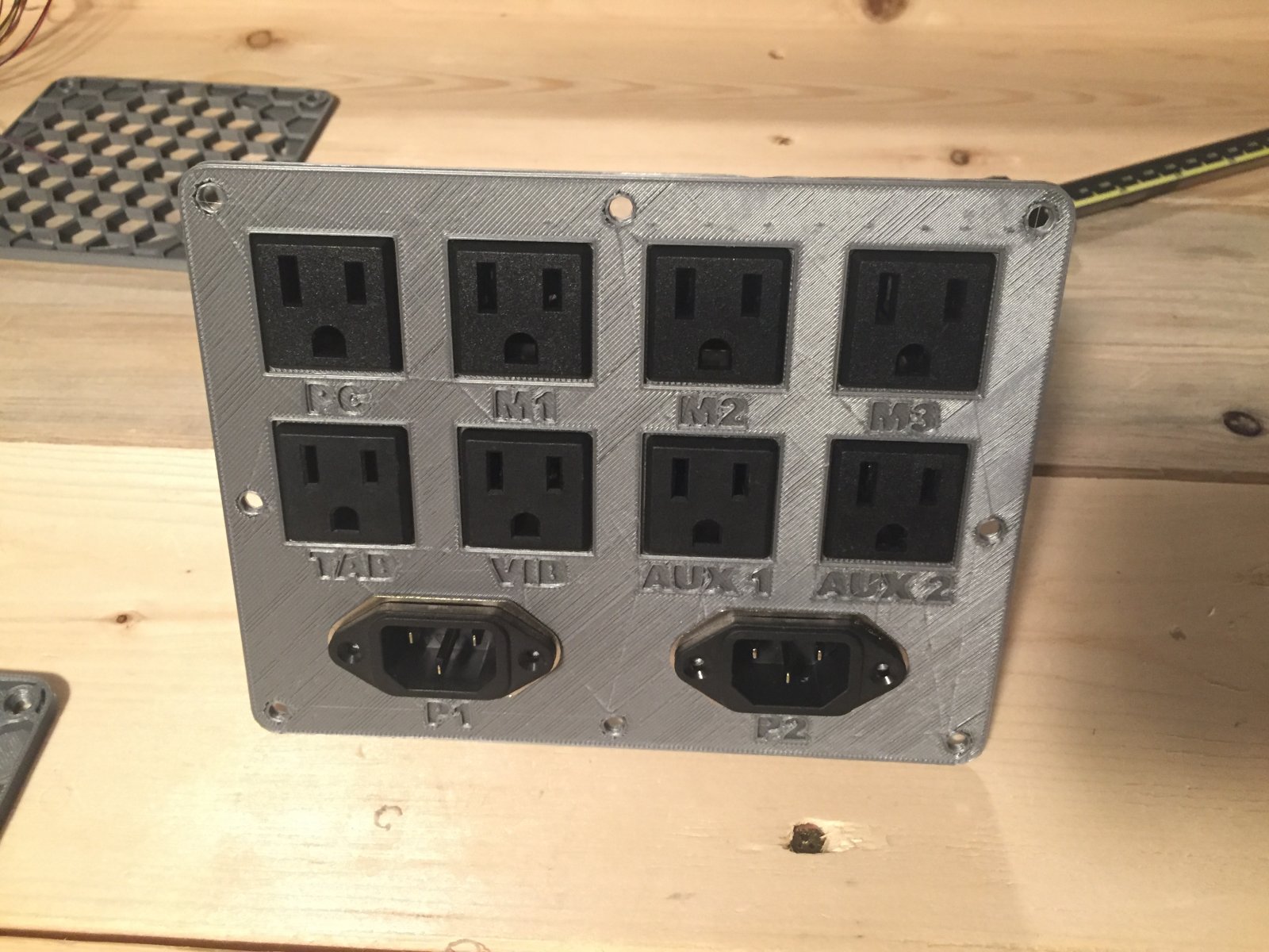

    The Power Distribution plate. 8 Power outputs and two power inputs. the majority of the outputs are controlled by the switch box.
    PC - always on
    M1-M3 - Switched by panel, controls each of the three monitors
    Tab - Switched by panel, turns power onto the three dashboard tablets.
    Vibe - Switched by panel, turns power on to transducer amplifier
    Aux 1 & 2 - Switched by panel, Future expansion points.

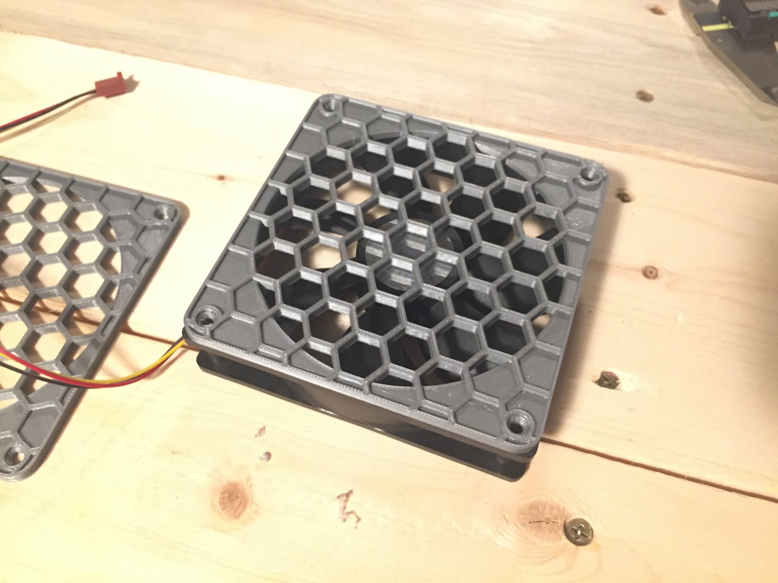

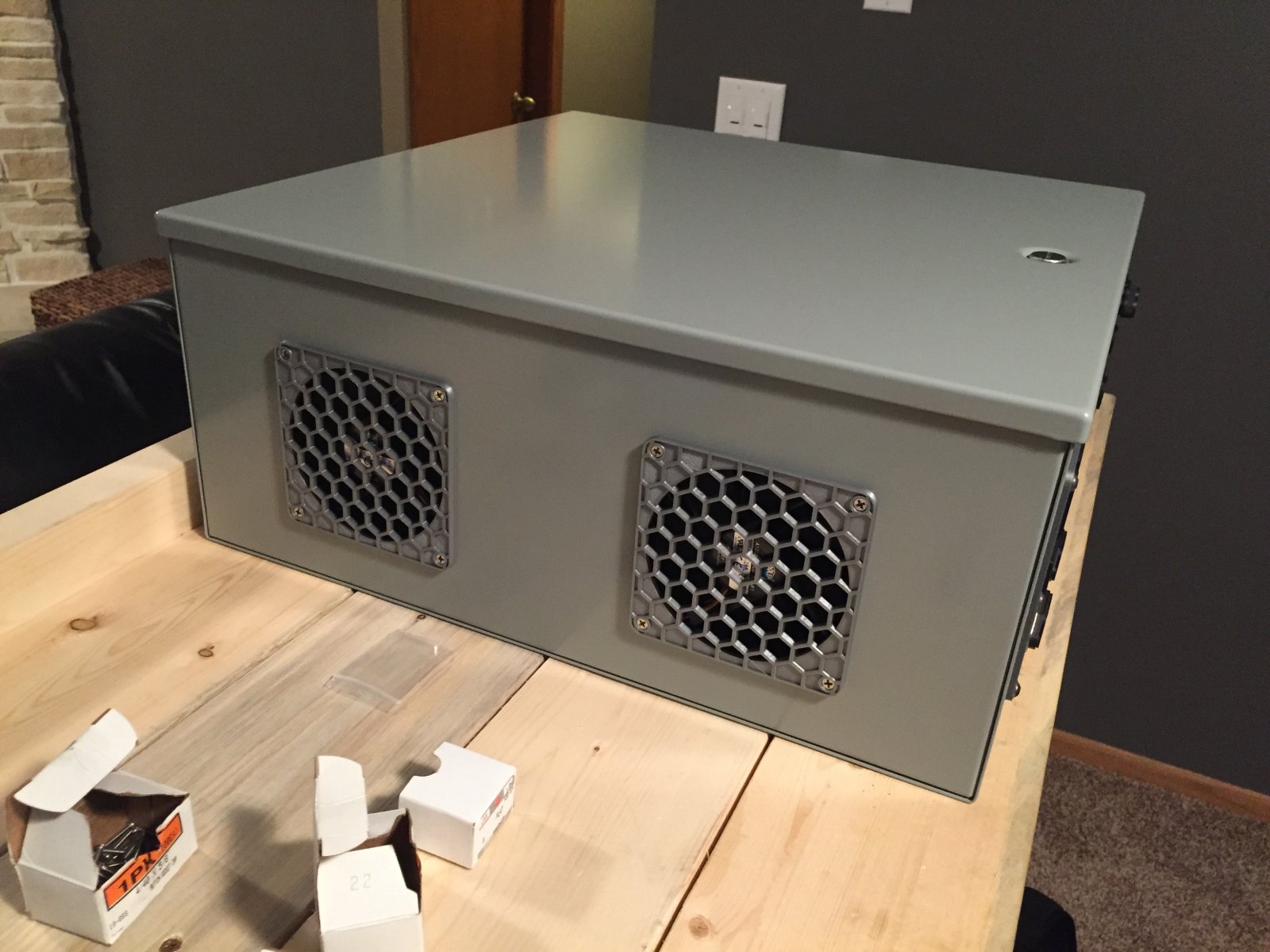

    The fan grill from thingiverse. http://www.thingiverse.com/thing:298648. I'm using cheap coolermaster fans off amazon that come in a 4 pack.
    I need to find some time to start cutting the box to fit the panels, but in the near term I'm still figuring out how to fit everything inside. I am going to be 3d printing a ton of custom mounts and stacking things to save on space. Ive got a really cool solution for the bulky server power supplies that I will share soon.

    OK, so I have been burning the candle at both ends tonight and I was committed to getting my control box cutout and all of my printed panels mounted.

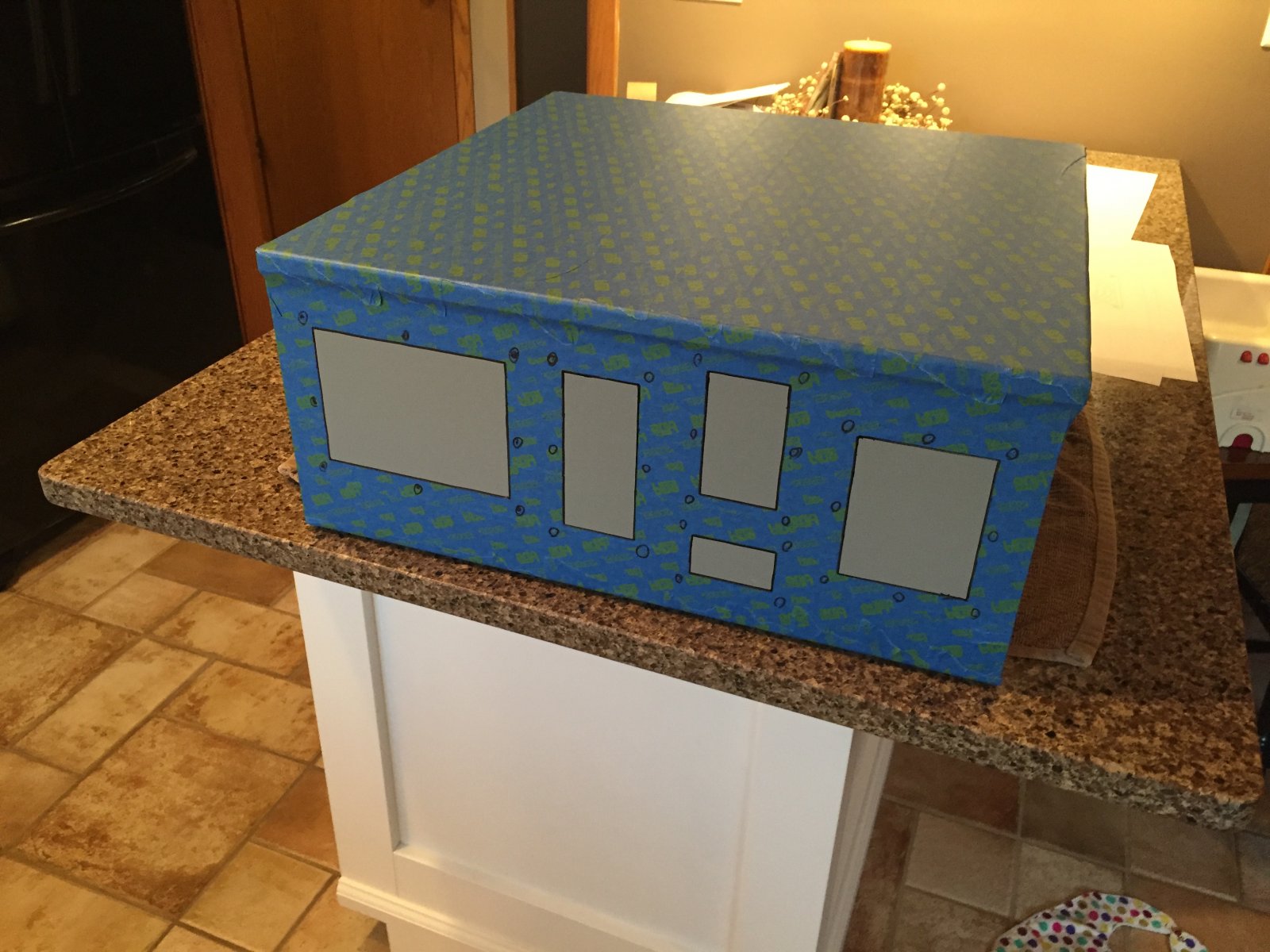

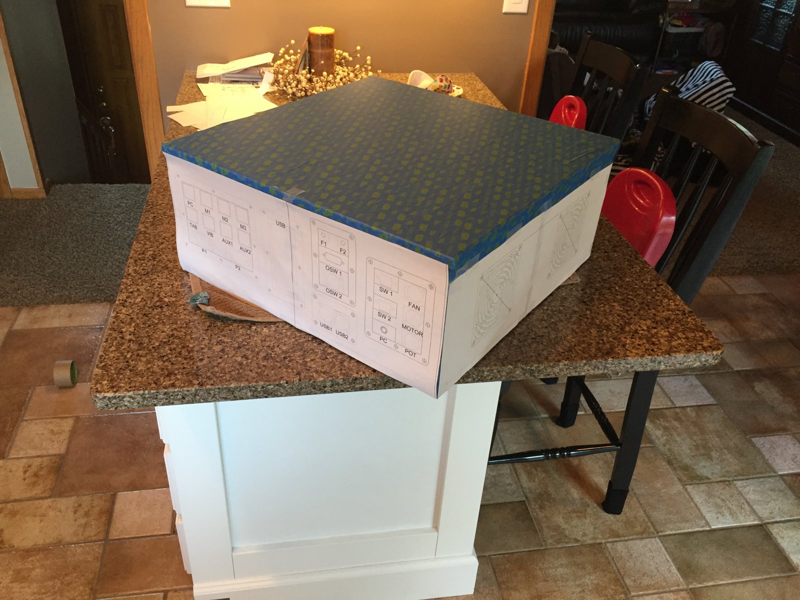

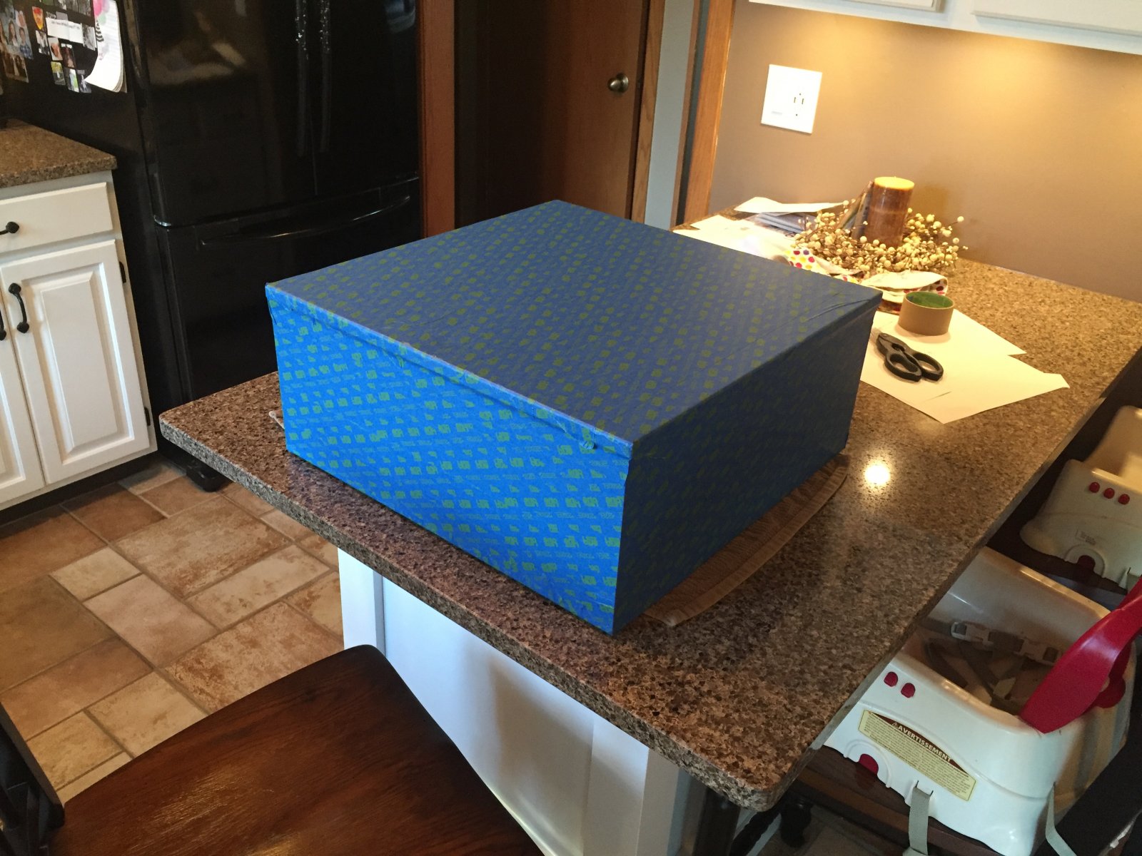

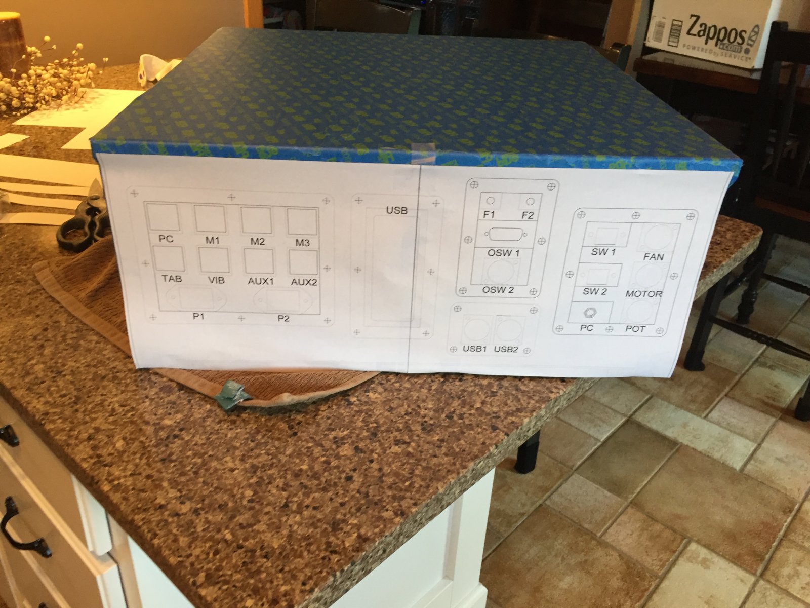

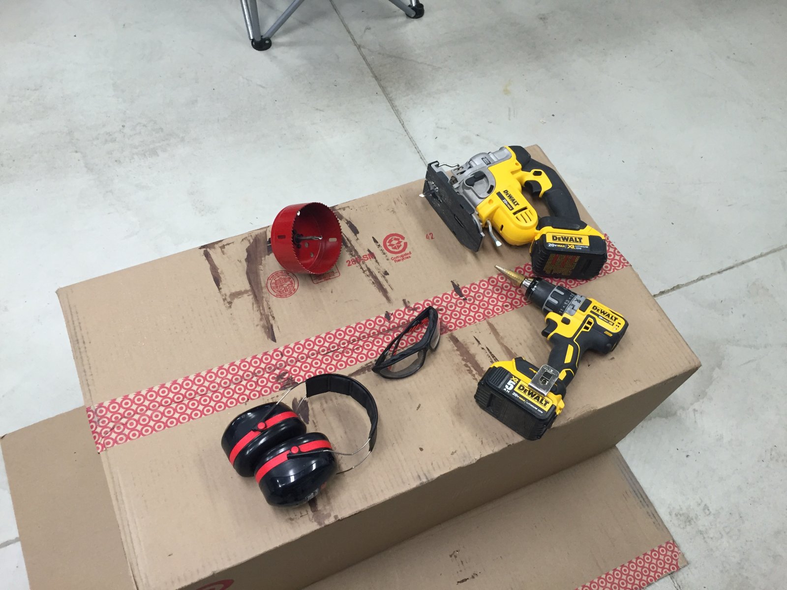

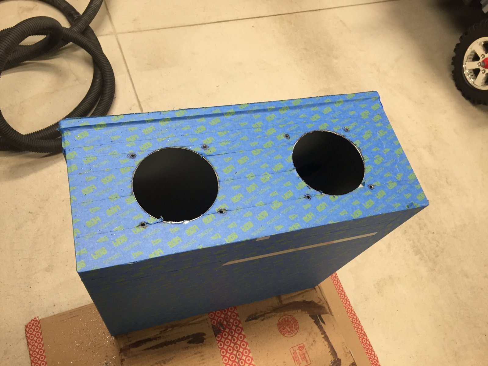

    I have built a number of control boxes for work and I will share my method for cutting out control boxes without destroying everything.
    First thing I do is completely tape the entire box using blue painters tape. This will help prevent scratches during all of the cutting and re-positioning. It seems like a lot of wasted tape, but if it prevents that one scratch it is worth it.

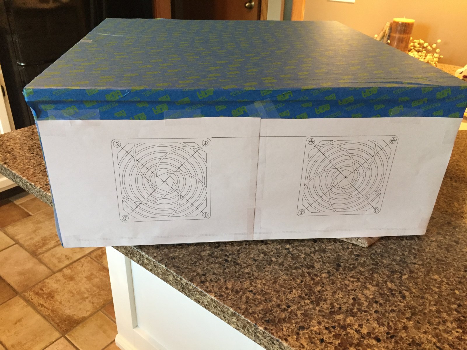

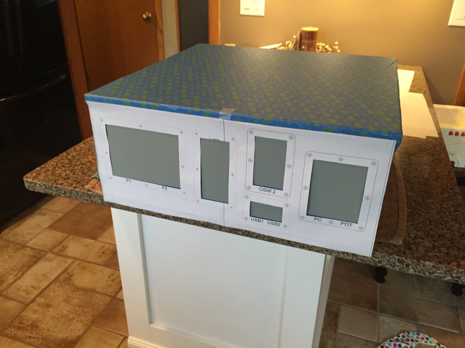

    Next I print out and mount 1:1 templates of my holes and cut-outs. I always design my control boxes in auto-cad and if needed I print the templates on multiple sheets. These templates were printed on two pieces of 11x17 paper and taped together. I bought this box from mcmaster carr, which is handy because they have 2d and 3d cad files available to download.

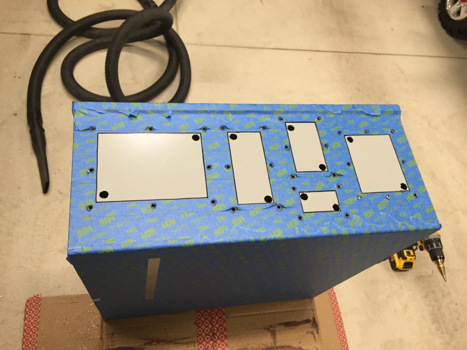

    Next I use a spring loaded center punch to mark every hole, usually I strike each hole 2-3 times to be sure I have a good mark. Then for my cutout portions I use a razor blade to cut the paper template and blue masking tape away. I do this because in my experience the paper template doesn't survive and without transferring the locations its easy to lose the location of the cuts.
    Next I remove the paper template and discard it. I then trace the cutout locations with a black sharpy ensuring that I have marker on the blue tape and the painted box. This is another safety in case the tape is removed during the drilling or cutting operation. I also circle all of my drill locations to ensure that I don't miss any, the marks can be hard to see through the tape.
    Now the box is ready to start cutting, so here are the tools that I use for my boxes.
    Cordless drill, cordless jig saw with a good metal cutting blade, hole saw for the large fan holes, good eye protection and good hearing protection. Not show is a shop vac and a Dremel or rotary tool.
    notice on the drill I have a good quality step or indexing bit. These are awesome for drilling holes in sheet, typically its very difficult to make a nice close tolerance hole in sheet steel with a regular drill bit. The step bit allows the hole to be gradually increased until you reach the final size and it doesn't get all oblong like a regular drill bit.

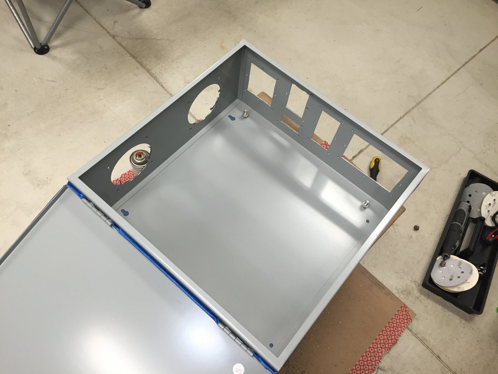

    I started with the sides of the box, drilling the fan mounting holes first followed by the large 4.5" holes for the fans. Drilling a large hole with a hole saw can be a challenge. I have had the most success by drilling a pilot hole with the step-bit that is the same size as the hole saw guide drill bit, then when I drill with the hole saw I tilt the saw a few degrees off axis and rotate it around the center axis of the hole. This seems to give me the best results without using a drill press. Also, I try not to use cutting fluid on my boxes because the cutting fluid causes the masking tape to fall off and exposes the box to scratches. I just go slow with the drill bit and check it often for overheating.
    I am doing all of my work on top of a cardboard box and I am very careful not to slide the control box around while cutting. Chips will be flying everywhere and the more movement the more opportunity for scratches. I also vacuum the control box frequently and the work surface prior to rotating the box.
    Next I switch to the front of the box and drill all of the mounting holes and then two holes in each cutout to fit my jigsaw blade into. this was a long process, but its better to go slow and check the drill bit for heat then going fast and destroying the bit in the middle of a project. I don't usually put much effort in getting my jigsaw blade holes perfectly in the corners, its easier to cut in with the jig saw then fix a hole drilled outside of the lines.
    I do all of my mounting holes before my cutouts because the structure can change significantly after the cut-outs are made. I have made the mistake of drill holes last and actually bent the box because I was putting too much pressure in areas that were weakened by cutouts.

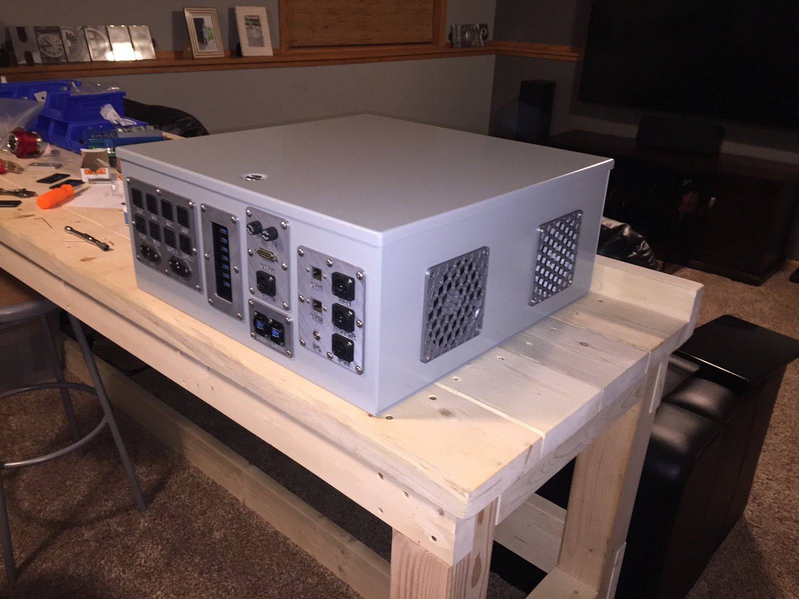

    Next I cut everything out with the jigsaw. I start from each hole and go both directions, this will remove most of the material and then I go back and clean up the corners where the starter holes were located. Eye protection is a must here, tiny shards of very hot metal will be flying all over the place and you can't replace eyes. I prefer the jigsaw vs a cutting wheel because I feel that cutting wheels are harder to control and much easier to accidentally make dummy marks with.
    The last thing I do before pulling the tape off is clean up all of the edges. This can be done with a hand file, but I like to use my Dremel with a sanding drum to carefully hit all of the edges in the inside and outside of the control box. A word of caution, this is where I typically make a dummy mark because I'm so close to being done I stop concentrating. Also, all of the drilled holes will have nasty metal burrs on the inside of the control box. I just use the same step-bit and drill the holes again from the inside. The step on the step bit acts as a chamfer and deburr's the holes nicely. A good cleaning with the shop vac and the box is almost done.
    Finally I pull the tape of carefully and ensure that while rotating the control box I am setting it on a nice clean surface. Also, its a good idea to do test fits prior to removing any protective tape. One last cleaning with the shop vac and its ready for assembly.
    That's how I do all of my control boxes. There are plenty of other ways, but this is what works best for me after doing it a handful of times.
    Here is the final result.
    2017-05-02 23.32.07.jpg 2017-05-02 23.32.25.jpg 2017-05-02 23.32.33.jpg 2017-05-02 23.32.50.jpg

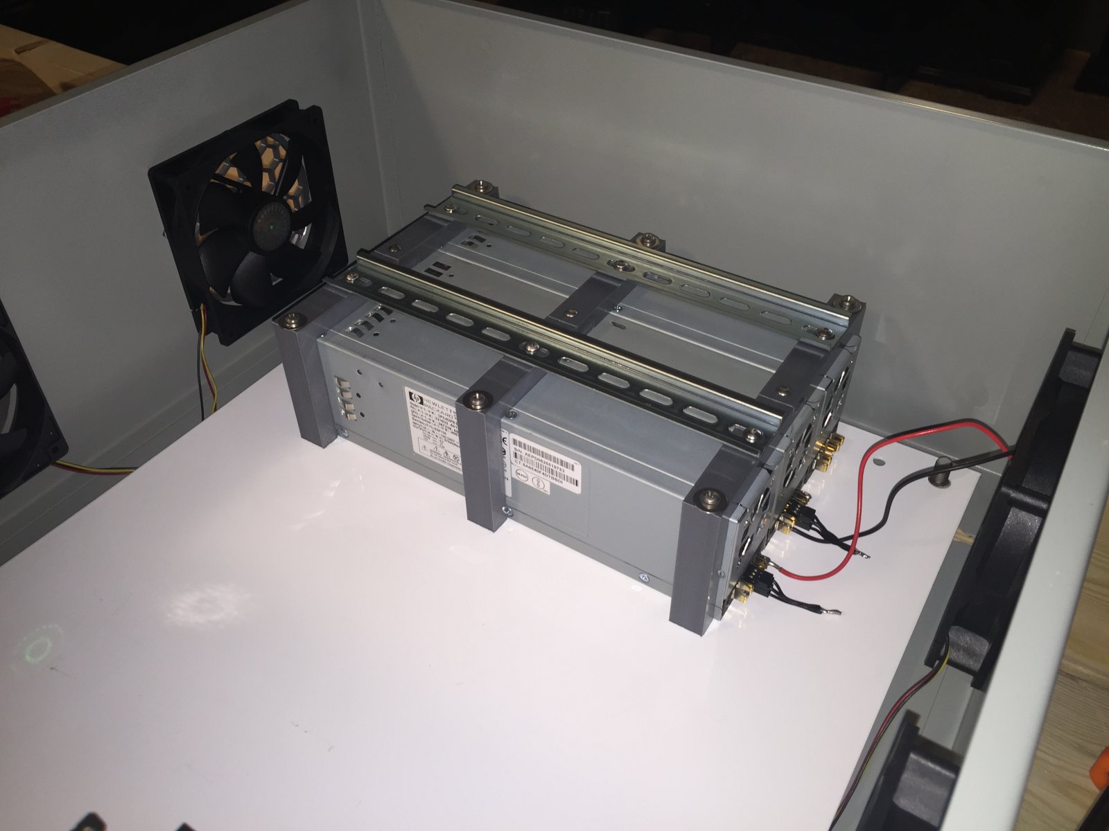

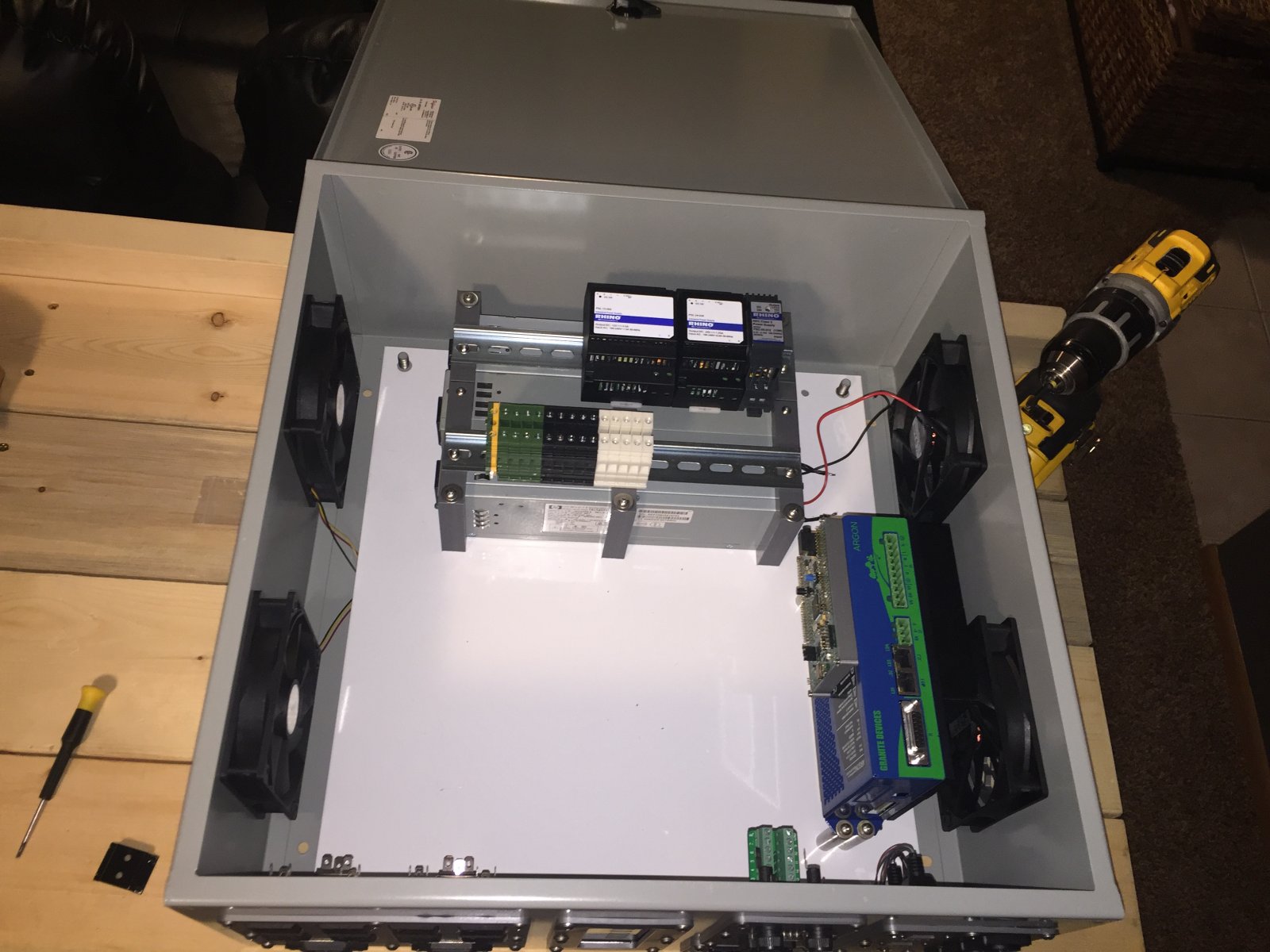

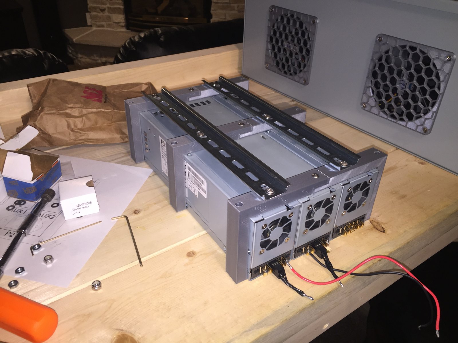

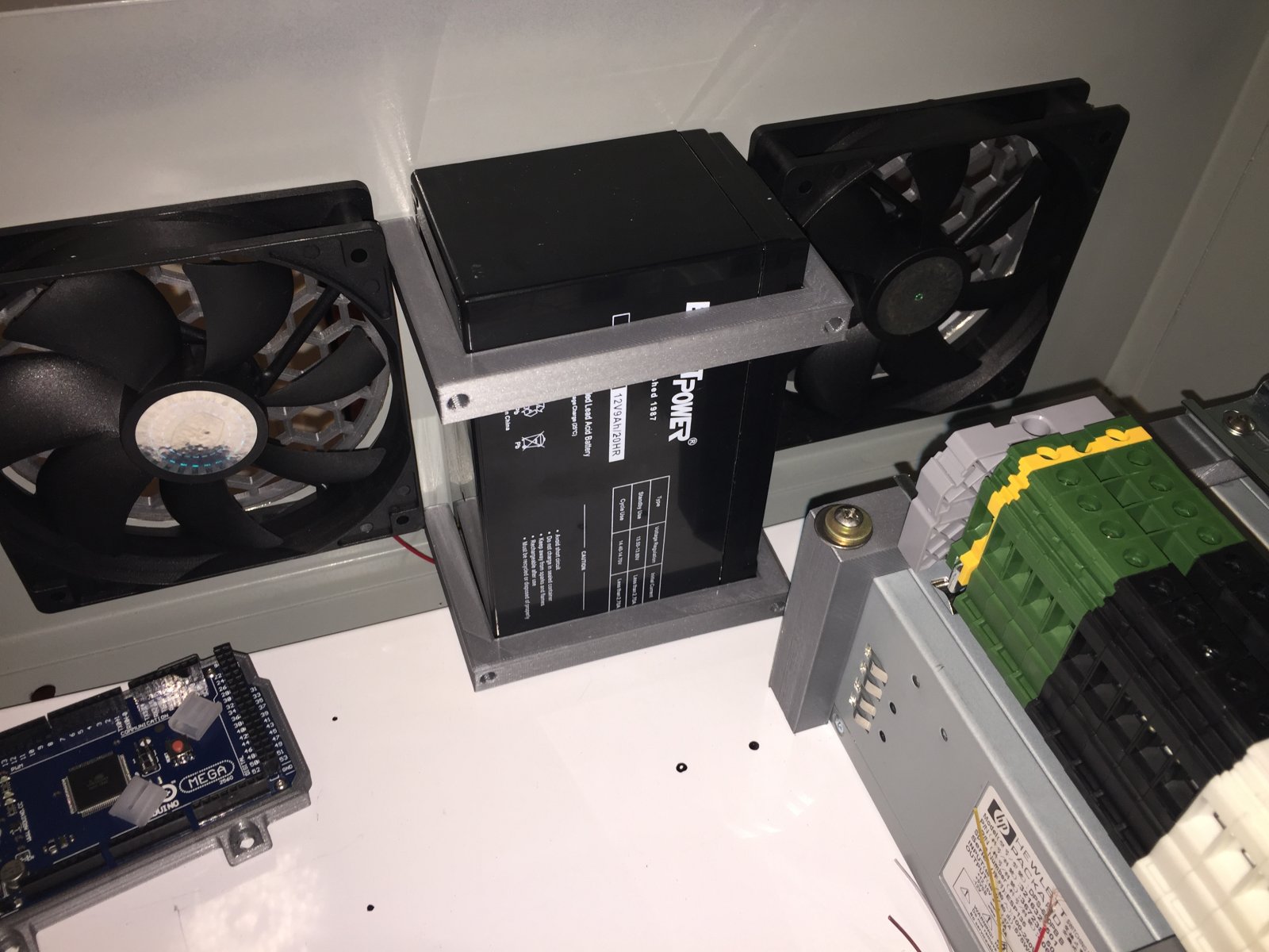

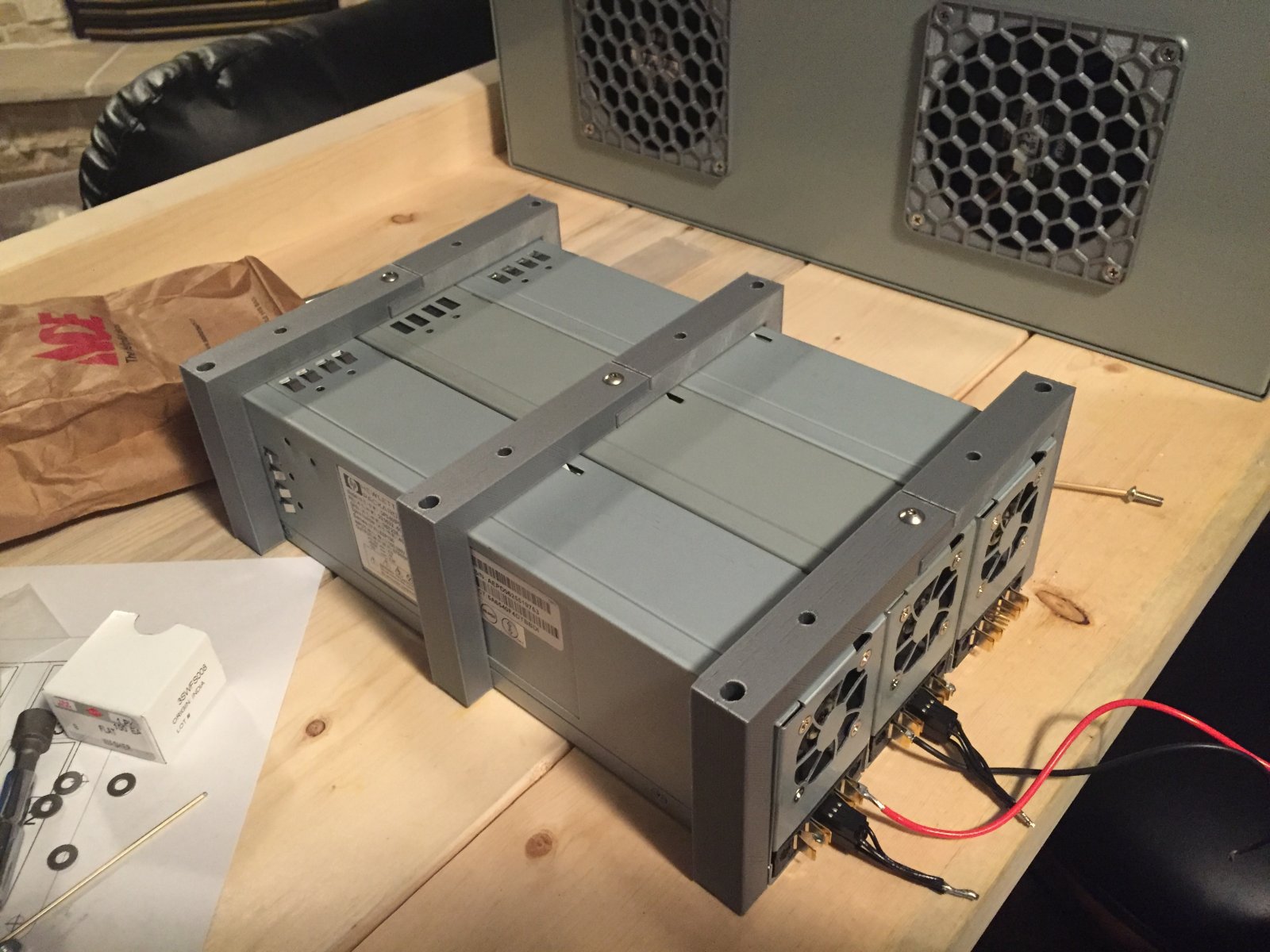

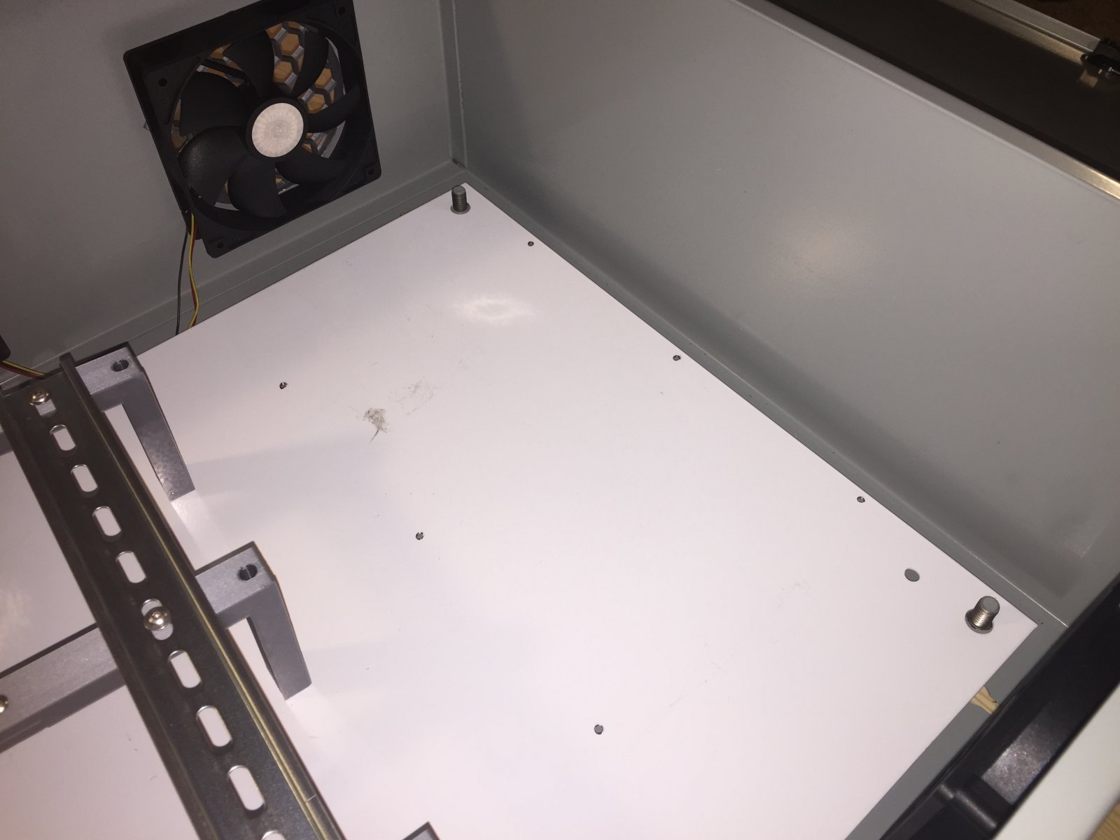

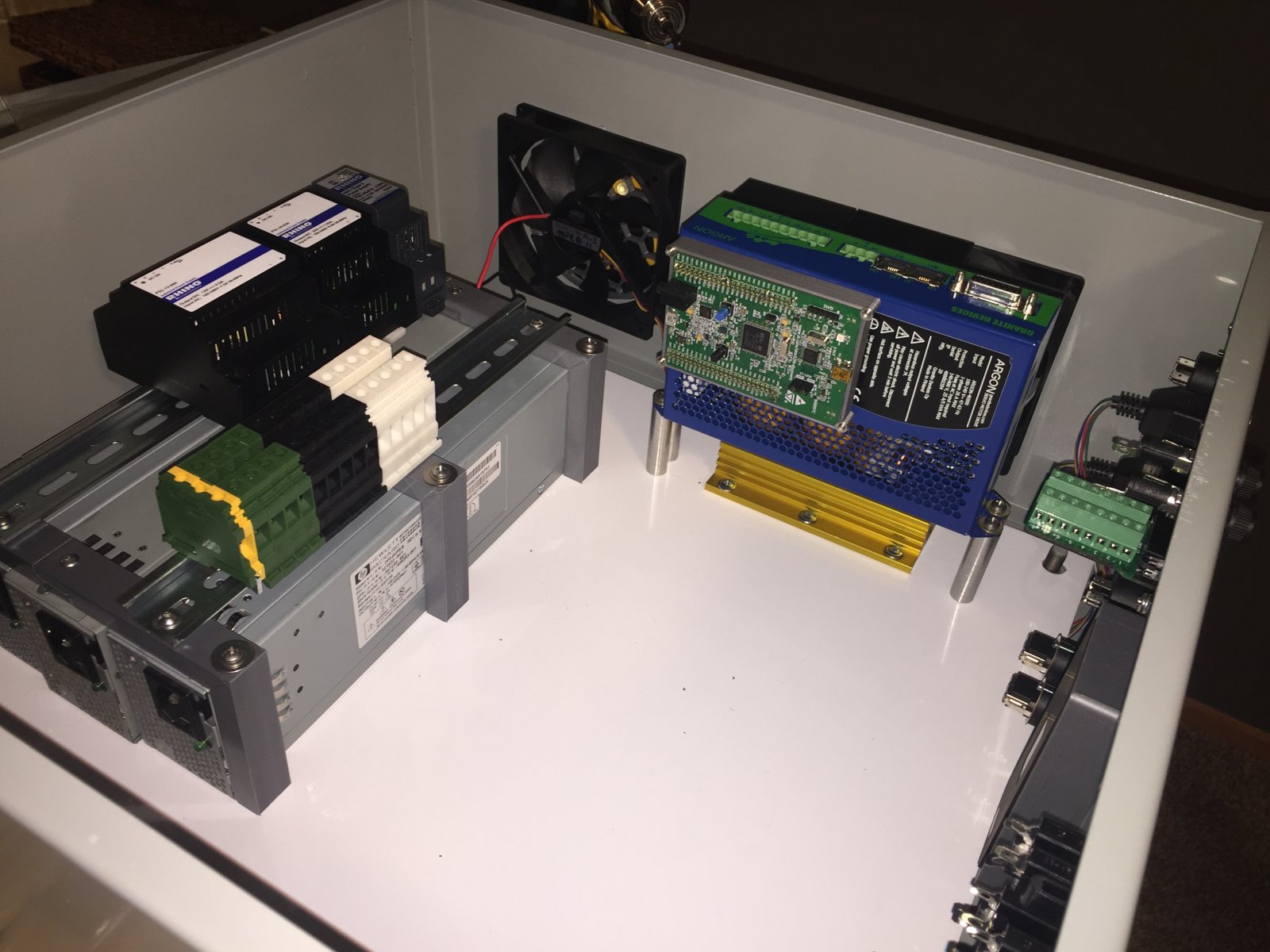

    So I have a lot to fit in the control box and space is definitely at a premium so I have to get creative with all of my parts.
    I have 3 server power supplies, 1 for each motion motor and 1 for the wind generator fans. I also need to add a couple of additional power supplies (5v for arduino stuff, 12v for everything else, 24v for the argon servo driver) and a bunch of terminal blocks.

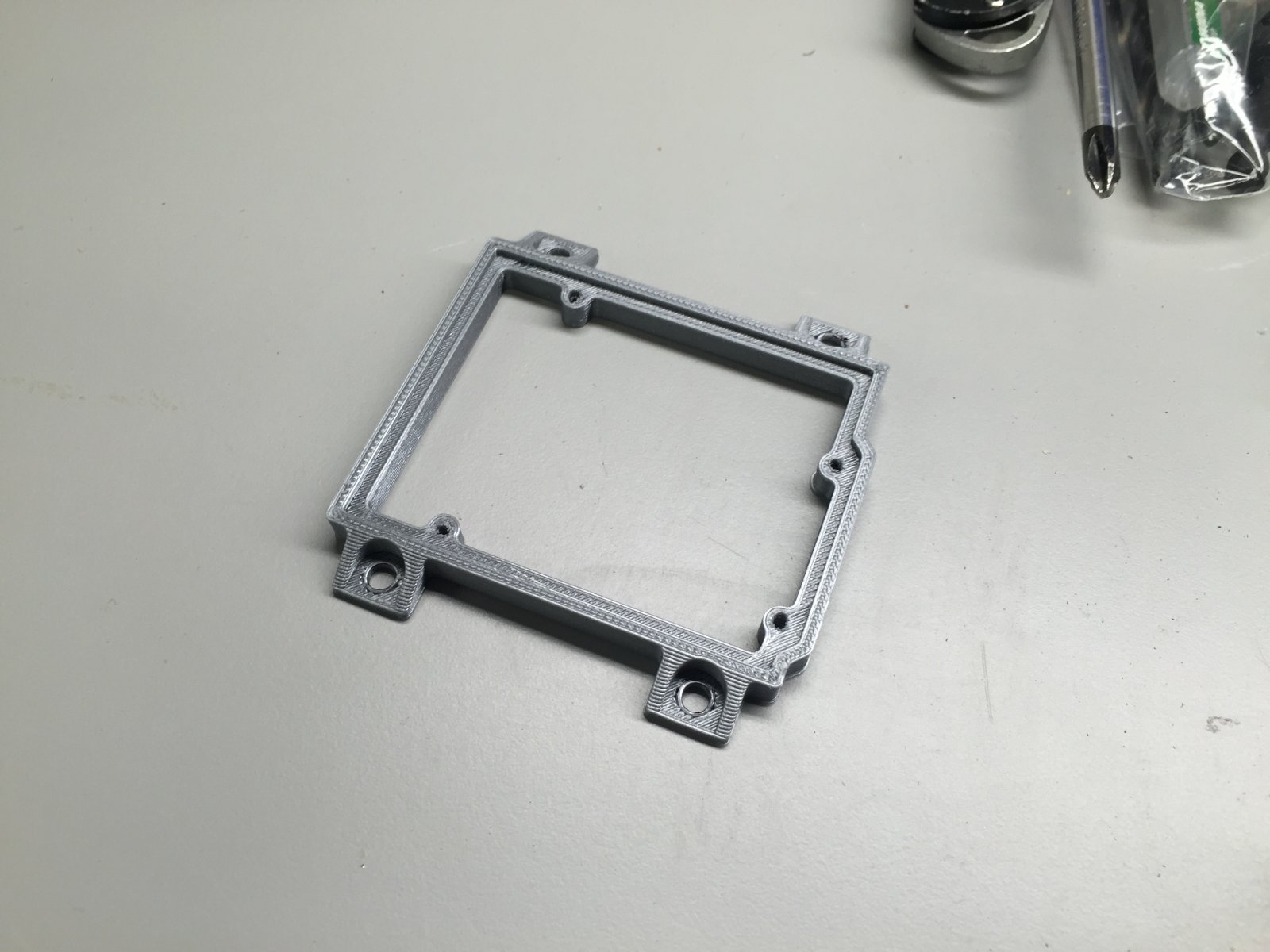

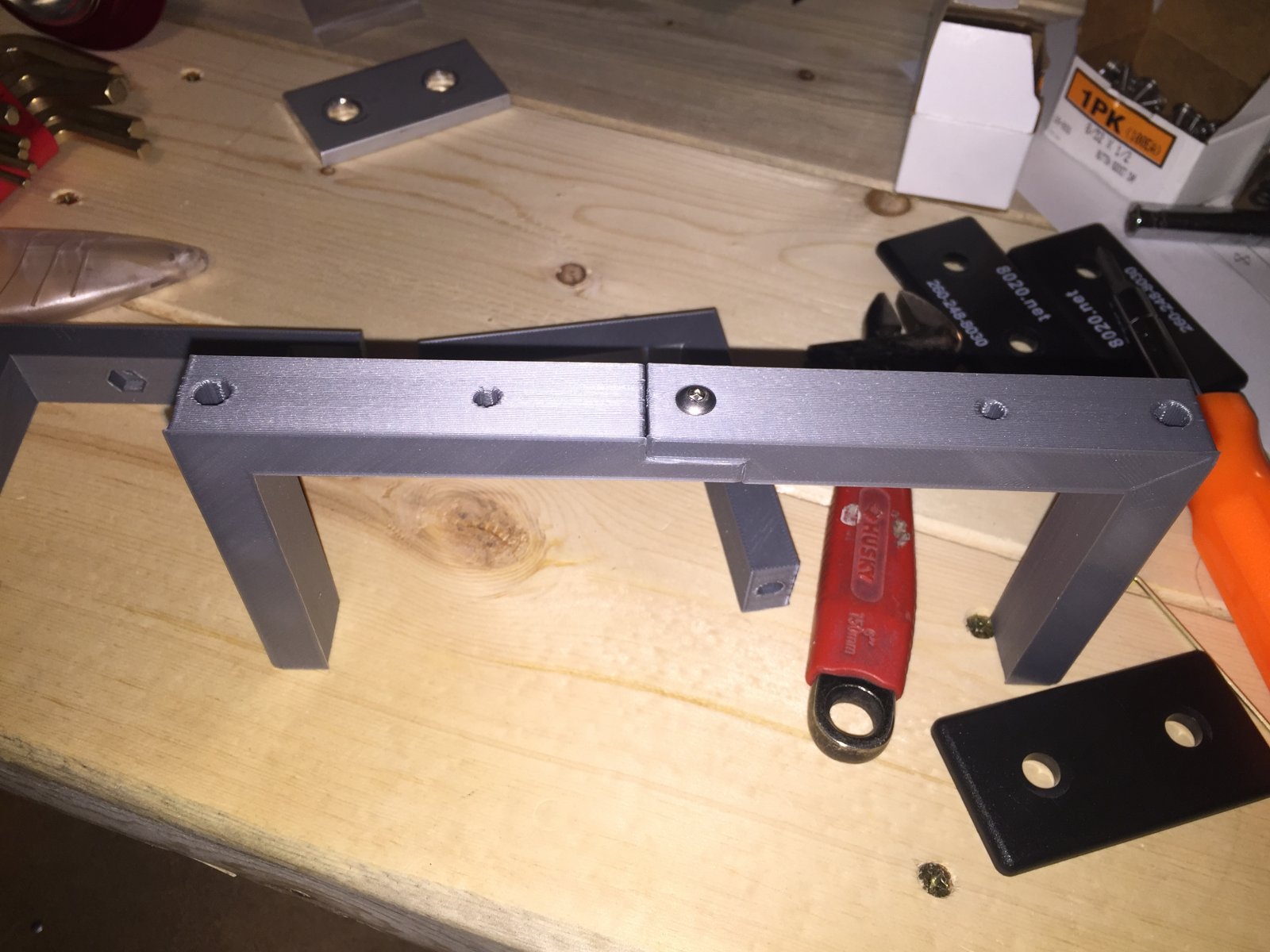

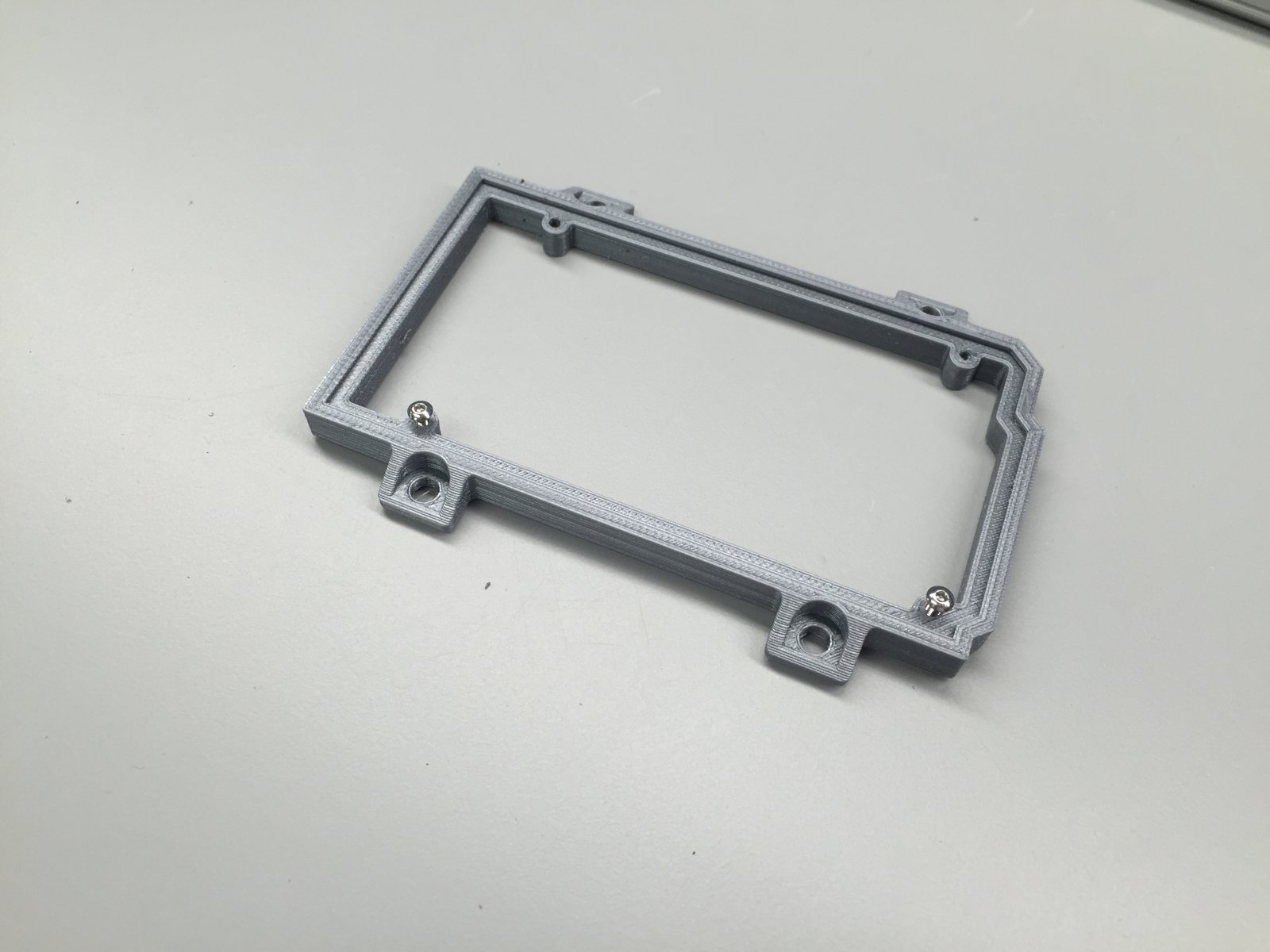

    The first thing I did was design a couple of mounting brackets for the 3 power supplies, I had to print them in two parts because if the size. I also added a few mounting holes for din rail to mount my other power supplies and terminal blocks.

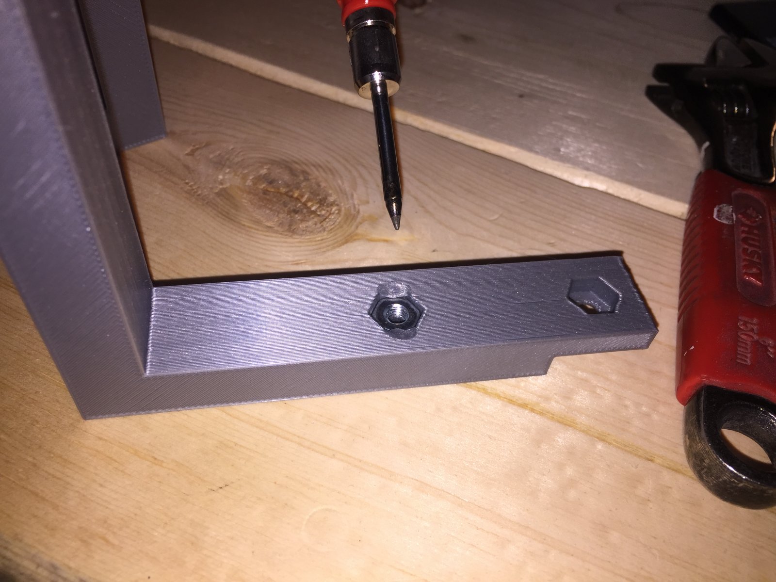

    The assembly is joined with an 8-32 screw and recessed hex nut. As a side note I use a cordless soldering iron to rework and fix 3d printed parts, in this case I used it to melt the print and secure the hex nuts.
    Here is the iron I am using, I don't remember when or where I picked it up but it works great for manipulating 3d printed parts.
    Here is an assembled mounting bracket, I ended up printing 3 sets total.
    Then I did a quick test fit with the three power supplies, all looked good.
    Next I added the din rail with a couple more 8-32 screws.
    I then did a test fit inside the control box and marked out the location of each mounting hole on the control box panel. I drilled and tapped the six 8-23 holes mounting holes.
    And mounted inside the control box with the power supplies. The two outside power supplies are locked down, but the middle one can still move a little. I will probably throw some double sided tape between the power supplies to keep the middle one from sliding around.

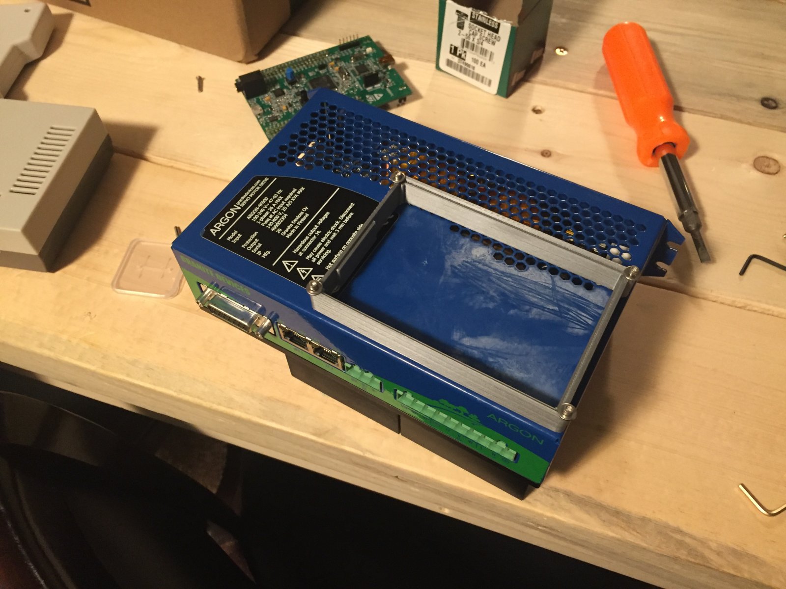

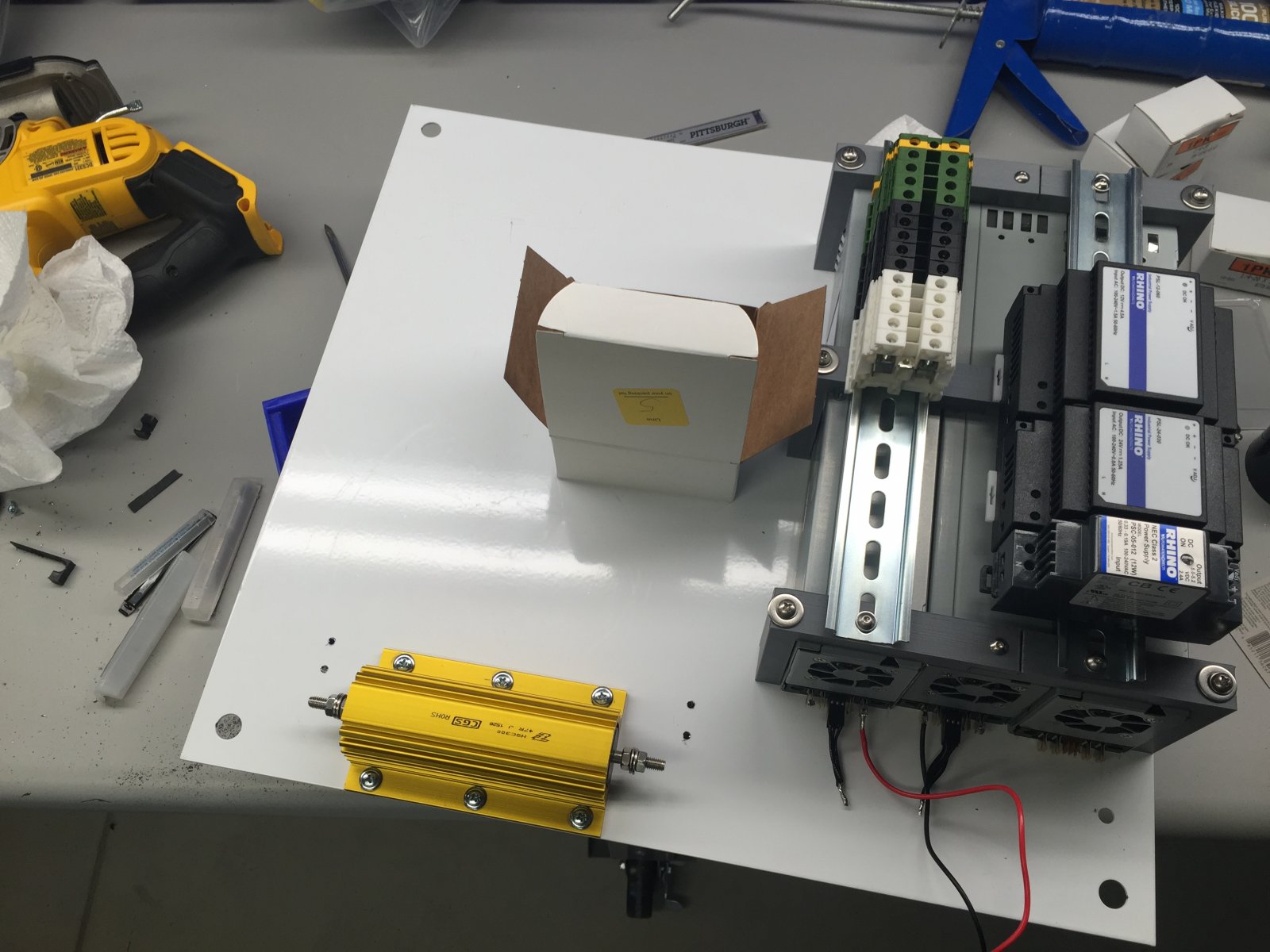

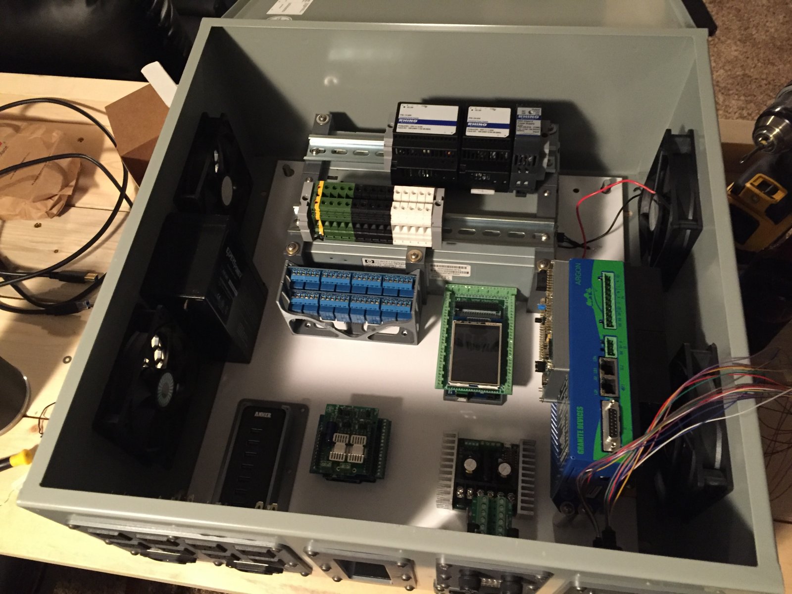

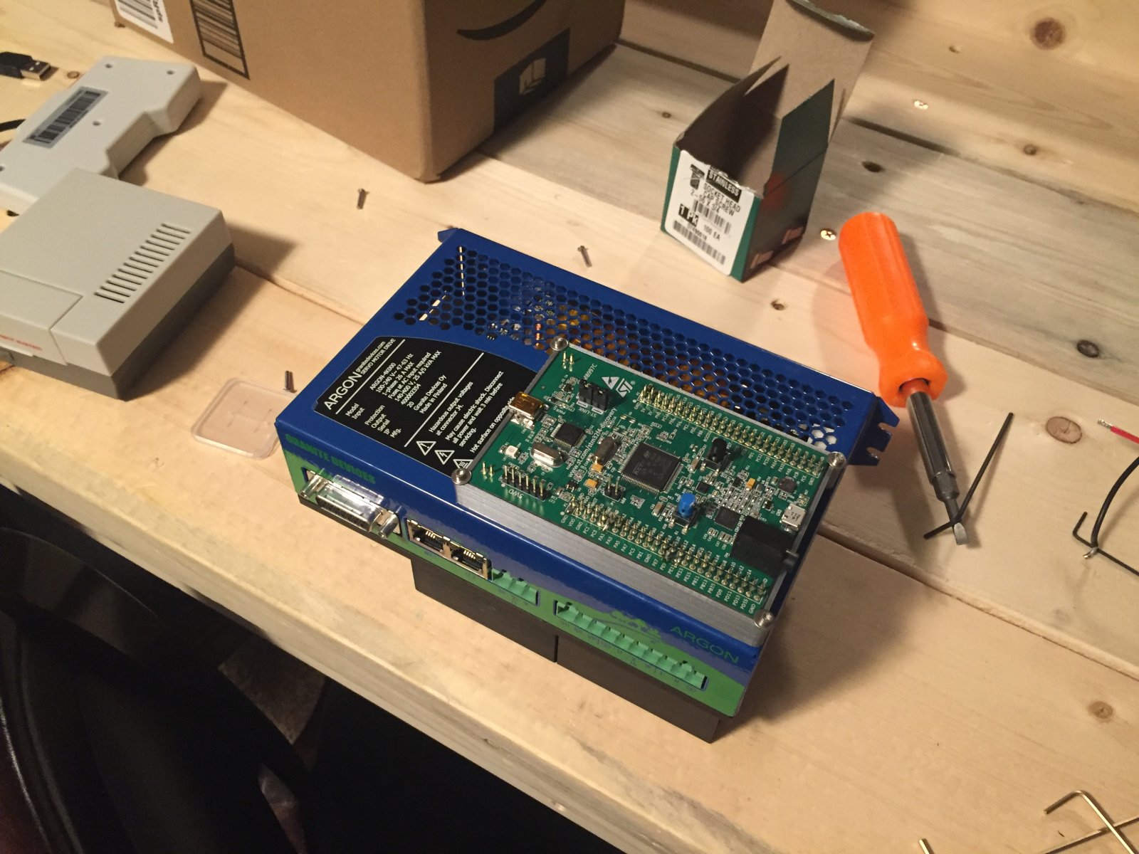

    I also worked on mounting the OSW servo driver, I'm using the argon servo drive so I first printed a mounting bracket for the discovery board and mounted it to the argon case.
    Then I mounted the discovery board.
    Next I marked out the location for the large servo resistor and mounted it with self tapping screws. I also marked out the location of the argon drive mounting points and tapped additional 8-32 holes.
  15. Hoddem
    Hoddem Well-Known Member
    Sep 27, 2016
    404
    Engineer
    Minnesota, USA
    3,343Coins
    +717 / 2 / -0
    Continued....
    I put a couple of 2" spacers under the argon drive and raised it up enough to clear the resistor.

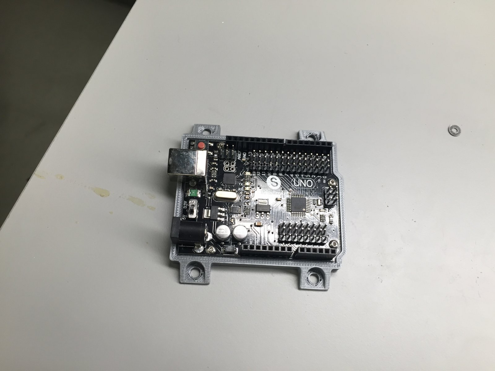

    Here is the control box as it sits right now, I still have to fit the Sabertooth/Arduino for the motion, the MonsterMoto/Arduino for the Wind Generator and the battery and relay bank for all the switches.

    Well, the house deal fell through. The owner decided to keep it so it was out of my control. bad news for a 6DOF, good news for the build.
    I was playing around with locating the remaining components in the box and this is what I came up with.

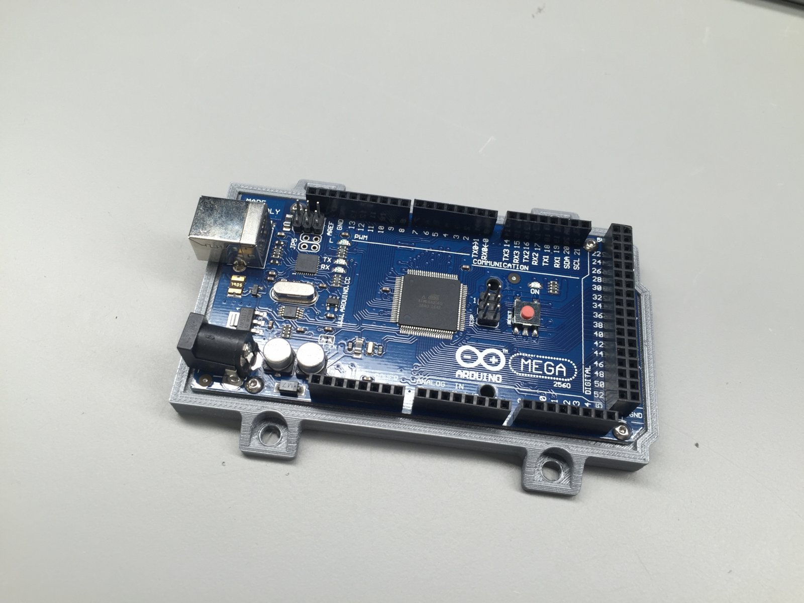

    I was going to start mounting everything, but I realized I need to print a bunch more parts.
    I found some arduino mounts on thingiverse, they worked perfectly.
    This is the Arduino Mega mount for the seat motion.
    I was lucky enough to find some 2-56 screws in my stuff along with a tap.
    this is the Uno Mount for the wind generator.
    I also needed to print up a couple of mounts for the battery and a lid for the USB holder.
    That's about all the further I got, I am hoping in my next post I will have everything mounted and ready to be wired.

    That's one professional looking panel. I'm guessing you must have a panel building background? Watching with interest :popcorn
  20. Hoddem
    Sep 27, 2016
    404
    Engineer
    Minnesota, USA
    3,343Coins
    +717 / 2 / -0

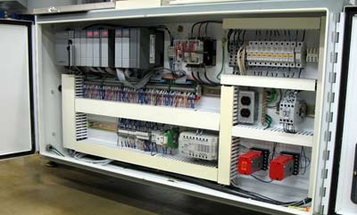

    Yes and no, I have built a fair amount of panels for work over the years. Usually I size the box to the guts, but here I had a limited amount of space to fit the box so I just have to wing it. I use wire duct in my work panels, it's really slick and allows the wires to be run much easier then free running them everywhere. also once you finish up and pop the covers on everything is clean as can be. the downfall is it usually takes a bit more space and requires everything to be laid out is straight lines. IE not how I'm doing this panel.
    Here's a random internet picture of a panel with wire duct.
    we'll see how good I am once I start wiring, the sad part is once I seal it up nobody will ever see my work.
