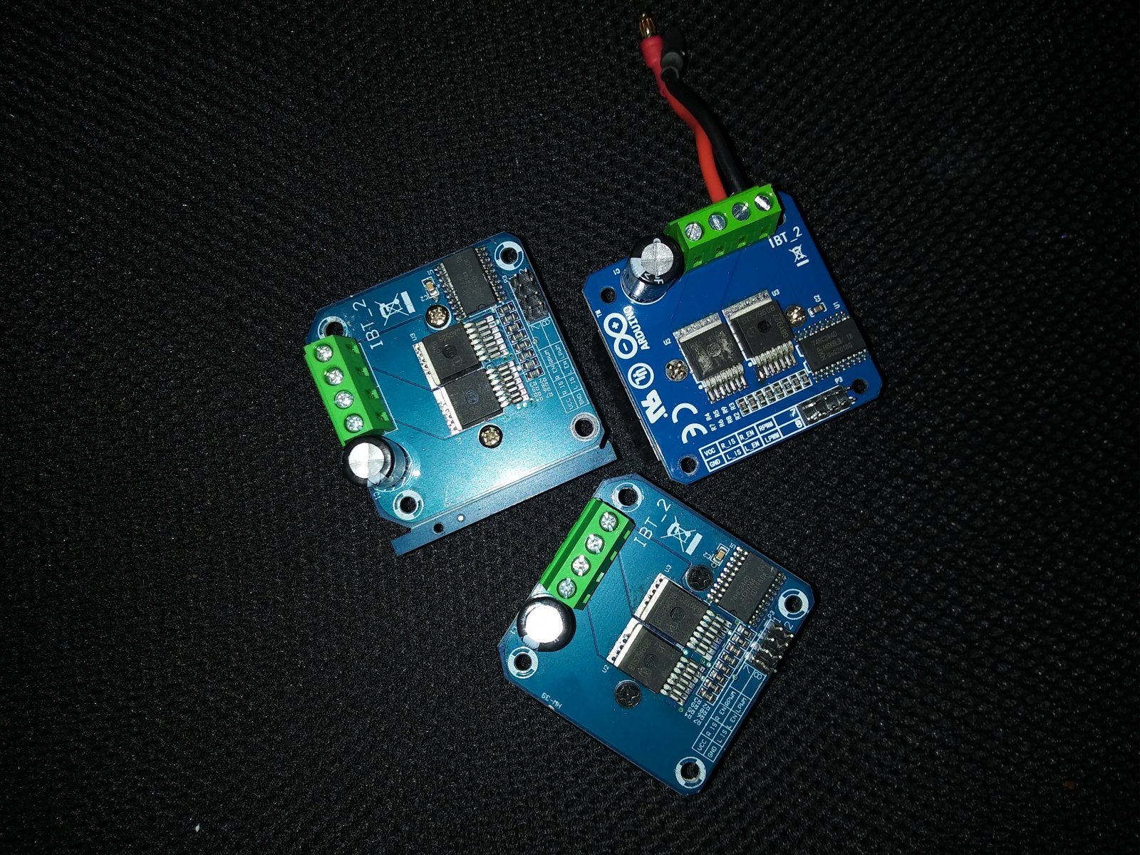

    I fought with the tuning of the pot but what the problem was, was that the IBT-2 H bridges kept blowing up. When the motor got to center, it'd vibrate a bit, then drive away to one side.

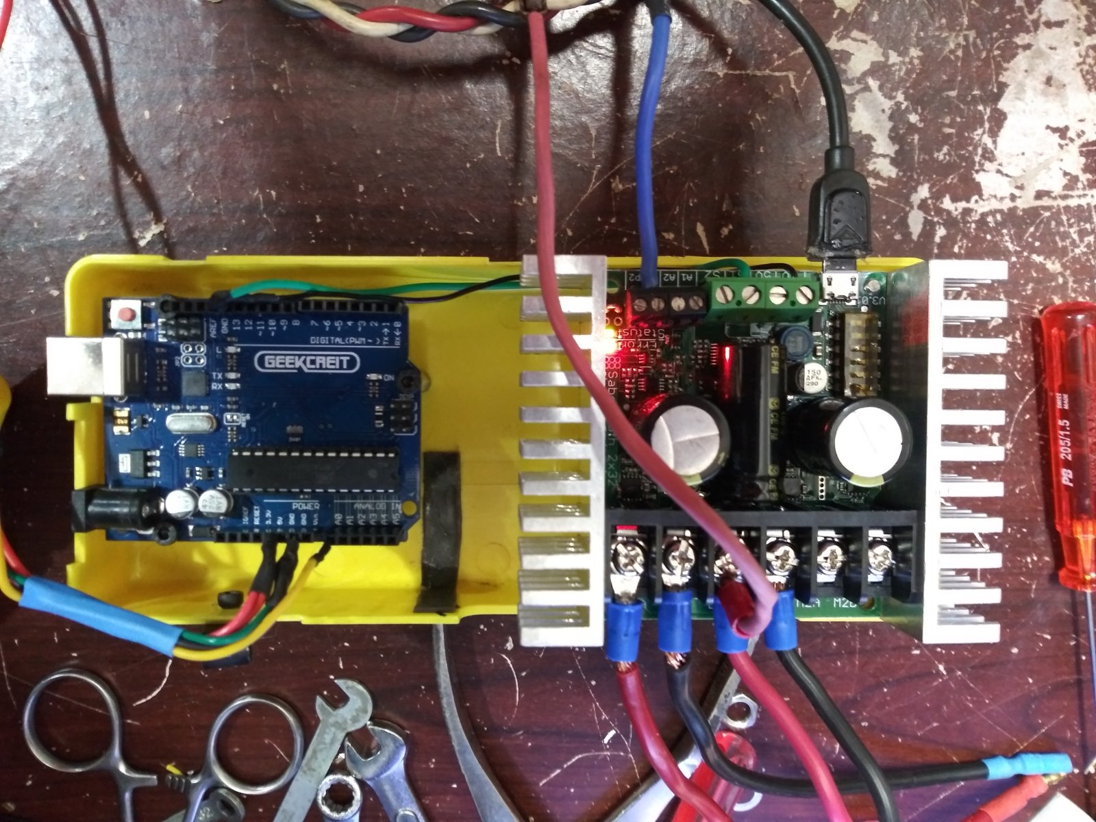

    I got a cool (expensive) Sabertooth 2x32, followed the toot as best I could and have a problem, well, two.
    1, with the computer off, I turn on the power supply and the arduino Uno and the motor runs. Moving the pot doesn't change it, it just goes on it's own. The last SMC3 (sorry, it's the newer soft start one) sketch saved was with everything at zero. I don't understand this enough to figure out what I can do. I copied the IBT-2 sketch settings and changed them for the 2x32 but I must be doing something wrong.

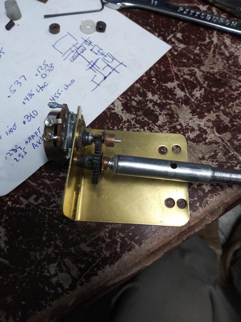

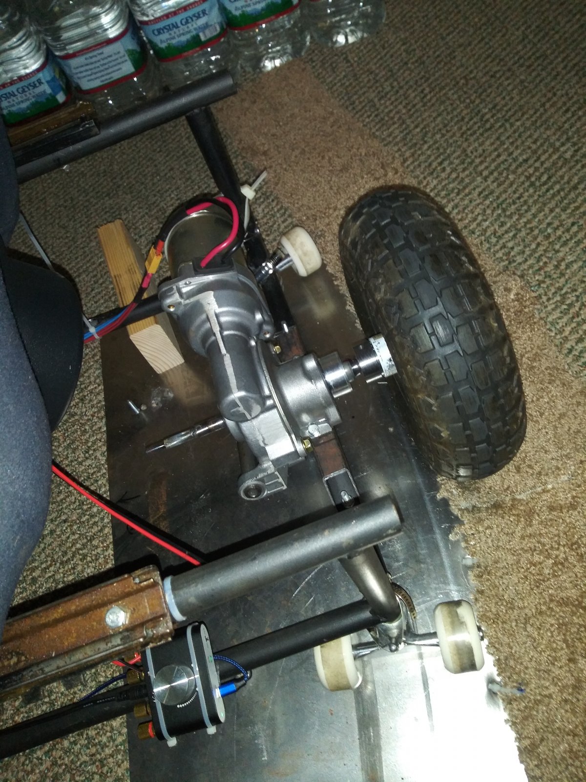

    2, I put the pot in the front pivot so the wheel will be controlled by where the rig is, not the motor because tire slip. The angles are very small. I could use slot car gears to manually change the ratio but there's probably a software fix (?)

    For Sabertooth you should use @BlazinH's modifed SMC3: https://www.xsimulator.net/communit...ket-serial-pid-motor-driver-for-arduino.9277/

    Yes, that's the one I used. When I had problems, I thought I needed to make more comments active so I compared the comments from the working IBT sketch to the ones on on BlazinH's. I'm hoping someone else had this happen and knows where I went wrong.
    I have the dip switches set as the page - off,off,on,on,on,on
    no jumpers, no clamp resistor
    SPS does recognize the UNO when asked.
    The pot is seen (but very small movement shown)
    The motor won't move with just power, it needs the USB plugged into the UNO before it runs.
    I'm submitting the first bit of the sketch where I need to make the comment changes.
    There's a chance there are more further down I don't know about.(?)

    I got some more IBT-2's and promised myself to treat them better. It worked right away so the 2x32 got sent back. I got too frustrated and have other things to do than figure that out. Using the motor and tire, I had to move the pot from the motor to the front pivot. Because the movement is so small, I figured the pot wouldn't have the resolution to show a difference. I have boxes of 50 year old slot car parts so I put them to work. The gears make it a bit over 5 to 1.

    Here's the latest video. I have it dialed in pretty well but wonder if there's a magic formula for settings.
    I'd like it to be Very responsive (no lag) but with small movement with less noticeable re-centering.
    I'd just like to know when the back is starting to move but not get jostled around while feeling it.
