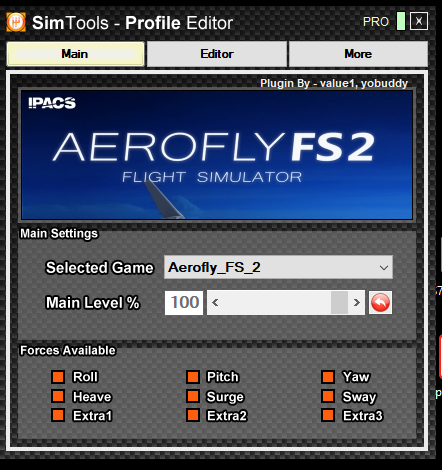

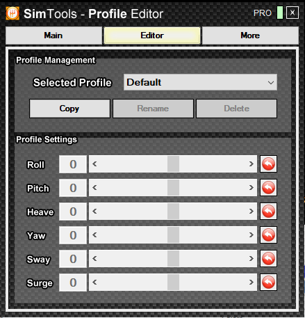

    What are your profile editor settings in game manger?

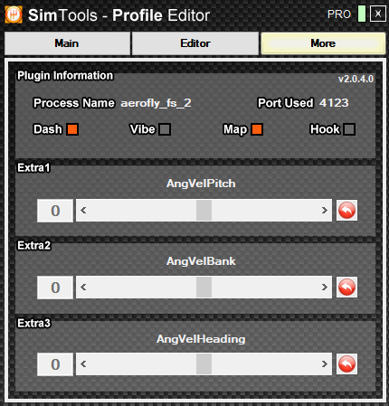

    All settings are at default values, I did not change anything.
  6. Grigory
    Grigory Active Member Gold Contributor
    Jul 6, 2016
    202
    Moscow
    224Coins
    +305 / 1 / -0
    3DOF, 6DOF
    Here they are:

    Fs2 sdk has been broken for weeks. Nothing we can do until ipacs fix it

    The developers of IPACS said that to solve the problems just write a new plugin.

    +3,363 / 13 / -1
    Try this, if it is any better. Surge, sway and heave only update very slowly. I'm not sure yet, if this is my problem or IPACS'
