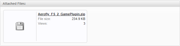

    Hi Andreas here
    Because this plugin doesn't seem to work anymore, I looked at the SDK for Aerofly FS2 and wrote a new GamePlugin. It delivers Roll, Pitch, Yaw, Surge, Sway and Heave via UDP Packages.
    Everything is working well here with my DOF reality P6, but I'm new here and it's my first plugin for motion platforms and vb.net, also it's not my main coding language. Anyone interested in testing this?
    Download my plugin here:
    http://www.ewe-software.de/downloads/sonstiges/Aerofly_FS_2_GamePlugin.zip
    Download the sourcecode here, if you wish:
    http://www.ewe-software.de/downloads/sonstiges/sourcecode_aerofly_fs_2_gameplugin.zip
    http://www.ewe-software.de/downloads/sonstiges/sourcecode_aerofly_fs_2_gameplugin_telemetry.zip
    It based of the plugin sample code by yobuddy. Thanks yobuddy!
    Happy flying :)

    Just tested it. Thanks for this. Works well with my 2 scn5 simxperience set up.
    A bit juddery first off so added 10% smoothing to roll and pitch (I only tend to use those 2 with just a seat mover)
    Forgot to patch game first of all so thought it wasn't working.
    Been a while since i added a game.
    Good stuff. thanks again.

    It looks like, but I never downloaded an previous SDK version. So I don’t know. Also I used there external_dll sample code and coded my own dll which sends UDP data to the GamePlugin dll. The update rate for this is roundabout 10 times per second.
