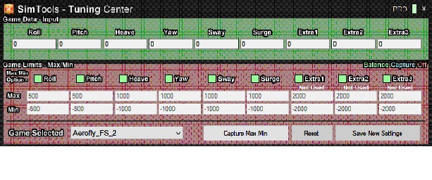

    Non-Steam version has always worked well. This new plugin worked in the current steam version, but I was unable to adjust the anti roll over. H
    anyone managed to make this work well?
    In the roll to the left, the values in the tunning center are strange.

    You must be using absolute angles rather than acceleration forces. Is that right? Its the acceleration forces that broke.

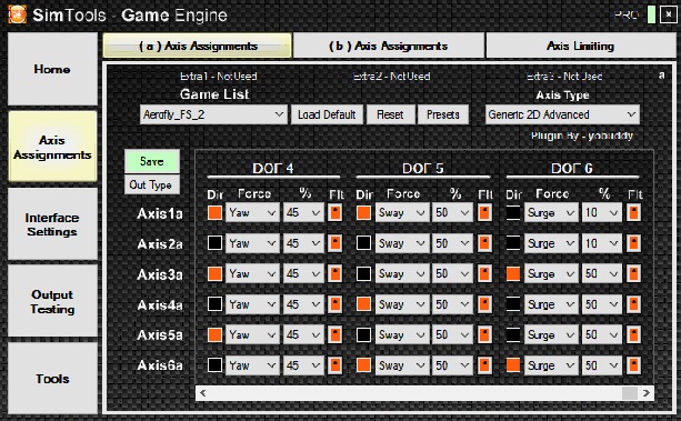

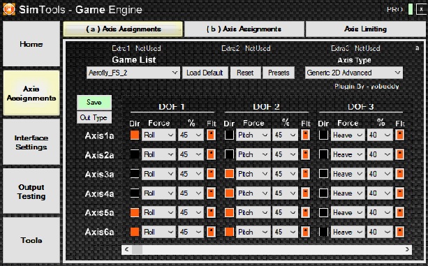

    In the previous plugin it worked fine, but I don't know what angle value to put on this one. I've tried some and it didn't work. Can you send an image of the axis assignments and the tuning center?

    Hi Andreas,
    I patched your plugin today and tried to run it with my original config. I noticed a few differences. Originally Extra1/2 were rate of bank/pitch, whereas you have been working with absolute angles. With the last IPACS SDK (when it worked), after a lot of experimentation and advice from others I found that rate of bank was a far more useful input than absolute bank angle, especially in VR. If you hold a 20 degree bank angle it feels more natural if the platform gently and unobtrusively returns to level rather than keeps you banked. I think this was the main issue with the SDK change, in that this acceleration data was lost. I think I concluded that pitch was OK as an absolute but not roll.
    Would it be possible for you to add rate of bank please or is it still missing?
    Similarly, am I correct in thinking that your surge/heave are velocities rather than acceleration forces?
    Incidentally how does yaw and traction loss differ? Yaw is an acceleration force already I see, rather than a deviation from some nominal straight ahead.

    Hi Phil,
    I checked the sdk, but i was not able to find a "RateOfBank" value like "RateOfTurn" I used for yaw. I understand the need of that for roll or pitch. I attached a text file for you with all possible values which the sdk is delivering. Maybe one of these are the value you looking for. The output values for Extra1, Extra2 and Extra3 are still unused, so I will outlet the values you need there. No problem.

    Hi Andreas, this is great. I wonder about this one?
    AircraftAngularVelocity , "Aircraft.AngularVelocity" , tm_msg_data_type::Vector3d , tm_msg_flag::Value , tm_msg_access::Read , tm_msg_unit::RadiantPerSecond , "angular velocity in body system if 'Body' flag is set (roll rate pitch rate yaw rate) in global system" ) \
    My other thought is whether the rate of change of any of these values could be derived from the stream of values?

    Hi Phil. Thats right, for surge, sway and heave I used the angular velocities instead of acceleration. This is maybe incorrect. But so angular velocities ist already used. Easily switch roll and sway in Simtools Gamemanager. This should do the trick with turning back to center when rolling the plane.

    That is very interesting. I believe that sway is a lateral acceleration - are you saying that you have used a rotational acceleration? Similarly surge should be a forwards/backwards acceleration, is your a rotational acceleration in the forwards/reverse dimension? I diagram would be very helpful – I am on holiday at the moment just using my iPad otherwise I would happily assist.
