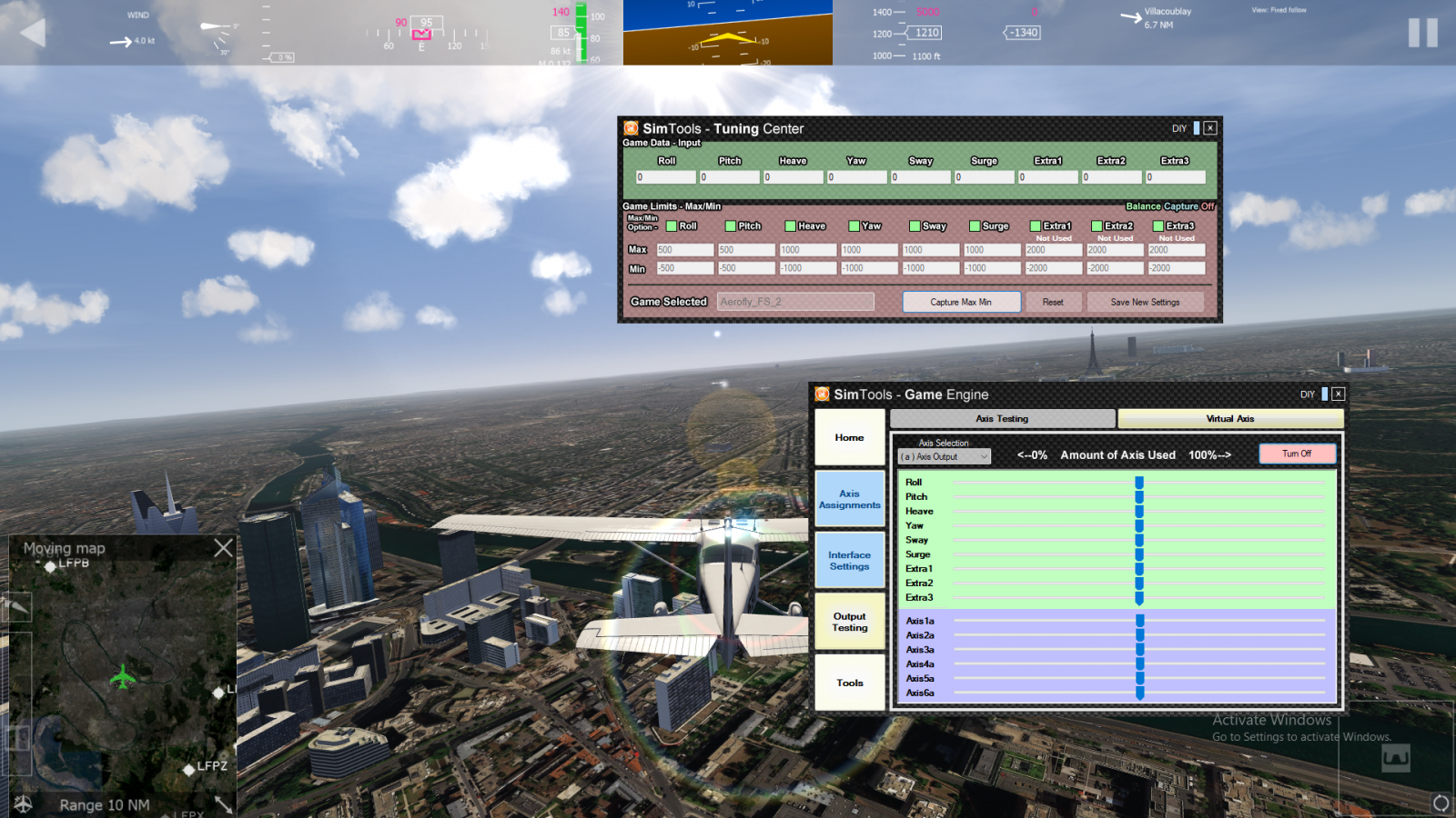

    There is no motion data sent to simtools, help please i did everything nothing changed please help me 3.png

    Is your computer set to English Local, just so we can rule out a known bug: https://www.xsimulator.net/community/faq/simtools-language-setting-bug-change-to-english-local.233/
    It is also possible that your antivirus/firewall could be messing with data communications, to check temporarily disable both, uninstall the plugin, reinstall the plugin then test.
