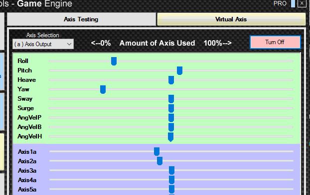

    OK, so I'm finally getting into SimTools now that FS2 works in VR mode and hitting a few areas of confusion.
    - When the game starts the platform tilts even though I'm on level ground. Everything seems fine with normal output testing.
    So I switched on the virtual axis to see what FS2 was reporting and saw the following. Both are stationary on level ground, one is at game start and the other later on in the game.
    I haven't yet done the tuning step - is that relevant? I thought that was just related to the amplitude of any DOF movement, not to do with the neutral point.

    Hi @Phil Hulme,
    at first thanks a bunch for the fantastic news that AeroFly finally works. It is my absolute favorite.
    About the tuning: Yes, it is absolutely required that you capture the min/max values with the TuningCenter. Without, you may get these uncontrolled movements. I also had this when I once forgot the TuningCenter.

    @MarkusB - Thanks for the advice. I will do that, but just thinking it through, how does the tuning process help SimTools identify flat and stationary? Doesn't it just record the full max/min range? I'm comparing the process to joystick calibration where you record the full range of movement, but there's also a step where the calibrator says allow everything to centralise and then confirm OK.

    Yes, the Tuning Center records the min and max values. You need to activate recording and then do a "normal" flight, i. e. one without a crash. Do the usual acceleration, braking, start, landing, and turning. Then you save the values.
    The smaller the Tuning Center values, the larger the axis movement within SimTools. That means, if you still find your movement is too large, you can manually increase specific values.
    And as far as I know, the initial values are zero, which means uncontrolled movement.
    I may be wrong and this is not the problem in your case, but I would give it a try.
    I once had the case that my 2DOF rig was moving completely to one side after starting a game, although the virtual vehicle did nothing. And this was solved by recording the min/max values.

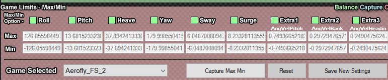

    One helpful way to tune expands a little bit on @MarkusB 's comment.
    Do as he suggests and make a nice steady flight around the place, however in simtools, use the Overall slider to bring the movement of the sim down to about 10%.
    Then in the tuning centre, zero out all your values (reset) and then start capturing the values as you taxi down the runway etc.
    If you don't limit your sim, your movements will be super violent (!!)
    It's important to let the game settle for a few seconds as some games can send a sudden surge of values to the capture on first start, so for example if Pitch surges to 90 before going back to normal range, you just captured 90 and anything BELOW that value won't register. So let the game "settle" and then reset all the values.
    If you start from zero, you capture everything. Once done. Be sure to "save" before hitting "stop capture"
    Then you can fine tune from there.

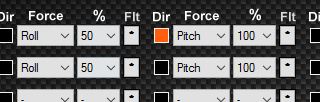

    OK, I've run the tuning process about half a dozen times now, and it seems to be storing new values fine. but I still get random platform movements.
    The last two times have been almost impossible to fly and and land as all sorts of random and sometimes severe movements were happening as I tried to make a gentle touchdown. Any ideas? DOF output testing behaves sensibly.
    All I'm mapping is roll/pitch for now. Its set up as below though I've got all this reduced to 40% in Main Level%
    Is anyone else using FS2 in VR at the moment? Is there some way I can see some sort of raw output from the game to confirm whether the game is sending crazy stuff or SimTools is converting it in a weird way?

    This is what the tuning centre shows me for roll/pitch data when level/stationary
