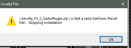

    Hi guys, I puchased Aerofly FS2 on Steam.
    So I wanted to use the newest Plugin for SimTools 2.something.
    I downloaded the .zip-File and draged still compressed to the profile Installer.
    I tried in Manager and in GameEngine.
    I tried the plugin version with the 5Stars too.
    BUT all I get is this ...
    Does anyone know how to help with that?
    Thanx in advance,
    Yours ART FLY

    Are you closing SimTools and using the PluginUpdater app to install the plugin: https://www.xsimulator.net/community/faq/how-to-install-plugins.310/

    NEWbe mistake :rolleyes: ! ! !
    NoorBeast this was the right hint. Thank you.
