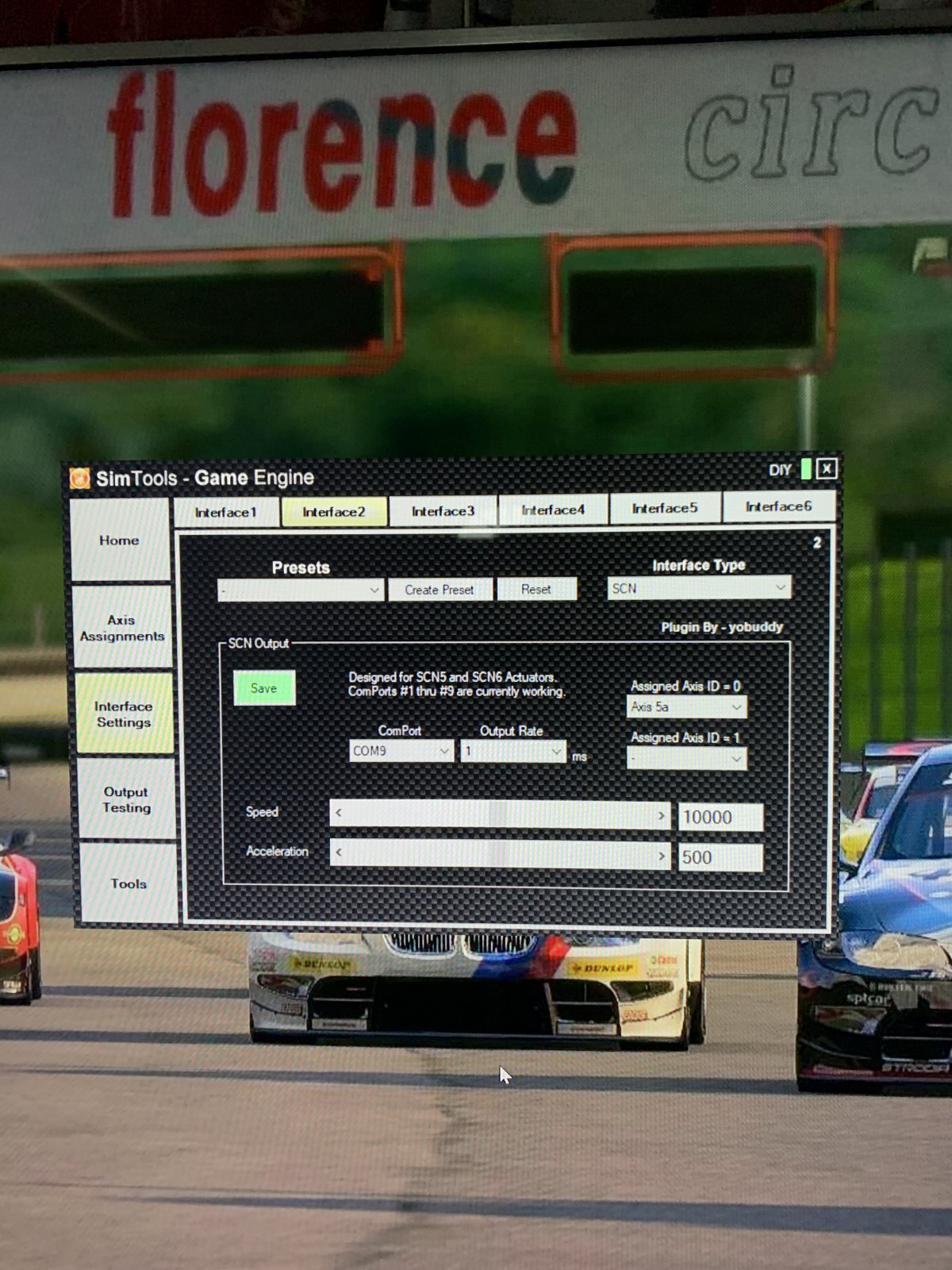

    On the other hand, I found a way to improve the situation while waiting to find the solution.
    I lowered the acceleration to 250 instead of 500 and I lowered the speed to 5000 instead of 10000.
    The result is much better and more pleasant.

    Hello.
    As I wrote above, I found a temporary tip.
    Put it on:
    - profile editor at 100%.
    - speed at 5000
    - acceleration to 250
    This gives something similar to what we had with Windows 1909.
    The video is in French for those who want.

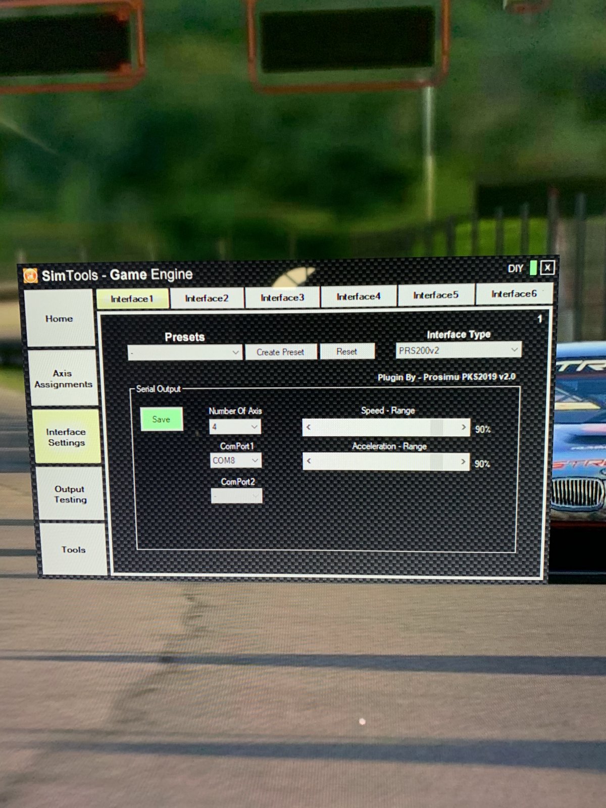

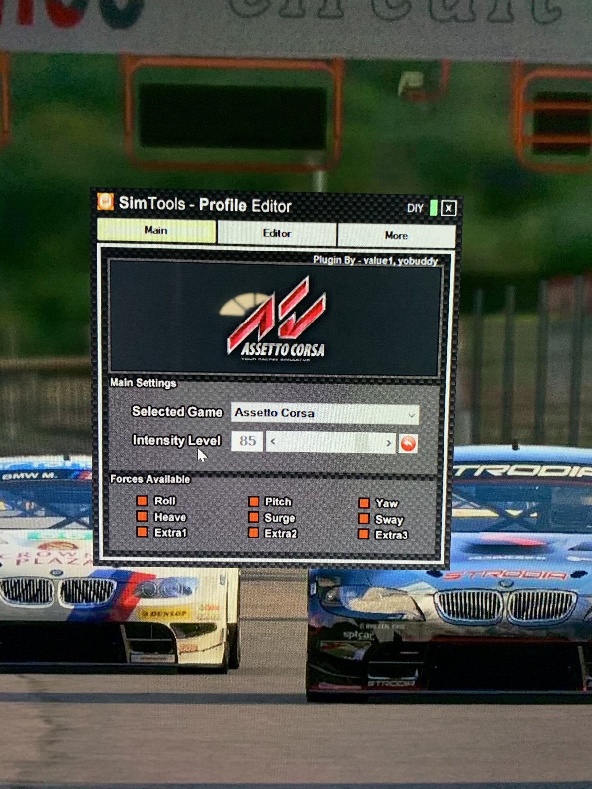

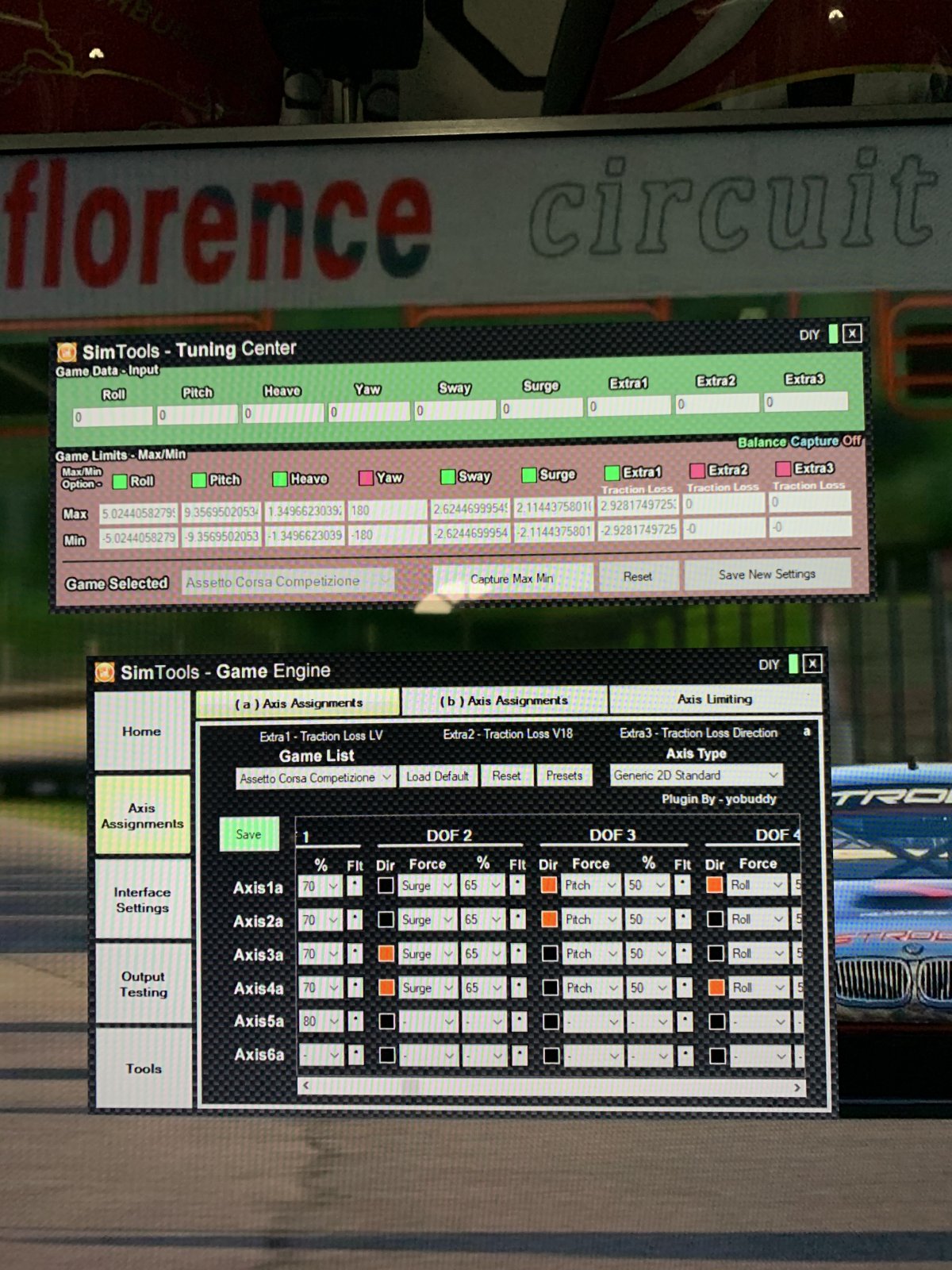

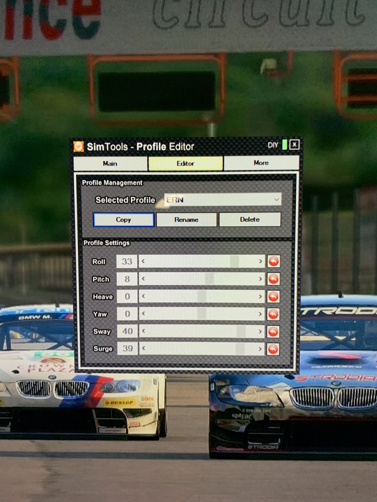

    I’ve noticed that when I go to output testing I think everything is perfect the rig moves as fast as before windows update it feels exactly the same when moving the sliders it responds as fast as usual. It’s when I start any of my sims-RF2 ,AC ,ACC, AMS2, PC2, DIRT RALLY 2.0 , I’ve lost the intensity, 99% gives me some movement at 100% the rig goes crazy actually jumps off the floor theirs no in between .at 99% I feel I’ve lost Surge and pitch. Theirs definitely more movement in sway and roll or I would say it does not notice as much, hope this information helps as I’ve got used to the immersive of simtools motion And it now feels like PlayStation days “lol” pictures below of my current setting
    Cheers Dave
