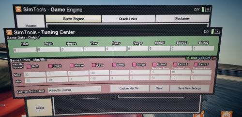

    It would be better if you made the video from the sides of the simulator instead of the back.
    When the output levers are perfectly horizontal the chair should be perfectly level.
    Please make a video in Game Engine. Go to Tools / then Tuning center and record the numbers on the screen.
    You need to have the game running and the car being driven .
    I would recommend turning off the 12 volts to the motors when doing the video.....

    Could you set your pitch axis to zero so you only have roll motion working...
    and then under the tuning box in the pink area set roll to 30 and -30
    In the tuning center bigger numbers reduces the amount of motion...

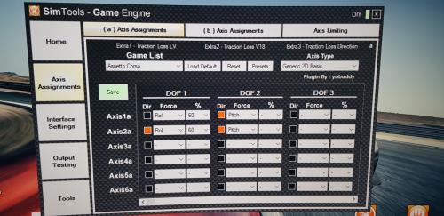

    I set simtool like this:
    below movie - sorry for driving but I used one hand and keyboard
  20. T R Para
    T R Para i make stuff up
    Oct 18, 2018
    385
    Cincinnati, Oh
    2,447Coins
    +358 / 3 / -0
    AC motor, 6DOF
    Ok it looks like the problem is somewhere between the PC and your motor driver board.
    I know that covers a large area . But we can narrow it down a bit...
    Next thing to try is run the game and go to output testing then virtual axis and turn on.. You can remove power from the motors as all that violent shaking is going to brake something.
    The slider for the roll axis should move in sync with the car movements and not be violent in its motion
