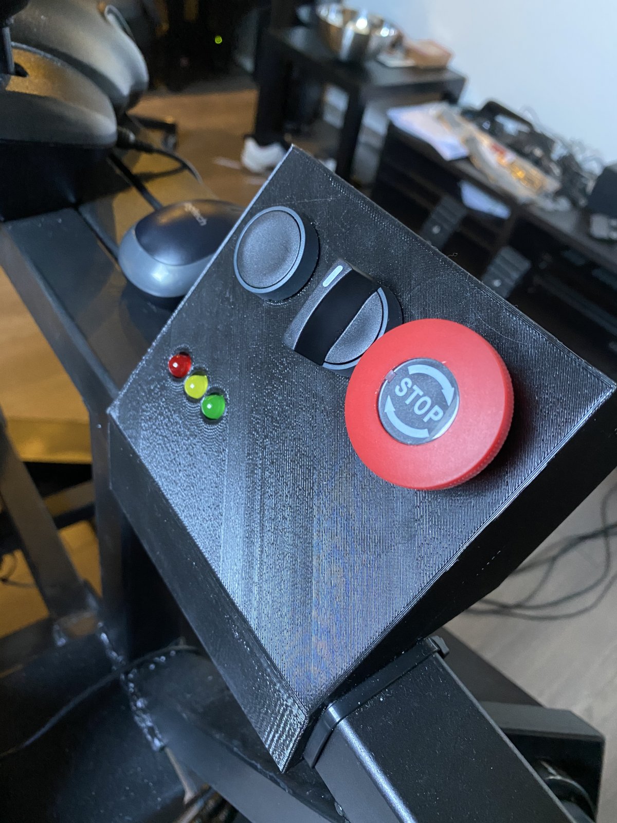

    +1,080 / 10 / -0
    Any custom made e-stop button box can be used. Like this one:
  6. pooh
    pooh Member
    May 16, 2009
    86
    584Coins
    +75 / 0 / -0
    I made myself one like this:

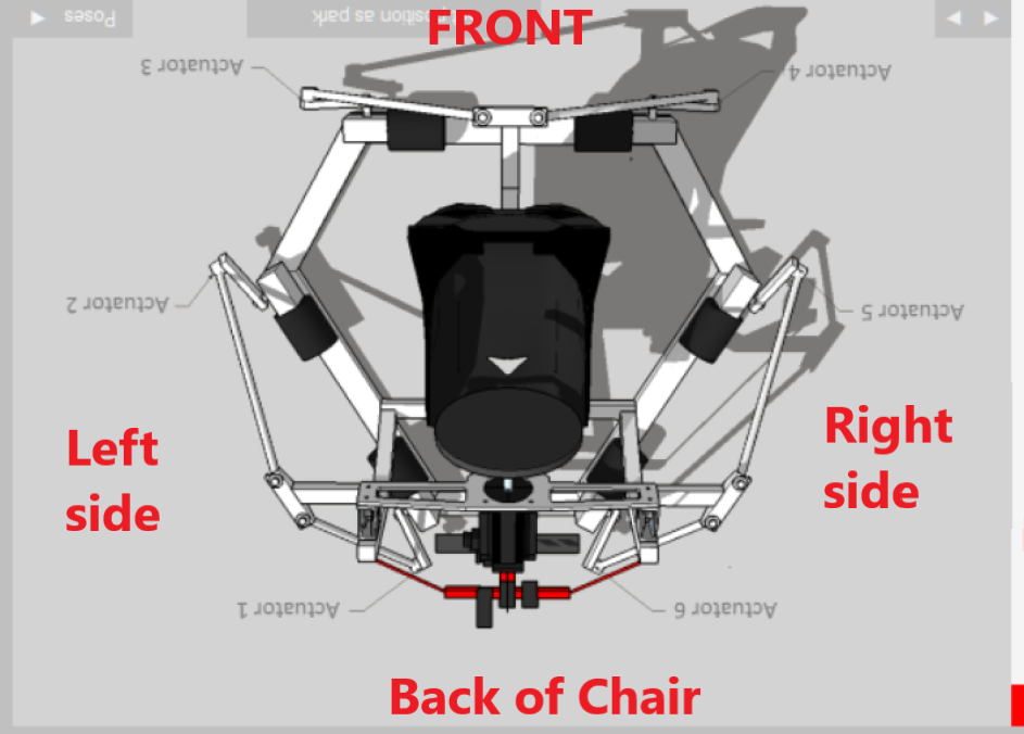

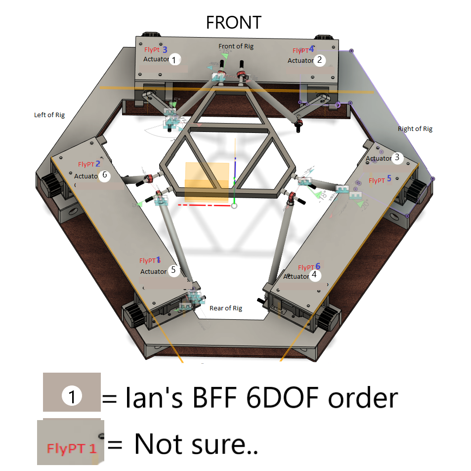

    AC motor, 6DOF
    @Thanos I have installed FlyPT Hexapod Interface 1.9.0 for my 6dof rotary platform.
    I am using the simtools output..
    I have spent a bit of time trying to get the ACM-AASD15 board to work with the FlyPT interface.
    The picture below should show how your board expects the servos to be hooked up to the Steward Platform according to Ians BBF 6dof order.
    I borrowed the picture from your discord server and modded it a bit.
    I have it working now.. Things had to get switched around a lot.
    Very confusing to me..:think

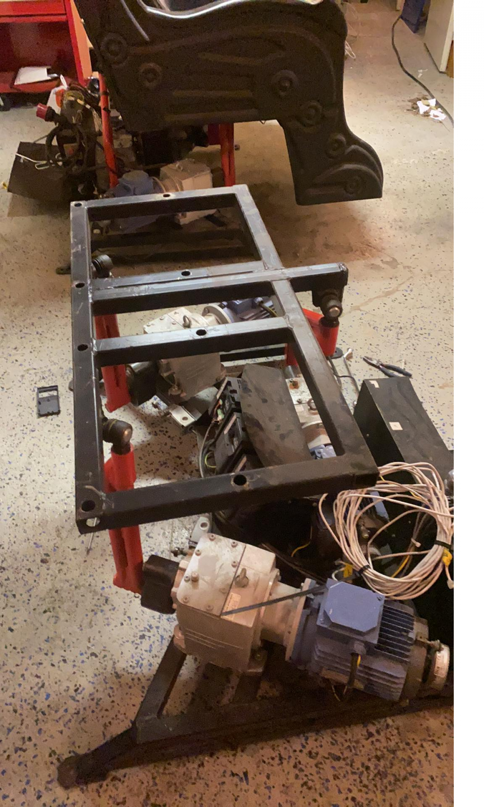

  11. Joel Sahlen
    Joel Sahlen New Member
    Oct 31, 2020
    28Coins
    3DOF, AC motor
    I got the hole sim setup from an 5d cinema, the thing is that everything works, and they got encoders fitted to them already. I got them "working" with smc3 an arduino and this setup https://www.xsimulator.net/communit...ry-encoder-in-place-of-a-potentiometer.10173/
    The problem is that they lose track, is there any way to get hold of your encoder2pos?
    I orderd your old AMC1280USB from Ebay, but i still ned a way to get the encoders to work with it.
    Mounting a POT is not something I rather dont do, as the encoder sits before the gearbox,
    And i have to say that the sim runs very good, just a problem with the pos...

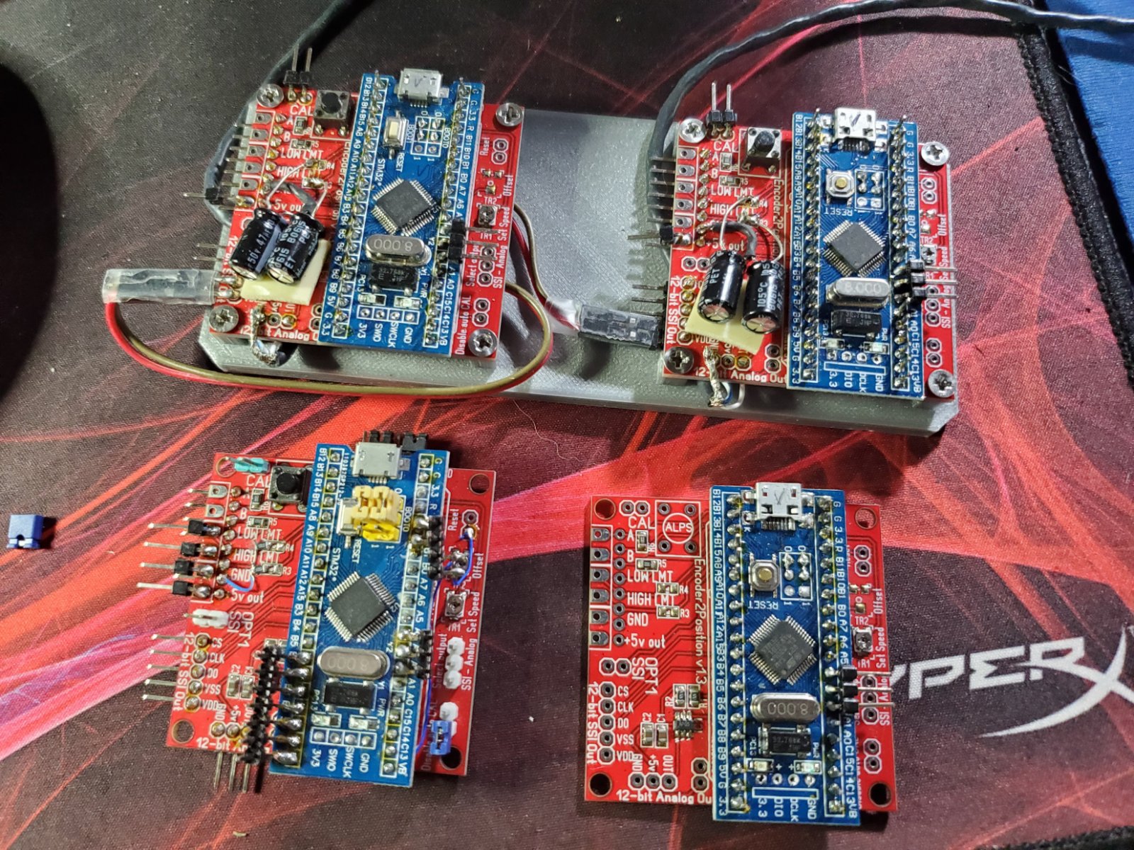

  12. Thanos
    Jul 6, 2017
    1,381
    Electronics Engineer
    United States
    2,931Coins
    +1,080 / 10 / -0
    I'll check to see if I have any old encoder2position boards left in my retired parts bin...
    https://www.tindie.com/products/tronicgr/encoder2position-module/
    How many axis (motors) your platform has? Can't tell from the photo.

  14. Thanos
    Jul 6, 2017
    1,381
    United States
    2,931Coins
    +1,080 / 10 / -0
    I found four encoder2position boards...
    If you need more, I think @wannabeaflyer2 may have some he is not using at the moment as he switched to servomotors... maybe send him a message.
    Thanos
