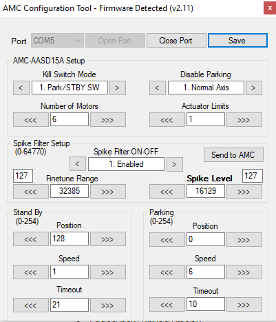

    Hello Thanos,
    Yes I have the latest firmware v2.11 fix3.
    My Parking and StdBy setting are inline with yours.
    Here attached screenshot of my setting on AMC Config tool,
    Note: I have checked they are the same on AMC controler as well.
    For the video here it is:
    Is the stdby speed set to 1 should apply when AMC do the transition from parking to stdby ? If yes I would expect a very low speed while it looks like it is full speed.
    Thanks for your help, Olivier

    Hi Olivier,
    I can't see the video its private, set it unlisted so it can be viewed.
    About the standby speed, its actually a delay, the smaller the number the smaller the delay and the faster it moves. You should increase the standby speed number to name it move slower...

    Hello Thanos, my Video should now be visible.
    So in the video, you will see that the time for the actuators to do the transition from stdby to parking (first time I press stdby button) is around 7 seconds.
    In the opposite the time for the actuators to do the transition from parking to stdby is less than 2 seconds (second time I press stdby button) .
    So what are the settings to do so that transition from park to stdby takes approximatively 7 seconds as well ? For now what ever the value I set in stdby speed it does not change the transition speed from Park to stdby. It is always neer to full speed. Hope my question is clearer now.

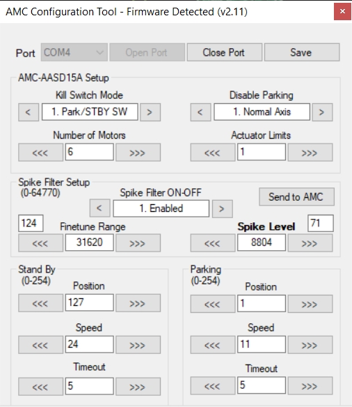

    Did you set the standby speed value higher as I mentioned?

    Yes I did, exactly the same as in your AMC config above. It's the same results with speed to 27 compare to 1. Should it be slower ? not for me.
