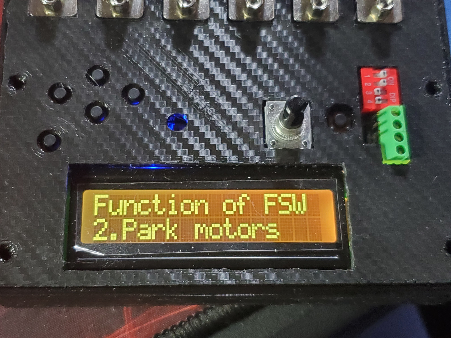

    OMG, it still doesn't work as expected and i learned it the hard way... estop was changed to hold position and when i pressed it it KILLED power to all servos and i went down :(
    i can't store correct settings now for that. if i "store" it - it shows "hold position" but then when i hit emergency button it kills power :( if i reset the controller it shows kill power again...
  2. pooh
    pooh Member
    May 16, 2009
    86
    584Coins
    +75 / 0 / -0
    ok, i think i know what the problem is and how to reproduce it:
    if you have force offline switch turned ON then it won't save settings (and there's no message "settings saved")
    i'm not sure if this is correct/expected behaviour but i will update it to 2.11fix4 again and check.
    i believe i should be able to change settings with force offline switched ON though...

    Load the latest firmware here:
    https://github.com/tronicgr/AMC-AAS.../enc_6dof_AMC_AASD15A_v2_11_beta_fix4_RGB.zip
    Then make sure to restore defaults by holding exit button as seen in this video:
    Then, make sure to have the Force Offline switch deactivated and set and store your settings.

    yes, force offline was the issue. is it intentional?
    btw, when using FO set to park the speed going down is ok but speed going up is not the one set in settings. it's the issue described in previous page.
  5. Thanos
    Jul 6, 2017
    1,381
    Electronics Engineer
    United States
    2,931Coins
    +1,080 / 10 / -0
    Yes, Just tested, everything saves correctly, and as I said you have to make sure to have the force offline switch deactivated.
    It doesn't save the parameters when force offline is active in purpose, as some were pausing the motion while still connected to the game, to do small adjustments, and there are lockup issues trying to save parameters in epprom memory while there are interrupts for incoming motion data. I just raise a flag that there are parameters waiting to be saved and wait normally for the incoming data to stop or the force offline switch to be deactivated and then it saves automatically...

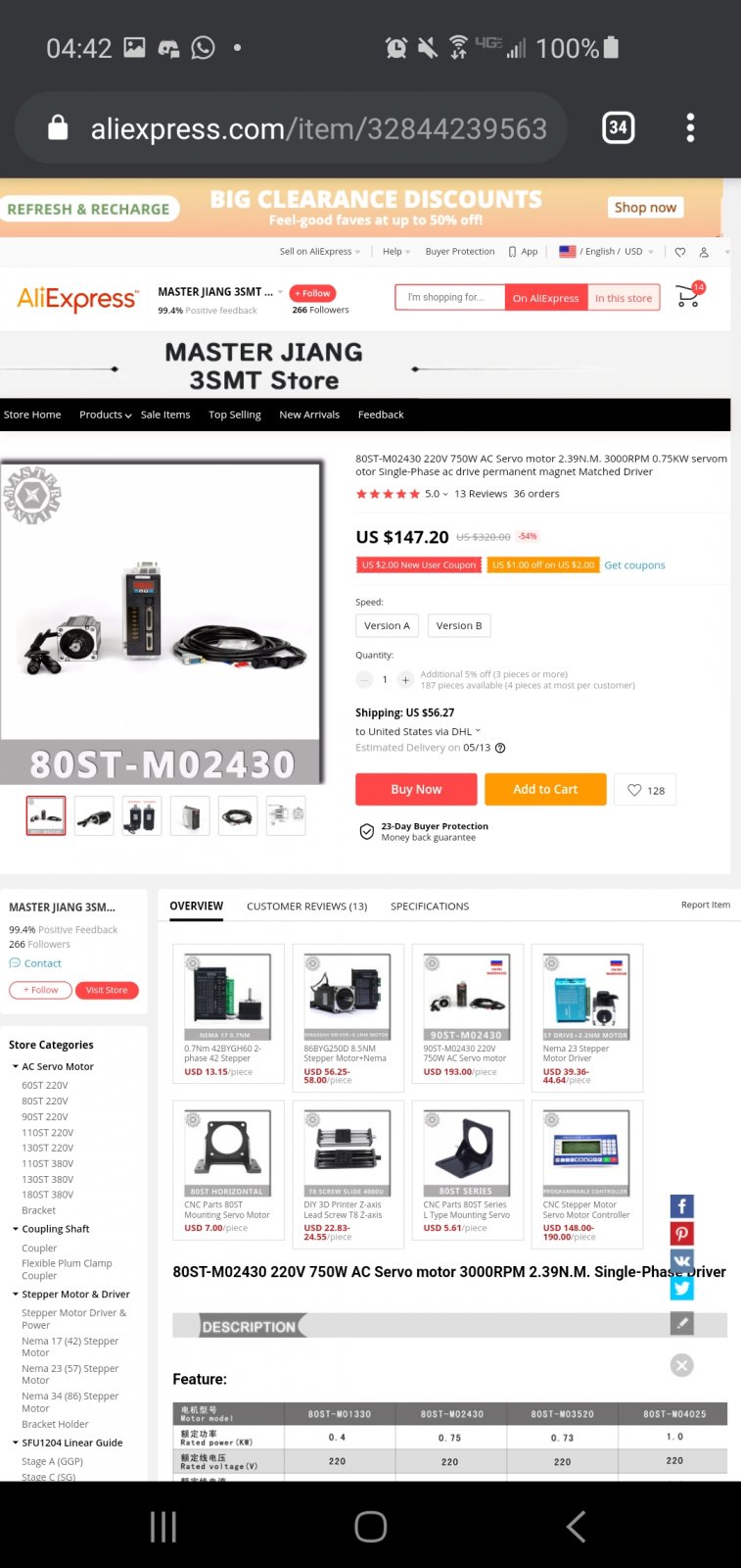

  9. pooh
    pooh Member
    May 16, 2009
    86
    584Coins
    +75 / 0 / -0
    i recomend this shop as i have bought there. ver A and B differs by connection on servo side and you can choose whichever you prefer. 90 is size of motors and i went with 80 - servo flange is 80x80mm
  10. gigi
    gigi Active Member
    Nov 16, 2013
    467
    920Coins
    +141 / 1 / -0
    2DOF, JRK, 4DOF
    I Pooh thanks for your reply.
    Ver.A90 and Ver B.90 mean that the motor is 90ST-M02430? If yes as I'm looking for 80ST and not 90ST my choice should be only from "VersionA" or "VersionB" and I can exclude "Ver.A90" and "Ver.B90"? correct?
    Your choice was 80St "VersionA"'
    Thanks for support
  11. pooh
    pooh Member
    May 16, 2009
    86
    584Coins
    +75 / 0 / -0
    correct!

    Thanos, so now question remains about the momentary button connected in parallel with emergency button. what is expected behaviour of it?
    because i thought it should be possible to configure those buttons in a way that if my force offline switch is set to "hold position" then if i'm in the game and engage FO then it holds position and then i can push my momentary "park" button and it should go to park so i can exit the platform...
    at the moment it doesn't work for me if in game (connected to mover). the way i use it now is that my FO switch is set to "park" but that causes it to park even when i want FO for a brief moment at the begining of motion or in pitlane.
  13. Thanos
    Jul 6, 2017
    1,381
    United States
    2,931Coins
    +1,080 / 10 / -0
    The monetary button works only when the controller is offline, not receiving motion data at all. If its receiving motion data won't work even if you engage the force offline switch... I needed to enforce that to prevent issues with jumping to real motion data sometimes. The monetary button is used if you need to lift the platform powered, to place supports to work on it, like in racing cars in the pits... :p
    The Force offline switch behavior can be set to either move and stay at Standby (50%) or move the actuators to Park position.
